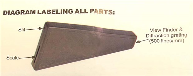

Spectrometry is the measurement of electromagnetic radiation.  Here we are most interested in the dominant frequency of LEDs emitting visible light.  Sparing no expense an Eisco spectroscope cat no. PH 0100QA was purchased from Amazon for $8.29 USD including shipping.  The marketing blurb states that the measurement range is 400 to 700 nm and the accuracy is +/- 5 nm.  More on that later.
The instrument passes light through a slit with a 500 lines/mm diffraction grating on the viewing end.  There is a scale lit by an opening which shows the frequency of the light in nanometers that can be seen when looking through the view finder.  Knowing the distance from the slit to the diffraction grating and the spacing of the grating it is possible to calculate the wavelength of the spectra when viewed.  According to the Experiment Guide provided with the instrument:
     y = λL/d  (2)
where: y is the distance from the center to the spectral line being measured in meters (m) on the scale
            λ is the wavelength (m)
            L is the distance from the diffraction grating to the slit in meters (0.19 m)
            d is the distance between gratings in meters (2 x 10−6 m)
This calculation does not appear to properly account for the variable distance from the view finder of the ends of the scale.  The scale is marked in nanometers rather than meters.
credit:  Experiment Guide, EISCO SCIENTIFIC www.eiscolabs.com
Although not the most precise of instruments it performed better than I thought it would and I had a lot of fun with it.  It succeeded in making me more interested in spectrometry and I am considering making a more sophisticated instrument with a Raspberry Pi  to record data and examine other ways spectrometry is used.  The spectrometer was mounted on a tripod with rubber bands to hold it steady and using an iPhone the spectrograph of sunlight was captured.  It is difficult to get a good photo but here is one that has been cropped and straightened in Photoshop with the contrast tweaked but otherwise unaltered.

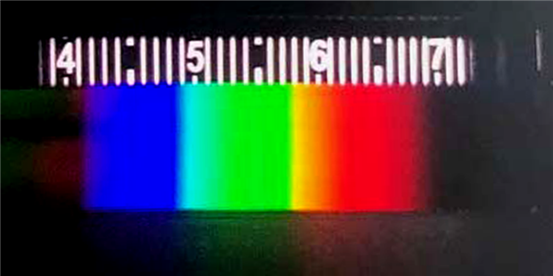

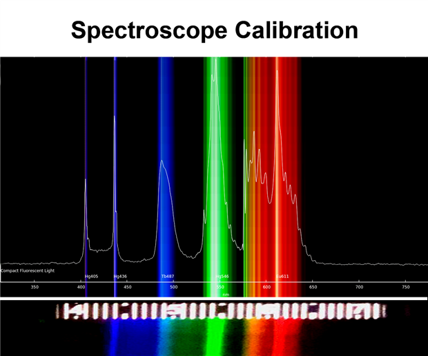

The following video demonstrates the setup while viewing a compact fluorescent light (CFL).
The direct emissions from the mercury vapor in a common CFL  gives several bright lines and there is also fluorescence from rare earth phosphors.  A representative spectrograph from the internet will be used for calibration and is shown here superimposed above the spectroscope.
credits:  top spectrograph uncredited image on Pinterest.  bottom spectrograph, the author.
The bottom spectrograph from the spectroscope has been "stretched" in Photoshop so as to line up with the image being used for calibration.  The CFL light has several bright lines including the following:
Element
Calibration Spectrograph
λ (nm)
Spectroscope Spectrograph
λ (nm)
Hg 436 440
Tb 487 487
Hg 546 545
Eu 611 611
The problem here is that the spectroscope does not give particularly sharp lines and it is difficult to visually discern the brightest part of the line.  The comparison does however indicate that the blue side of the spectrum seems a bit off for the spectroscope by maybe 4 nm or so.

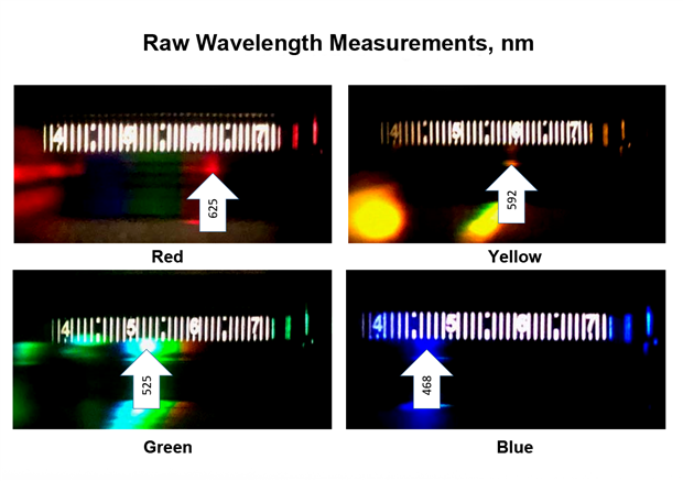

The spectroscope was then used to measure several Lite-On brand LEDs in my possession where datasheets were available and one unknow red LED.  The resulting spectrographs were photographed and shown below.
Credit: the author
The arrows with wavelength records my estimate of the brightest part of that line in the spectra.  If my attempts at calibration are to be believed, the blue LED is about 4 nm off high and might be corrected to 464 nm.

So there is uncertainty in all the sources of data.  The spectroscope results have been tabulated below along with the datasheet values from Lite-On.
LED Color Lite-On Model
Datasheet
λ (nm)
Spectroscope
λ (nm)
Corrected
λ (nm)
Red Unknown 625
Yellow LTL2V3YX3KS 596 592
Green LTL2V3TGX3KS 522 525
Blue LTL2V3TBS3KS 472 468 464
There is potential for greater than 5 nm difference from the typical datasheet value and the "corrected" value from the observations differs more from the datasheet than the raw value.

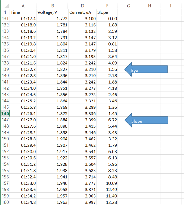

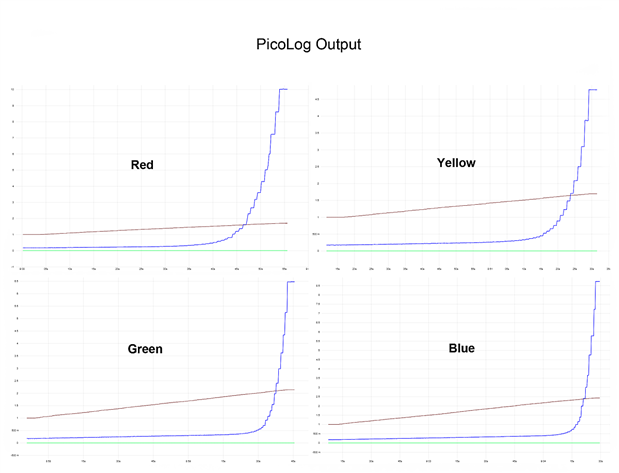

The plots with voltage and current as a function of time and taken directly from the PicoLog onscreen graphical output are shown below.
The blue lines are the current and the brown lines are voltage plotted against time.  The minimum voltage increment on the bench power supply is 0.01 V which explains the current steps once the forward voltage exceeds a forward voltage sufficient for the exponential current increase to become apparent.  Since there isn't a sharp transition there is bound to be some error in the voltage used to calculate the Planck constant by this method.  The following three methods were considered:
  • the point that light is just visible to the eye which is subjective and dependent on the eye
  • the voltage where V-I obtains a specified slope - i.e. the first derivative
  • the voltage where the slope change doubles over a specified voltage range - i.e. the second derivative

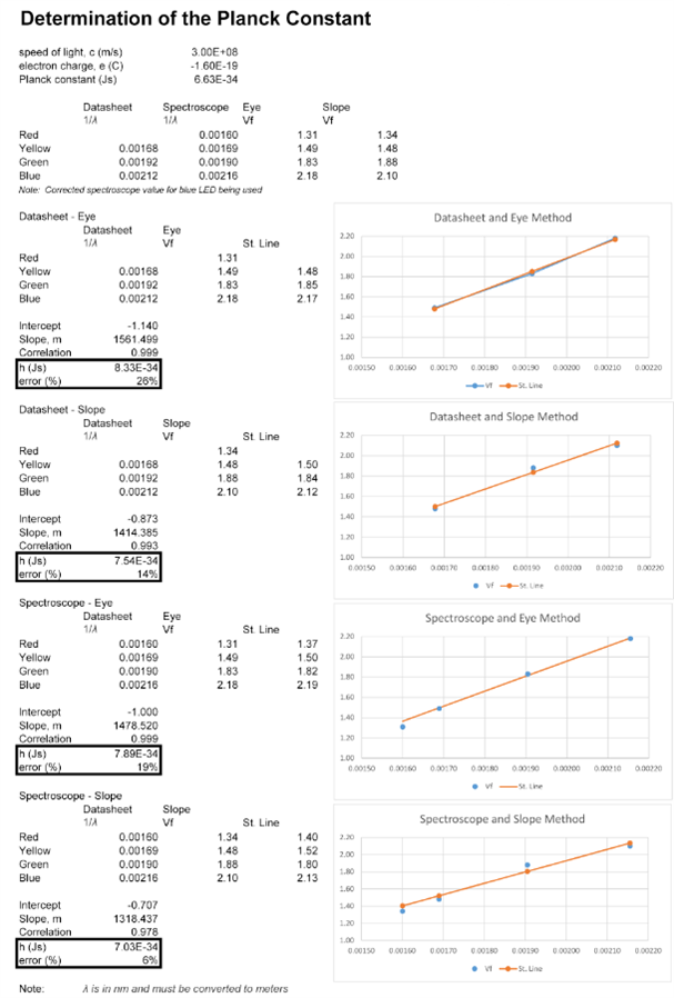

When the data in the table was examined the problems with a manual sweep of voltage became apparent in that the rate of voltage change was not consistent and there were pauses and jumps backwards and forwards to clean up.  Multiple sweeps or slower sweeps with averaging would have helped smooth the data.  The approach using the second derivative was dropped because it didn't seem to provide additional insight given the crudity of the data.  Below is an annotated extract from the green data.
The slope was calculated in a somewhat odd manner by arbitrarily getting slope from the current to 3 entries back due to the way data was captured.    The methodology for slope determination where photons are first emitted could stand improvement.
The massaged data from all LEDs is shown in the table below.
Color Vf (V), eye method Vf (V), slope method
Red 1.31 1.34
Yellow 1.49 1.48
Green 1.92 1.88
Blue 2.18 2.10
Interesting... Sometimes my eye sees the LED light sooner than the slope method might indicate and sometimes later. The eye method was repeated with the same result.  Not too surprising perhaps - the eye will vary by individual and is sensitive to some colors more than others.
The forward voltage as a function of 1/λ was plotted and the slope calculated using least squares.  Here slope is referring to voltage and 1/λ for multiple LEDs - not the V-I curve discussed above. From there the Planck constant was determined.  Four cases were evaluated using the datasheet and spectroscope to get frequency and the eye method and slope method to get the forward voltage when the LED turned on.
The deviation from the accepted value using the 4 different methods varied from 6% to 26%.  The best results were obtained using the spectroscope to determine frequency and slope for voltage.
