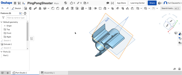

3D modeling
Basically what you need is a bucket with a tube on which you mount three BLDC motors that have wheels on them which will spin the ball and shoot it away.
In this project I am going to get my kids involved, the model you see above here has been designed by my oldest son. I have been organizing summer camps for children the last four years and I see this as a kind of extension to that... ;-)
Once he has his model finished we are going to 3D print it and connect the BLDC motors to it.

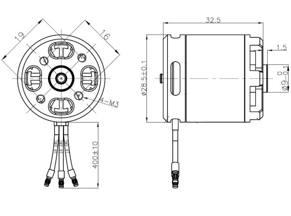

We are going to use a BLDC from Avizar, the MC2834:
The first model is finished:

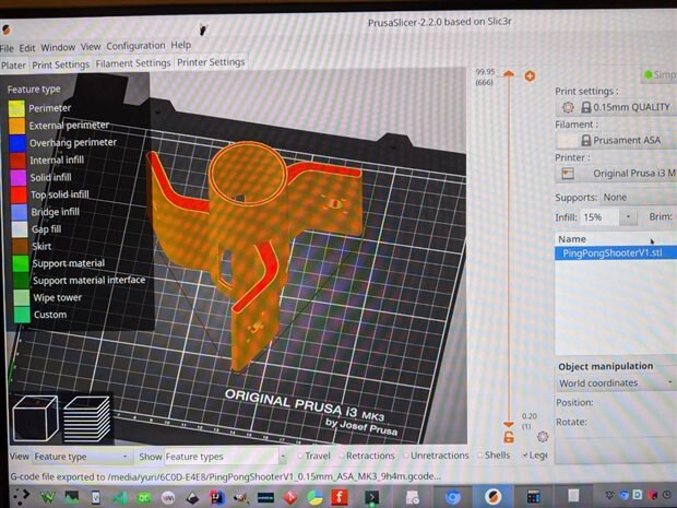

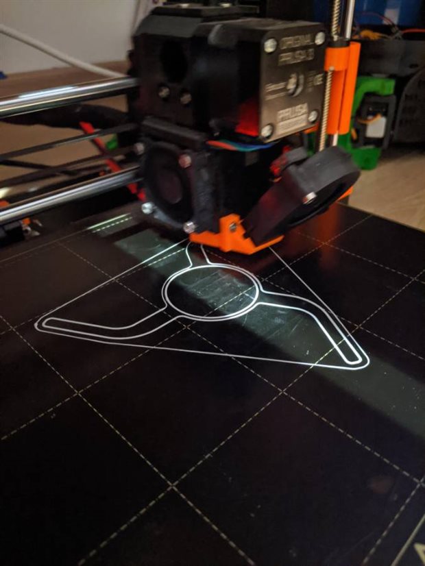

And already printing:
We are printing with ASA filament which is engineering grade and should be quite strong...

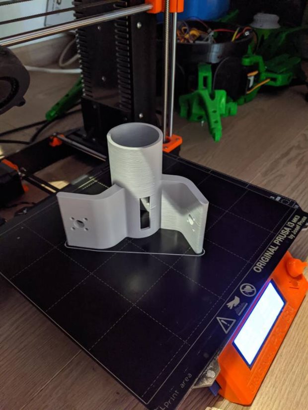

Printing has finished:

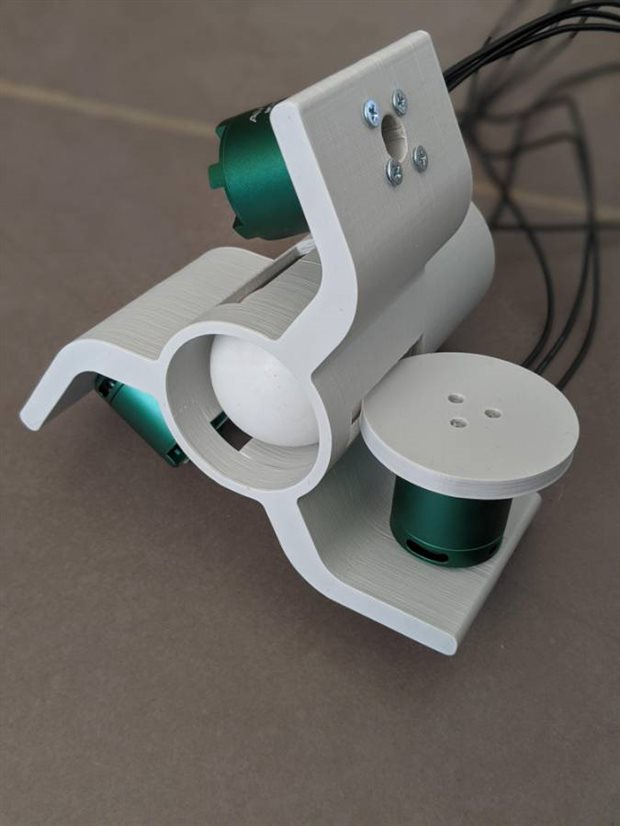

Motors assembled:
Experimenting with wheels...

Added a front cover to prevent being hurt if an o-ring (which will be mounted on the wheels, thanks for the tip dougw) slips off.
Also added a ball coupling, this allows the shooter to move by about 36 degrees left/right/up/down...
After 3 days, the print is ready, next step will be creating a box with a ping pong ball feeder.
After updating the discs, serious improvements where achieved for the speed of the ball... At low speed it even shoots away fast!
