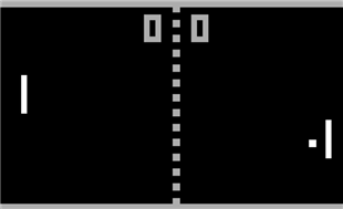

What's Ponq?

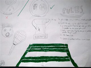

Then my son came home with a project he'd done in the one day of school a week that he's doing. Due to the cancellation of Wimbledon tennis this year, they'd been challenged to make up their own substitute. He'd come up with pushing a ball back and forth across a table and scoring much like table tennis. One sentence from his poster struck me - Someone or something must be a scoreboard.
I imagined an overhead view of the "court" with the Pynq-Z2 tracking the movement of the ball and updating the score. I then thought back to the first video game I ever used - the classic (if you're old enough) Pong. I imagined a Pong-like score for each player calculated automatically and overlayed on top of a video feed of the game.

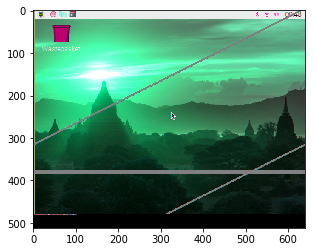

However, you can see that the output would often be wonky. You may notice it's displayed on top of what appears to be a Raspberry Pi desktop. This is just because this was the most convenient source of a 640x480 video feed that I had to hand!

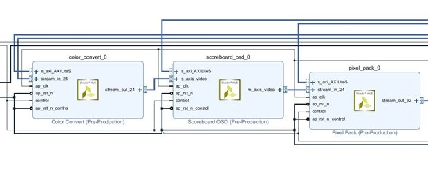

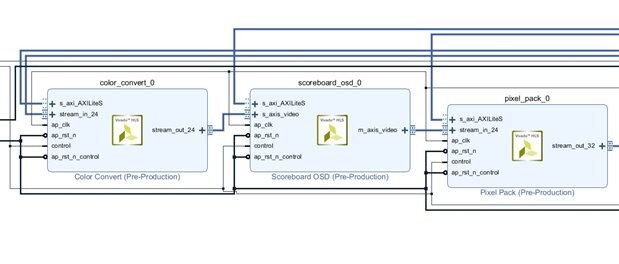

2. Adding the scoreboard IP to our overlay.
Once the scoreboard IP had been created I started by adding it on to the pipeline we created during the workshop series. I'd previously added IP to posterize the colours coming through, so I won't go into great detail about packaging the IP. The process was much the same. I then switched from Vivado HLS to Vivado and this IP was then dropped in to the same place by posterize IP had been.
After going through the now familiar process of creating a bitstream to export over to Pynq I was ready to test it.

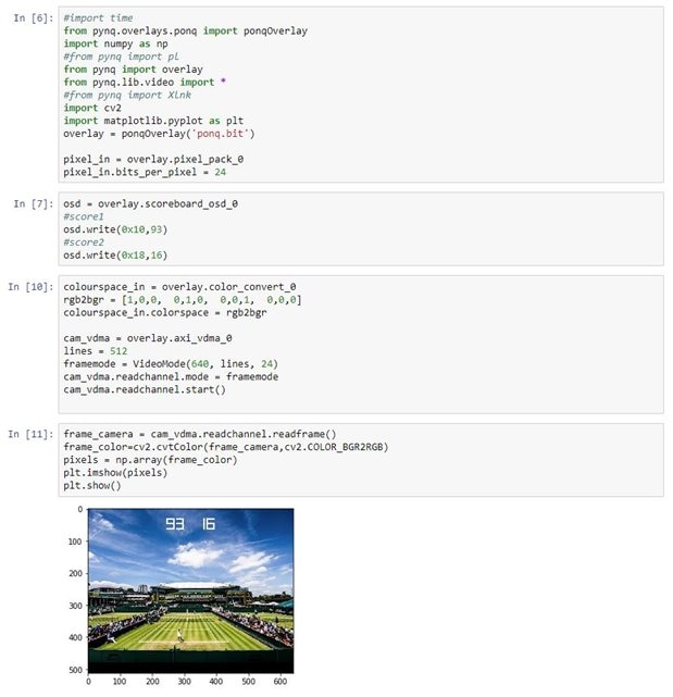

3. Using our IP in Pynq
One thing that didn't seem obvious was how to access my parameters - score1 and score2. There was a useful comment I found in another of Adam Taylor's blogs - "You can find the slave AXI address offset in the generated driver files for the IP block in Vivado HLS". However, there wasn't any further details. I eventually managed to find the details I needed in a file called scoreboard\scoreboard\syn\verilog\scoreboard_osd_AXILiteS_s_axi.v that told me the addresses I needed.
//------------------------Address Info-------------------
// 0x00 : reserved
// 0x04 : reserved
// 0x08 : reserved
// 0x0c : reserved
// 0x10 : Data signal of score1
//        bit 31~0 - score1[31:0] (Read/Write)
// 0x14 : reserved
// 0x18 : Data signal of score2
//        bit 31~0 - score2[31:0] (Read/Write)
// 0x1c : reserved
// (SC = Self Clear, COR = Clear on Read, TOW = Toggle on Write, COH = Clear on Handshake)
I initially thought that the following code would work. It runs just fine but it does nothing. There must be a way to get this working so the IP is easier to use, but right now I'm not sure how.
osd.score1 = 93
osd.score2 = 46
I was very happy to see that I could now set the two scores in my Python code overlayed on my video feed. (My Raspberry Pi is now displaying a photo of Wimbledon.)

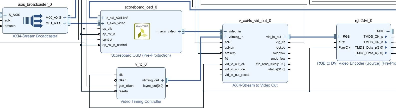

4. Displaying the score on via HDMI out
The next stage was to display the video with the score overlay on a HDMI monitor. I took inspiration from this Xilinx blog showing how to generate HDMI output on the Pynq using the pattern generator. There's also a nice blog by here by yuricts  covering similar ground. PYNQ Z2: Getting Up and Running - Tea Storm . I decide to split the video stream straight from the front end. One side would have the overlay added and head out to the Z2's HDMI out. The other side was better without the overlay as it was going to be processed to find the ball and work out the scoring.
The IP required for this are as follows:
IPFunction
AXI4-Stream BroadcasterThis splits the AXI stream into two copies
Video Timing ControllerIn our case this generates the timing signals required. It can also be configured to detect these signals if required.
AXI4-Stream to Video OutThis takes the stream and the timing from the Timing Controller and generates RGB video signal
RGB to DVI Video EncoderAs the name implies, this takes RGB video and generates the DVI signal we're going to push out over HDMI.
This is the relevant part of the (not quite working yet) block design starting from where the broadcaster takes a "copy" of the incoming HDMI stream. The outputs on the right are direceted to the appropriate HDMI pins through the standard Pynq Z2 constraints file.
The Xilinx example is for Vivado 2018.1 (which is not one of the 4 versions of Vivado I have installed) but it wasn't too hard to create it for later versions. The structure of the IP is as shown. The thing I found hardest to get working properly was the clocking. I was banging my head against conflicts between IP that was clocked at 100MHz (for AXI control) and other than was clocked at 142MHz (for the video stream). I somehow missed that the pixel clock for the RGB to DVI should be clocked at 40MHz and was stuck there for a while. Tying it to the PixelClock from HDMI in synthesized OK but caused routing errors. Once I had the block design synthesizing OK I then spend many head-scratching hours with just nothing on the HDMI output. I have converted this guide to HDMI to to work with Vivado 2019.1 and can happily generate an 800x600 output. I have removed my own IP and have the HDMI-to-Pynq block design we created in the work shop processing 800x600 HDMI in from a Raspberry Pi. However, I just can't get the video stream from the Color Convert IP displaying on the HDMI out. I know it's OK as Pynq can display it. The only difference I can see is that the Pynq video stream is working at 142MHz and the HDMI out example uses 100MHz, but I've matched this to the AXI4-Stream to Video Out.
After a very helpful Zoom screen sharing session with Adam Taylor, it turns out that there are a couple of oddities when dealing with a real incoming video stream, as opposed to the on generated by IP such as the Test Pattern Generator. The TPG creates a nice clean stream of pixel data. HDMI however, tends to come in irregular bursts. It seems that these burst weren't quite stable enough for the AXI4-Stream to Video Out to get a lock and to push data out on its vid_io_out port. Connecting the onboard LEDs showed that locked remained low and underflow was worryingly high. Increasing the hysteresis (i.e. buffering) in this piece of IP finally gave some output although this tended to flicker out to a blank screen every few seconds. Al least I now had something coming through. Another little quirk is that if you use a Stream Broadcaster then neither output gets any data if one of the isn't accepting input. In this case, until you call readframe() in Pynq, the video out will also receive no data.
Unfortunately this flickering screen was the best I could get. I tried varying the hysteresis. I tried adding an AXI4 FIFO IP but at best this slightly lengthened the time before flickering to black. Making any other changes - including adding the Scoreboard IP I'd created - only created instability in the output video stream.
