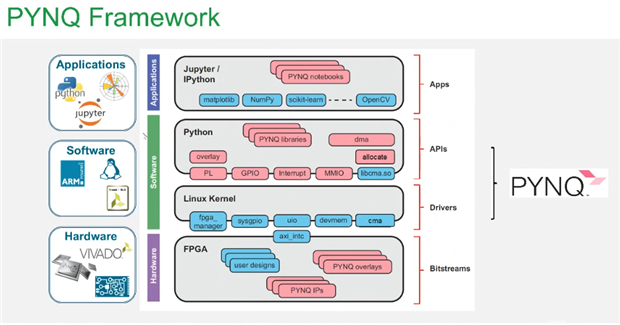

In the three part series on getting started with Pynq, the first lab saw us doing an introduction to the PYNQ plaftorm and the framework itself. It is interesting to see that the whole thing runs on Peta Linux and though for this lab we will be using Jupyter, there is also the option to dive into the shell using ssh and run python scripts directly.
The libraries expose a Python API for GPIO and programmable logic interaction. The overlays are actually bitstreams that will be executed on the configurable logic of the SOC and we will be using the Python API to pass data to and from these H/W blocks.

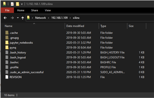

The Jupyter notebook can be accessed through the browser but that is not the only way to get in. The SSH daemon allows users xilinx and root in with the password xilinx [lower case all] and drops you into a bash shell. There you can install and upgrade to you hearts content. I hope to explore this more later.
The last way to access the PYNQ board is via the samba share. Essentially the code folders on the linux system show up as a windows network by

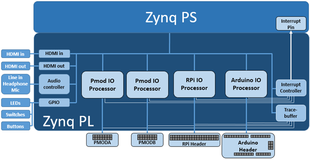

This block of base.bit along with all the config files that make it usable with the Python stuff is what is called an overlay. Here is a block diagram of what happens inside the base.bit
The Zynq PS is the Processing System or our ARM cortex A9 with Linux and Python where as the Zynq PL is the programmable logic part. It comes with stuff like GPIO blocks(which in themselves consists or registers and clocking systems and what not). I will dive into the code if I get a job but for right now this is as deep as I go. The docs say that they are running a Logic Control Processor  (prolly microblaze processor) for each of the PMOD and ArduinoIO subsystems.

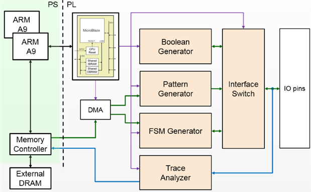

Logictools Overlay
The logictools overlay on PYNQ-Z1 includes four main hardware blocks:
  • Pattern Generator
  • FSM Generator
  • Boolean Generator
  • Trace Analyzer
A PYNQ MicroBlaze is used to control all the generators and analyzers.

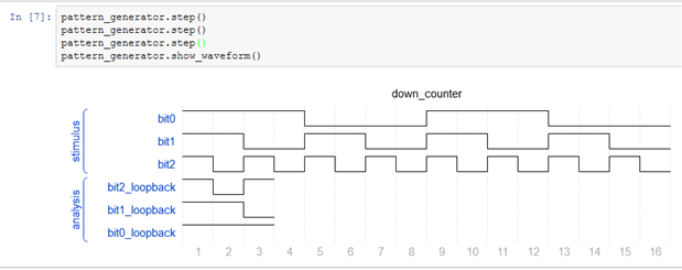

For the lab session we use the Pattern Generator to generate a pattern and then use the anaylsis tool to read them back into other GPIOS. I found the source-code for the module at https://pynq.readthedocs.io/en/v2.0/_modules/pynq/lib/logictools/pattern_generator.html and saw there were other functions. The step function run three times gave me the following output.
Also see: https://pynq.readthedocs.io/en/v2.5.1/pynq_libraries/logictools.html
This ran the system for three clock cycles which means that the system displays all the stimulus once and the analysis part is updated. This is good news if you intend to use it as a test bench of sorts. Not really CPU intensive BUT an experiment with the system none the less. You can also reset the system and run the same tests multiple times.
