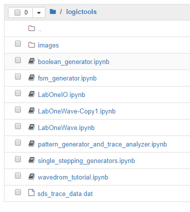

Here are the directories of the different example categories included:
The example notebook used in the lab is the board_btns_leds.ipynb.

Here are the logictools notebooks.  The ones with the "LabOne" prefix were ones created for use in the lab.
The first lab walked through using the base overlay to interact with the buttons and LEDs and using the logictools overlay to produce patterns on GPIO pins and then to feedback and capture those patterns on other GPIO pins.

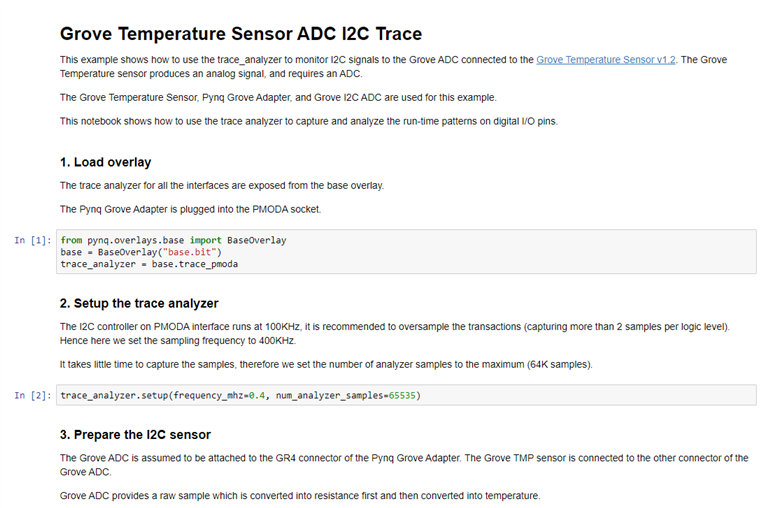

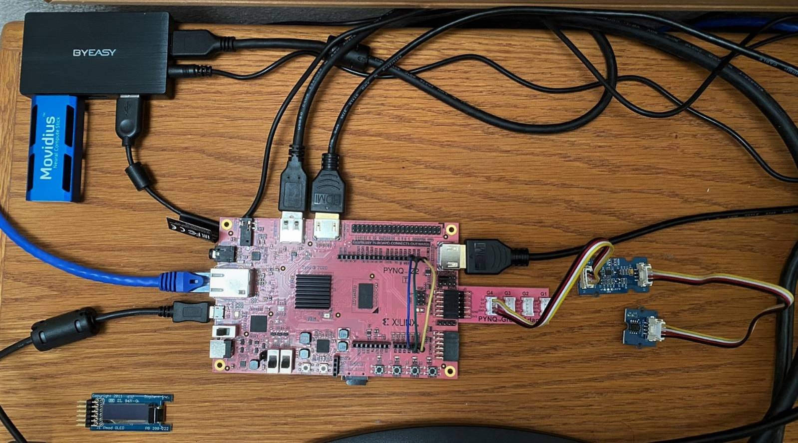

I thought that it would be useful to generate and capture an I2C transaction.
I couldn't think of a simple way to generate the initiator code using the logictools pattern generators, so I opted to just use one of the included hardware libraries.
There is an example of an I2C trace analyzer but it uses a PMOD_TMP2 temperature sensor and I don't have one of those.
I do have a Grove analog Temperature Sensor 1.2 which interfaces with a Grove I2C ADC.  I also have a Pynq Grove adapter board.  A picture of my setup with the ADC and tmp sensor attached to the Grove adapter on the PMODA port.

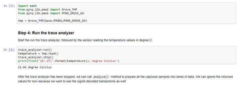

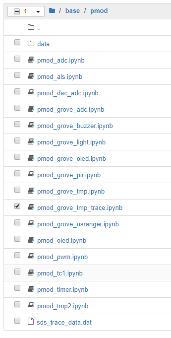

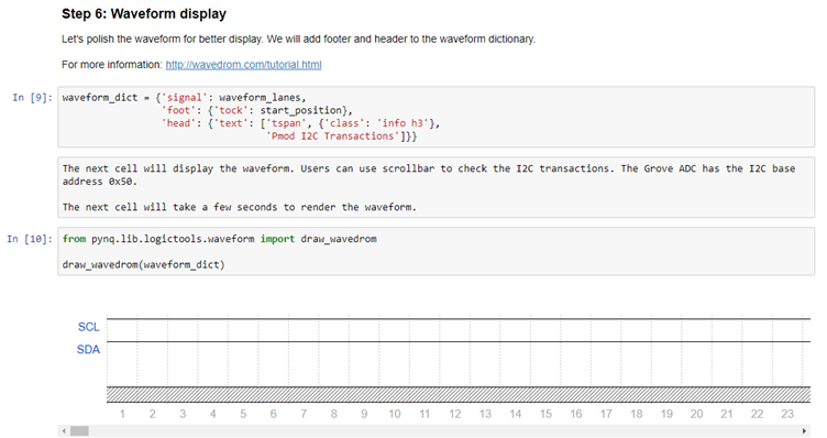

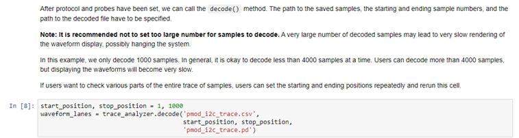

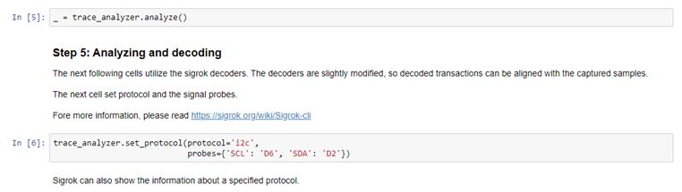

The PYNQ image includes a lot of libraries for different PMOD and Grove sensors and displays.  I decided to modify the one that matches my sensor and add the I2C Trace Analyzer.  The new notebook is shown below pmod_grove_tmp_trace.ipynb.

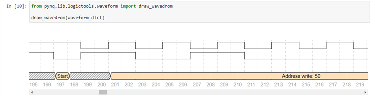

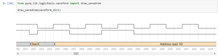

Display shifted to start of I2C transaction:
The start of the data read:

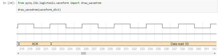

The initial read data byte:

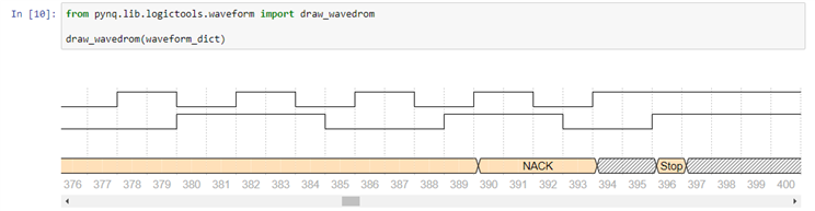

The end of the transaction:

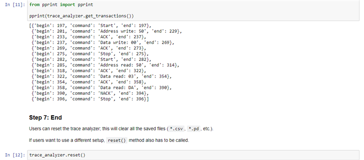

This data can also be printed as text:

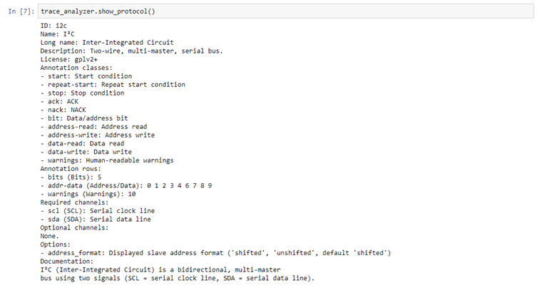

    I haven’t gotten around to looking under the hood but it seems that the pattern generator API is somewhat limited.  I’ll be interested to see what you discover.  I really like that the trace analyzer is protocol aware.
