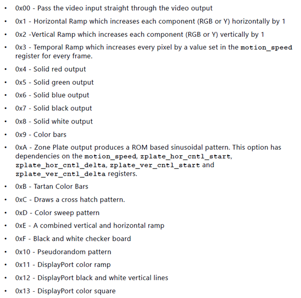

It can generate a number of interesting video patterns:

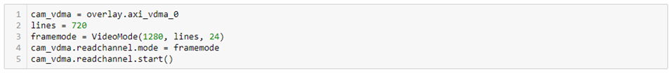

In the notebook there is a section to configure the VDMA element;

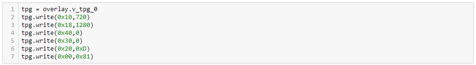

and to configure the TPG:

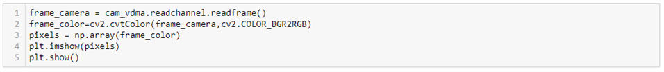

and to display it in the notebook:

The pattern is reconfigurable using the BACKGROUND_PATTERN_ID (0x0020) Register of the TPG.  The pattern size is configurable by programming the VideoMode in the VDMA and the ACTIVE_HEIGHT (0x0010) and ACTIVE_WIDTH (0x0018) Registers in the TPG.
Before you can reconfigure the pattern you need to stop the VDMA and TPG.
