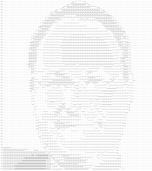

Just show me what Taylor waves are
And this is what the Taylor waves look like:
Now, I must admit I was a bit disappointed too, after looking through my code I found the bug.

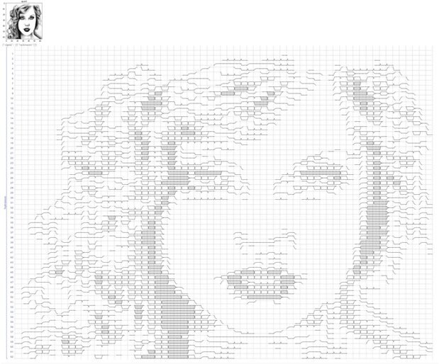

And now the beauty
Apply these changes:
#Load image
#im = cv2.imread('images/taylor.jpg')
im = cv2.imread('images/swift2.jpg')
Displaying the Taylor waves took 13.378.224 microseconds
So, now you know what Taylor waves are! Beautiful, aren't they?

I was surprised that displaying these 64 waveforms of 64 clockcycles took so long to render...
The waveform is actually an SVG.
I suppose the creation of the SVG is happening in javascript and this takes a long time.
So while it is very interesting to see some ouput of your design while you are programming,
it probably will not be as powerful as an Analog Discovery's output.
