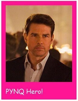

Usually face detection examples take an image and mark every detected face with a rectangle and call it a day. We want to do it bit differently. Say that our camera sees such image:
We want to detect the face, crop the image, and display it on a screen. This could be handy in surveillance system, temporary pass generators and more. Some inspection apps would behave similarly. So the example would be:
A camera and a display can be connected to a PYNQ-Z2 board but the display doesn't have to display image from the camera. We can use Pillow in Python to create an image file programatically and fill it with information based on processing we done with a frame from the camera:

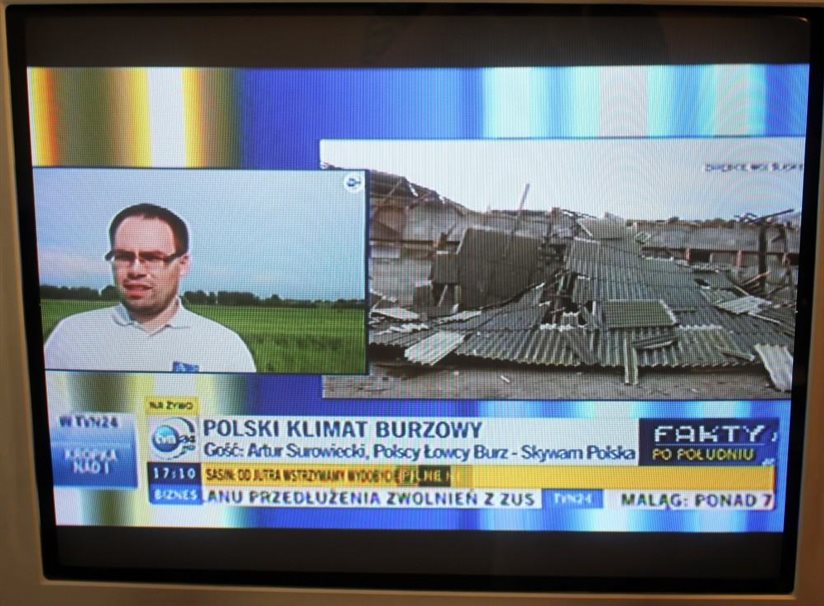

So when camera sees a face, when pointed at a TV:

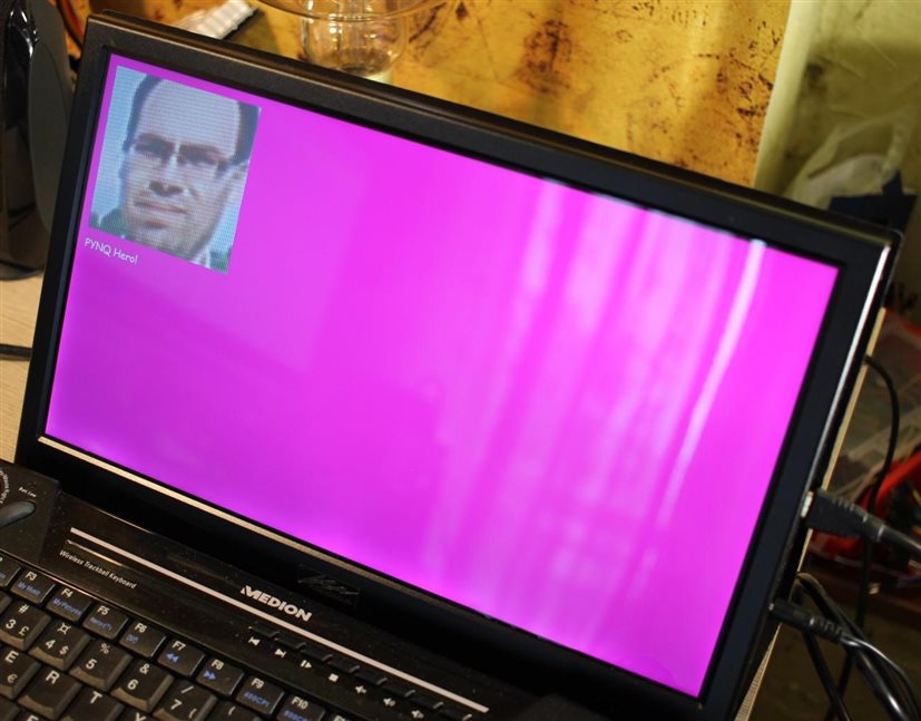

The HDMI output can be completely custom and listing detected faces:
Here Pillow is used to create a 1920 x 1080 image, colorized pink and then a cropped image of the face is placed on it. Final image is pushed to the HDMI output.
