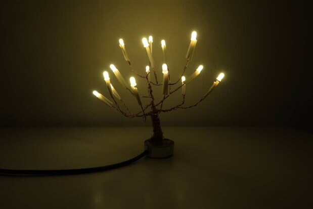

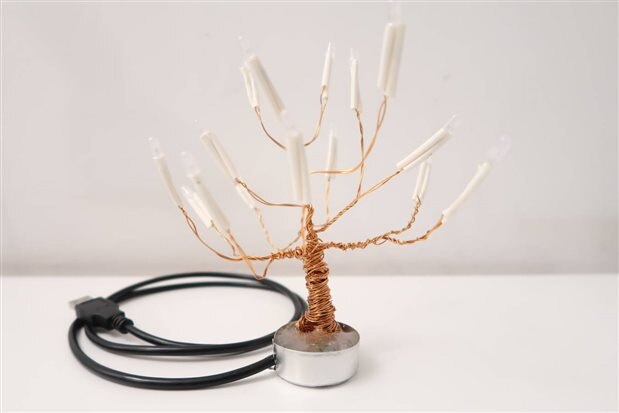

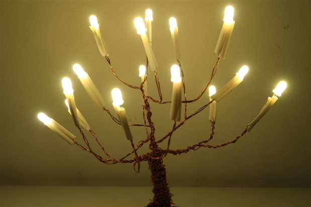

I would like to present a tree made from 15 white warm LEDs, winding wire and powered from USB. Each LED is soldered to two winding wires and protected by white heat-shrink tubing. I used this wires with LEDs it to form branches and trunk of tree. All LEDs are connected parallel and have a proper resistors to limit current for each. Tree trunk was putted to aluminium case from taken from candle and glued with hot-melt. It is really simple construction but final effect it is quite nice. Here are more photos:

    Nicely done video - really shows the project off
    shabaz over 7 years ago +2
    That's a very beautiful project! Clever use of enamelled wire. In fact clever use of all the materials, the tea-light base is inspired too. Also good use of the white heat-shrink sleeving, the light nicely…

    Shabaz, A great idea of using it for children to make. It has all the right ingredients for something great that they could make. I'll have to wait a couple of years for my Grandchildren to age but then…

    The ambiance that the light gives off is relaxing! I like how simple it is to put together.

    A great idea of using it for children to make. It has all the right ingredients for something great that they could make. I'll have to wait a couple of years for my Grandchildren to age but then it will be time to make one, or more.

    That's a very beautiful project! Clever use of enamelled wire. In fact clever use of all the materials, the tea-light base is inspired too. Also good use of the white heat-shrink sleeving, the light nicely diffuses into that!
    This would be a really nice school project.. kids could bring in an old USB lead to further save costs.

    Thank you. I think that using of a RGB LEDs should also improve final effect.
