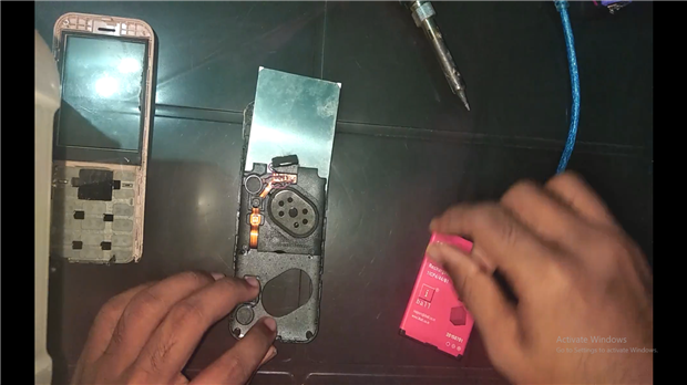

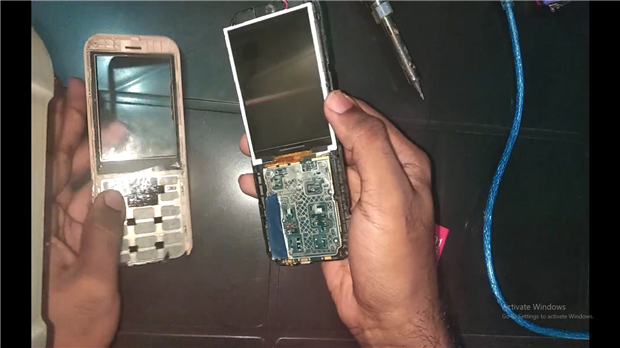

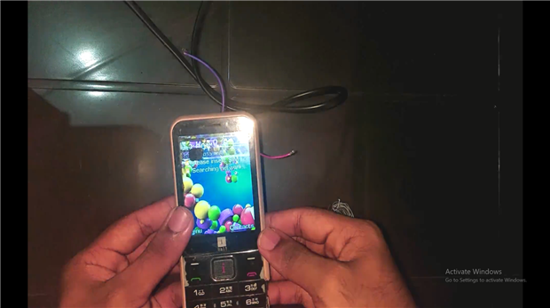

1.First of all take an old phone remove its back cover ,unscrew it ,remove the back layers go to the section where speaker and vibrator is placed .

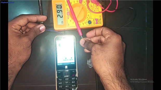

2.Take a multimeter connects its probe to the phones speaker/vibrator terminal. Turn the knob to DCvoltage on multimeter and check the voltage.you can see 0v.And give a call to the old phone from another phone you can see the voltage rises and drops.so if u give a call ,voltage rises hence this can be utilized for our job.

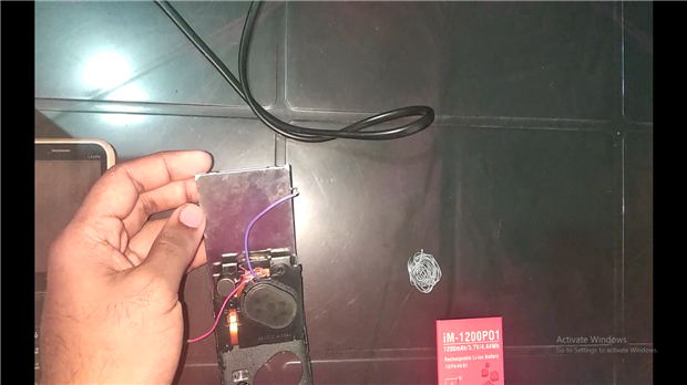

3.Now solder two wires across the terminals of the speaker the wires should have min length ,so that even if the phone back layers are closed ,the wires are available outside to tap the signal.
4.Now after soldering close the back layers ,
5.And again connect the multimeter probes to the two wires and give a call to the phone to check our soldering and connections are fine.

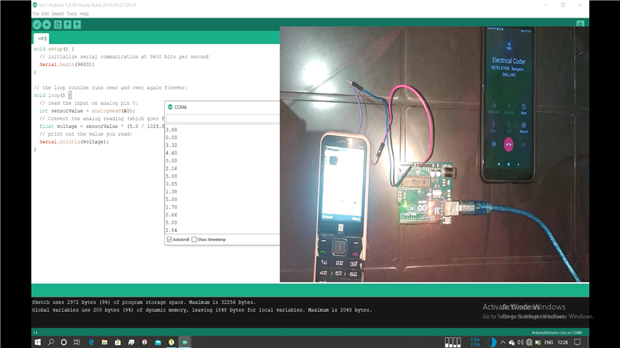

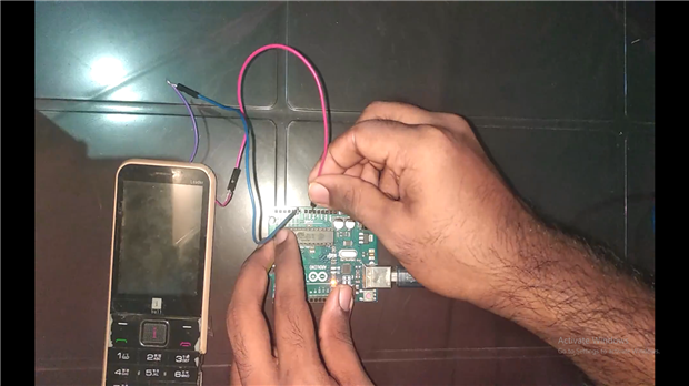

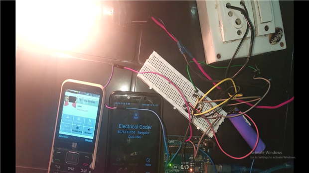

6.Now for easiness of the project we can use an Arduino for processing ,So we take an Arduino and connect its A0 pin to the positive terminal and Ground to the negative terminal of the wires
7.And take the example the program in ArduinoIDE for Analog voltage check and upload the program to the Arduino.And make a call to the phone and start the Serial monitor in the Arduino ide ,you can see the voltage outputs.

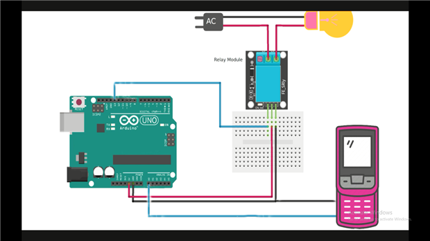

8.So our job is 90% done ,Now download and upload my code for Various device activations.Connect the device to P!3 on Arduino ,and by making changes in my code
you can put as many as devices as well as on any pins.Here is my code link-https://github.com/stijojoseph/oldmobile-to-gsm
9.you can can connect out of P0 to P13 pins in Arduino and connect relay and automate home apppliances  or devices as your wish
