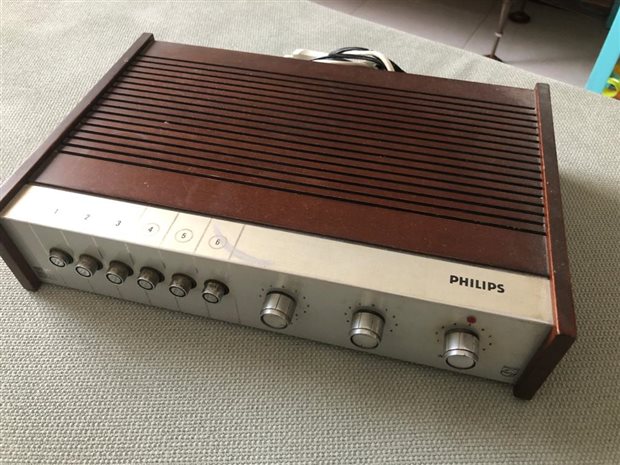

My idea is to repurpose this object, keeping it externally as similar as possible to its original form, as a wi-fi web radio player.
As this "wired broadcast" will become a "wireless broadcast", so "filo" (wired) will become "senza filo" (wireless). (Of course "wired/wireless" is referring to radio source).
The core of this new web radio player will be a Raspberry PI 3b+ provided by E14 after the first proposal of this project.
This really vintage looking object has taken place in my various houses in the last 30 years, mostly because it has a sentimental value to me (when I was a small kid it was my main music source) and also because I consider it aesthetically pleasing.
If you want one, it's easy to find on eBay (for example here).

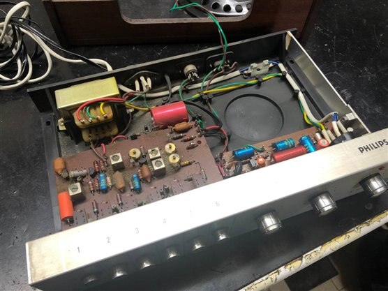

Opening it

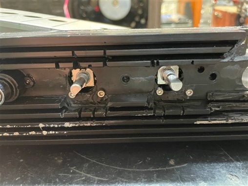

The bottom is in black plastic, while the top is fully made of wood. Let's unscrew and unmount the various parts:

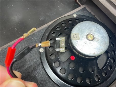

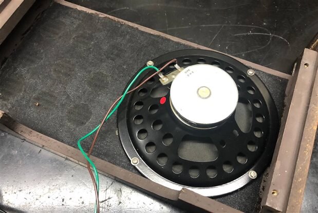

The speaker clearly states "8 ohm" in it, that will ease its interfacing. PSU is a 220 to 12V AC, guess I won't use it but if it still works I can save it for something else.

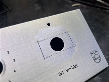

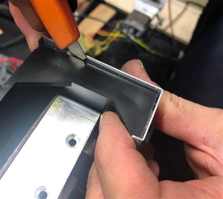

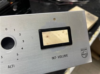

Removing the front aluminium needs cutting the bi-adhesive:

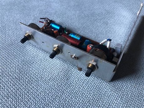

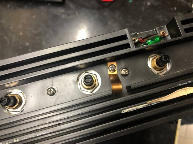

The first two potentiometers are for highs ("alti"), lows ("bassi"), while the rightmost one is used for power on/off and volume.

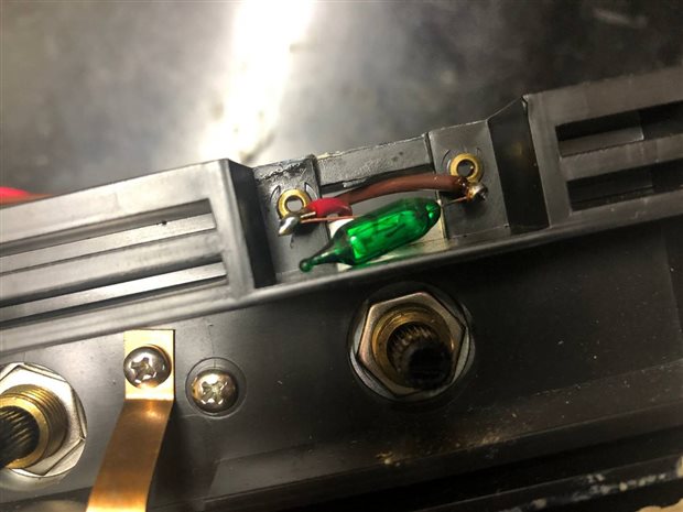

Two things are noteworthy: the metal lever that makes the pot simulate a switch (while the device is actually always powered on!) and the little "Christmas tree light" working as a pre-LED!
Note: obviously the lever was not in this position but horizontal, tangent to the pot knob neck (not visible here).

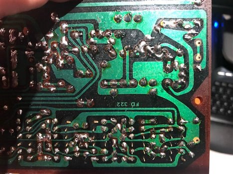

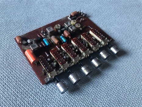

The PCBs and the soldered components are a masterpiece of vintage electronics technology.

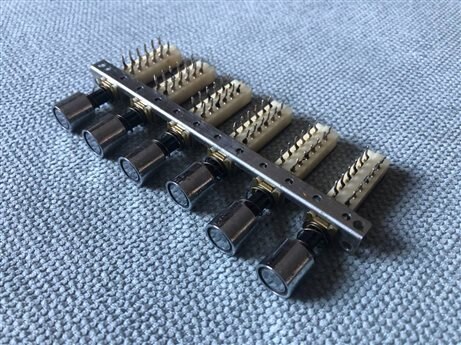

The 6 buttons are self-excluding by the use of a lever that disables the previous at the press of the new one. This is the real "radio button" that Apple introduced as a metaphor! After desoldering, this one will be very useful.
I won't, anyway, reuse the potentiometers (even if they are still working), nor the metal bracket that holds the PCB and pots.

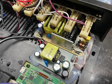

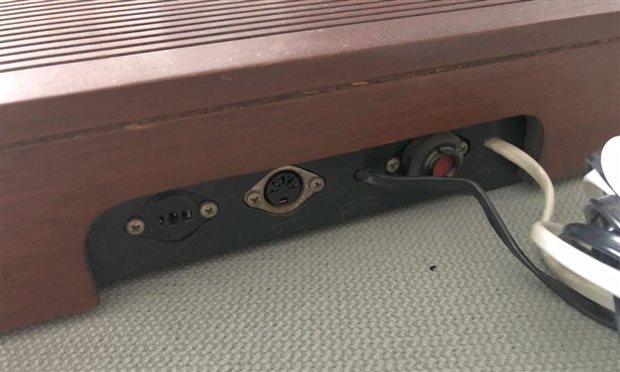

Finally, let's examine the connections on the back:
Two wires are coming out: the white one is for the AC and it will be reused, the other is for the phone line and there's no use for it.
The red object is a voltage changer, it allowed to switch between voltages (e.g. 100/220V). The leftmost connector is for the external speakers. I don't know about the middle DIN.
Just to end this first step, I tested the speaker by soldering a mono jack to the two poles. It seems to work!

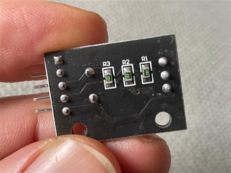

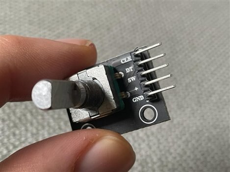

For the "knobs" I chose KY040 encoders with PCB and push button (foto).
The presence of the PCB is useful because it provides pins that are directly usable with Dupont cables, and pull-up SMT resistors.
Note:

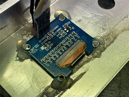

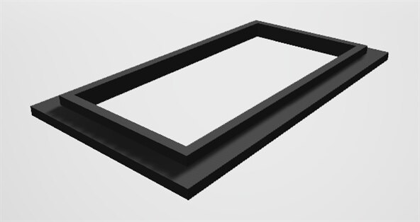

For the display, I chose an OLED 1.3" 128x64 pixel with I2C connection. There are also 0.9" displays very similar, but I think that a few millimeters more are better.
Some of these devices have SSD1306 controller, mine has SH1106. There is no real difference, as far as I know, if you use the right library to drive it.

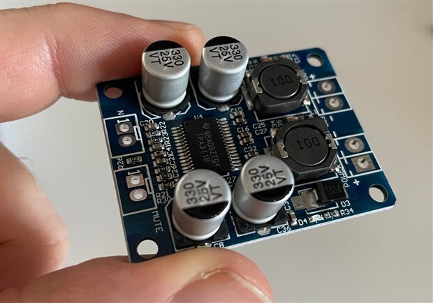

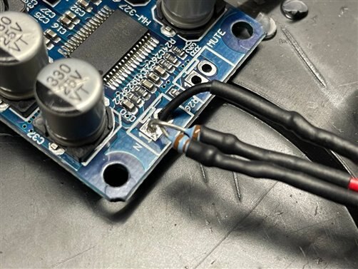

I chose this one, a tiny mono amplifier circuit based on Texas Instruments TPA3118 "30-W stereo, 60-W mono, 4.5- to 26-V supply, analog input Class-D audio amplifier" chip. It also sports an interesting "mute" couple of pins.

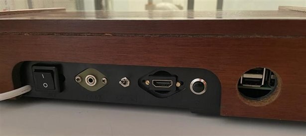

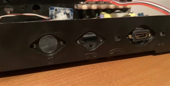

To replicate the HDMI port on the back, I just bought a short HDMI male to female extension cable.

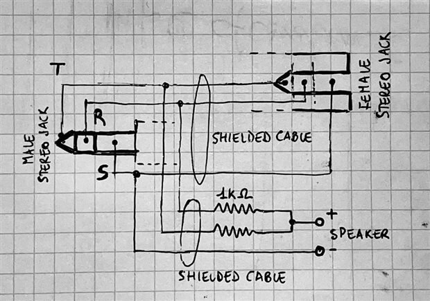

For the audio jack output, I built a Y shielded cable, with one branch repeating stereo output to a female 3.5 mm jack and the other summing the two channels to one by means of two 1Kohm resistors.

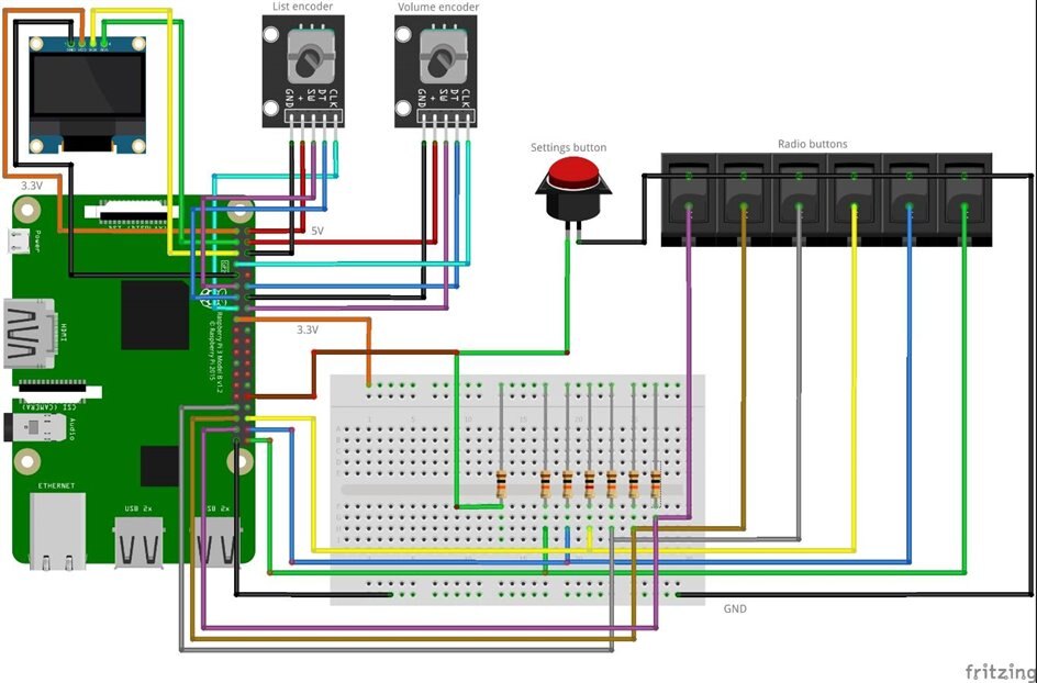

This is the final circuit with regards to RasPI. The two encoders use 5V while the display and pull-ups use 3.3V. The red push-button is used to activate the settings menu.

I decided to use the RPi library because it is rather straightforward to use. There are obviously other that are optimized for realtime applications, etc. but it's not my case.
Encoders and buttons
As it was my first time using these devices with the RasPi, I searched a lot on how to do it. The known main problem is debouncing the readings. There are various ways to do this, and I preferred a software solution to avoid adding circuits.
For the encoders, I found this article specific to KY040 type, and ported the Arduino code to Python, adapting some parts to better fit my needs. The idea is to verify all the possible states for the 2-channel reading (CLK/DT or A/B) and filter out the one that have no meaning. The result is more turning on the encoder but more precise forward/backward readouts.
For the buttons, I used interrupt callbacks also from RPi. The use of this functionality allows to avoid polling and also has built-in debouncing.
The interrupt is configured like this
GPIO.add_event_detect(list_sw, GPIO.FALLING, callback=list_push_callback, bouncetime=300)
where list_sw is the GPIO BCM pin number and list_push_callback is the procedure to be called for each FALLING state of the pin.
The push-button in the KY040 has already a pull-up resistor, while I had to add one for each preset switch and for the settings button, as you can see in the Fritzing circuit.

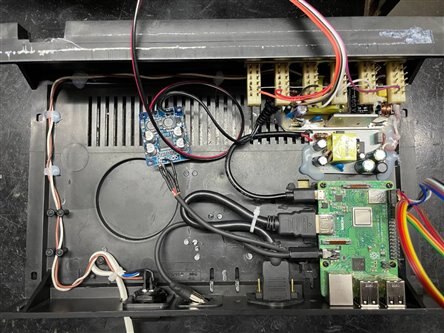

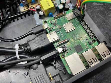

First things first. Gathering all the pieces to evaluate the internal disposition.
Both RasPi and the tiny amplifier needs to be powered. I bought a 5V-3A USB for the first, a 12V-2A for the other, and unassembled both by using a Dremel and a certain amount of violence ;-)
Only half the internal volume is available due to the presence of the big speaker. Moreover, I'd like to position the RasPi in a way I can make the USB accessible.
(yes, I used hot glue, and I can describe its color as "A whiter shade of pale")

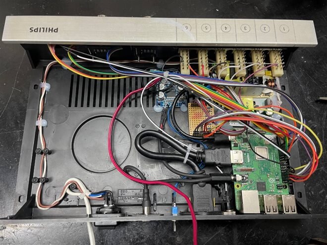

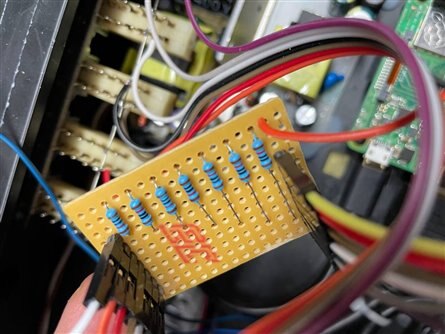

For the pull-ups of the preset switches and settings button I used a piece of stripboard:
Just a detail of the amplifier input: as you can remember from the audio Y cable drawing, two resistors are used to convert stereo to mono. Thermo-shrinkable tube is your friend.
You can see the two mute contacts. When closed, the amplifier stops output. So I decided to add a switch to use this feature. It is useful when you use the stereo plug on the back (directly connected to the audio jack, see previous drawing) to disable the internal speaker.
FASTON connectors are good to connect the speaker, in case I need to detach it temporarily.

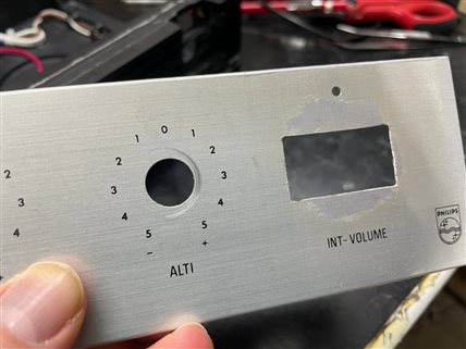

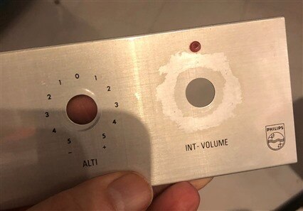

The silkscreen in the front aluminium panel was a bit ruined in the rightmost knob numbers, so I decided to clear them using isopropilic alcohol and make a blank space for the display.
{gallery} Front panel workout
I designed and 3d printed a small frame to mask the visible aluminium edge
I decided to use the small hole over the display to accommodate an internal activity LED. In practice, this LED substitutes the green light. See here how to do it.
So I connected this LED to GPIO pin 25, through a 330 ohm resistor. I glued both the LED and the display on the inside, after finding the right position with the display turned on.
To accommodate the display and the screws needed to block the encoders, I had to dremelize the front plastic, with no mercy at all.
The back panel allowed me to host the main power switch, the audio output, the HDMI output from the extension cable, and the settings button.
I also cut a hole with a cup saw to make one USB accessible. It was difficult to cut a better shape because of the combination of plastic and wood wall.
The final internal disposition... ehm... but I can assure you it is all working, look at the video below!
