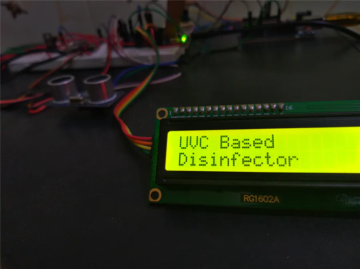

  • Interactive display

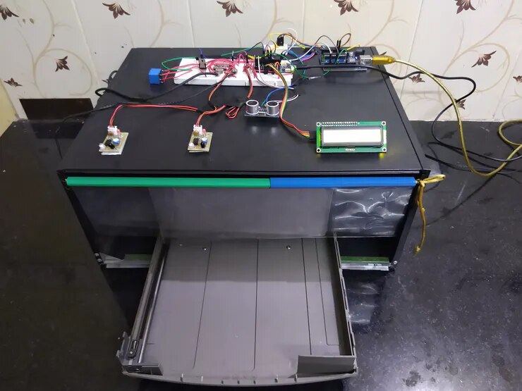

Step 2: Building the Case and Tray

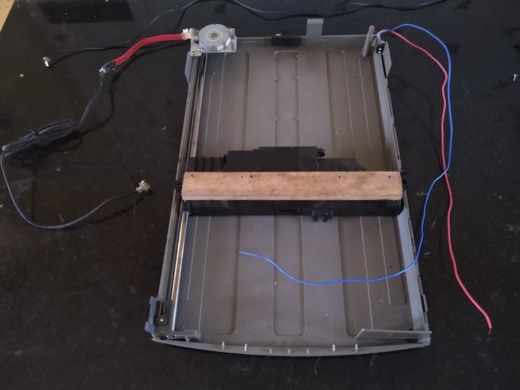

  • Dismantle the scanner and take out the lower part of the scanner that would have the scan head and the stepper motor attached with it. This would be used to take the items inside and outside the disinfecting machine.
  • Solder wires to the stepper motor, so that they're lengthy enough to connect to the breadboard.
  • Fix a limit switch at the end of the base, so that we can determine the position of the scan head while starting the MCU.
The base with the scan head of an old flatbed scanner, with the stepper motor and limit switch attached.

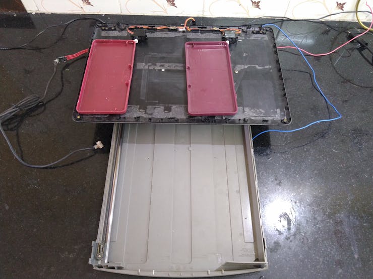

  • Remove the lamp that's there inside the scan head, you can re-use it later. Fix a firm base (tray) to the scan head. The things to be disinfected will be placed on the tray.
  • Now take the geometry box and separate the lid and the base. Attach these two to the servo motors, the servo motors will be used to flip these items.
  • Now fix the servo motor set up with the tray such that they can lift items and flip them. Make sure you use a powerful enough servo like a metal geared one, ex. MG90S servo.
  • Now mount the tray to the scan head. You should end up something like this:
The tray fixed to the scan head with the servo set-up
  • Remove the front part of the CPU case such that it's completely open in one side.
  • Now attach the lower part of the scanner with CPU case using screws. Drill holes if necessary.
The base and tray mounted to the CPU case.

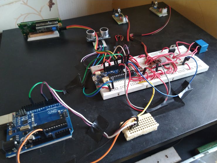

Step 3: The circuitry and sensors

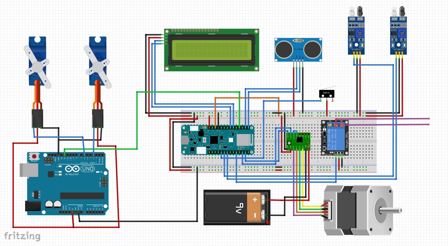

Schematic:
  • The primary Micro-controller board will be the Arduino MKR WiFi 1010, and the secondary Micro-controller board will be the Arduino Uno. Give the connections as per the circuit given in the Schematics section below.
  • Fix the IR sensor in front of the top panel and the ultrasonic sensor in the middle, the display should be in the corner and clearly visible to the user.
  • The UV-C light should be placed beneath the top panel, in a reasonable position such that max. amount of light falls on the items placed on the tray.
  • Test each and every part including the motor and sensor as you connect them to the MCU.
  • Make the wires connecting the servo lengthy enough such that it doesn't stop the tray from coming out completely.
  • The completed circuitry looked like this for me, but make the connections as neat as possible.
The finished circuit should look something like this
