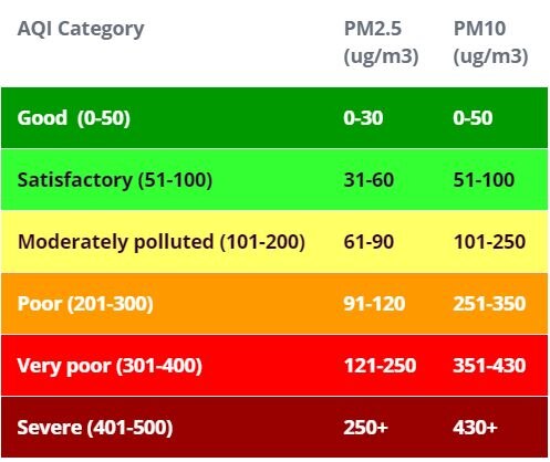

Note:- PM2.5 or PM10 data on online websites is represented as AQI or ug/m3. If the PM2.5 value is 100, then if it is represented as AQI then it will fall in the 'Satisfactory' category but if it is represented as ug/m3 then it will fall under the 'Poor' category.

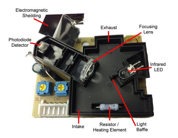

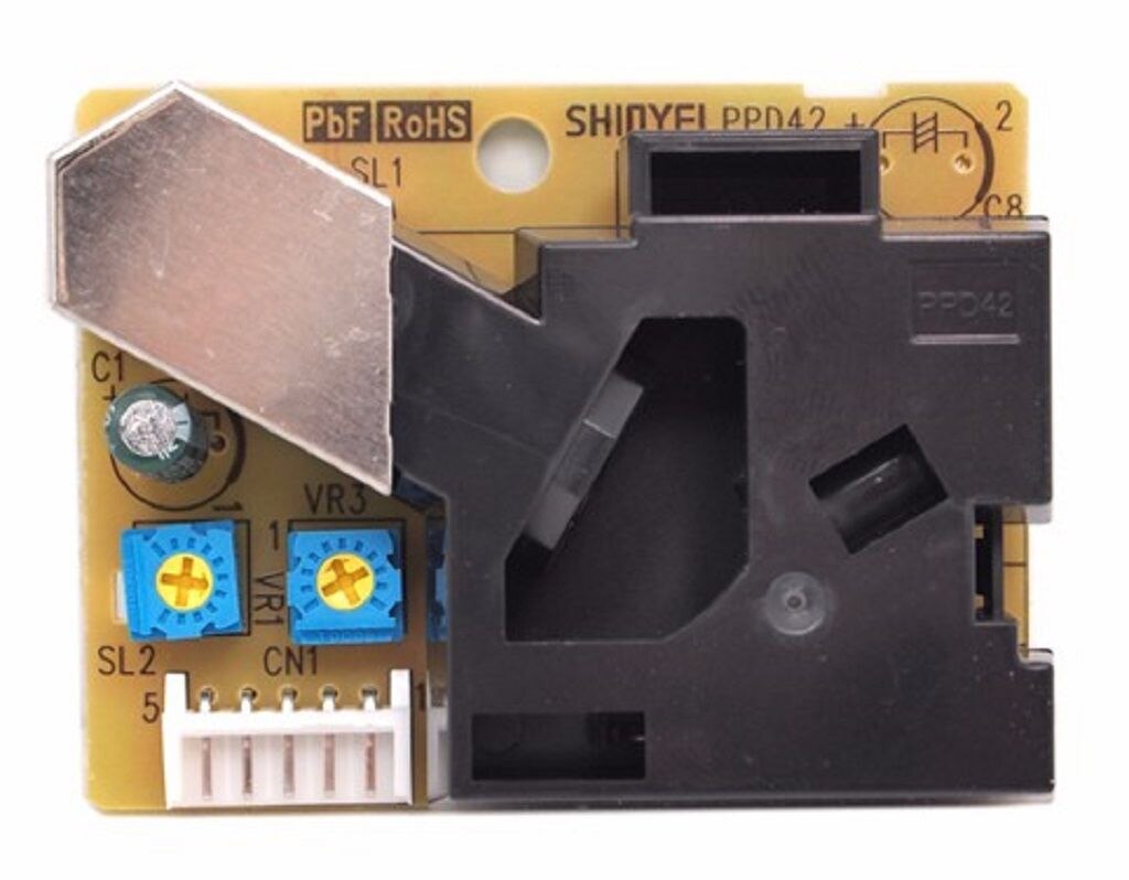

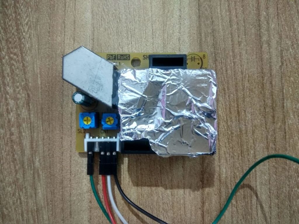

PPD42NJ Dust Sensor
Based on the light scattering method, it detects airborne particles continuously. Pulse output that corresponds to concentration per unit volume of particles can be obtained with using an original detection method based on light scattered principle similar to the particle counter.
Front side
On the front, it has 2 pots labelled VR1 and VR3 that have been already factory-calibrated. The IR detector is covered under the metal can. Interestingly there’s a slot by the side labelled SL2 which is unused.

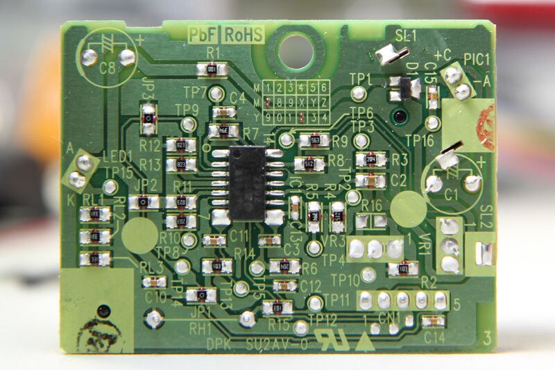

Back side
The circuit consists largely of passives and an op-amp. RH1 is the resistor heater which, in theory, could be removed to save power if there was some other method of air circulation.

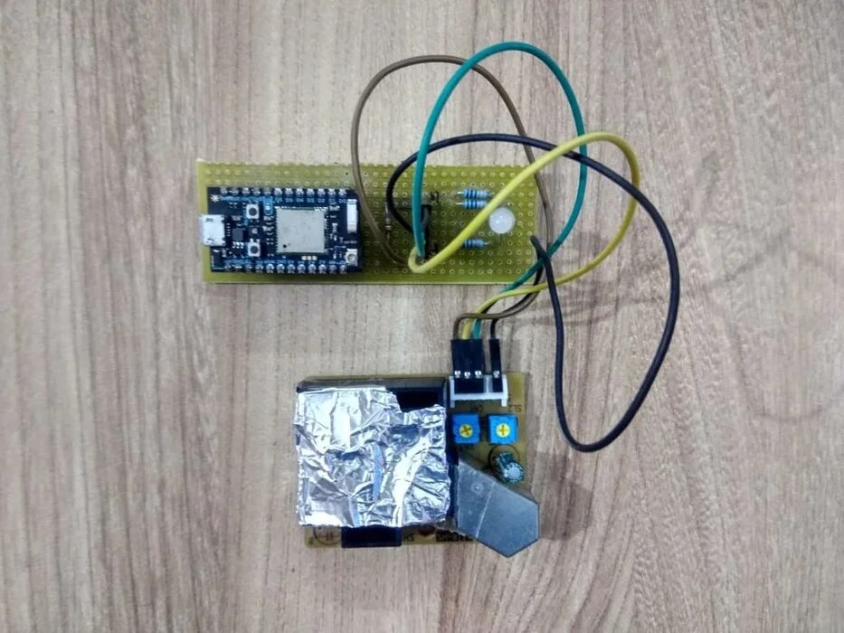

Sensor Placement (important)
There are several points that should be observed when deciding how the sensor is placed.
  • The sensor must be placed in a vertical orientation. Any other orientation would not achieve the desired airflow.
  • The sensor should be kept in a dark condition.
  • Soft cushioning material to seal the gap between sensor and housing is necessary.
Seal the gap using foil paper as shown below
The sensor output is normally high, but goes low in proportion to the PM concentration, hence by measuring what they call Low Pulse Occupancy (LPO), the PM concentration can be determined. This LPO is recommended to be measured over a unit time of 30 seconds.

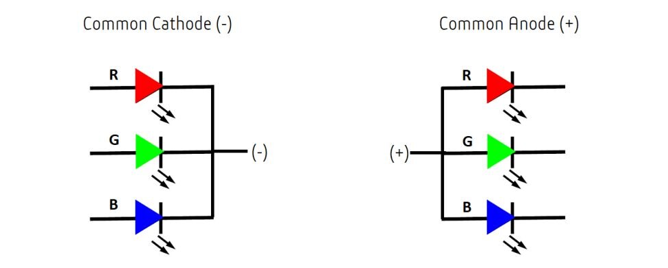

RGB LED
There are two kinds of RGB LEDs
  • Common anode LED
In a common anode RGB LED, the three LEDs share a positive connection (anode).
  • Common cathode LED
In a common cathode RGB LED, all three LEDs share a negative connection (cathode).

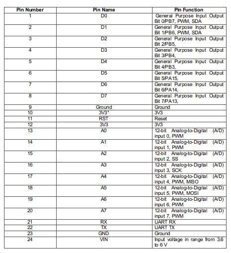

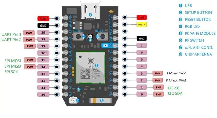

Particle Photon
Photon is a popular IOT board.The board houses STM32F205 120Mhz ARM Cortex M3 microcontroller and has 1 MB flash memory, 128 Kb RAM and 18 mixed signal general purpose input output (GPIO) pins with advanced peripherals. The module has on-board Cypress BCM43362 Wi-Fi chip for Wi-Fi connectivity and Single band 2.4GHz IEEE 802.11b/g/n for Bluetooth. The board comes equipped with 2 SPI, one I2S, one I2C, one CAN and one USB interface. It should be noted that 3V3 is a filtered output used for analog sensors. This pin is the output of the on-board regulator and is internally connected to the VDD of the Wi-Fi module. When powering the Photon via VIN or the USB port, this pin will output a voltage of 3.3VDC. This pin can also be used to power the Photon directly (max input 3.3VDC). When used as an output, the max load on 3V3 is 100mA. The PWM signals have a resolution of 8-bit and run on a frequency of 500 Hz.
Pin Diagram
Pin Description

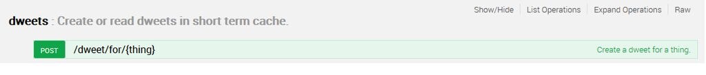

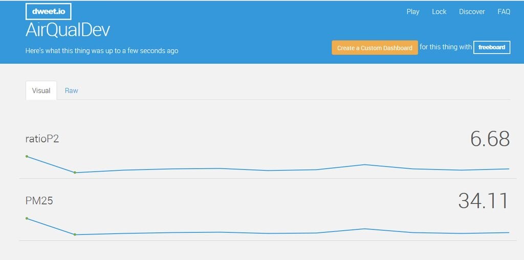

Dweet.io

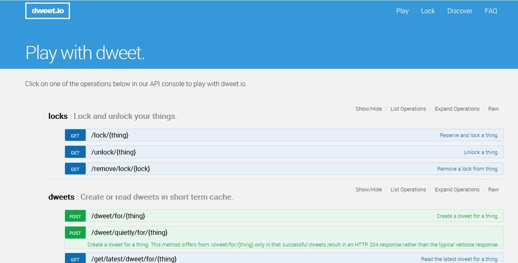

dweet.io enables your machine and sensor data to become easily accessible through a web based RESTful API, allowing you to quickly make apps or simply share data.

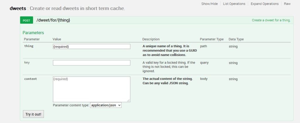

1. Go to dweet.io
2. Go to dweets section and create dweet for a thing.
3. You will see page like this. Enter a unique name of a thing. This name will be used in Particle photon.
Now, we are done with dweet.io setup.

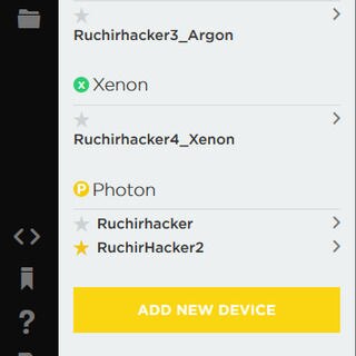

  • Open the app on your phone. Log in or sign up for an account with Particle if you don't have one.
  • After login, press the plus icon and select the device you'd like to add. Then follow the instructions on the screen to connect your device to Wi-Fi. If this is your Photon's first time connecting, it will blink purple for a few minutes as it downloads updates. It may take 6-12 minutes for the updates to complete, depending on your internet connection, with the Photon restarting a few times in the process. Do not restart or unplug your Photon during this time.
Once you have connected your device. Your device can store up to five networks. To add a new network after your initial setup, you'd put your device into Listening Mode again and proceed as above. If you feel like your device has too many networks on it, you can wipe your device's memory of any Wi-Fi networks it has learned. You can do so by continuing to hold the setup button for 10 seconds until the RGB LED flashes blue quickly, signaling that all profiles have been deleted.

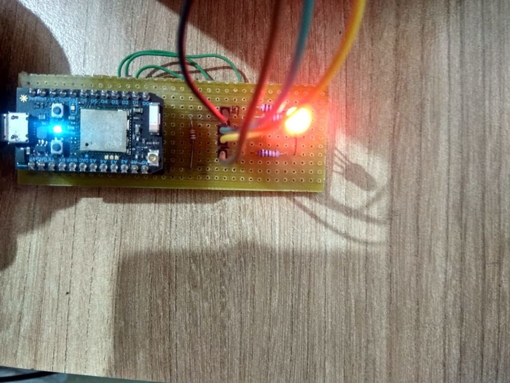

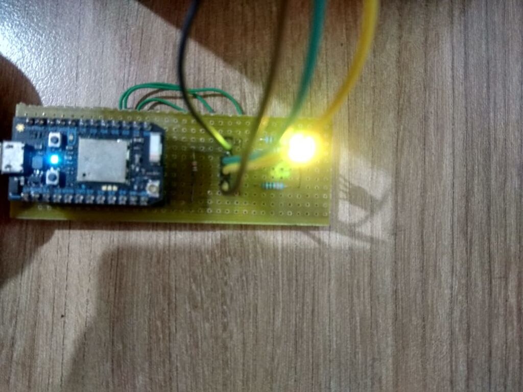

  • Cyan, your Photon is connected to the Internet.
  • Green, it is trying to connect to the internet.
  • Magenta, it is currently loading an app or updating its firmware. This state is triggered by a firmware update or by flashing code from the Web IDE or Desktop IDE. You might see this mode when you connect your Photon to the cloud for the first time.
  • White, the Wi-Fi module is off.

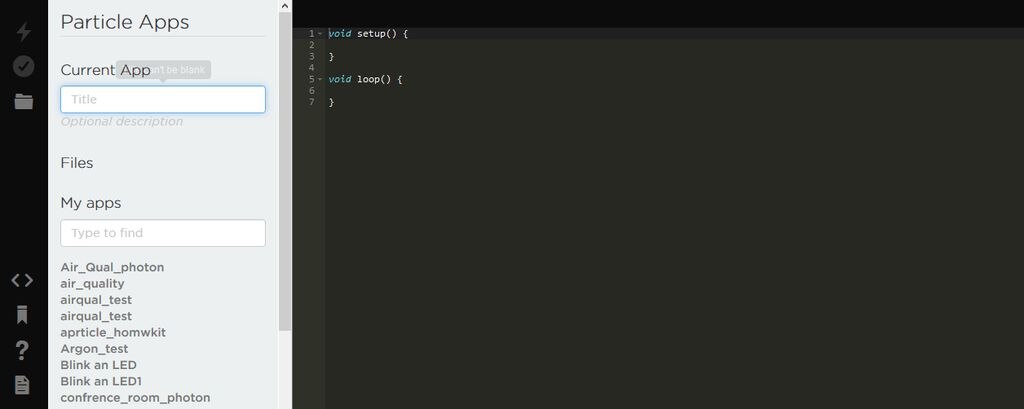

Web IDE

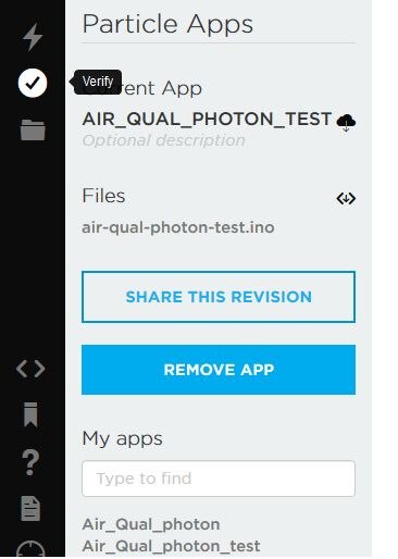

Particle Build is an Integrated Development Environment, or IDE that means that you can do software development in an easy-to-use application, which just so happens to run in your web browser.
  • To open build, login to your particle account and then click on Web IDE as shown in image.
  • Once you clicked you will see console like this.

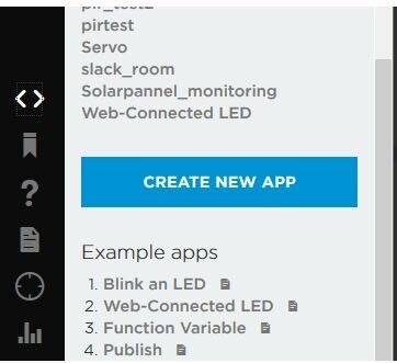

  • To create a new create app, click on create new app.
  • To verify the program. Click on verify.

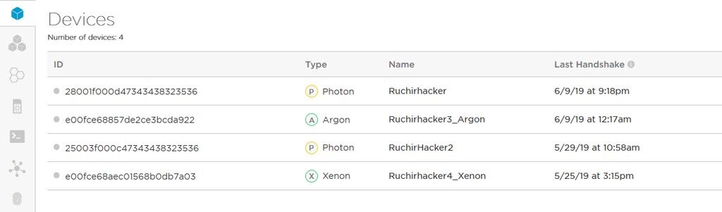

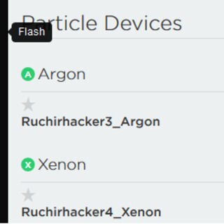

  • To upload the code, click on flash but before doing that select a device.If you have more than one device you have to make sure that you have selected which of your devices to flash code to. Click on the "Devices" icon at the bottom left side of the navigation pane, then when you hover over device name the star will appear on the left. Click on it to set the device you had like to update (it won't be visible if you have only one device). Once you have selected a device, the star associated with it will turn yellow. (If you only have one device, there is no need to select it, you can continue.

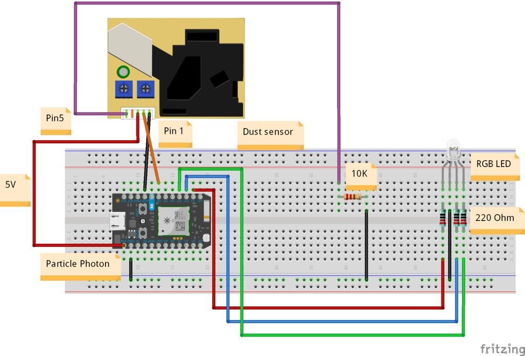

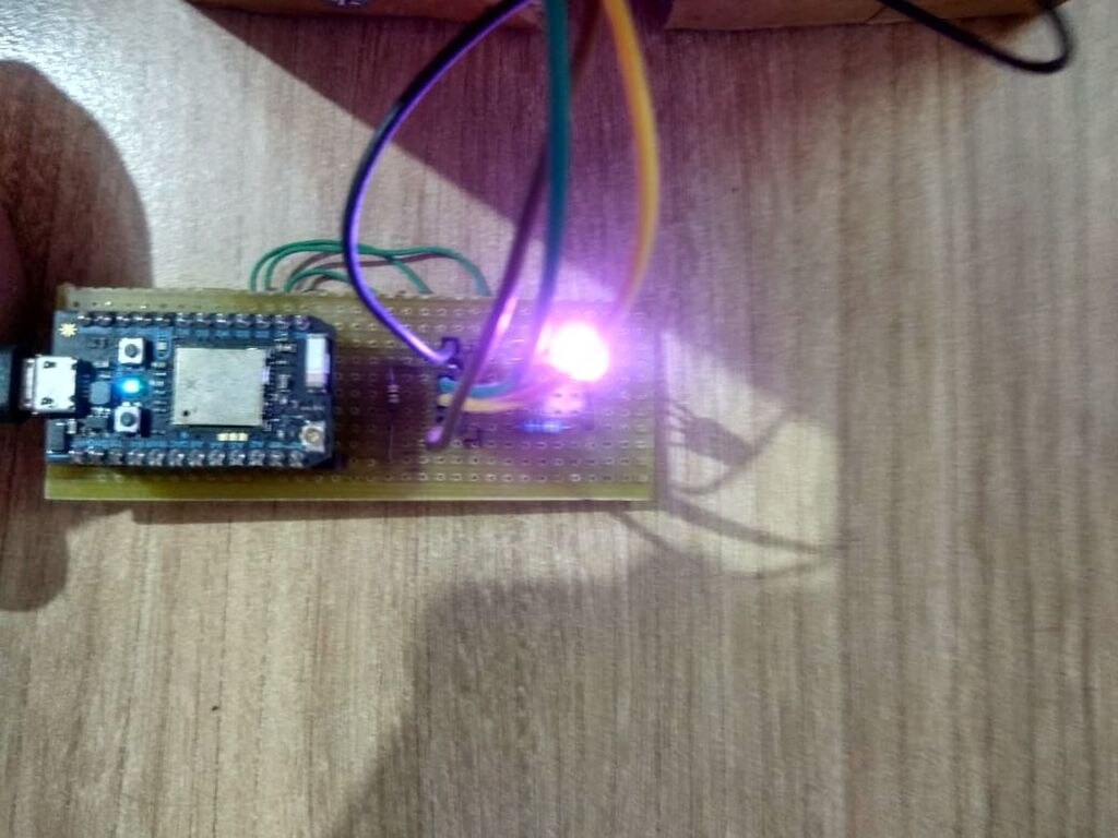

Connections
Particle Photon ==> PPD42NJ sensor (placed in vertical direction)
GND ==> Pin1(GND)
D6 ==> Pin2 (Output)
Vin ==>Pin3(5V)
GND ==> 10k resistor ==> Pin5 (Input)
Particle Photon ==> RGB LED
D1 ==> R
D2 ==> G
D3 ==> B
GND ==> Common Cathode

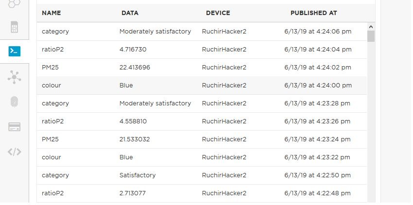

    Particle.publish("colour", String(colour));
    delay(2000);
    Particle.publish("PM25", String(PM25));
    delay(2000);
    Particle.publish("ratioP2", String(ratioP2));
    delay(2000);
    Particle.publish("category", String(category));
    delay(2000);
    // Starts the section that will publish the results to DWEET
    if (client.connect("dweet.io", 80))
    // Go to  http://dweet.io/follow/thingname  to see the results in your browser. change "thingname" to your thingname in the web address.
      client.print("GET /dweet/for/");
      client.print(THINGNAME);
      client.print("?ratioP2=");  // Don't use spaces for data names
      client.print(ratioP2);
      client.print("&PM25=");  // Don't use spaces for data names
      client.print(PM25);
      client.println(" HTTP/1.1");
      client.println("Host: dweet.io");
      client.println("Connection: close");
      client.println();
           // ends publishing to DWEET

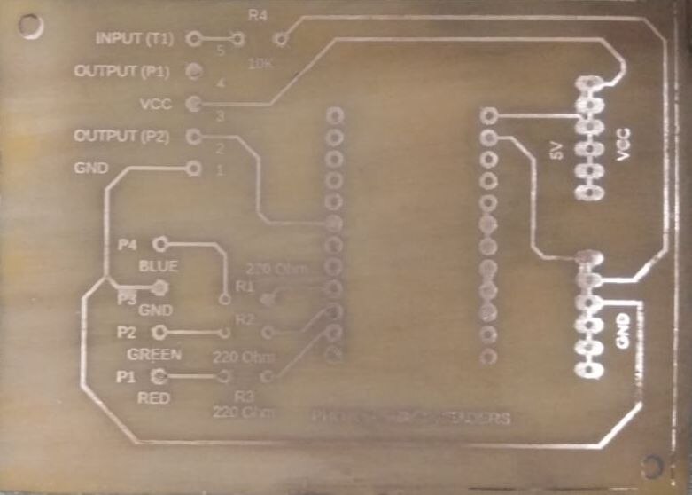

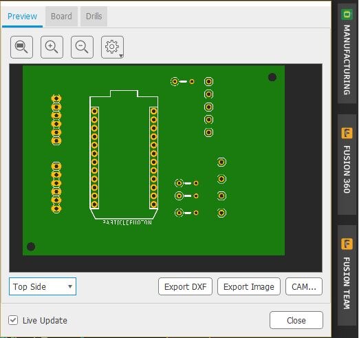

Result

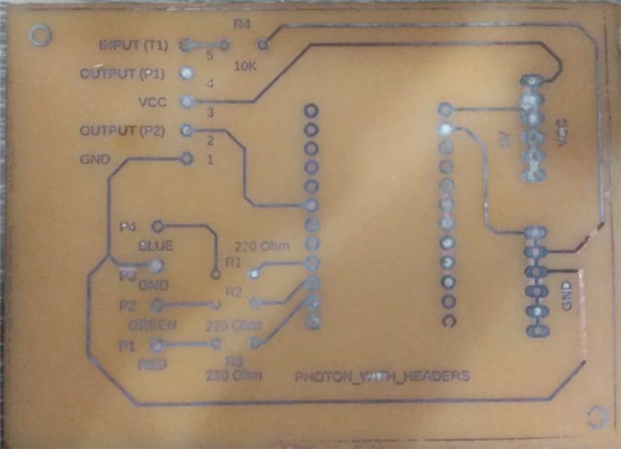

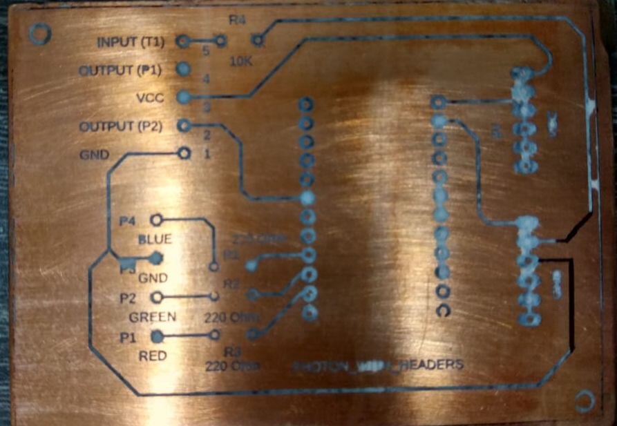

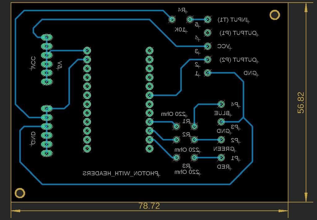

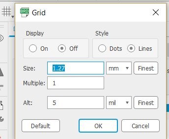

How to Make PCB in Eagle
What is PCB
PCB is a printed circuit board which electrically connects a set of electronic components by using copper tracks on a non-conductive board. In PCB, all components are connected without wires, all components are connected internally, so it will reduce the complexity of the overall circuit design.
Types of PCB
1.Single-sided PCB
2.Double-sided PCB
3. Multi-layered PCB
In this, I am only talking about Single-sided PCB
Single-sided PCB
A single layer PCB is also known as single-sided PCB. This type of PCB is simple and most used PCB because these PCBs are easy to design and manufacture. One side of this PCB is coated with a layer of any conducting material. Copper is used as conducting material because it has a very good conducting characteristic. A layer of solder mask is used to protect PCB against oxidation followed by silkscreen to mark out all of the components on the PCB. In this type of PCB, only one side of the PCB is used to connect different types of components.
Different Parts of PCB
1. Layers
Top and bottom layer: In the Top layer of PCB, all SMD components are used. Generally, this layer is Red-colored. In the bottom layer of PCB, all components are soldered through the hole and lead of components is known as the bottom layer of PCB. In this DIP components are used and the layer is blue.

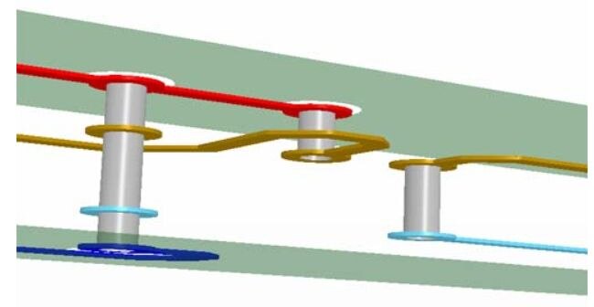

6. Via
A via is a plated hole that allows the current to pass through the board. It is used in the multilayer PCB to connect to more layers.
Types of Via

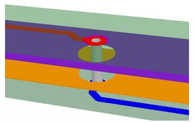

1. Thru-hole Vias or Full Stack Vias
When an interconnect must be made from a component that is located on the top layer of the printed circuit board with another that is located at the bottom layer. For conducting the current from the top layer to the bottom layer, a via is used for each track.

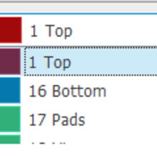

Green ==> Top and bottom soldermasks
Red ==> Top layer ( conductive )
Violet ==> Second layer. In this case, this layer is used as a power plane ( i.e. Vcc or Gnd )
Yellow ==> Third layer. In this case, this layer is used as a power plane ( i.e. Vcc or Gnd )
Blue ==> Bottom Layer ( conductive )

How to make PCB in Eagle
Make a schematic diagram

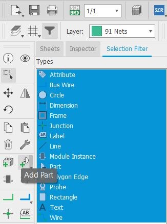

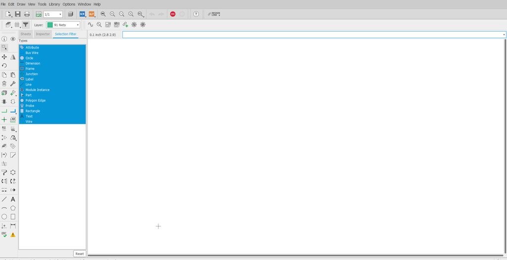

To make a schematic go to File ==> new ==> Schematic You will see a page like this

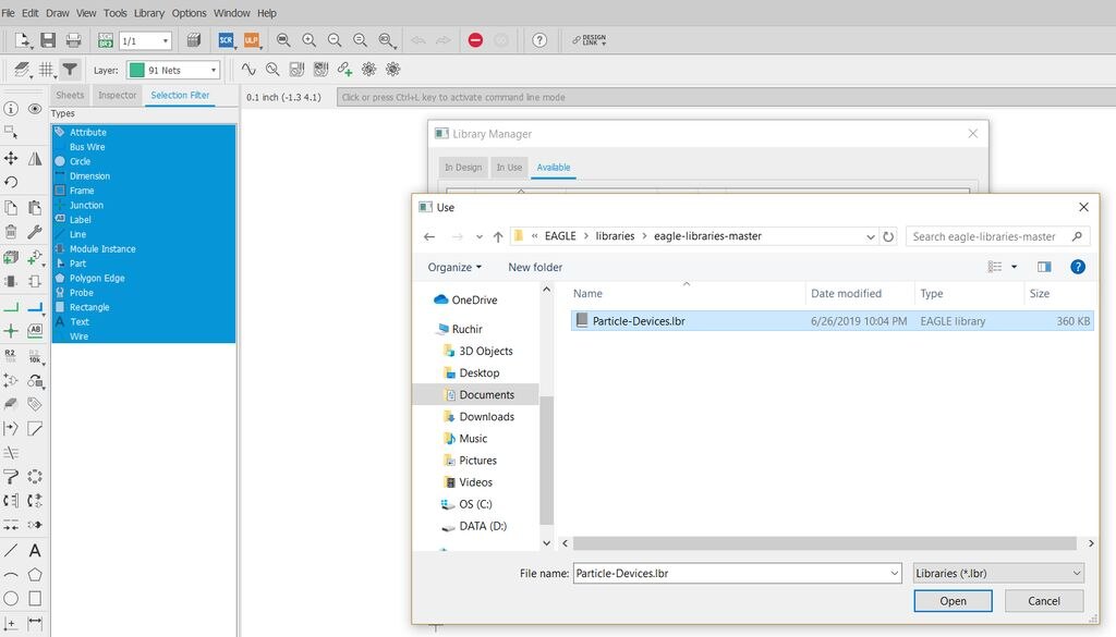

As there are no Particle parts so we have to add Particle devices libraries.
particle lib

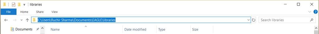

Next, after downloading it move it to the folder C:\Users\.....\Documents\EAGLE\libraries

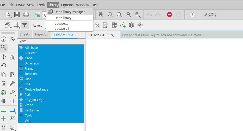

In Eagle open Schematics go to Library ==> open library manager
you will see a page like this, go to option Available and browse to the library particledevices.lbr
After opening it click on use
Now, we can see particle devices.

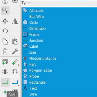

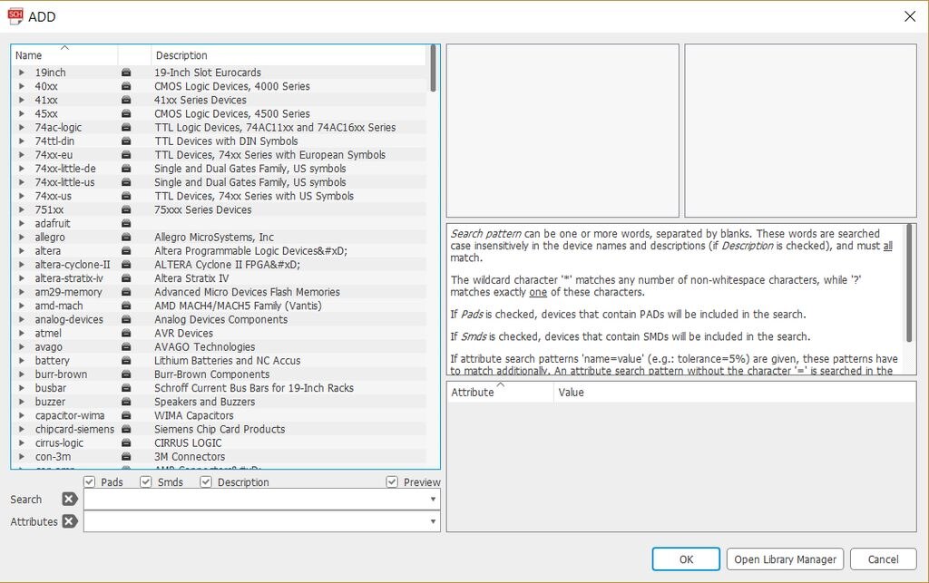

Next step is to make a schematic for that we use add part as shown in figure
When you click on add part you will see a page like this
The components we needed are Particle photon, headers, resistors, GND, Vcc. Search components in add parts
  • For a resistor, there are two types US and EU. Here I am using a European one
  • For header search header and you will see lots of headers choose according to yours.
  • For ground search gnd
  • For VCC search vcc
  • For Particle Photon search it
Once components are selected next step is to join it together for that you can use line or nets or both.
Join it as shown in the image below

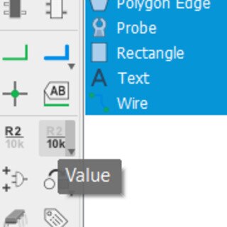

Next step is giving name and value.
For giving names select name and then click on the component to which you wanna give a name.
For giving values select value and then click on the component to which we want to give a name.
After that check ERC
Once checked we are done with Schematic. Next step is to switch to boards from schematics
After that assemble all the components as per your convenience. For joining the components use route airwire make sure you will use the bottom layer, the grid will be in mm and route airwire width 0.4064
After joining all the components Use mirror tool to generate an image of values and names.
For using mirror first select mirror tool and then values, names.
Next, save the board with any name, check DRC to check errors. If no error we are good to go ahead.

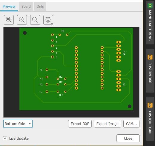

To see a preview of the board go to manufacturing.
Now we are done with the board part.

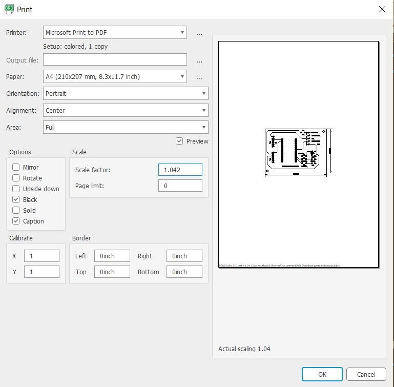

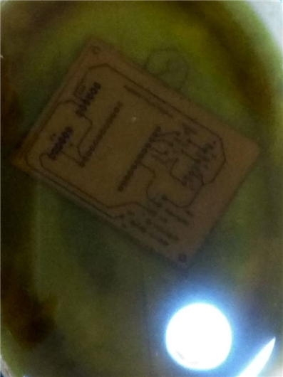

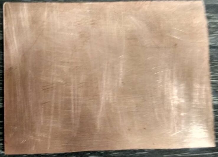

Next step is to print the ckt on glossy paper. For that click on print, you will see a page as shown below.
  • Select black in option, if you are using multiple layers then you also have to select mirror.
  • Select scale factor 1.042 After that save it to pdf or print it.
After printing the ckt,
1. Remove the oxidation layer from FR4 sheet using sandpaper (400) use a light hand.
2. Clean it using isopropanol or propan-2-ol or if you want you can use thinner also.
3. Place the printed ckt on FR4 sheet using paper tape.
4. Heat it using heating iron (5 -10 minutes) so that ckt will print on FR4 sheet. Soak board in water for 2-3 minutes. After that remove the tape and paper.
5. Place it in ferric chloride solution for 10 minutes to remove access copper then wash it with water.
6. Remove the layer using sandpaper(400) or Acetone.
