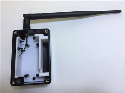

Well, I am running out of time to complete this project.  All the usual excuses, out of town guests and other distractions.  I am going to do well just to finalize all the construction by next week.  I did a test print of the component mounting bracket (insert) for my case and I quickly realized that I was going to have issues with the assembly.

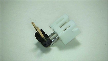

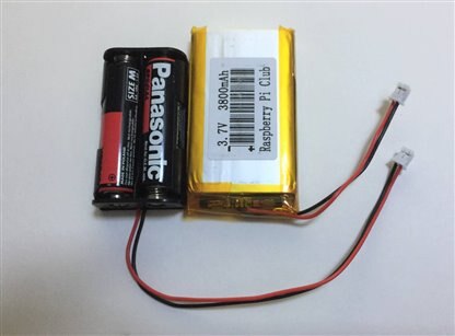

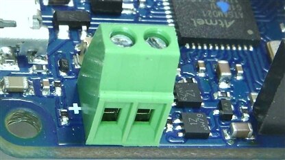

Issue #1 Battery Pack Connection

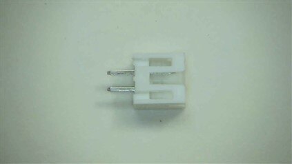

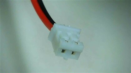

The battery pack that I'm using has 2 x AA batteries and a JST PH 2.0 connector.  The MKR 1300 has a terminal block interface for battery connection.  I could just cut the connector off the battery pack and use the bare wires, but I like the ability to quickly connect/disconnect the battery.  In lieu of a power switch I could just disconnect or reconnect the battery.  I decided to make an adapter with the mating JST PH 2.0 connector.  I wondered why they didn't just use that connector in the first place and I realized that standard 3.7V LiPo batteries use the same connector and their max voltage could damage the circuitry on the MKR 1300.  But this is a battery pack that is used with micro:bit boards which should have the same problem.  Then I noticed that the wiring of the battery pack has the connector polarity reversed from the LiPo.  If you plugged in a LiPo accidentally - the board wouldn't function but the diode in the battery path would prevent any damage.  So, I'm just going ahead and add the JST PH 2.0 connector.

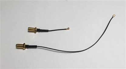

Issue #2 LoRa Antenna cable is too long
I wasn't considering the close quarters when I bought the antenna cable and at 17cm length it doesn't fit well in the case.  I found one that's only 5cm long and I just received it.
Issue #3 Connector locations required swapping GPS and Temp sensor board mounting
This was easy, I just moved the mounting screws.  Now the GPS is below the Temp sensor in the case.  Here is the printed insert in the case with all the mounting hardware for the PCBs and the mounted LoRa antenna.

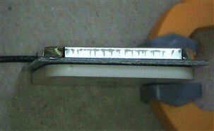

Issue #4 GPS Antenna is poorly constructed
The antenna that I got with the GPS was not anywhere near "square", so it was difficult to mount cleanly although it works fine.  I decided to try getting another antenna and it is constructed much better.

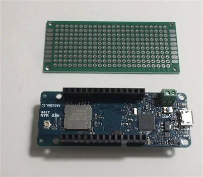

I need to make a plug-on shield that will interface the sensor wiring to the MKR 1300 IO connector.  I always knew that I would have to replace the jumper connector wires that I used for prototyping with something more compact.  I just didn't allocate the time to build it.  This is what I am currently working on.  Once I finish this, the assembly will be complete.
Here's the proto PCB that I'm using.  Before I wire the header and interface connectors I need to cut the board shorter so it doesn't cover the antenna jack, battery connector and reset button.

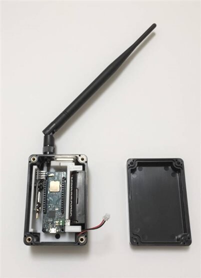

Completed sensor assembly minus the proto shield and sensor wiring.  Antennas are connected.  PCBs mounted.

    mp2100 over 7 years ago +2
    Aha, thank you for your good observation about the polarity of the JST connector. I bought a bag of JST connectors to solder onto my bare LiPo batteries and was annoyed to find that the red/black wires…
    Aha, thank you for your good observation about the polarity of the JST connector.  I bought a bag of JST connectors to solder onto my bare LiPo batteries and was annoyed to find that the red/black wires were reversed.  This explains it, it's made for a different device/voltage.
