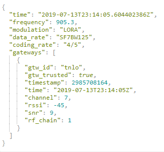

Gateway Data from TTN Console
Here is a sample data point:
The data of interest:
  • Frequency: 905.3 MHz which corresponds to Channel 7; the gateway continuously switches channels.
  • Data rate: To increase range and data reliability the gateway can trade off data rate and bandwidth (see spec below).  Spreading factor relates to the data rate.  The higher the spreading factor, the lower the data rate but the required RSSI is lower so the relative range is increased.  SF7BW125 indicates Spreading Factor of 7 and Bandwidth of 125 KHz.
  • RSSI: -45 dBm
  • SNR: 9 dB

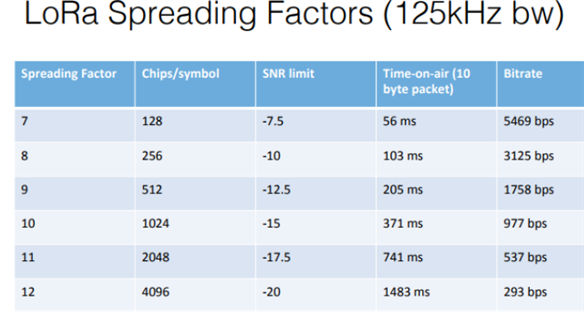

Here is a table that illustrates the effect of spreading factor:
You can see that a higher spreading factor can tolerate a larger negative SNR at the cost of bitrate.  You can also get range improvement by lowering the bandwidth, but for the Murata LoRa module used on the MKR 1300 - the lowest bandwidth is 125 KHz with spreading factors from 6-12.

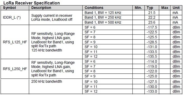

Murata module LoRa specification:
I currently planning to use adaptive data rate (ADR) which allows the gateway to adjust the spreading factor to increase the range as necessary.  For my test measurements I am going to use SF7BW125.

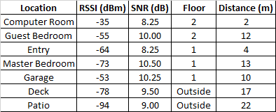

RSSI and SNR readings
Here is my test data:  The gateway is on the second floor at the front of the house.  The signal loss doesn't correlate directly to distance because of the intervening structure of the house.  The data point are averaged across different frequencies (channels).

    Hi Ralph,
    Interesting information and data.  It looks like you ample margins in RSSI with your current setup.  I look forward to your future updates to this project.
