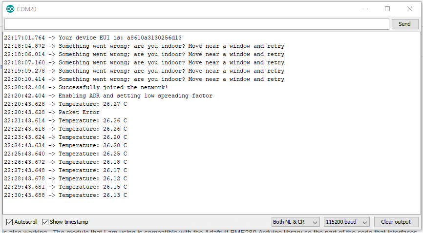

I decide to test the temperature sensor code using my second MKR 1300 so that I could verify that it is also working.  The module that I am using is compatible with the Adafruit BME280 Arduino library so the part of the code that interfaces to the sensor is straightforward.  Then I needed to format the data for transmission to the TTN interface and also write a payload decoder for the data when it is received at the TTN console.
I should note that I'm still having some difficulty getting the devices to connect to TTN reliably.  Once I get connected everything works well but whenever I go through a program update cycle it takes multiple tries to reconnect.  Very frustrating in the development cycle.  The double reset that I thought was helping was just a 'red herring'.  It just coincidentally worked a few times in a row, but it really doesn't work consistently.  I've added a loop that attempts to connect for 10 times before quitting and that helps but doesn't completely solve the problem.  I tried changing connection modes from OTAA (over the air activation) to ABP (activating-by-personalization) but in ABP mode I don't see any traffic on my gateway even though the joinABP function returns a value indicated that I'm connected.  And I don't receive any data in the TTN console.  I probably don't have something set up correctly for that mode.  I have seen some references in forums that it may be the MKRWAN library that has issues.  I probably have to live with it for now.
Once I get connected things work fine.
Here's a log from the serial console on startup:

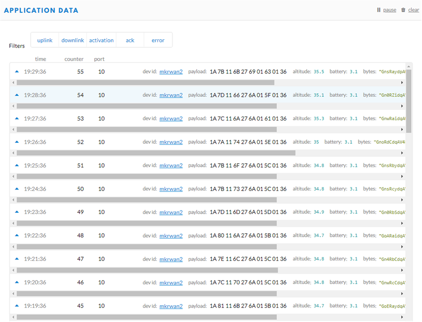

Here is a screenshot of the data in the TTN console:
And a closer look at one of the decoded JSON data packets:
