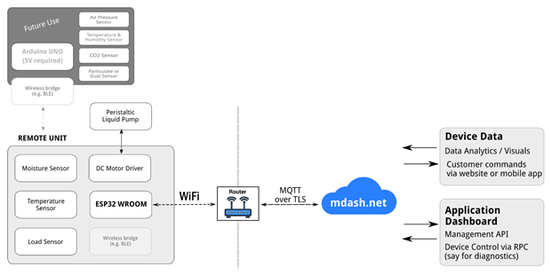

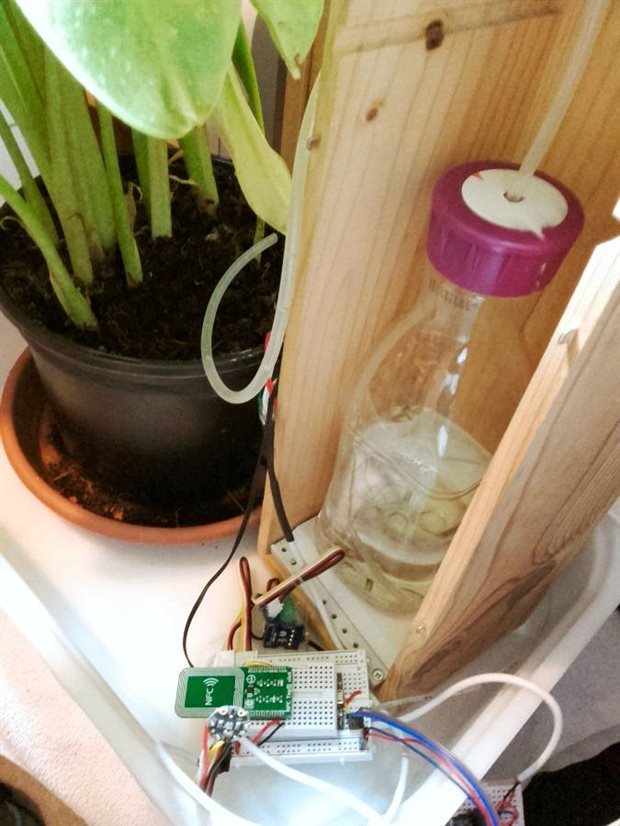

New Remote Unit

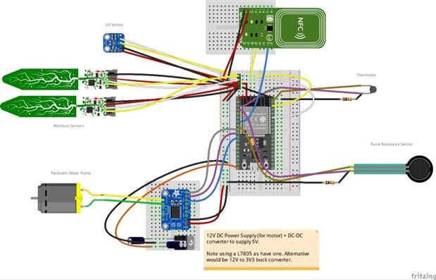

The new remote unit has quite a changes.
For the MCU I'm using an ESP32 WiFi module. This links in with the MDash cloud platform.
I added in an NXP NTAG I2C Plus module, as I personally think this is the best way to provision WiFi hands down. None of this scanning for Access Points and manual SSID/Password entry required.

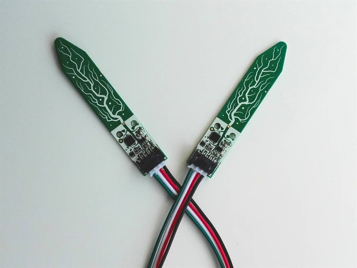

I swapped out the old corroded moisture sensors for capacitive based moisture sensors. The ones I'm using are from Adafruit. These are I2C based as use a microcontroller. The nice thing is that they have made provision for 4 I2C addresses, which comes in handy as I wanted one remote unit to handle two plants. If I needed to use more, I found these ones, from DFRobot, online which provide an analog output.
For this prototype, I am testing the use of two sensors per pot, in the following configuration as I wanted to see how much moisture levels differ between near the soil surface and at the bottom of the pot, where the roots are. My hypothesis is that you are not too concerned about horizontal moisture variances it is more about the vertical changes. Time and data will determine if this is relevant or not.
Then for the motor driver, I decided to use the TP6612 as can handle 12V for the motor and will happily drive two water pumps which require 200mA each. I am using a breakout board from Adafruit.

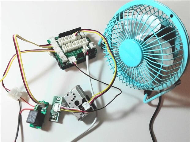

    I just had to put this one to bed... Here is my environmental sensor unit set up. It is now a standalone unit and uses the BLE Environmental Sensing Service with some added customised characteristics.…
  • BigG
    BigG over 7 years ago

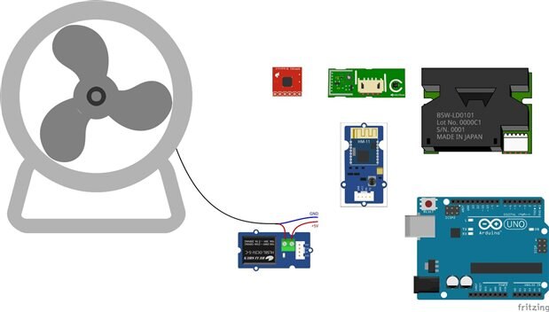

    When I started out on the "feature creep" part, I was scratching my head as to which would be the simplest BLE module to use with my Arduino UNO, when the solution was sitting right under my nose in a box, looking all forlorn. It was the now defunct Arduino 101. And boy oh boy, it worked a treat and so much simpler than say trying to use the ESP32 BLE Arduino libraries, which don't use the correct terminology and are way too over complicated, memory/resource hungry and crash far too frequently (all classic signs, in my opinion, that the competent code writers did not fully grasp the BLE spec).
    The fun part of the project, was including a characteristic for a small USB (5V) fan. I have options for the remote turning on and off of the fan and for auto mode, which triggers every time the sensors are sampled (the idea is to raise a bit of dust with the fan on in order to measure dust particulate concentration).
