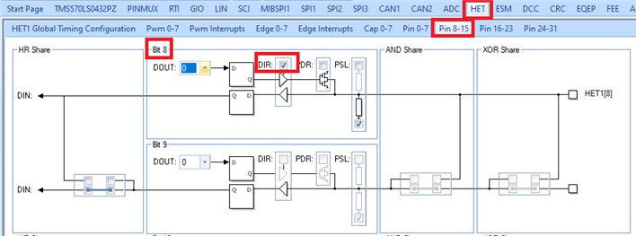

Second Project: Hercules LaunchPad Design
I used this one first, before making the Aruino design, to test my own turntable. The LaunchPad comes with two bright white LEDs ad needs no additional components.
(the full code composer studio project with config and sources is attached to this blog)
The software is in essence the rtiBlinky example (real time clock) for that board. But in the interrupt of the RTC, I toggle the two LEDs.
I've doubled the speed here, compared to the Arduino example, because of that toggling.
To blink a led at 100 Hz, you have to toggle it at twice the speed (because one toggle lights it up, the next toggle dims it). That means 200 Hz, or 5 ms:
The interrupt for that RTI is enabled:
.. and the two pins with connected to the LEDS (GPIOA.2 and HET1.8) are defined as outputs:
The drivers for GIO, HET and RTI are set:
In the code, we enable the interrupts and init the modules:

In the RTI interrupt, the LEDs are toggled.
void rtiNotification(uint32 notification)
  gioToggleBit(gioPORTA, 2);
  gioToggleBit(hetPORT1, 8);
That's it. You cans see the effect on the photo in The Theory chapter.
