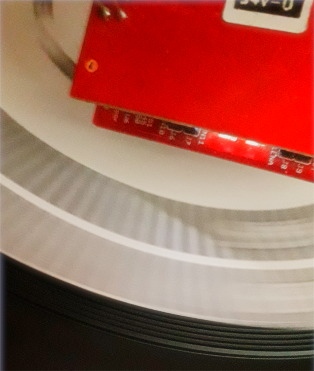

Here you can see the effect of using my design on a turntable. You can see that the inner circle appears to be standing still.
That's because its dots are placed for 45 RPM, and for a 100 Hz strobe.
I'm strobing the LEDs on the LaunchPad in the photo at 100 Hz.

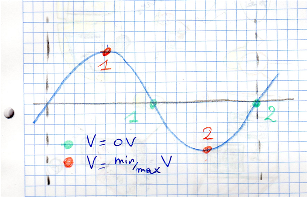

Let's assume 50 Hz in this explanation. That's the same frequency as used in this project, where ever you use it, anyway.
The 50 Hz mains is a sinusoidal signal. It goes to max/minimum twice fer cycle. And through 0 twice per cycle too.
That means that at 50 Hz, the light will be brightest 2 times per cycle, and dimmest 2 times too.
So it blinks 2 times per cycle. That means 100 blinks per second in a 50 Hz situation. That is a blink frequency of 100 Hz.
So we'll have to build something that blinks 100 Hz.

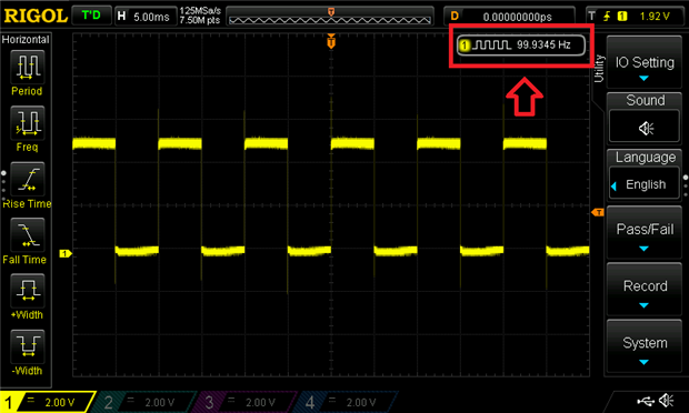

Precision?
Well, in the past they used the mains frequency to control the speed. That's never been ultra-stable over short periods.
So our designs here for the Arduino UNO and the LaunchPad, both are "good enough", both between 99.93 and 100.04 Hz.
I use hardware timers in both designs, so interrupts have no lasting effect.
In fact, the Arduino is a little bit bette than the Hercules in my design, because I connected a LED directly on the timer output pin.
Whatever happens with that controller, the tick will be ticking accurately.

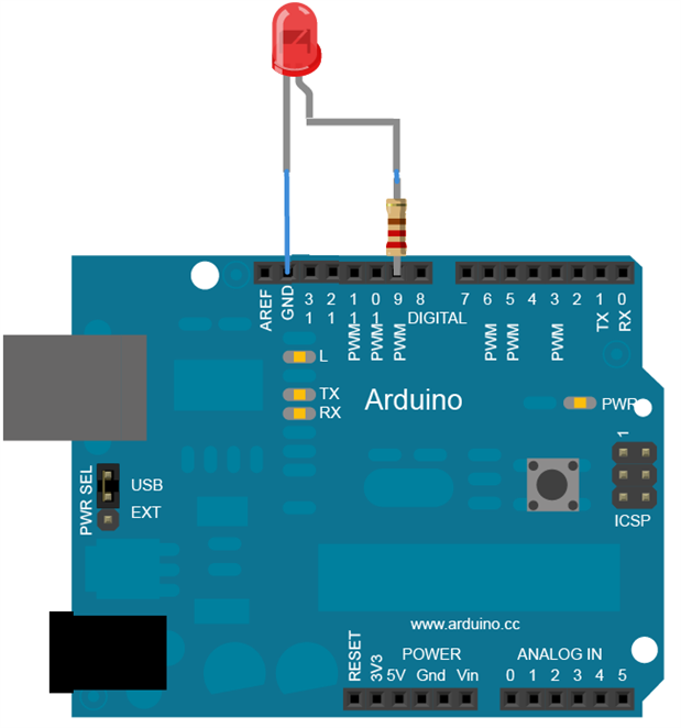

Wiring for Arduino
Very simple. An LED with a 330 Ohm resistor between digital 9 and GND.

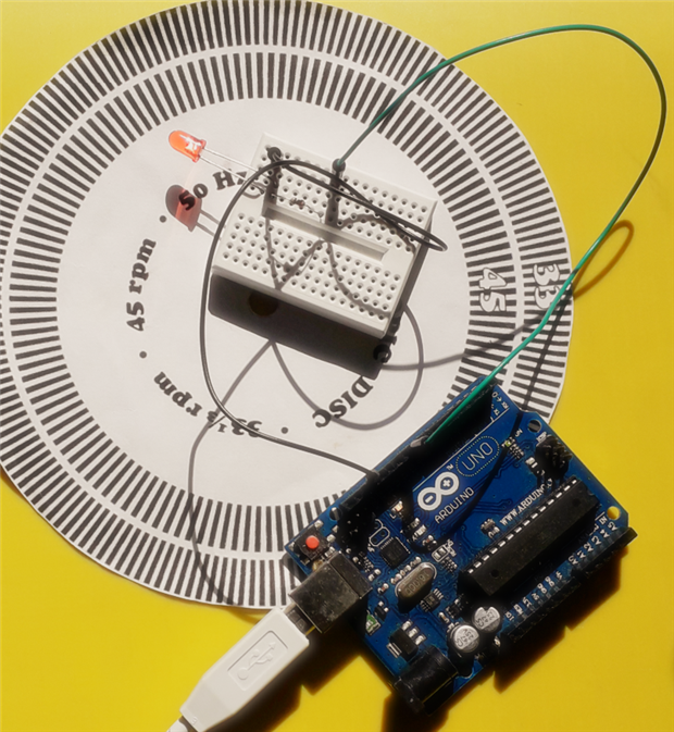

To use it, place the turntable in a location without bright lights. On a normal day, closing the curtains is good enough.
Print and cut out the strobe disk. Place it on the turntable.
Switch it on, and bring the led as close to the strobo disk as you can. I used a little breadboard and long wires.
If your turntable is spinning correctly, the corresponding circle on your strobe disk (or at least the part directly lit by the LED) appears to stand still.
If you have speed control on your turntable, you can now use that to correct the speed until the dots become stable.

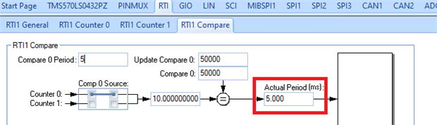

The software is in essence the rtiBlinky example (real time clock) for that board. But in the interrupt of the RTC, I toggle the two LEDs.
I've doubled the speed here, compared to the Arduino example, because of that toggling.
To blink a led at 100 Hz, you have to toggle it at twice the speed (because one toggle lights it up, the next toggle dims it). That means 200 Hz, or 5 ms:

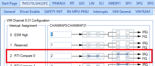

The interrupt for that RTI is enabled:

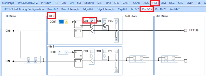

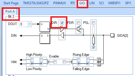

.. and the two pins with connected to the LEDS (GPIOA.2 and HET1.8) are defined as outputs:

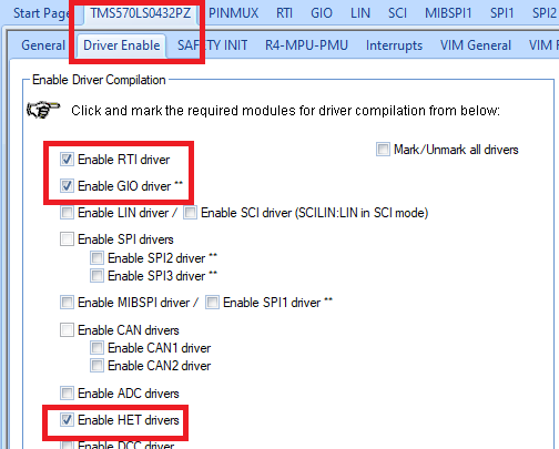

The drivers for GIO, HET and RTI are set:
In the code, we enable the interrupts and init the modules:
