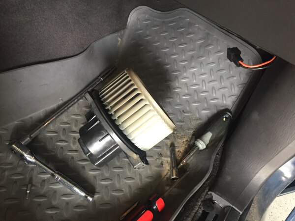

Due to the pandemic grounding us, we're doing a lot preventive maintenance this week on our Jeep.  They had a 20% discount and free next day shipping on parts, so we thought it would be good to reset some of the consumables for another 4 years.  By consumables, I mean things that rotate, turn, slide, or clog.  These typically have a life under 7 years.  We are changing out brake pads, rotors, all drive train bushings, sway bar links, water pump, thermostat, air filter, rear axle bearings, serpentine belt, and the engine oil and filter.  Other joints and bearings such as on the front suspension were already renewed in the last 5 years, so we figured that's a good scope to keep us from going stir crazy in quarantine.
Since that scope is mechanical, I won't cover them here.  We'll do a deep dive on failed blower for my heat and Air Conditioning.
Here is how it went down:
  • First sign:  heard a ticking sound under the dash where the blower is.
  • Second sign:  it no longer spun when turned on.  no sound at all
  • Suspected:  After 21 years, the motor brushes have eroded to their springs which led to the ticking sound which then led to the ultimate failure.
So, we got after it.  Here were the steps:

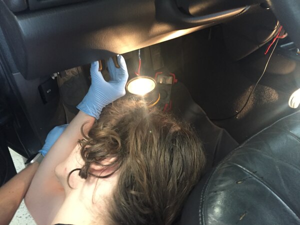

Checked the Fuse:  This is quick and easy  The fuses are labelled on the fuse block cover.
All was good, so we went to the other side of the electron path.  The blower.
With Young Eyes - One Can Check a Fuse Visually, but an Ohmmeter gets a 100% check

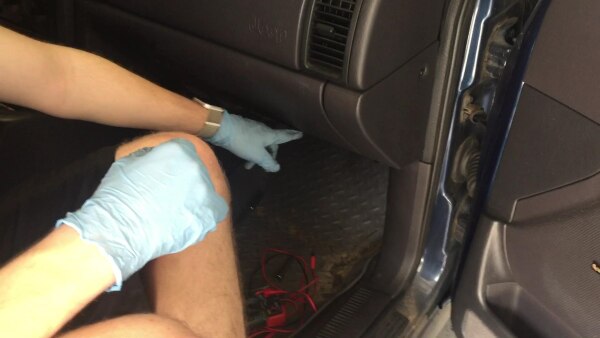

Holding his tongue right, Connor snapped the electrical harness off the blower and checked for voltage.
This eliminates the chance of the problem being anywhere between the fuse and here.
There was voltage at the harness.
The 21 year old blower has bit the dust.

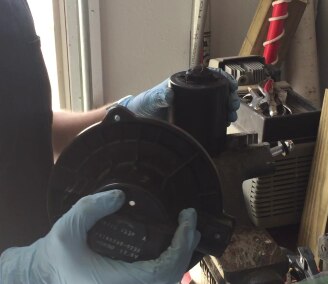

The blower fasteners were amazing!
You could use a flat screw driver, a torques bit, OR a 8mm socket -
and there were only 3 screws!
Took less than 5 minutes to drop it out.

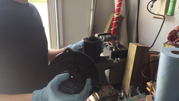

Since we could just replace a 21 year old blower with a next day delivered blower for $60, we just bought a new one.

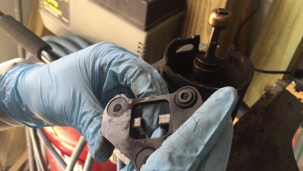

But, we wanted to see if it was the brushes, so we tore the motor apart.
We found the brushes were still had some years left!
The springs were still intact.
Let's look at what could have caused it to no longer work:

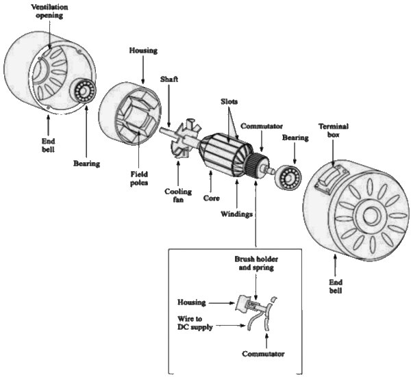

Exploded View of a DC Motor
End Bells - these are just a cover that provides structure for it to spin.  They didn't appear to be damaged which could have led to a short, but not in this case.
Bearings - we could spin the motor easily by hand without resistance.  Bearings are always good to renew when aged, but not what caused it to stop turning on.
Housing - since this is a stationary part, I would only expect corrosion to be a culprit.  It had none.
Shaft and cooling fan - this would have had to been bent or damaged - not found in our case.
Brushes - this is the leading cause of motor failure in my experience.  The brushes eventually erode to nothing and it rides on the springs that gave them tension.  In a critical operation, you would periodically check them and renew.  But, to my surprise, this was not the cause of failure.
Windings - this is most likely the problem.  The windings have a copper wire that has an enamel coating on them.  If this degrades, it is game over.
Checking Windings:
Windings can be tested for a "go, no go" with an ohmmeter set to measure resistance.  You'd need a data sheet for the exact motor to do any further diagnostics.  To check for potential future failures, you can use a device called "megger".  Megger is actually a company name that had the most popular motor insulation testing equipment.  Back in the day, you actually hand cranked them to induce a voltage that then could find the smallest of insulation issues.
PROJECT SUMMARY
Good news, no wires were melted or knobs found broken.  The new blower is working great.
