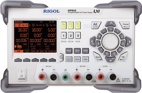

Rigol recommends calibrating the Rigol DP832 power supply unit (PSU) (Figure 1) at least once a year, and since my PSU's calibration date was 5 years old, I thought it would be a good time to recalibrate it. Before calibrating the PSU, I decided to evaluate it so that I could check if it was still in spec.
Figure 1: Rigol DP832 [Source: Rigol].

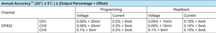

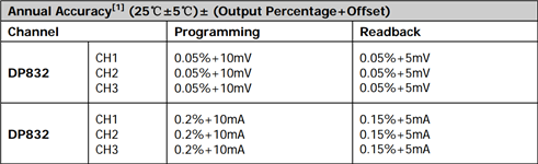

While looking for the specs, I found some discrepancies between the annual accuracy shown in the datasheet (Table 1) and in the performance verification manual (Table 2):
Table 1: Annual accuracy according to the datasheet [Source: Rigol].
Table 2: Annual accuracy according to the performance verification manual [Source: Rigol].
So I arbitrarily chose to test the instrument against the following accuracy limits:

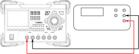

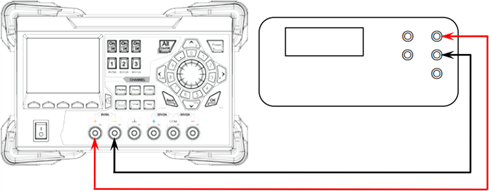

The PSU was connected to a Keithley DMM6500 which was controlled through simple TSP commands (which I've already shown in my Keithley Bench Digital Multimeter - Review). Two type of connections have to be made for each channel, to measure voltage (Figure 2) and current (Figure 3).
Figure 2: Voltage measurement [Source: Rigol].
Figure 3: Current measurement [Source: Rigol].
Each channel contains 4 calibration items:
  • Programmed voltage (V-DAC)
  • Programmed current (I-DAC)
  • Readback voltage (V-ADC)
  • Readback current (I-ADC)
To measure the accuracy of the instrument, 12 calibration items need to be evaluated.

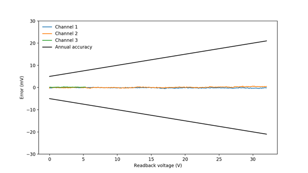

Pre-calibration accuracy

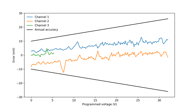

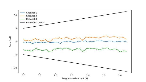

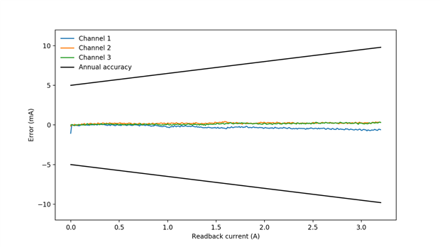

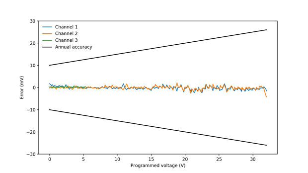

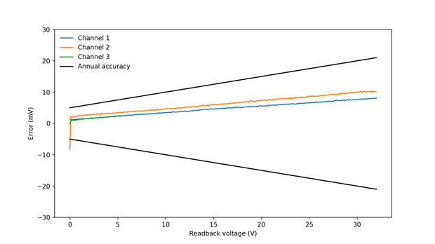

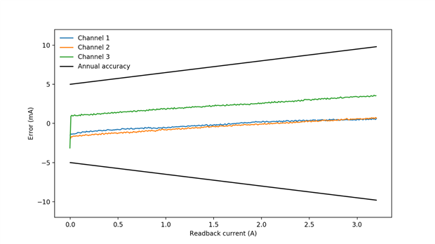

Accuracy was measured by performing full voltage and current sweeps at each channel with a 1 s delay at each sweep step and measurement. 0.1 V steps were used in the voltage sweep, and 0.01 A steps in the current sweep. The following table shows the obtained results:
Pre-cal      V-DAC      V-ADC       I-DAC      I-ADC
Channel 1:   ±12.8 mV    ±8.1 mV    ±0.8 mA    ±1.5 mA
Channel 2:   ±12.4 mV   ±10.4 mV    ±2.2 mA    ±2.0 mA
Channel 3:    ±4.6 mV    ±2.5 mV    ±4.1 mA    ±3.6 mA
The following 2 figures show the programmed and readback voltage and current errors:
Figure 4: Programmed voltage and readback voltage error plots.
Figure 5: Programmed voltage and readback current error plots.
Everything looked fine, with the exception of the channel 2 readback voltage, which at 0 V gets slightly out off spec. The reason that it gets out of spec is that when the PSU is programmed to output 0 V, it actually outputs ~-8 mV, which is then read back as a clamped 0 V. A similar situation occurs with channel 3 in the readback current plot, but it does not get out of spec there.

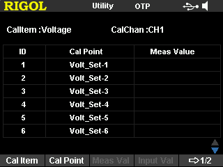

Rigol provides a calibration manual that shows how to manually calibrate the PSU. To calibrate it, the 4 calibration items (V-DAC, V-ADC, I-DAC, I-ADC) need to be evaluated at different "calibration points" (Figure 6). When a "cal point" is selected the PSU generates an arbitrary voltage/current output that depends on the cal point ID, this output has to be measured with a DMM and manually entered in the table. The procedure needs to be repeated for every "cal point" of the table until it's complete. Since the PSU has 3 channels and there are 4 calibration items, 12 tables need to be filled to fully calibrate the PSU. There is a total of 180 values that have to be entered, which makes the process slow,and error prone.
Figure 6: Calibration table [Source: Rigol].
Luckily there is a better approach through the usage of SCPI commands. Members of the eevblog reverse engineered the PSU calibration SCPI commmands and published an SCPI calibration user guide. Although a good starting point, this guide has some minor errors and misses some important details, such as that the number of calibration points and values can be set arbitrarily. Lets take a look at the commands that I used on my calibrator program:

Post-calibration accuracy
After performing a full calibration its time to compare the pre-calibration with the post-calibration results:
Post-cal      V-DAC      V-ADC      I-DAC      I-ADC
Channel 1:    ±2.3 mV    ±0.5 mV    ±1.8 mA    ±1.0 mA
Channel 2:    ±4.2 mV    ±0.7 mV    ±1.4 mA    ±0.4 mA
Channel 3:    ±0.8 mV    ±0.4 mV    ±0.7 mA    ±0.4 mA
Figure 7: Pre- and post-calibration programmed voltage error plots.
Figure 8: Pre- and post-calibration readback voltage error plots.

The post-calibration accuracy increased in all cases except one: the programmed current for channel 1, which I suspect was caused by temperature variations. I found the programmmd current calibration/measurement to be quite tricky because heating of the PSU affects the current output. And since PSU temperature varies quite a bit during normal operation, how close the output is to the programmed values varies during the operation of the instrument. For example if all of a sudden a lot of current is sourced, it will take probably a few minutes for the PSU output to stabilize.
