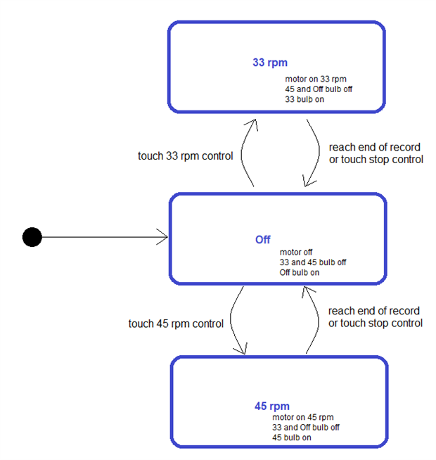

Thoughts About the Speed Switch Circuit
At that same time I did a first overhaul, I also replaced the light bulbs in the capacitive touch buttons. They were blown.
This isn't something you '"just can do". The lamps resistance plays a part in the discrete flip-flops that lets you select the speed.
An interesting circuit. I left away the start / stop sub-circuit in the middle. It's described earlier in this post.
The two speed controls are capacitive touch switches with a light bulb underneath them.
The bulb under the 33 RPM button will light up when that's the selected speed.
The 45 one in case that the table runs at 45 RPM.
The default status, not shown here, is the off-position.
You can see two bistable multivibrators, each controlling one speed.
In the "off" case, both multivibrators are in their "inactive" position: left transistor on, right one off.
When you touch the 33 control, it will flip the upper multivibrator.
TS426 off, TS428 on. The light LA 410 will go on. And the 33 rpm signal will activate the motor circuit for 33 RPM.
Meanwhile, the upper multivibrator (33), via D445 and R538, will lock the lower multivabrator (45). It can't be used as long as the TT is running 33 RPM.
The STOP circuit first has to be activated before you can switch speed.
The 45 RPM side works exactly the same.
In essence, this is a state machine with 3 states: Off, 33 or 45.
You can migrate from Off to 33 by touching the 33 control
Off to 45 by touching the 45 control
Either 33 or 45 to Off by touching the Off control or blocking the LDR at the end of the record.
These days, you'd probably use a microcontroller for this?

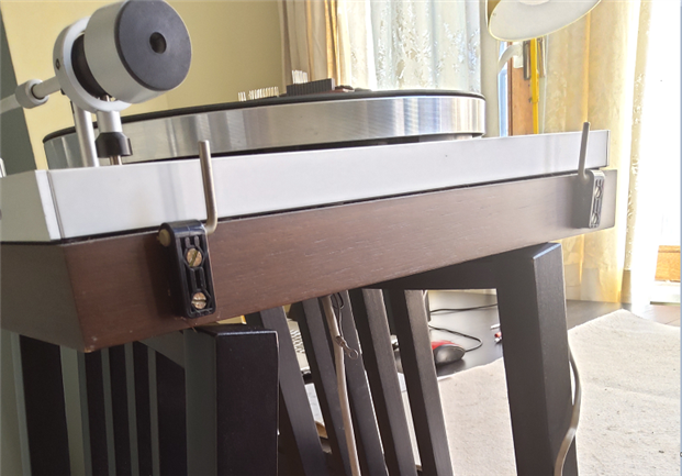

Here it gets a little tricky, because you have to turn trimmers inside the turntable while it spins.
jw0752 mentioned in a previous post that he uses a construct hanging from the ceiling. I use the backs of two chairs (very unsafe).
I balance the TT on them, with the bottom cover removed.
Then there's the fiddly part (remember to put the 2 outside potentiometers in their middle position first) where you kneel, insert a little plastic screwdriver in the correct trimmer.
Then stand up while trying to keep the screwdriver in place. Then switch the table to 45 RPM, and use a stroboscobe to check speed.
Then carefully fiddle with the little trimmer until the speed is spot on.
Once 45 is ok, do the same ith 33 RPM. Try to not knock over the whole structure ...

    Hi Jan, Great Compromise on working under the table. Reminds me of putting the car up on a hoist. John
