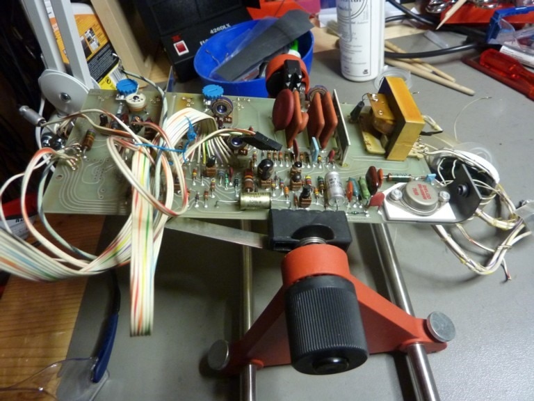

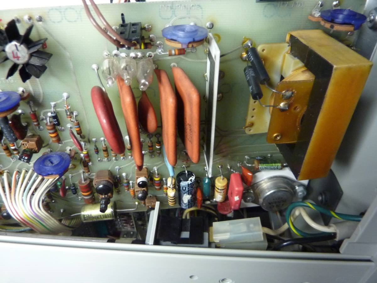

Quickly after power has been applied, something began to smell "electrical", so the unit was powered down quickly. image

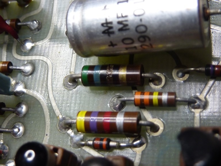

After the aluminium cover on the HV/Deflection board has been removed, a damaged resistor was revealed.
Here is a summary of the following repair:

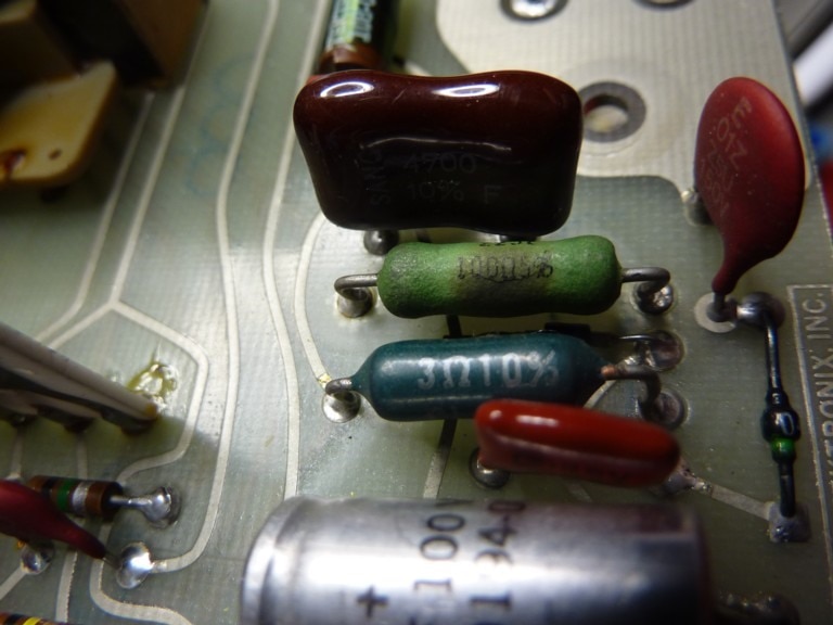

- A damaged resistor R252 / 100 Ohm was found.

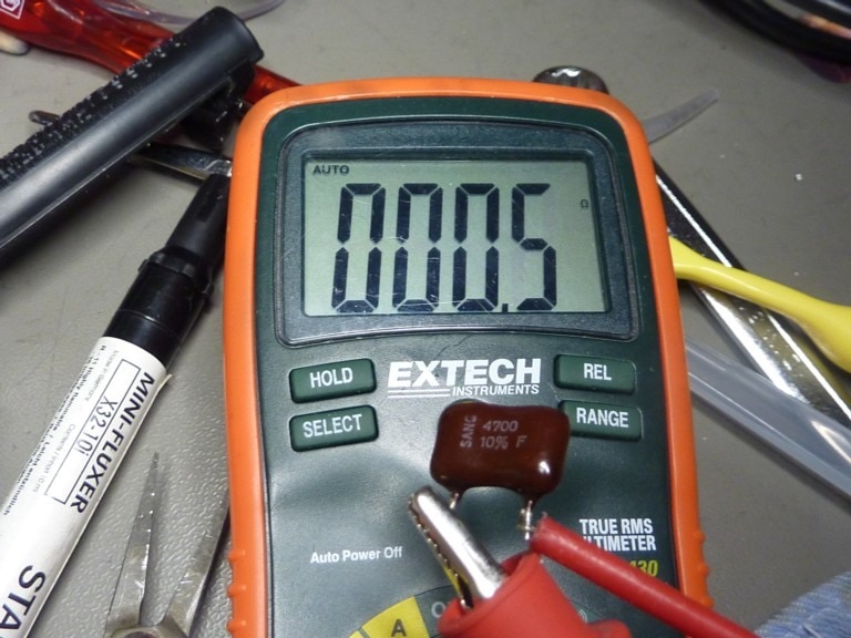

Picture 1: Dead short silver mica capacitor
- Primary failure was a shorted silver mica capacitor in the HV section, C252, 4.7nF. Dead short, see photo above. Again, this is the first silver mica cap failure I have ever seen.
Pictures 2, 3: Damaged resistors on HV board (CRT Circuit, board 2 in the schematics)
Picture 4: Side view from opposite, CRT removed already.

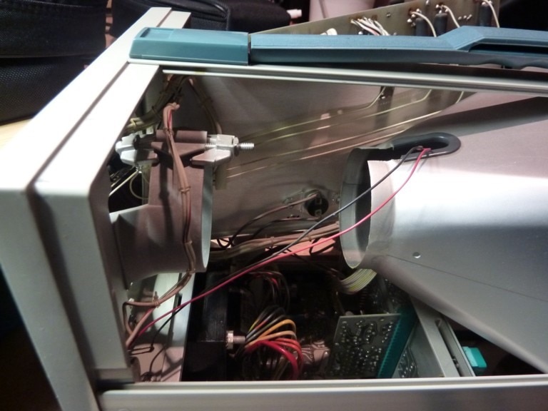

- In order to remove the HV board for repair, I had to remove the side panel, pull the CRT neck connector, remove all connectors to the main power supply board, unmount all front panel controls, unsolder the calibrator connection, remove the overtemp. protection, remove the CRT and move the CRT shield aside. If you ever need to remove a CRT, please obey the safety instructions as provided in the service manual.
After all this work, I could finally remove the aluminium bracket which holds the HV board, and take the HV board off the bracket. Yay... image
Picture 5: Finally, the HV board is ready for repair

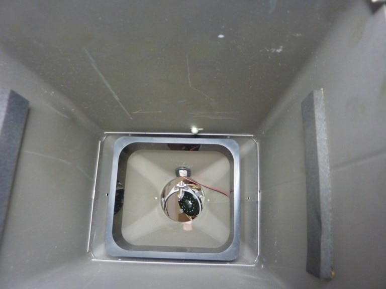

Picture 6: A view into the CRT shield.
Mind the small nut which fixes the shield to the upper frame. The black plastic frame is the DC coil for beam/trace rotation.
Side note: The HV board features an interesting switched mode power supply, which generates several supply voltages, incl. the -3,450V cathode voltage.
- Tested switching transistor Q252 on my 5CT1N curve tracer (being aware of the CT's limits). Looked functional per se, but had low beta. Tektronix listed the SJ2304 as a replacement part, which is insanely expensive and rare. See below for chosen replacement.

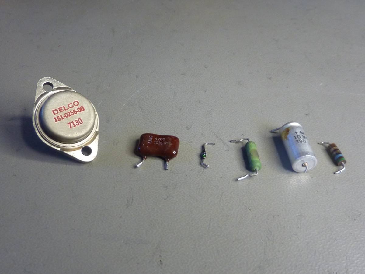

- The following components have been replaced:
R252 100 Ohm, Q252 with a BUX48A , C252 with WIMA MKP 4.7nF, CR253 with UF4007 (the diode looked and measured ok, but these diodes can cause issues at high temp, which I experienced in my 7704A), R251 looked cooked, so it was replaced with two 10 Ohm resistors in parallel (measured 5.4 Ohm), C251 el. cap 10µF 100V replaced as a precaution.
Picture 7: Replaced components

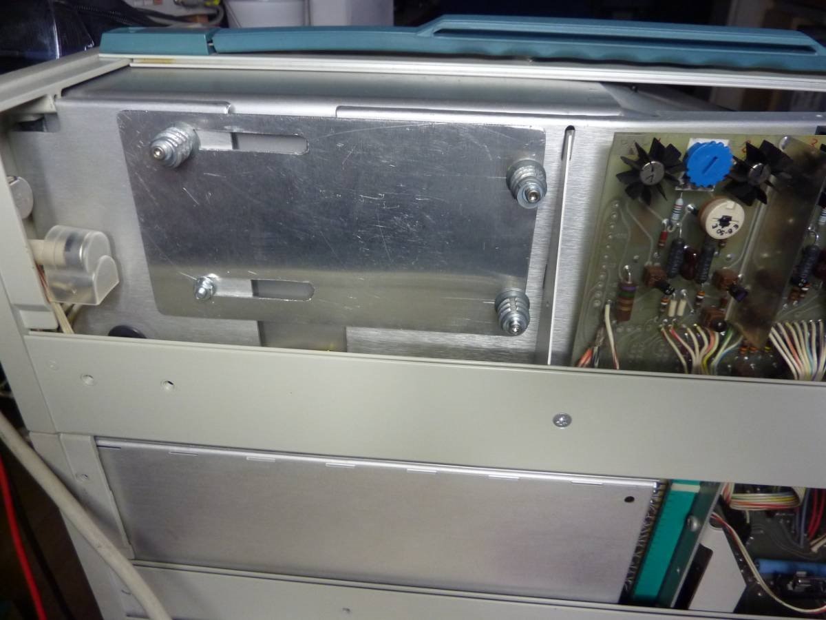

- To make the next repair easier, I decided to split the aluminium bracket. The same bracket type is used in the storage display variants of the 5000 scope series (such as the 5113/D13); so it has some extra space at the front. I have made a simple panel with two slot holes out of a left-over aluminium sheet, and used some standoffs, nuts and bolts. This allows taking out the aluminium bracket very easily next time.
Picture 8: New panel

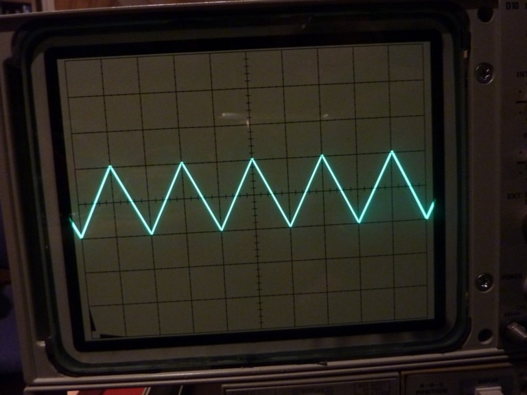

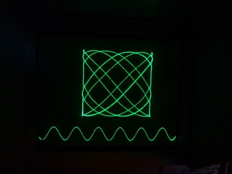

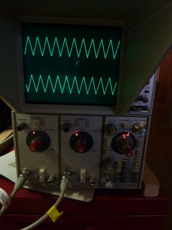

- After all components were re-assembled, I was glad to find the HV board and the oscilloscope functional again. A quick check of the supply voltages and continuous operation over 1.5 hours (under supervision) confirmed the successful repair. A full calibration followed and closed the repair.
Picture 9: Another classic Tektronix oscilloscope is back to operation…
- As almost expected, the two 5A15N single amplifiers and the 5B12N dual time base will not need much adjustment, as it appears. These are very reliable components; however, these will be calibrated also.
Picture 10: More fun with another revived Tektronix 5000-series oscilloscopes…
