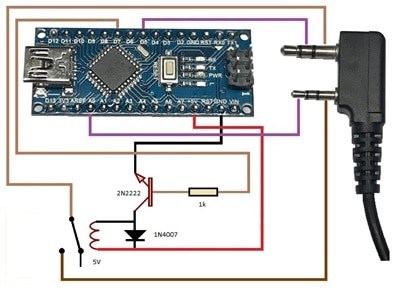

As part of Project14 | RF (Radio Frequency): Win a Spectrum Analyzer for the Most Innovative RF Project!, I wanted an automated transmitter for my Antenna Radiation project.  Amateur radio folks use such a device for "fox hunting", a radio direction finding event where the transmitter is hidden and one has to find it.  I decided to go with one where an Arduino controls a handheld radio and plays a little segment that the radio broadcasts.  My inspiration came from Fox Hunt Transmitter – Whitecourt Amateur Radio.
The version I used for testing antenna radiation patterns was good enough - but I did want to improve it (sooner or later).  The schematic from Whitecourt had two wires reversed (dark brown and purple on the smaller plug).  The "schematic" below is correct.

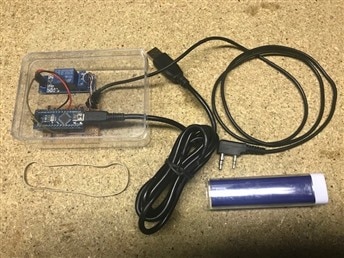

Yes, that's a Velleman box.  The rubber band was to keep the lid on during the snow and sleet.  The blue thing is a 2000mAh cell phone charger for power and the whole system plugs into a $35 Baofeng UV-82 radio.
The relay controls the Push-To-Talk circuit.  When closed, the radio transmits.
D5 is the Arduino output to radio microphone input. The darker brown wire is also common / radio ground.
A0 allows for DTMF (Dual Tone Multi Frequency) input, but I'm not using that yet.

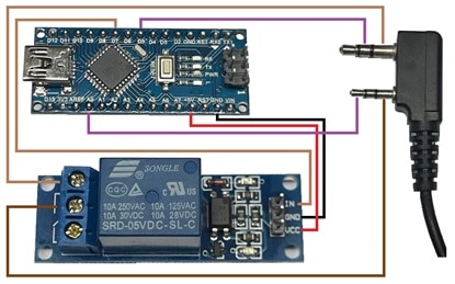

With the antenna radiation pattern testing complete, I wanted to upgrade the packaging of my fox - to make it more field ready.  The circuit did need to be modified slightly and I needed to change my Arduino code slightly.  The relay board above was active low and the relay used below will be active high.
