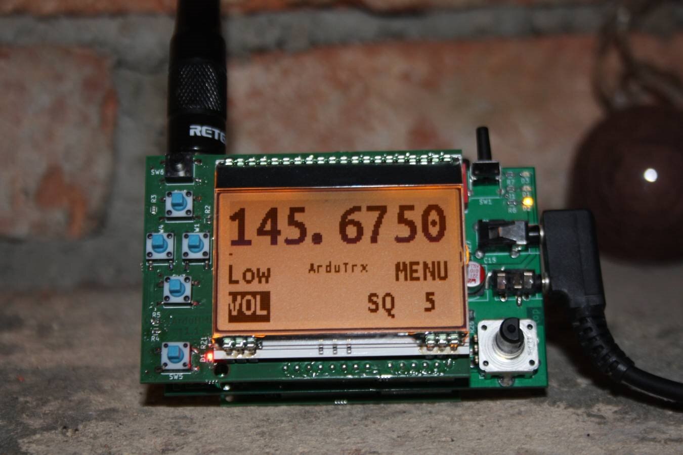

I received an Arduino MKR WIFI 1010 from element14 with a hint to the RF (Radio Frequency) contest. So I decided to dig out my ArduTrx project and update it to work with the Arduino MKR.
Background
The ArduTrx was originally described in these blog posts:
ArduTrx - a 2-meter-band ham radio transceiver with Arduino
ArduTrx Update: Open Source Hardware and professional PCB
ArduTrx Update: new HF modules and better documentation
ArduTrx is 3.3 V compatible but the previously used HMI shield is not.
So I decided to use my ArduHMI shield. This adds a bigger graphical display as a replacement of the former alpha numerical display. The shield was already described in a former project here: NFC-Badge - Update your badge with your smartphone - Design data of the HMI shield
Finally an adapter is needed to connect the Arduino MKR to these Arduino Uno compatible boards: Arduino MKR adapter
This leads to a heavy stacking of boards. As I don't have a suitable battery for the Arduino MKR I added a 18650 LiIon battery with holder and soldered it directly with wires.

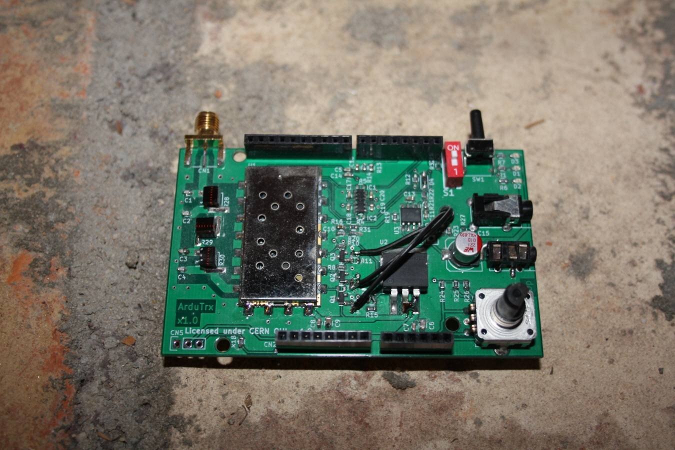

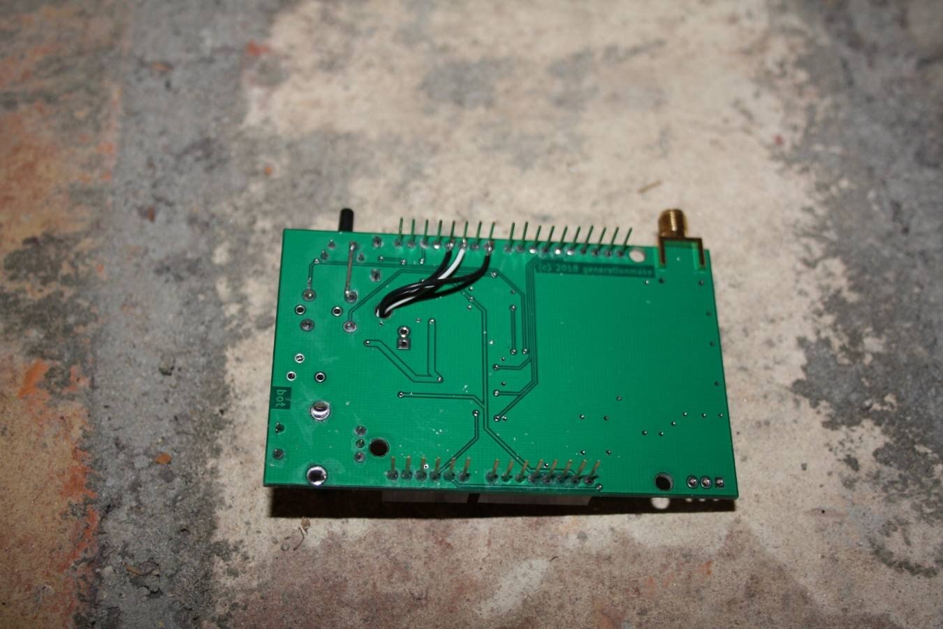

used pins
To get the shields running together some pins have to be changed. The display is connected to the microcontroller using hardware SPI. This is available on the Arduino Uno pins 11 to 13. unfortunately these pins are occupied by the ArduTrx shield. So this shield has to be modified that other pins are used.
The following table shows the new pin usage. The signals marked in red have to be changed.
shield
signal name direction
pin on Arduino Uno connector
pin on Arduino MKR connector comment
ArduTrx serial communication with hf module input 0 RX
ArduTrx serial communication with hf module output 1 TX
ArduTrx squelch input 2 2
ArduTrx analog / pwm audio output output 3 3
ArduTrx PTT output 4 4 was pin 11
ArduTrx Power down output 5 5 was pin 12
ArduHMI chip select to display output 6 6
ArduTrx output power output 7 7 was pin 13
ArduHMI signal A0 to display output 8 0
ArduHMI reset to display output 9 1
ArduHMI backlight control output 10 A6
ArduHMI serial data to display output 11 MOSI
12 MISO not usable as GPIO when SPI enabled
ArduHMI serial clock to display output 13 SCK
ArduHMI resistor divider of switches input A0 A0
ArduTrx measurement of VIN input A1 A1
ArduTrx audio input input A2 A2
ArduTrx rotary encoder signal A input A3 A3
ArduTrx rotary encoder signal B input A4 A4
ArduTrx rotary encoder signal SW input A5 A5
These images show the additional wires on ArduTrx.

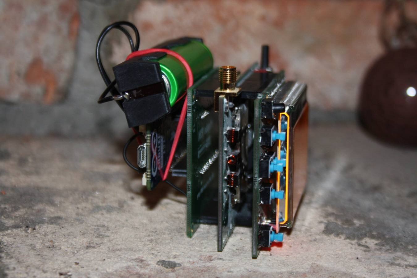

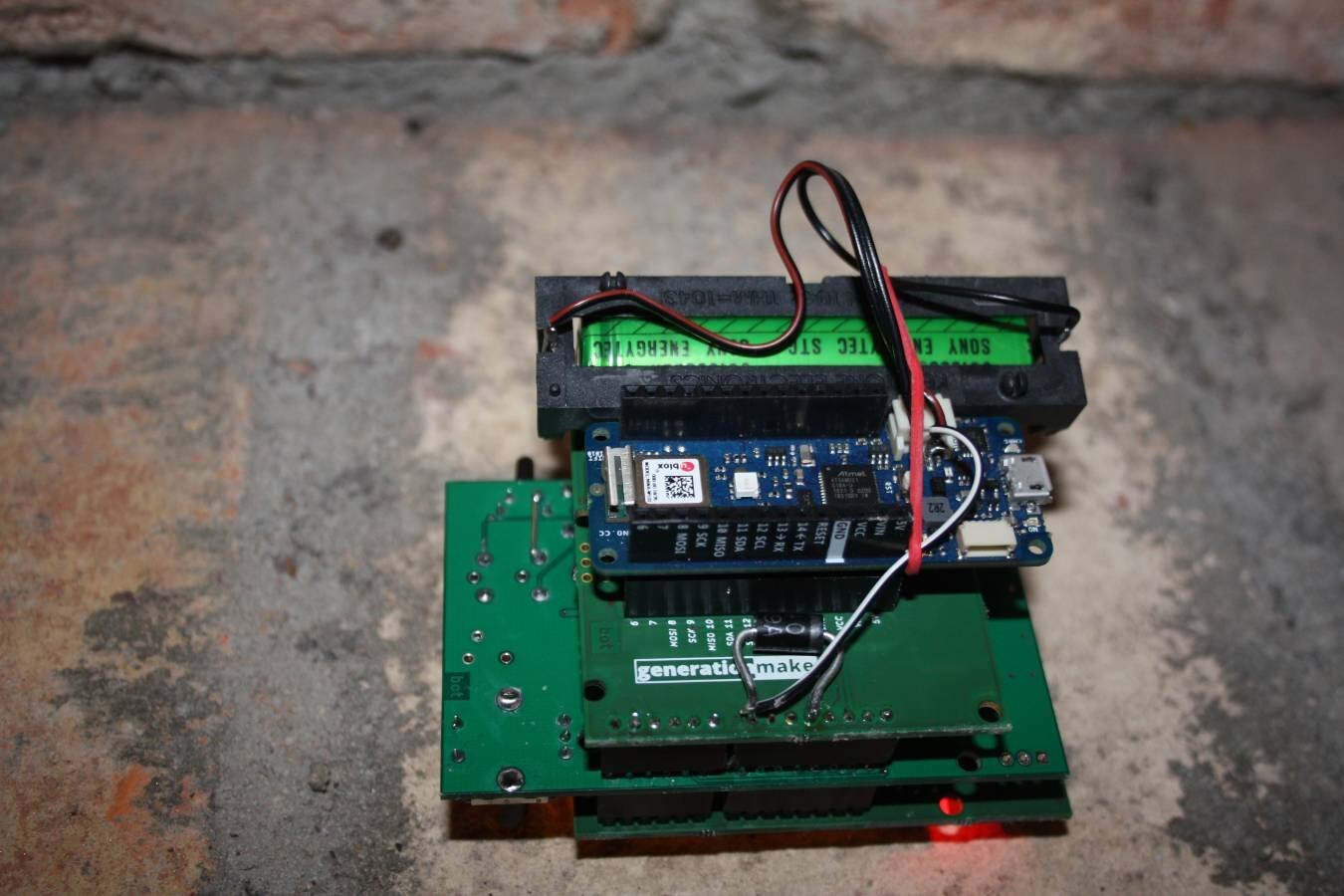

power supply
The coolest feature of the Arduino MKR WIFI 1010 for this project is its builtin battery charging function. Unfortunately the battery voltage is not available in any of the pins. So you have to make an additional wire from the battery to the input (VIN) of the ArduTrx shield (or in my case the MKRadapter). On the ArduTrx shield the voltage regulator should be shorted. The maximum voltage of the battery should be somewhere around 4.2 V and this is totally fine for the HF modules.
The next problem was that the display shield needs 5V to generate the supply voltage for the display. When powered by battery the 5V rail of the Arduino MKR WIFI 1010 is not powered. So I added an additional schottky-diode from VIN to 5V (also on the MKR adapter). In my case this is OK because VIN is connected to the battery and has maximum 4.2V. On regular Arduinos the VIN rail can go up to 20 V.
