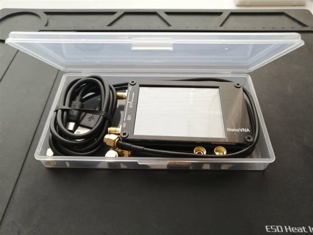

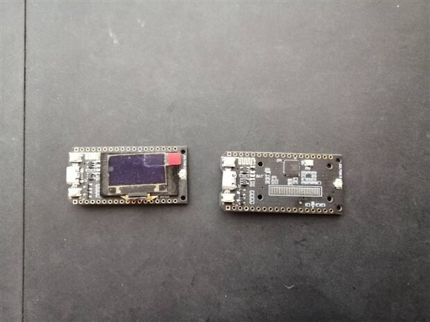

To help me with the tasks, I will be using 2 TTGO ESP32 LoRa boards (RX and TX) and, for measuring some of the antennae characteristics, I will use the NanoVNA, an extra-cheap Vector Network Analyzer, capable of covering the range 50Hz-900MHz! I will be exploring this tool when dealing with measuring the antenna's parameters.

    Thanks for the encouragement and the advice. Indeed, I have noticed how sensitive the measure is to even the slightest movement, when I tried the NanoVNA. I will have to tape everything down, including myself on the chair! image
    Fabio
    shabaz over 6 years ago
    Hi Fabio,
    Best of luck! I believe you'll get good results. Don't be disillusioned if initially things seem unpredictable or varying, because often just the cables moving can be enough to make a difference : )
    If you can, keeping the coax position the same so that it doesn't move between measurements, could help. And double-checking that the connector on the other end doesn't accidentally become loose when unscrewing/screwing the opposite end.
    Also, running the calibration procedure each time you sit down to start your tests (with the calibration done on the end of that cable, with the cable at the same position it will be for your measurements).
