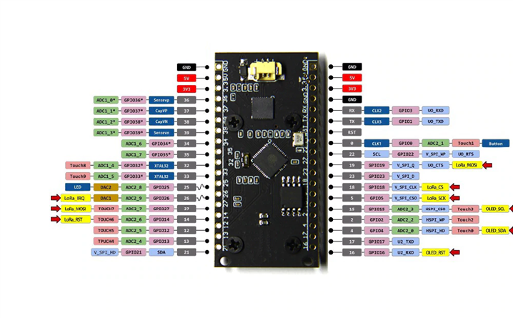

Lets start by introducing the boards: for this project I'm using a TTGO (actually TTGO-compatible) ESP32 LoRa board, which is powered by EspressIf's ESP32 SoC. The heart of the ESP32 is the dual-core Tensilica Xtensa LX6 32bit processor (240 MHz), with 520Kb SRAM, integrated WiFi 802.11 b/g/n/e/i (802.11n @ 2.4 GHz up to 150 Mbit/s) and Bluetooth v4.2 BR/EDR and Bluetooth Low Energy (BLE). The board comes with 128MB of Flash memory and the LoRa functionality is provided by the Semtech SX1278 chip (433MHz, TX power 20dBm).Also, there is a lithium battery charging circuit and interface and the CP2102 USB to serial interface makes it easy to flash the device via your computer USB. Below is the pinout of the board:
Development Environment Setup
EspressIf provide a quite powerful SDK  to support the ESP32, with a rich set of API, covering all the components of the SoC. The SDK can be used standalone (using the idf.py command line), or can be integrated in several development environments, like Ecplise and Arduino IDE. The integration with Eclipse can be achieved installing the eclipse plugin (Eclipse set up is described here). Although Eclipse is great, and it works brilliantly, I opted for the ArduinoIDE becuase EspressIf SDK does not include libraries for LoRa and for the OLED display (receiver board only), which I need to use and have no time to port over.
Setting up the ArduinoIDE is pretty straightforward: all is needed is to add the ESP32 boards using the Board repository URL (for EspressIf, use https://dl.espressif.com/dl/package_esp32_index.json ), then use the Board Manager to install "ESP32 by EspressIf Systems". This will install the toolchain and all the libraries needed by the ESP32. We also need to install the libraries for LoRa and for the OLED, which can be done by using the usual "Manage Libraries...". The libraries needed are:

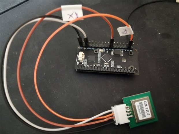

To make it easier to collect data about distance, for the receiver, I have decided to add a GPS module. Since the power requirement for the GPS are contained, I will use the on board +3.3V and GND pins for powering it. The GPS needs also a serial connection for communicating with the controller (RX/TX). This can be done using a new hardware defined serial, using the pin 17 and 23 (see connections in the image below). From the software side, we need a library to manage the GPS. I have opted for TinyGPSPlus, a very helpful library which offers the functionalities I need.
The receiver will wait for the GPS signal to lock, then it will listen for incoming LoRa messages. The transmitter's latitude and longitude coordinates are hard-coded in the receiver, so once a new set of coordinates are read from the GPS, the distance can be correctly calculated and displayed. I also keep track of the maximum distance, and that will be displayed as well. Other information are added to the display, as the RSSI and S/N reading, to understand the strength and quality of the signal received.

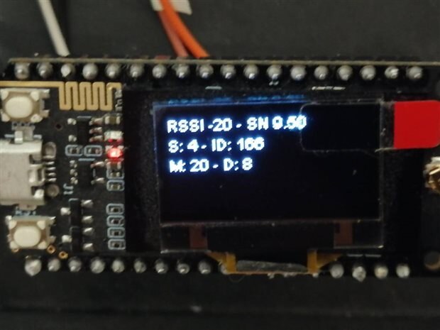

Below you can see the information on the display (S:number of bytes received - ID:message counter - M: maximum distance - D: current distance):

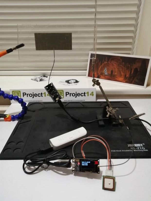

Lets show the boards, ready for action (image below). The video explains the boards and how the testing will be carried.To make it transportable, the receiver is powered by a battery pack.
Testing the antennae
With both the transmitter and the receiver code completed, time to test the antennae. The procedure is pretty simple: I will set up the transmitter using one different antenna at time, then pick the receiver and go for a walk. Once I reach the maximum distance (no more signal received) I go back to base, change antenna and do the same round again. The bonus from this testing plan is I get the exercise!
I live in a town, so let me start by stressing there will be lots of noise and reflections (lots of 2 or 3 storey buildings and lots of trees), so the range will be limited as result. This is one of the reason I chose the minimum bandwidth and the maximum spreading factor for configuring the LoRa communication. The transmitting antenna is always located in the same place, with the same orientation, so that all the conditions are kept the same while repeating the test.
The GPS is not the most precise around, so allow +/- 10m on the measure.
Below you can find my results:
Antenna Maximum distance (m)
Helical 303
Molex FPC (on poly) 504
Center Loaded Coil 327
Small FPC 347
Quarter-wave Monopole 583
The numbers speak for themselves. I'm very impressed with the result! Looks like the poor's man antenna works quite well image.
