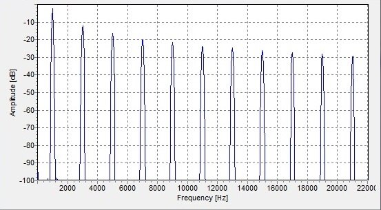

If you look at a 1kHz squarewave with a Spectrum Analyzer you get this.
Every second harmonic is skipped, so 1kHz gets harmonics of 3kHz, 5kHz, 7kHz etc. This skipping is the result of the 50% duty cycle, the even (divides by 2) frequencies are cancelled out.
However, SMPS work by varing the duty cycle to get a stable output voltage, so what frequencies are cancelled alter varies.
In addition, a second main frequency is generated, as ontime is time, and frequency = 1 / time.
