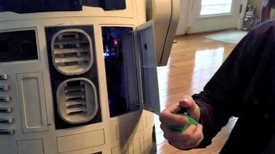

Me (Sean Miller) Back in 2014 with my "Old RC" Transmitter in Hand(12)
Wishing she wasn't so cute when asking "Can I Drive It??  Pleeeeeeaasssseeeeee!"
Sometimes events could turn into a "Can I drive it?" event.  Instead of the demonstration being about the magic of R2 or the engineering behind it, the focus for the kids was more on getting to drive him.  It would be a major buzz kill when I'd say "Sorry, not this time" to the kids and parents.  So, around 2013 in the Astromech community, we had a lot of forum discussion around the Holy Grail for R2 control - the Incognito Controller.

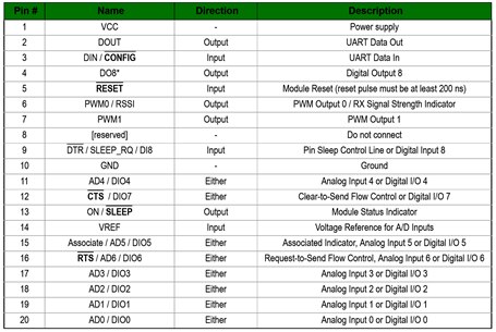

With that small form factor, the module can operate as low as 2.8V, so powering with two AAA’s made it a perfect solution.  Best of all, it has its own GPIO covering the bases – Analog, Digital, and PWM!
Pin Assignments for XBee S1 802.15.4 Module(5)
In turn, we have the capability to integrate a wireless, but virtually wired controller into our droid.

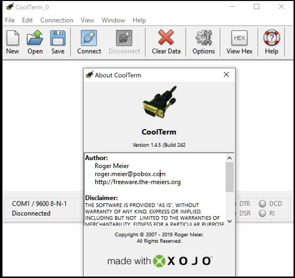

The XBee S1 module is configured using simple serial AT commands.  Easy Peasy! Well, not really.  I’d say this was the biggest headache for the newcomer to XBee.  However, after much trial and error, we got the configuration sorted.  Since then, Digi International has improved their configuration software and you can do this now with their XCU tool.  We went old school and shot the AT commands directly ourselves.  By learning this behind-the-scenes, low level approach, it allowed us to be able to send AT commands on the fly with a microcontroller which served us for future projects.
So, to communicate the configuration to the transmitter and receiver modules using AT commands, we used a program called CoolTerm. As stated on their website, CoolTerm is a simple serial port terminal application by Roger Meier downloadable at http://freeware.the-meiers.org(6).  It that is geared towards hobbyists and professionals that have a need to exchange data with hardware connected to serial ports such as servo controllers, robotic kits, GPS receivers, microcontrollers, etc.
CoolTerm Application(6)
We then carefully entered in the AT commands(7) with a 3.3V USB to Serial converter module:
Setup:
    Vin must be a 3.3V - don't use a 5V USB servial converter or you risk damage
    The Com port will be something other than 1
    9600 baud
    Note:  don’t type the notes indicated by the # sign.

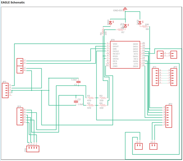

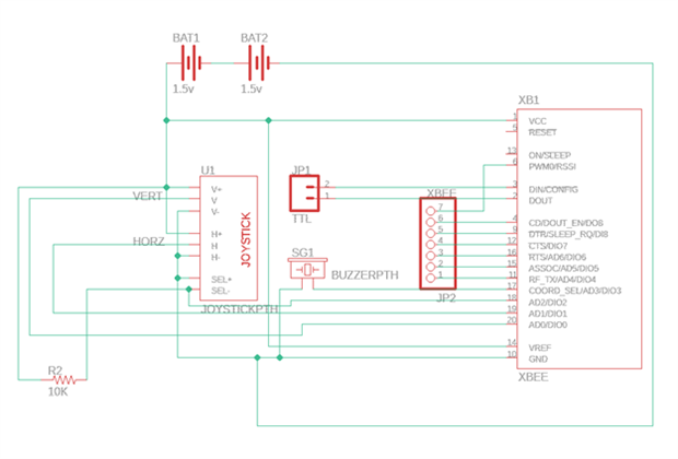

SCHEMATICS
When designing the circuit for the controller, we found that the buttons on digital inputs of the XBee modules should actually take the pin to ground versus bring Vcc to the pin.  Otherwise, we’d needed a pulldown resistor and give the XBee module a command to turn off the XBee internal pull up resistor.  In turn, the receiver always has voltage until the transmitter button is pressed, but that is no big deal in software as we’ll show in the Code section.
I shared pictures of these same circuits in a past contest, Robots on Wheels.  In that blog, I documented the physical construction of the droid, but didn’t cover the design, building, and coding of the RF Controller.  Let’s deep dive on the circuits here.
Handheld Transmitter:
Here are the key details:
  • The 1.5V batteries in series are simply AAAs.  The controller has a switch (SG1) to kill current flow when idle.  Even without it, it will get a few hours of use. So, AAAs were found to be the most convenient power source and met the power needs of the XBee module.
  • The joystick is a thumbstick as one would find in a Play Station 2 Controller.  They are very inexpensive and readily available.
  • JP1 is a couple of pins to allow serial communication.  They come in handy for configuration without having to take the controller back apart.
  • R2 (the resistor, not the droid) is a 10K Pull up to 3.3V.  This is so I can push in/click the joystick and take the signal to ground as discussed above.  When it's not push, its a steady 3.3V to let the XBee know he's idle.
  • The Joystick provides analog signals to reflect how far the stick is pushed in any direction. When received by the microcontroller, this translates to speed and direction.
Handheld Thumbstick Controller
For any virtual wire handheld project you can download this Eagle Schematic and Board file to have this fabricated at your favorite PCB fabricator such as Oshpark.com.  Be sure to add your own flare to the design.
    https://github.com/RaisingAwesome/R2D2/blob/master/XBeeTransmitterV2.0.zip

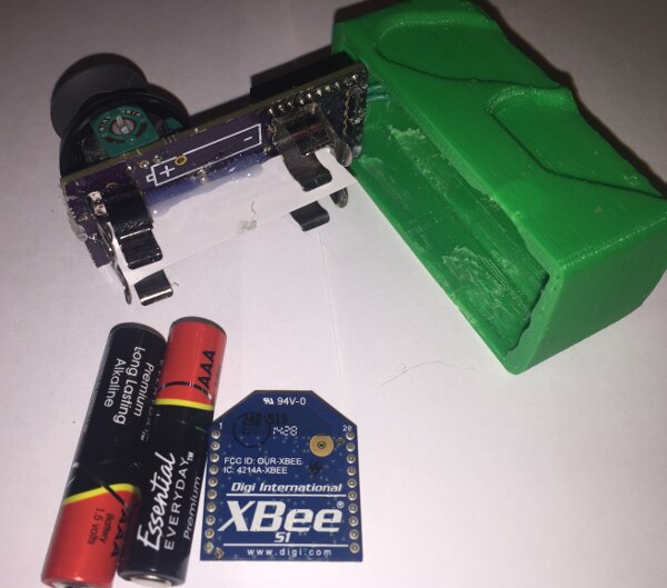

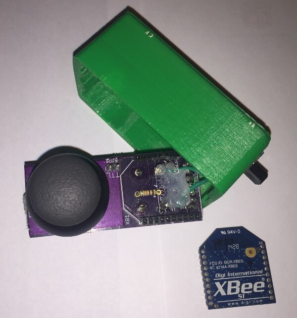

Here are some pics of the resulting fabricated board:
Handheld Controller Showing What is Under the Hood of the Radio
A Little Glue Gun Action Goes a Long Way for
Stress Relief on Wire-to-Board Connections
Battery Side of the Handheld Controller
Just 2 AAA's easily get you through an all day event with R2

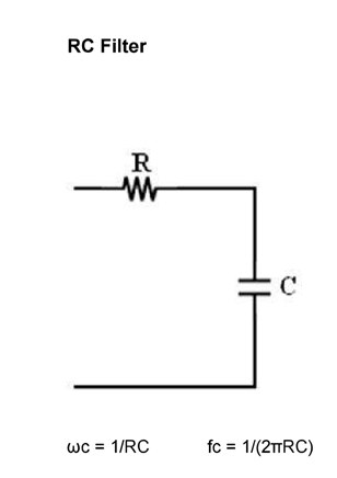

The receiver circuit brought a new learning to us – Digital to Analog conversion of PWM.  Since we are sending a signal with a virtual wire to a module without its own ADC, we had to devise a circuit that could emulate the analog signal that the joystick produces.  To do this, we made what is called an RC Filter as discussed in the Digi Knowledge Base(8):
RC Filter for PWM to Analog Conversion(8)
With a little math and trial and error with resistor values, we determined a 470 ohm resitor and 330 ohm resitor going to function confirming LEDs would do the trick for simulating an analog signal from a PWM digital signal relayed by the XBee.  The way it works is, as the Pulse Width Modulation pulses, the resistor slows the capacitor's ability to drain back down during the off cycle of the pulse.  In turn, the slower the pulse the less the voltage available.  The faster the pulse the higher the voltage.  The resulting steady voltages present an effective analog signal over the virtual wire that is the XBee.
Here is the complete circuit for the receiver:
And, last, here is the fabricated shield plugged into our microcontroller:
Custom XBee Receiver Module Shield:
It serves as Virtual Analog, Digital, and PWMWires to the Handheld Controller
Since the LEDs are in the RC Filter circuit, they brighten as the RF controller joystick is used to verify function and troubleshoot as needed.  This design is Arduino Uno compatible and can be used in a number of projects.  You can obtain it from my GitHub and have it manufactured at your favorite PCB fabricator such as Oshpark.com.  I'd suggest editing the file if your name is Sean or I hope your wife is named Brenda!
https://github.com/RaisingAwesome/R2D2/blob/master/XbeeSeanReceiverV2.0.zip

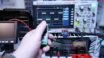

With the XBee's configured, we can take a look at how the Virtual Wire's behave with the controller.   Below is a video showing the output pins of the receiver.  The analog read at the transmitter is translated to PWM output from the receiver.
Oscilloscope of the Various Xbee Signals of the R2D2 Incognito Controller

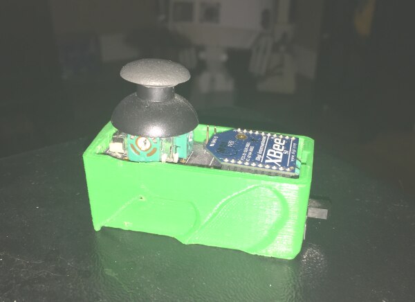

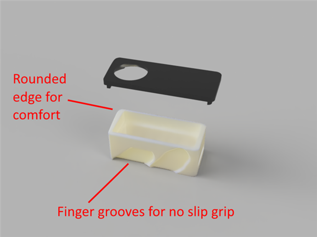

3D PRINTED ENCLOSURE
The enclosure was designed to comfortably fit in ones hand and not lose grip.  It readily fits even in ones jeans pocket – well, not skinny jeans, but this 47 year old man's frumpy jeans.
Autodesk Fusion 360 Rendering of our R2D2 Controller - Designed to Look Awesome in Your Pocket!
The STL files for the enclosure can be downloaded from my GitHub Repository:  https://github.com/RaisingAwesome/R2D2(9)
3D Printed XBee Transmitter Enclosure:  Pocket Sized Ready to Trick the Crowd

Taking the virtual wire approach allows us to put a microcontroller between us and the foot motors.  In turn, we can always be sensing the environment to determine if the droid will even allow motion or not.  The approach I took was to have program threads running similar to the involuntary systems in the human body.  They are named movementThread, soundThread, distanceThread, pulseThread, autonomousDomeThread.
movementThread - this looks at all factors including the user's thumb stick operation, but also considers proximity sensors.  It's end function is to assess if the droid should move or not, how fast, and what direction - and then either do what the user wanted, limit the speed, or let out a scream and stop entirely.
soundThread - this looks at all factors to determine what sound it should play - a yell, a beep, a sound, or whaterver.  It takes input from variables set by the other threads to determine what to play.
distanceThread - this thread is continuously using a proximity sensor to determine if it should interlock movement should someone be two close - regardless of what the person controlling it wants.
pulseThread - this is translating the analog and digital inputs from the XBee to meaningful variable updates so the other threads can assess what they should be doing.
automomousDomeThread - this is rotating the dome based on the variables set by the rest of the threads to give him a truly autonomous dome movement system
You can see where the XBee pins come into play with a skim for XBee in the code.  It's really quite simple in that you just treat the XBee pins as you would a wire connected to your GPIO.
