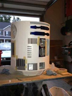

I was able to get ahold of drawings that gave a template to make his body frame out of wood.  So, I broke out my table saw and router and got to cutting:
After I had a sturdy frame, I learned about the material High Impact Polystyrene.  It is a sheet plastic material used by prop designers and model builders.  You can obtain it in various thicknesses.  Using solvents, it can be chemically welded instantly to allow you to make parts.  I used this sheet material to shape all non structure parts such as his foot shells.  I also used it to laminate over all wooden parts to give it the illusion of him being built from metal once painted.
For the small parts, I learned how to make molded resin parts from Smooth-On.  I would use clay to make one part, then resin cast it to duplicate it as with R2's coin slots:
3D printers weren't yet affordable.  So, this old school approach served me well.
It took about 3 years to find the time to research, 2D print & puzzle templates together, cut out the plastic, cast the resin, route wood, and assemble and paint.
The whole family was involved on applying the two layer of body skins:

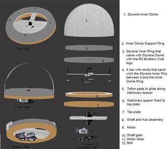

The legs were a big challenged in that part of the journey.  I had to keep in mind I had to get electricity to the feet when designing my approach without the wires showing.  So, I routed a hidden channel in the legs and ran the wires before gluing and screwing it all together.  Here is a video showing the extensive process:
They turned out pretty good:

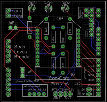

After 3 years, I had a great movie prop.  Not every body detail was finished, but we had enough to apply my programming and microcontroller skills I learned at year one.  Ben Heck taught me how to make my own PCB.  So, using Eagle, we designed the PCB shields to control R2's motor drivers using XBee radios.  This allowed for his control to fit in my pocket.  This makes him truly magical because people don't know how he is moving around.  When asked, I just say "The Force!"  It makes most men mad, though.  They just want to know how, but a good magician never tells his secrets.
The dome lights are controlled by an Arduino Mini.  You can see it in this video where we troubleshot his lights:
My first true circuit was in 2013 when I made a voltage regulator circuit.  Looking back, its fun to remember how rookie I was.
We first got the microcontroller to work with an RC controller:
We quickly evolved, though, and we soon had an OshPark.com PCB.  My son learned along side of me:

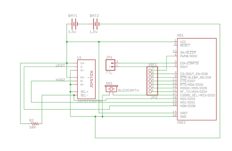

Joystick Design:

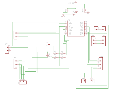

Receiver Design:
With C#, I had threads reading a proximity switch, reading the thumbstick from the Xbee, and randomly driving the dome.  I could click the thumbstick and he'd go into an autonomous mode where he would use a front proximity sensor to move around without hitting things:
