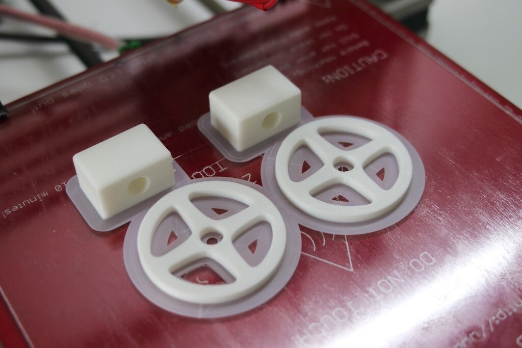

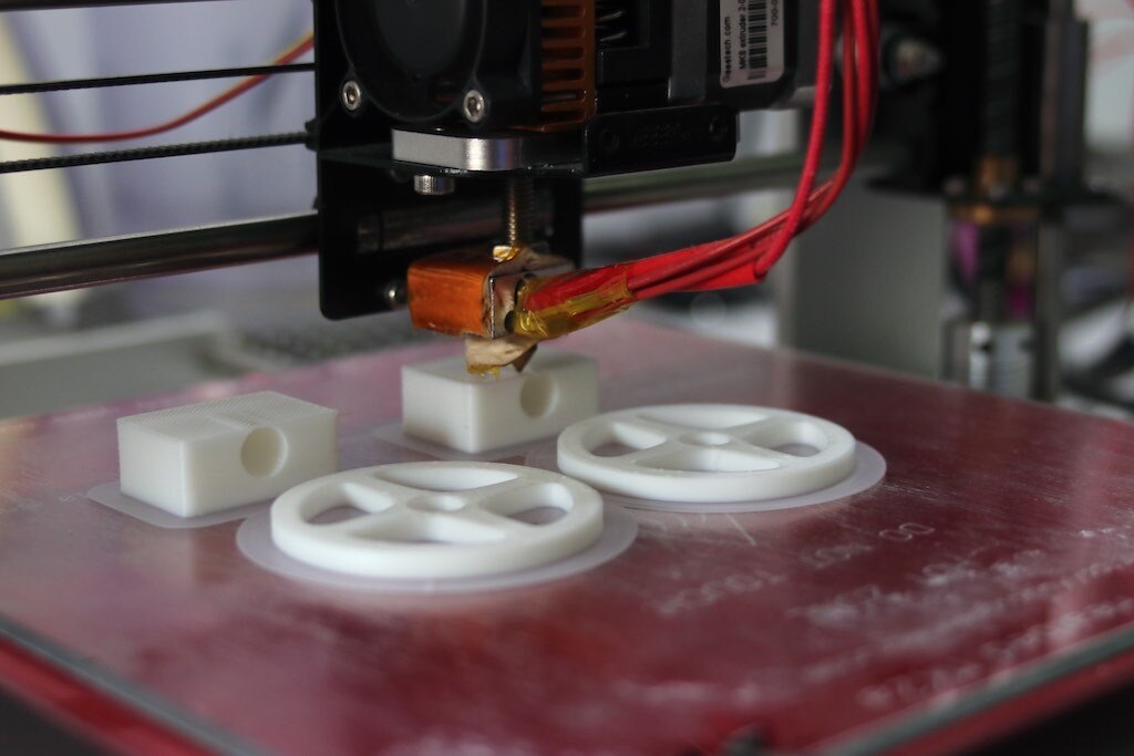

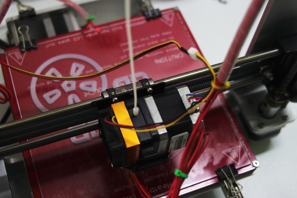

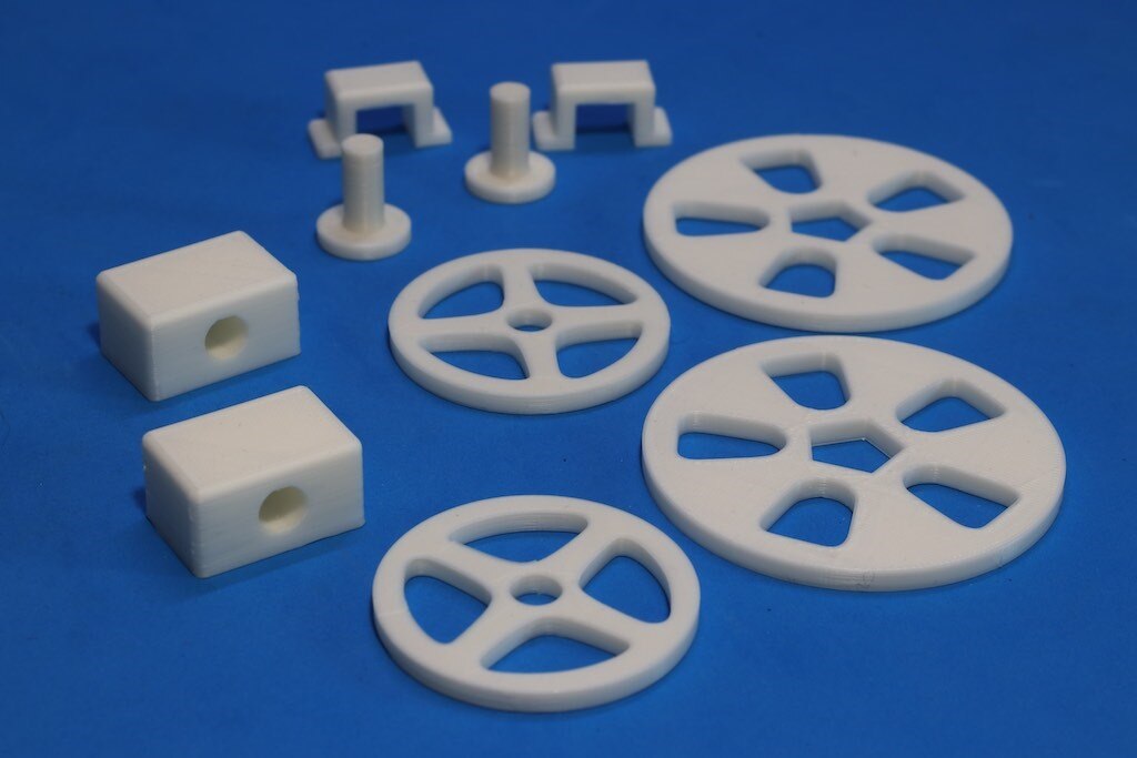

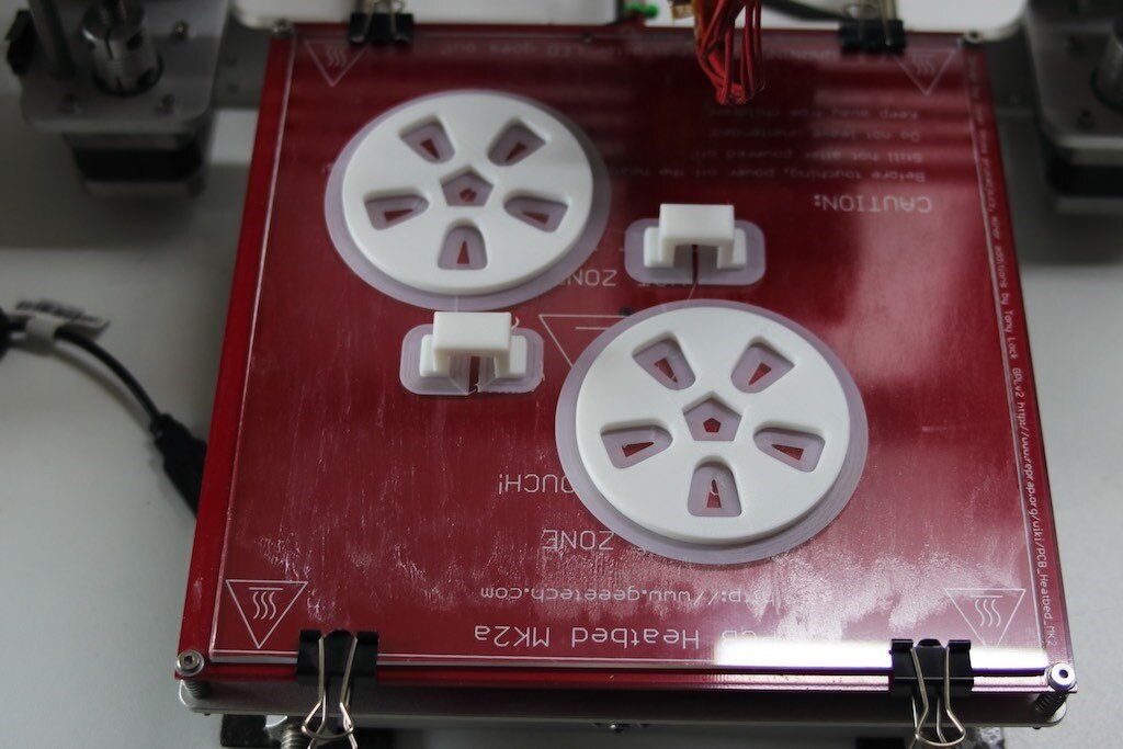

3D Printed components
It is possible to reach almost the same result without using a 3D printer, but the rotating parts and some small mechanics it was worth to make them better.
The images below shows the components used for this project:
{gallery} 3d Printed Components
Front free wheels
3D printing the driving wheels
3D printed driving wheels and motors support
The robot on wheels 3D printed components

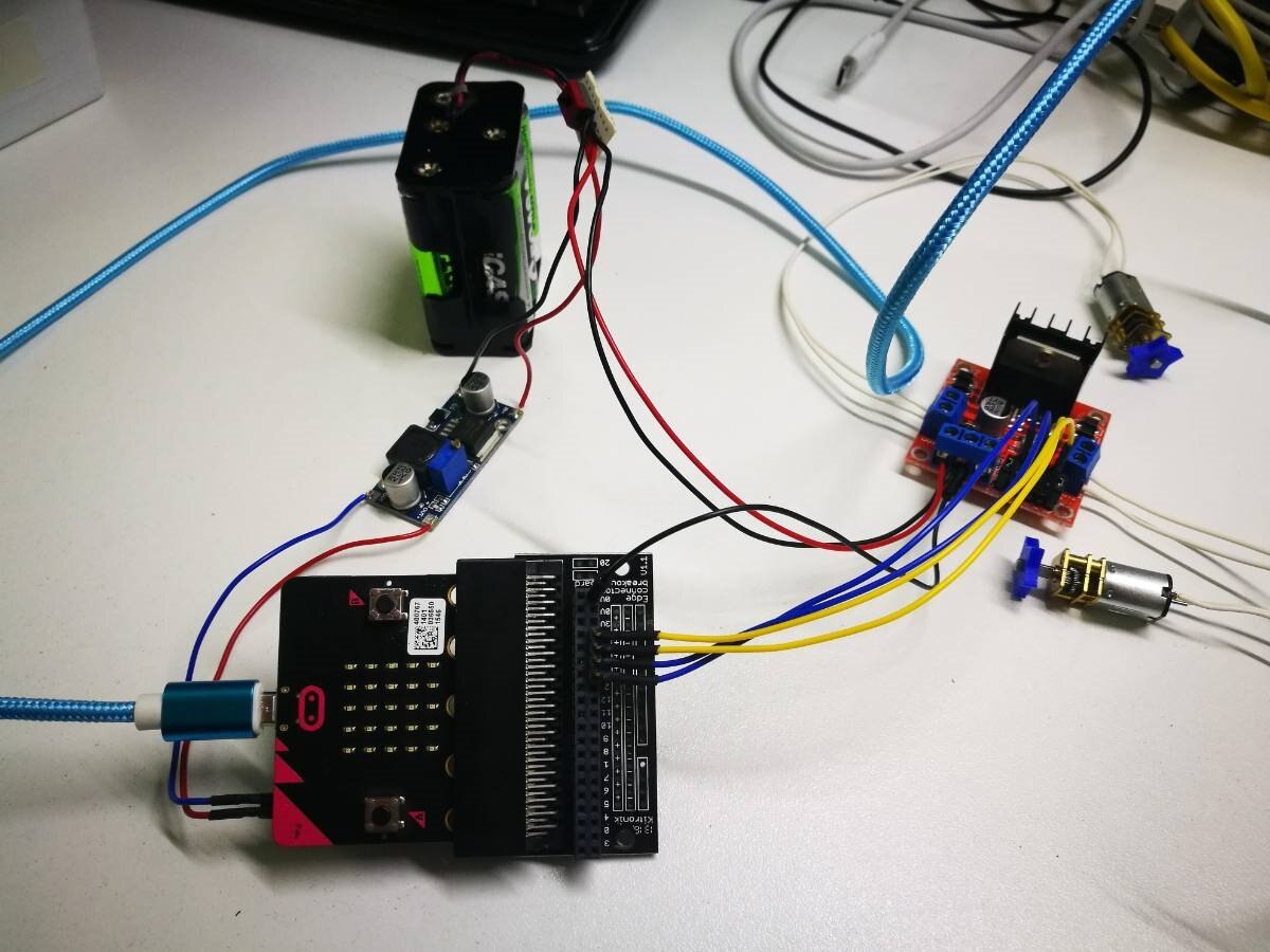

The electronic parts
The micro:bit has been inserted into the card edge micro:bit support (from Kitronik) as many pins should be used to drive the motor controller
Motors
Motion is provided by two micro geared DC motors by Kitronic. As the motors need 5-6 V to run it was necessary to build a 9V battery pack and two separate power lines for the motors and the micro:bitimage
Motor Controller
I have used a cheap motor controller from GearBest working well at low voltage (min 5V). This controller is very easy to connect and no soldering is needed. This driver can control a single stepper motor or two independent DC motors.image
Battery Pack
The super-cheap solution iI found has been a 0,50 Euro battery holder (bought at a local store) with 6xAA 1,5 V 1000 mA rechargeable batteries. I have also soldered the wires with a power switch. Note that from the power switch the power line has been doubled: a couple of wires go to the motor controller to power the motors and the controller itself and the second couple power a DC/DC step-down to power the micro:bitimage
DC/DC Converter
As shown in the side image, the DC/DC converter has been regulated to 3.0V power-out and soldered to the micro:bit power connector. This converter based on LM2596 can be bought on Amazon for about 7 Euro (4 pieces)image

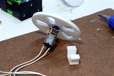

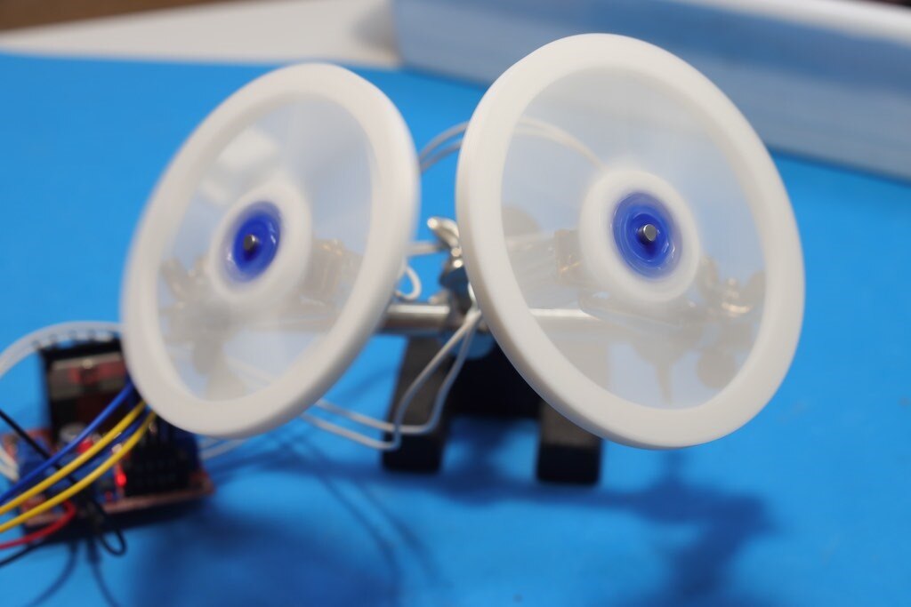

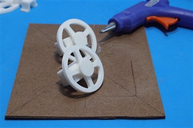

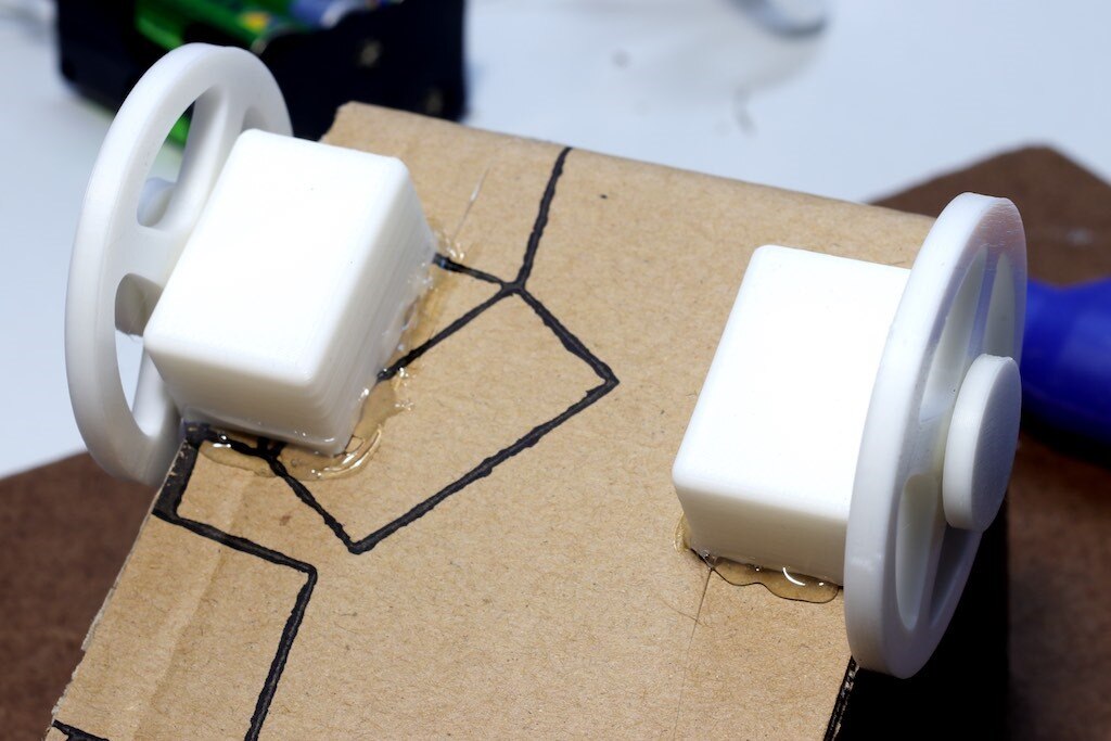

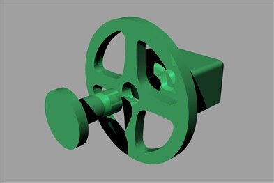

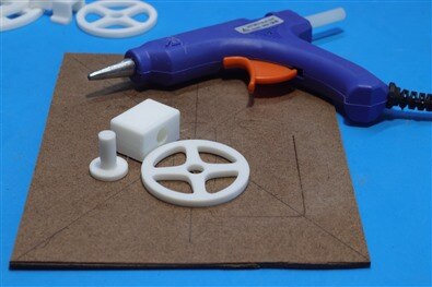

Step 1. Prepare the Wheels
The two freewheels (left in the first rendering below), I have decided to make them a bit smaller than the driving wheels and put them in front where there is less weight are built with three 3D printer pieces.
The right rendered above image shows how to assemble the front freewheel. The support block will be hot glued to the base of the chassis and the axis should be hot glued inside the block, leaving the wheel free to rotate.

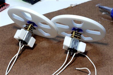

The motors are glued on the "U" support and the wheels are glued to the motor axis. As the micromotors are geared, the direct traction is sufficient to move the entire system. The image below shows the motor wheels assembled.
Then motors are tested (and the wheels well centred to the axis(

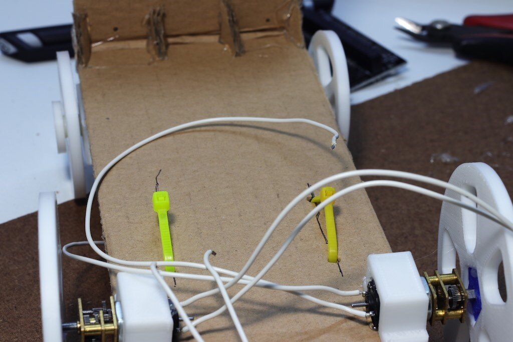

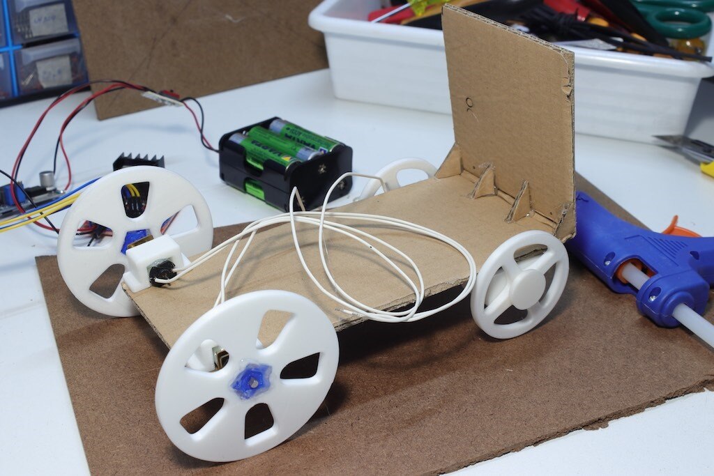

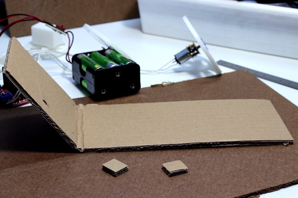

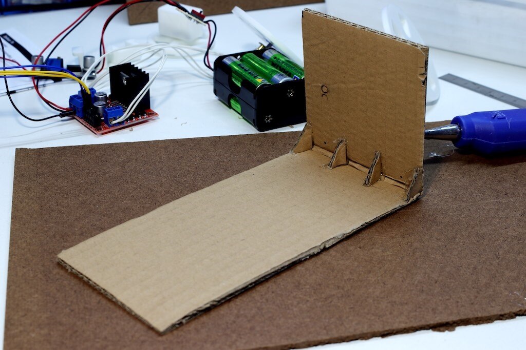

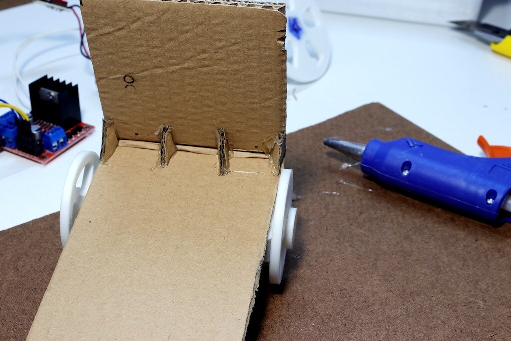

Step 2. Make the Chassis and assemble the wheels
The images below illustrate the sequence of making the cardboard chassis with the four wheels blocks hot glued (again!) to the bottom
{gallery} Assembling the Chassis and the wheels

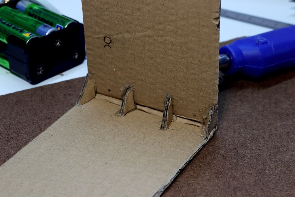

The cardboard base of the chassis
The finished chassis. Note the triangular supports to keep in place the vertical part.
Detail of the glued supports
The freewheels glued to the front bottom of the chassis. Be careful to align both blocks, the wheels should be parallel!
The front wheels from the top

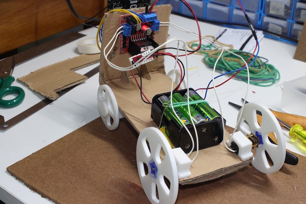

The motor wheels glued to the back of the chassis. Due to the smaller diameter of the freewheels, motors have been fixed on the top side. This solution also avoid damage to the motors while the vehicle is moving

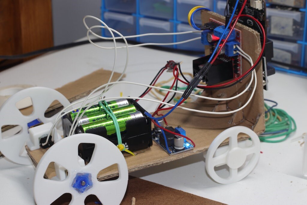

Two cable ties will keep in place the battery pack. As this is the heavies components it is fixed the nearest possible to the moving wheels.
Step 3. Adding the Electronics
The last step is gluing, gluing and gluing the electronic parts we have wired together before.

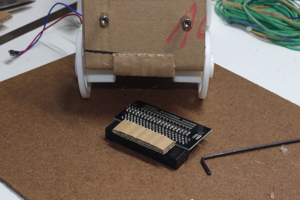

Glue a cardboard support to the back of the micro:bit connector
Then glue all to the front side of the vehicle. The support leaves space to the back of the board and make easy to disassemble the connector edge if needed.
Then, glue to the back of the front side the motor controller and the DC/DC converter to the bottom of the chassis
The battery pack kept in place with a paper-clip and a rubber band

    balearicdynamics over 8 years ago in reply to shabaz
    Thank you Shabaz,
    The idea of the blue piece ... Is a great idea to recycle the motor etc. etc. ... That's true but the reality is quite different image
    In fact, these two motors are recycled from the project TLE94112 Interactive Testing Platform I have done past year. The star was inserted with the hot solder (as suggested by shabaz for another project in 2016, remember ? LoL) and was so well put in place that seem impossible to remove. So I have adapted the concept. Then you found a good reason I will apply in the future.
