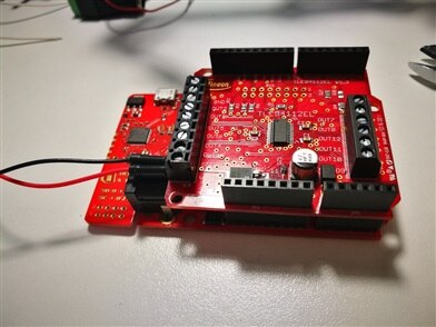

I am one of the road testers for the Infineon DC Motor Shield w/ TLE94112EL for Arduino and this project shows the testing platform I developed to test the features of the board shield, but it is also useful to test the DC motors performance, as well as other motor controller boards for Arduino.
According to me, carrying out a testing on the road of this platform based on the Infineon TLE94112 IC requires a versatile and flexible platform to make possible all the tests without building a lot of unreliable breadboarded stuff with loose wires. Moreover, in order to widen the range of possible tests making the platform reusable in the future you need to add only few extra components.
A full test of the TLE94112LE shield for Arduino based on this platform will be published in the Road Test section.

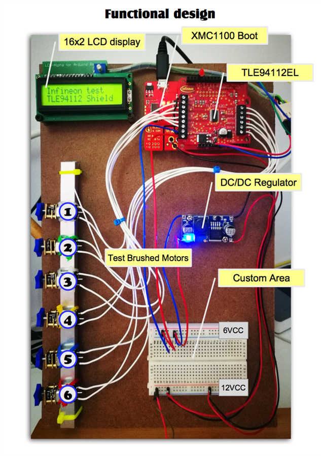

The idea of making an interactive testing platform evolved as I progressed analyzing in depth the shield features on several Arduino compatible platforms: Arduino UNO R3 , Chipkit PI and the Infineon XMC1100 Boot . All these platforms were reliable with no t special issues by the TLE94112 shield; for the final development I opted for the Infineon board due the better ARM MCU, which is faster and with more available flash and RAM memory (ARM Cortex M0 32 bit, 16Kb high-speed RAM, 64Kb Flash memory) I should admit that the better performance of this board compared to the Arduino UNO kept as reference.

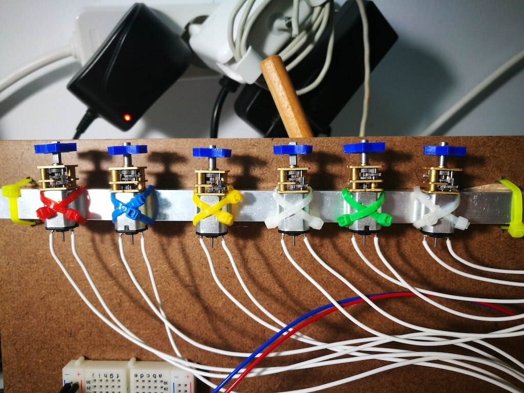

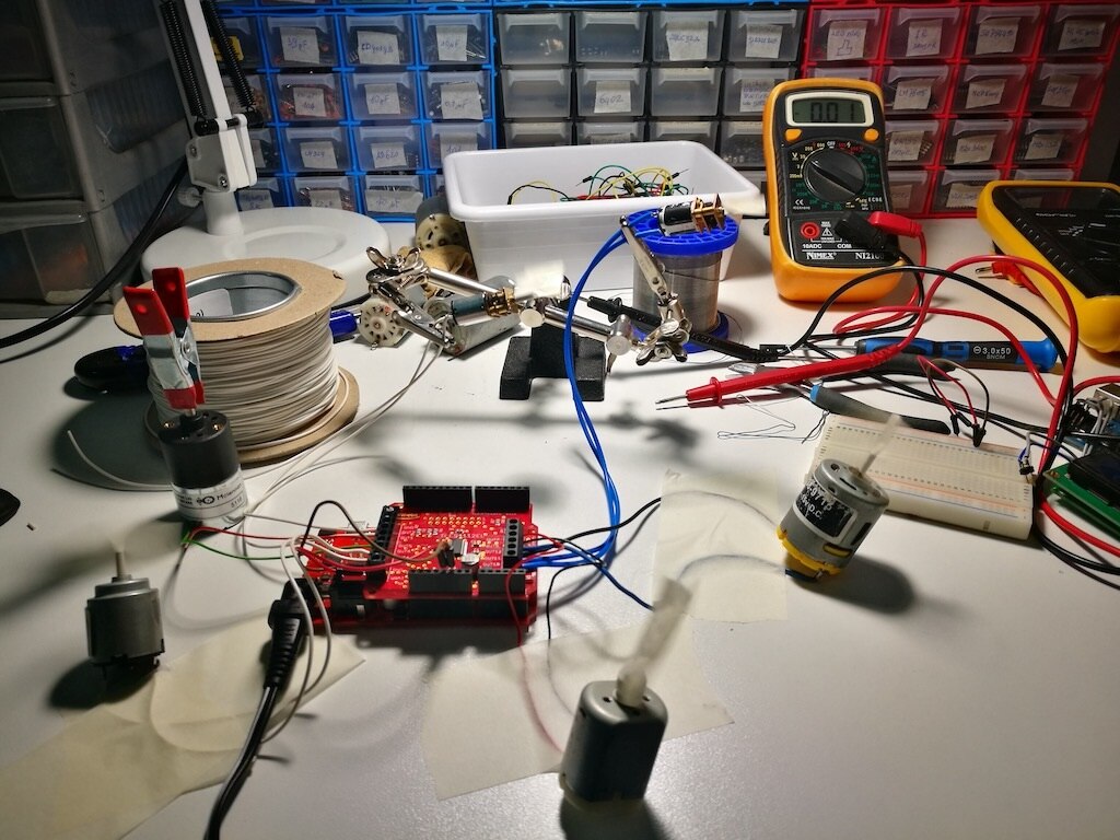

Testing motors
To create a reference for the test platform I chosen 6 brushed geared micro-motors with electrical characteristics included in the acceptable ranges of the TLE94112LE IC assembled together on an Aluminium square bar.
To that aim, I used cheap motors from Pimoroni with the following characteristics:
Free-run current @ 6V: 60mA (max 120mA) - in some conditions can generate an overcurrent that is useful to test the error registers of the TLE94112
Stall torque @6V: 2.5Kg/cm
Stall current @6V: 900mA (TLE94112LE max current per half-bridge is just 0.9A)
Gear ratio: 298:1

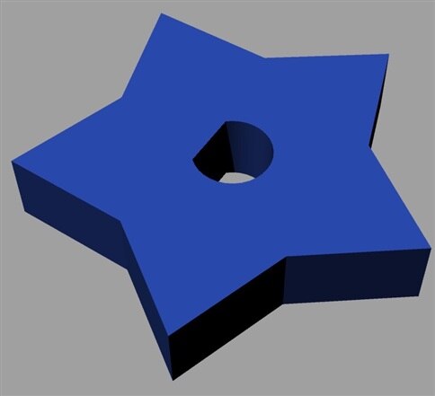

A small 3D printed object has been designed to make visible the rotation of the motors.

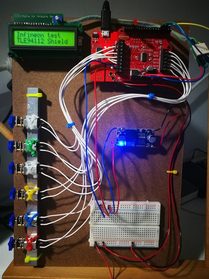

Control I/O
Using a terminal to control the shield seemed immediately the right choice as the available control options open a wide scenario of many motion possibilities. The problem arose when I saw that some status information and configuration updates need continuous and immediate feedback. To solve this problem, an LCD display has been added to the testing board.

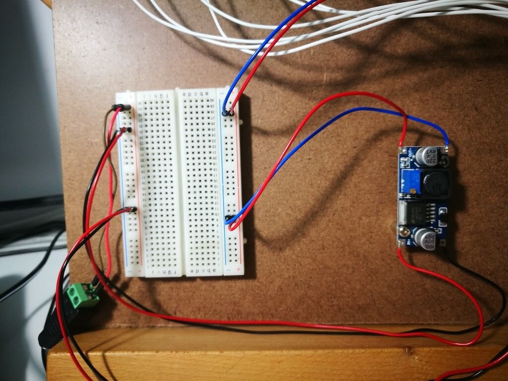

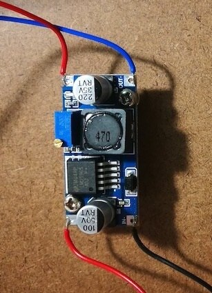

DC/DC Regulator
To provide the right power supply to the TL94112 a separate power line has been set through a DC/DC power regulator.

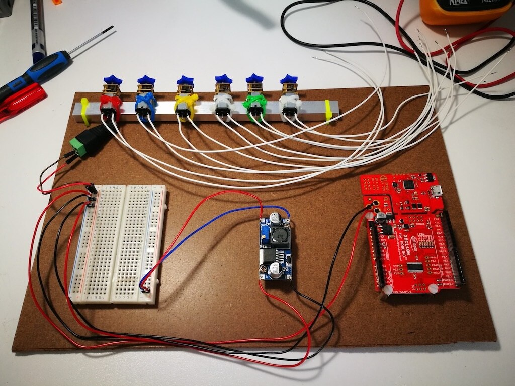

Design in practice
The working version of the design evolved around the features of the board I have experienced during the first phase of the hardware testing growing its complexity. The images below show the most meaningful steps.
{gallery} Platform design evolution

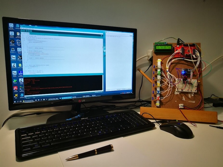

The Testing Platform
The last element added to the testing platform is a 50K potentiometer connected to the analog port 0. That will be used by the software when you need to read dynamic values (e.g. the manual duty cycle). The diagram below shows the components connection.

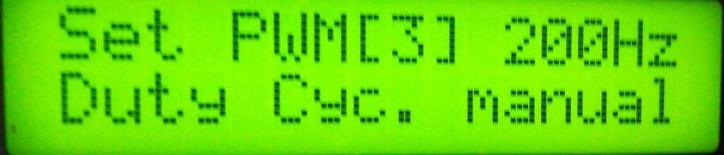

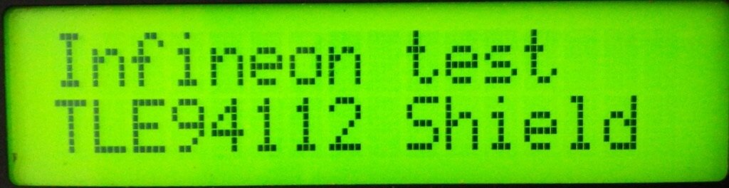

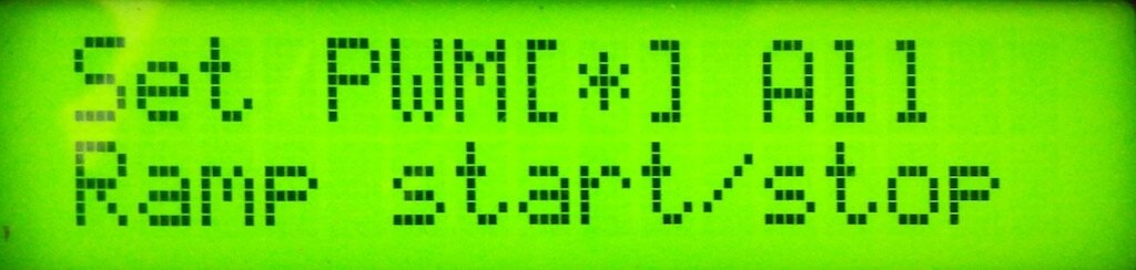

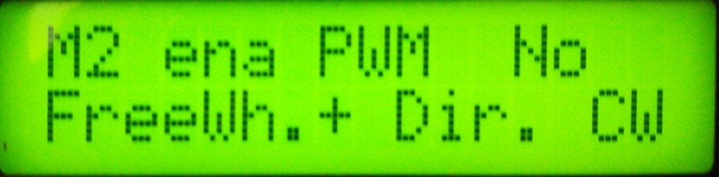

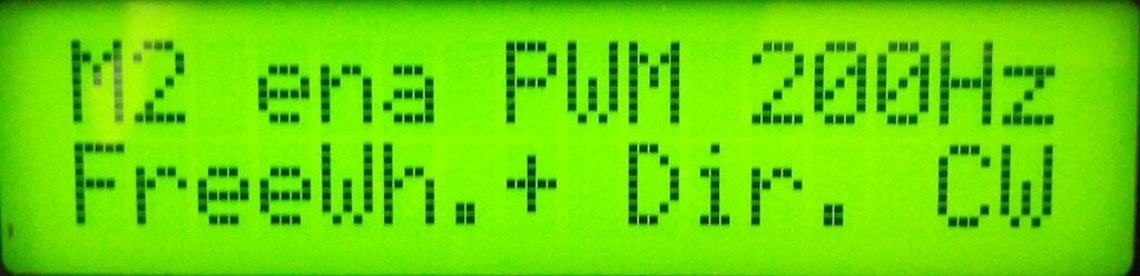

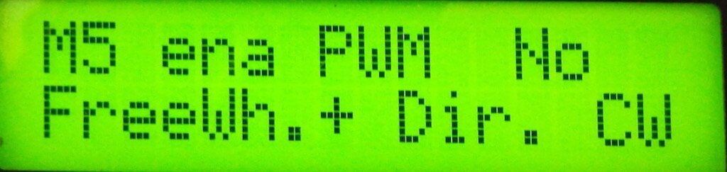

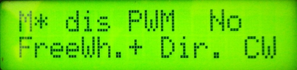

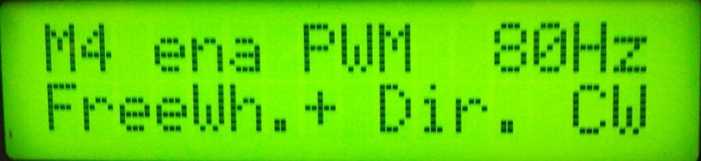

LCD layout

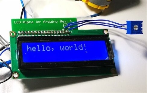

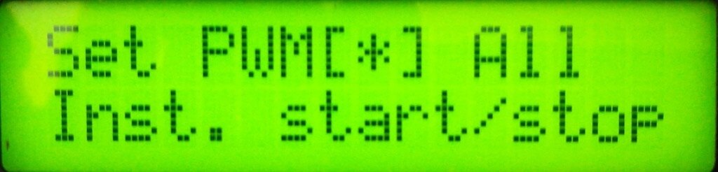

For obvious size reasons the LCD shows several layouts depending on the conditions using a layout with abbreviations; whenever possible, more readable strings have been used. The shortened symbols used by the LCD are listed below:
  • M1, M2, M3, ... M6 Set the corresponding motor
  • M* Set all the motors with the same parameter
  • PWM[1] 80Hz, PWM[2]100Hz, PWM[3] 200Hz Set one of the three PWM channels (assigned to a fixed frequency)
  • CW/CCW Clockwise/Counterclockwise direction of the selected motor(s)
  • FreeWh+/FreeWh- FreeWheeling active enabled/disabled for the selected motor(s)
  • DCMin Minimum duty cycle value for the selected PWM channel(s)
  • DCMax Maximum duty cycle value for the selected PWM channel(s)
  • ena/dis Selected motor(s) set as enabled or disabled
  • Ramp Set acceleration and deceleration for the selected PWM channel(s)
  • Inst. Set instant starting for the selected PWM channel(s)
The gallery below shows and example of several LCD layouts
