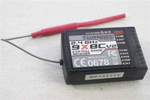

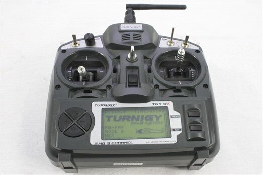

Once the mechanical structure was built and all the wheels were fixed i started by controlling it remotely using a Turnigy 9x remote controller and a 9 channel receiver for getting an idea of the movement of my robot.
I have attached the video for the same with a small load test that i performed with 14kg each boxes, i stacked three of these for testing purpose and the mechanical body really performed very well. I have also attached all the code for the same at the end of this blog with all other attachments( i am still working on the git client).imageimage

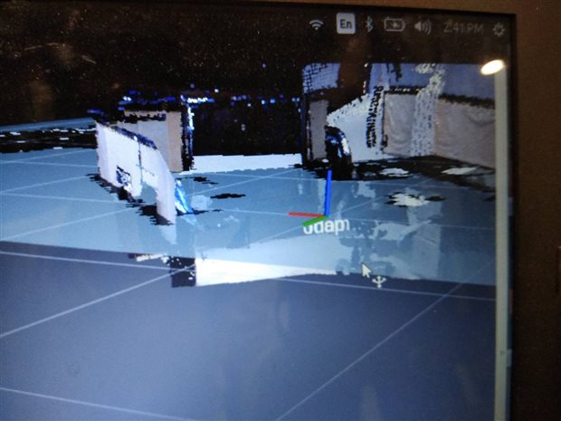

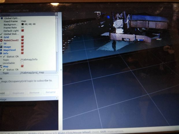

these were just to get started with the environment, however in the mean time i was working on robot operating system(ROS) for the mapping and localization problem statement, i used a kinect360 for a 3D mapping and a pseudo 2D map that was created while navigating the robot throughout the lab area. The project is yet in the research phase only but i was able to pull out some really interesting maps and localize it and navigate using the RVIZ navigation stack.
ROS and Mapping( SLAM):-
So while working on the simultaneous localization and mapping problem statement, i started exploring the ROS environment and the easy installation and huge community support played a really big role in getting everything working, i started with designing the robot using the URDF( unified robot description format) for using the robot for the simmulation purpose, the RVIZ and GAZEBO plugins were really easy to use, with a bit of  programming and making a few custom launch files i was able to get the simmulation started and then use the data for moving the real robot based on the atmega328p with an arduino bootloader. The serial library however had some glitches and serious issues with its reliability.
some of the images of map obtained using the kinect360 sensor are as follows:
