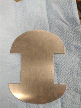

Chassis
I found a motor gearbox lying around, but it is the Tamiya Double gearbox, and the dimensions were different (narrower).
Double Gearbox (Left/Right Independent 4-Speed)

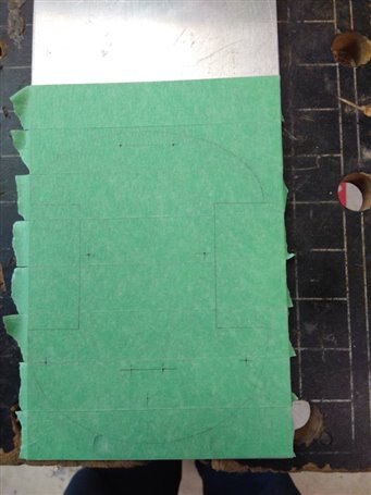

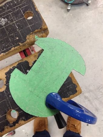

So fire up CorelDraw (As luck would have it, it wouldn't run this time) and make the necessary changes to the width.
While I was there, a few options to reverse things was deleted, the battery mounting revised and the front castor reversed to allow the cover to be mounted.

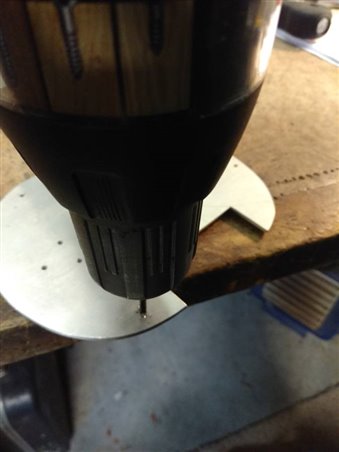

  • Printed it out (the revised plan is attached)
  • Marked it out. Masking tape protects the surface while allowing easy marking.
  • Cut it out. Jigsaw and metal blade ... a CNC would be great.
  • Drilled and taped the holes. Holes were drilled 2.5mm and then taped M3.
The edges were cleaned up using simple hand tools and some sandpaper.
I prefer to use a battery drill to tap holes. I find it easier to keep at right angles and use the lowest setting on the clutch to ensure it stops if the tap binds.
You need to use a tapping lubricant that matches the material. For aluminium Meths works but Iso Alcohol is just as good.
It's a reasonable facsimile of the paper design, so I'm on the right track. image

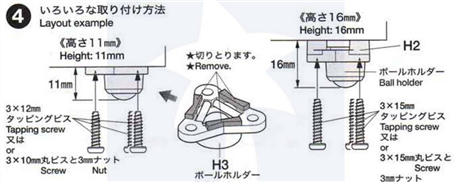

The chassis is 14mm from the surface with the choosen wheel combination.
I'm using the Tamiya 70144 ball castor  Ball Caster Set
The lowest setting is 16mm, unless you remove some of the plastic which reduces it to 11mm.
https://www.pololu.com/picture/view/0J4507
So some filing might be required, or put up with a slight rake. (I'll worry about that later)

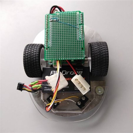

Battery
I have a stock of these 11.1v Parrot Drone batteries that my son found on sale in a local retailer.
The price was too good to pass by, so he called me up and I brought 10 of them.
I'd almost forgotten I had them until this came up and it seemed an ideal size and shape to mount.
I discovered the motors are 3v, and while 6v might be okay, the 11.1v is close to 4 times their intended design. image
The controller is able to be PWM, but that will simply reduce the overall power and it also means any speed adjustment is much coarser than it would be.
So I'm considering adding voltage reduction to the motor supply. It may not happen right away but it's being considered in the shield design.
As the picture shows, there is a single output and four smaller wires.
These are the charge controller and used to balance the charging, or supply the charge to each cell.
Without having these, you run the risk of overcharging one or more cells, which will damage them, but potentially results in a fire.

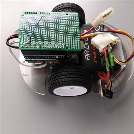

Assembly
I've run out of time to do everything I wanted.
Part of the design bloat was adding a LCD, and the mounting for that and the battery started to become a headache.
So until I resolve just where and how I intend to mount the LCD, I've opted for a cheap simple mount ... some double sided foam tape.
Some double sided tape holds the battery in place, and I've even left off the range finder.
Somehow I managed to overlook the battery connector. image
I'd ordered some that fit the battery ... and then decided to use these batteries ... BUT I failed to notice it had a different connector.
One IDE drive power extension sacrificed it's life in the cause ...image
As I said earlier the numbering will allow for ver 2.1 image
