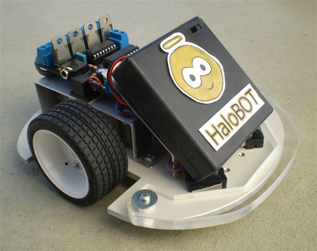

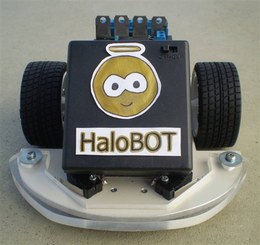

This robot was a collaboration between my daughter and I.
The idea was she could use flowchart software to program it, however that never really happened.
The design was based on an earlier and slightly larger model I built.
I had assisted the local school in a challenge and felt the 'feelers' that were used for sensing a wall were too delicate and bent if they hit too hard or got caught, so I worked on a bumper system.

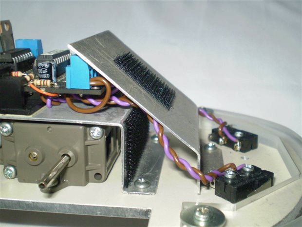

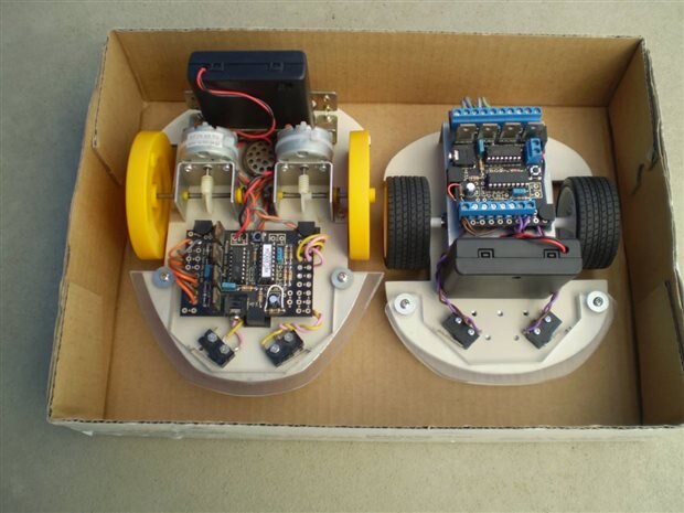

Version 1.0 on the left and ver 0.9 HaloBOT on the right.
A second angled plate was fitted and the battery pack velcros to this.

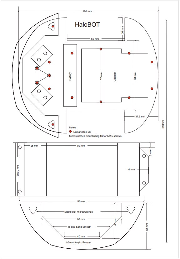

As the drawing shows the shape of the bumper was made to help prevent it getting stuck.
HaloBOT was essentially Ver 2.0 using commonly available parts (board), motors and wheels.
It uses a castor underneath that glides on the surface to act as a nose wheel.
The design was refined by Hayley and once built she added the graphical touch to it.
HaloBOT was the name she gave it.

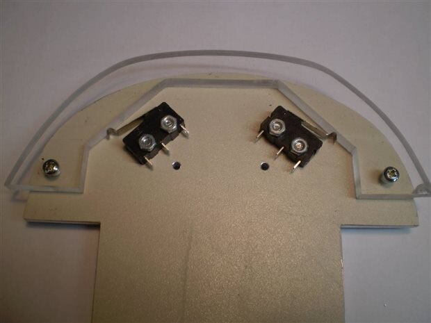

Bumper

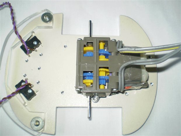

The design of the front bumper is such that it can detect three different touches, using two switches.
This shows the bumper before the triangle shaped clearance holes were filled.
It also shows a chip in the corner which was 'removed' by some rounding.
Pressure on the left side operates the left bumper switch. Pressure on the right side operates the right bumper switch.
However pressure directly onto the front of the bumper will operate both switches.
This is achieved by making the mounting mount float (the screws are have a lock nut on the bottom), and the 45 deg angle surface the micro-switches connect with.
The spring action inside the micro-switch provides the necessary centering action without any additional springs.
The use of acrylic also means it is non marking (or hard to isolate what caused those marks), and the shape means it can push it's way past if you get the programming wrong.

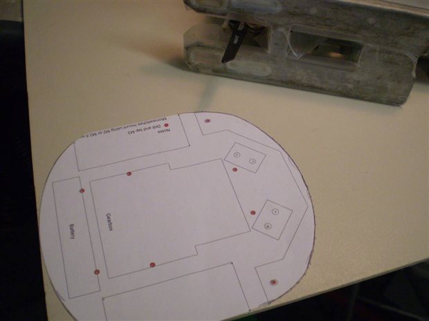

Plan
You should be able to enlarge this using the measurments as a guide, and print full size to use as a template.
Stick it down onto ypur material of choice, and cut out.
Wheels
Tamiya provided the wheels, and I discovered that these are one of the 'stickiest' off the shelf, meaning it has the best traction if your motors are up to it.
The Tamiya gearbox allows for multiple ratios and is cheap and robust, although not very good in dirty situations due to it's open construction.
Updated My software code included this note  ...... Tamiya Dual Gearbox at 114.7:1 ratio (Type C) and 56mm wheels
The gearbox configuration changes depending on which ratio you choose, so multiple mounting holes were provided, however we've never changed it.
The gearboxes are easy to mount and together with the wheels make a very simple construction.

Chassis
The chassis of any robot is the backbone.
Because these tend to be a WIP (Work In Progress) you need to allow room for extras to be added, and mounting can be a problem.
The chassis was constructed using 5mm aluminium that was recycled (previous life was a blank panel in a rack) and most holes are drilled and tapped for M3. (use meths as the lubricant for the tap)
The intention was to enable it to be made using basic hand tools.
I've seen the odd robot using a very lightweight chassis which can flex and bend, or becomes too hard to add extras, so while this could be considered as over engineered, in this case it wasn't going to be the fastest or lightest bot.

The video show Halobot trying to escape the lid of an A4 Paper box.
It keeps on going and never really understands that it can't escape, but does provide entertainment.

    What did you use as the third wheel?
    Tamiya castor 70144
    Comes with the ability to have a couple? of heights.
    Pololu have a different version
    https://www.pololu.com/product/951
    Cheers Mark
    balearicdynamics over 8 years ago
    Mark, it's a great project. What did you use as the third wheel?
    The solution to detect the obstacles seems very efficient and more reliable than a loft of alternatives I saw.
    Enrico
