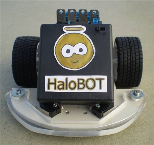

This robot was a collaboration between my daughter and I.
The idea was she could use flowchart software to program it, however that never really happened.
The design was based on an earlier and slightly larger model I built.
I had assisted the local school in a challenge and felt the 'feelers' that were used for sensing a wall were too delicate and bent if they hit too hard or got caught, so I worked on a bumper system.
Version 1.0 on the left and ver 0.9 HaloBOT on the right.
A second angled plate was fitted and the battery pack velcros to this.
As the drawing shows the shape of the bumper was made to help prevent it getting stuck.
HaloBOT was essentially Ver 2.0 using commonly available parts (board), motors and wheels.
It uses a castor underneath that glides on the surface to act as a nose wheel.
The design was refined by Hayley and once built she added the graphical touch to it.
HaloBOT was the name she gave it.
Bumper
The design of the front bumper is such that it can detect three different touches, using two switches.
This shows the bumper before the triangle shaped clearance holes were filled.
It also shows a chip in the corner which was 'removed' by some rounding.
Pressure on the left side operates the left bumper switch. Pressure on the right side operates the right bumper switch.
However pressure directly onto the front of the bumper will operate both switches.
This is achieved by making the mounting mount float (the screws are have a lock nut on the bottom), and the 45 deg angle surface the micro-switches connect with.
The spring action inside the micro-switch provides the necessary centering action without any additional springs.

Tamiya provided the wheels, and I discovered that these are one of the 'stickiest' off the shelf, meaning it has the best traction if your motors are up to it.
The Tamiya gearbox allows for multiple ratios and is cheap and robust, although not very good in dirty situations due to it's open construction.
Updated My software code included this note  ...... Tamiya Dual Gearbox at 114.7:1 ratio (Type C) and 56mm wheels
The gearbox configuration changes depending on which ratio you choose, so multiple mounting holes were provided, however we've never changed it.
The gearboxes are easy to mount and together with the wheels make a very simple construction.
The power consumption is very light, and therefore the battery voltage remains constant which makes programming easier.
Some other bots have high speed and high discharge, so 0.25 secs motor at the start makes the bot travel much further than 0.25 secs after some time in use.
These have no encoders so there is no correlation with time v distance travelled.

The chassis was constructed using 5mm aluminium that was recycled (previous life was a blank panel in a rack) and most holes are drilled and tapped for M3. (use meths as the lubricant for the tap)
The intention was to enable it to be made using basic hand tools.
I've seen the odd robot using a very lightweight chassis which can flex and bend, or becomes too hard to add extras, so while this could be considered as over engineered, in this case it wasn't going to be the fastest or lightest bot.

The board is based on Picaxe 18 and was programmed in Basic.
The Picaxe software can be programmed using a flowchart, which removes the need to understand Basic.
It does provide an early and easier learning curve, which was the reason it was chosen (at the time).
HaloBOT is programmed to wait after it is turned on, wait for a bumper switch to operate, then move forward until it detects a wall.
It will respond until it detects a wall and respond accordingly with the aim of keeping it moving forward.
Since there is no vision and both motors were travelling forward, the angle of collision is not known, hence there are two options when it touches a wall :-
  • stop the motor on that side and reverse the other motor, then move both motors forward.
  • Stop both motors and reverse both, then make the motor on the side that touched go forward first, followed by the other motor.
As you can see there is a difference in the amount the bot clears the wall by, and how quickly forward progress is made.
Any time you reverse, you will lose time and distance travelled.
The next problem was being stuck in a corner.
The worst is striking the corner at 45 degs where you react to one side touching followed by the same reaction on the other side, and it repeats.
In this case we counted the contacts and then made the next touch add more time to the sequence to break the deadlock.
This shows in the video as a 'pause' to show it is thinking about the next move, and it carries on.
