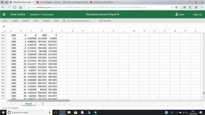

I am using the serial monitor within the Arduino IDE to display the range values which means using a USB cable to connect to RoboBobLet. This avoids the need to keep unplugging the HC06 Bluetooth link every time I re-program the Nano, with the added benefit of providing power to RoboBobLet thereby saving the batteries. It is possible that this might have an impact on the operation of the laser distance sensor, depending on it's current requirement so I am not intending to do any fine tuning of the system until it is all fully battery powered later on. I then just cut the string of numbers from the serial monitor display and paste them into an Excel spreadsheet. I am using the online version of Excel as I am relunctant to pay for a PC copy. It is almost as good but a bit slower in places due to the use of the cloud for storage. Below is a screen dump of the distance data.
Sorry about the small text but the online version of Excel seems to restrict the ability to cut and paste images so I am using screen dumps. The first column on the left contains the distance values cut and pasted from the serial monitor display. Then in the next column I have added the angle values, increasing by 2 degrees on each row. The third row contains the angles converted from degrees into radians as the trigonometric functions within Excel use radians. The fourth column is the X value (Rcos(angle) where R is the distance) and the fifth and final column is the Y value (Rsin(angle). By calculating the (X, Y) values then a scatter graph can be inserted into Excel, as illustrated below.

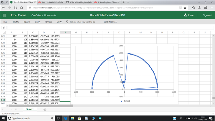

By using the scatter graph within Excel it is possible to plot a birds eye view of the distance values obtain, scanning anti-clockwise. There is a small spike at the beginning of the scan. I'm not entirely sure what this is but it is always there so it might be some part of the RoboBobLet chassis that is being detected. The main semi-circle is the maximum range set for the distance sensor, currently set to 1000 mm, which shows that not much is being detected. In fact there was only one small object, a 1 cm square wood strip placed at approximately 200 mm in front of RobBobLet, which can be identified by the indentation at approximately 90 degrees (immediately in front of the chassis).

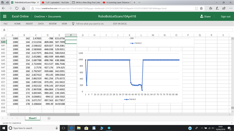

This is OK but doesn't seem to provide much information about the object. An alternative way of plotting is to use a different graph within Excel and just plot the distance values. As they are equally spaced at 2 degrees there is no need to use the angle values. This produces the graph shown below.
Apart from the peculiar spike at the left, this graph clearly shows the detected object. It does have a strange little peak on the right hand edge of the object, which again, I am not sure what this is caused by but it is repeatable so it much be a function of the system somewhere. The distance is shown along the Y axis and indicates that the object is at an approximate distance of 200 mm from the sensor which is correct. It also shows that the beam width of this thin object is 24 degrees. This is what was expected with a FOV of approximately 25 degrees and a thin object. This seems to be a repeatable set of results but further testing at different distances and different object widths is needed in order to gain confidence in these sensor results.

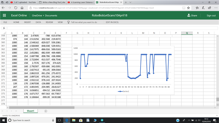

And just in case you might be thinking this is a perfect little sensor, let me show you some of the earlier results I obtained, where environmental impacts affected the results. It is the same single object in an otherwise empty plane.
    You have indicated that you're using the USB to power the device, along with the servo and the Laser.
    Have you considered it may be power supply related?
    We continually see issues when motors are driven without adding a decent sized capacitor across the supply to the motor.
    I ran into weird results with a Ping sensor and Neopixels doing this.

    Very nice update to your robotics project.  Interesting data that you have acquired.  Is it possible that the small glitch at the beginning/ending of your sensor sweep is you?  From the camera angle in your video, it seems to occur near to where your position might be.  Also, the servo seemed to be not exactly centered and maybe the front wheel of the robot comes in view of the sensor at the extreme end of the movement.
