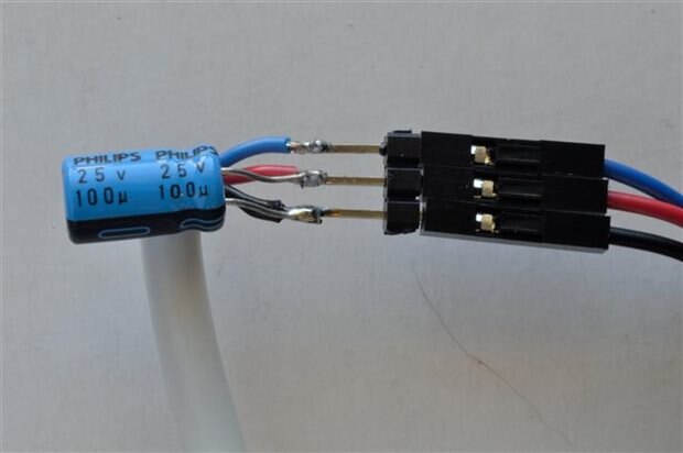

Short Distances
I was getting random short distances that made no sense.
I tried slowing down the Ping rate which seemed to help, but not make the problem go away.
I tried changing the hardware, using the theory it was faulty, but still I got random values that were short.
I tried a new library, various averaging approaches and searched the internet to see if the issue was common.
I found a site where the author used the "Running Median" of several readings, and while the code seemed to work at short distances, anything longer than 1m seemed to cause these random short distance values.
In the end I needed to start assembling the hardware in order to take some photos.
During the assembly I followed the instruction here that specified adding a 1000uF capacitor across the NeoPixel power wires.
    100uF instead of the 1000uF   photo source : three minions (me, myself and I)
When I next connected the assembled unit to the computer, it behaved perfectly with no short distances.
So my conclusion is that while the lack of capacitor didn't impact on the Neopixels, it did manifest in the Ping Sensor which was hanging across the same 5v source.

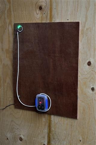

If it is pressed and held at power-up, the display changed to three Green pixels to indicate the SAFE distance is stored when you push the button.

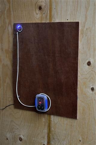

Once you have set the SAFE distance, the display changes to three Blue pixels to indicate the WARN distance when you push the button.

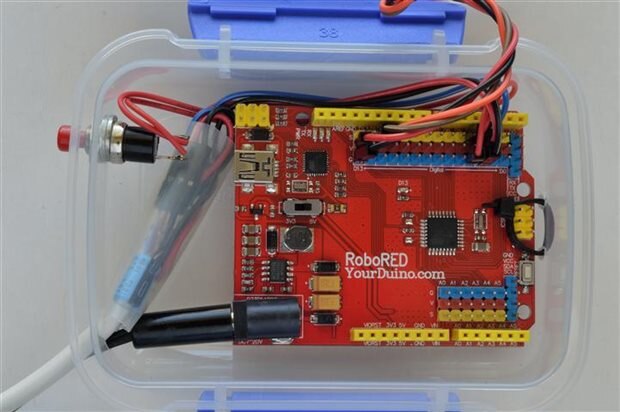

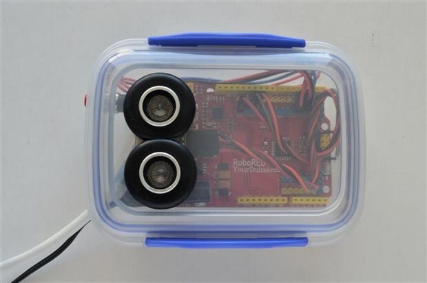

Assembly
This version was done for The Shed Magazine which use this version of Arduino UNO.
It allowed me to connect everything to the pins using female to female jumpers, but the same concept will work for a normal UNO.
The case is a food type container from a large retailer and at $2 makes a very suitable enclosure

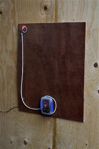

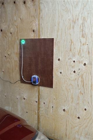

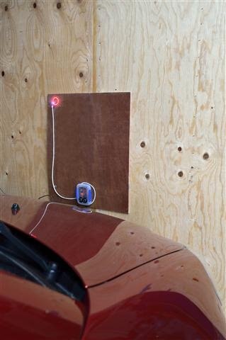

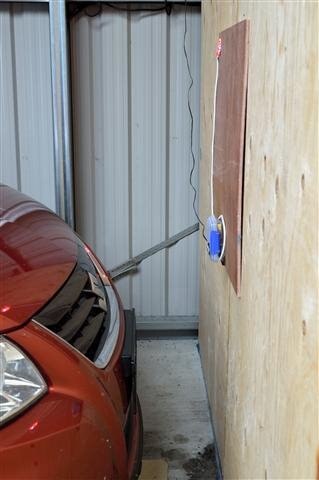

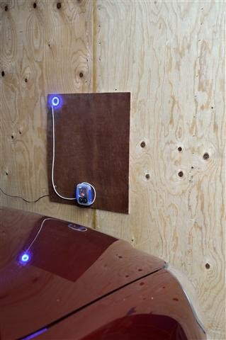

Did it work
Since my daughter moved out, I don't have a parking issue, but if she returns this would be much better than the "stick that moves" we used to have before.
The photos below show the false wall I put in my garage to test it out.
I was very happy with the results.
This is the final distance, and from the drivers seat looks like it is touching.
Normally you would be reversing into the garage and having the issue of parking in the right spot, but everyone's needs are different, and this works forward or back.
The relative position of the display v the sensor may need changing to suit the vehicle and direction.
I mounted it over to the right to allow viewing in an external mirror.
