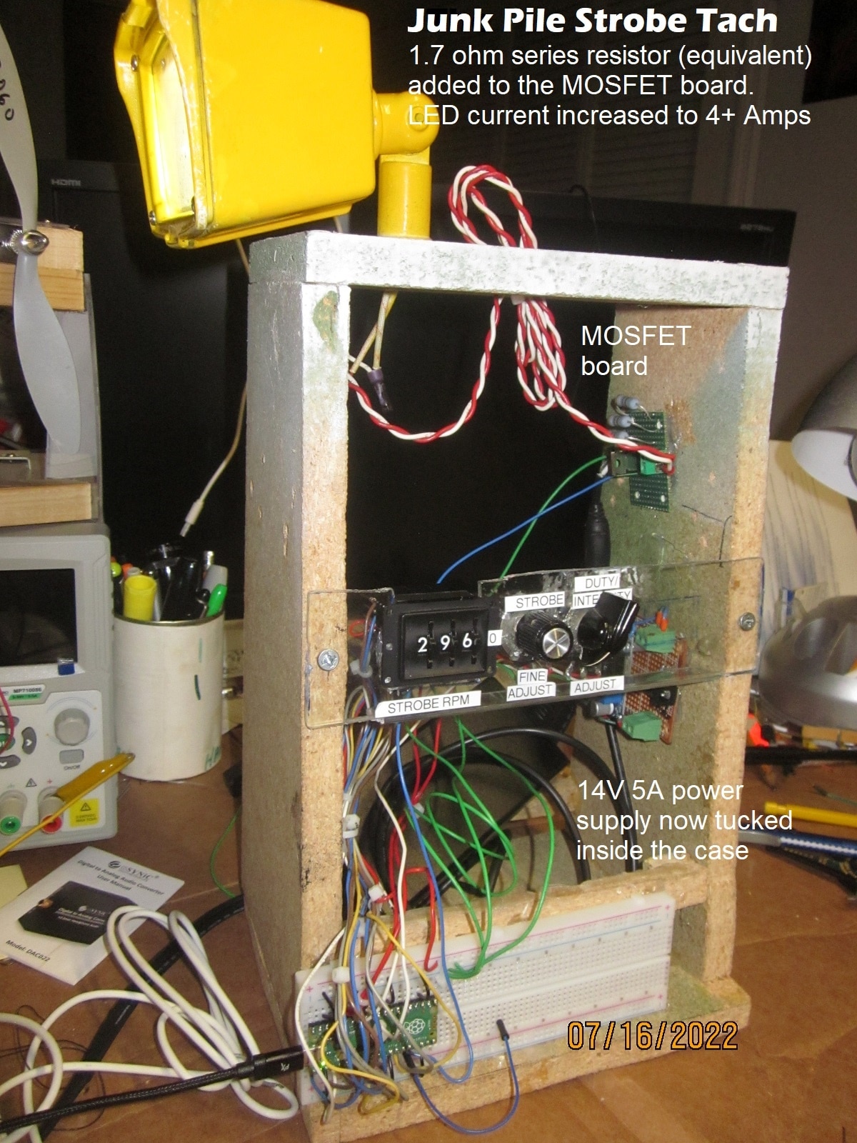

This project idea was inspired by a need to measure the speed of random - no nameplate DC motors salvaged from printers, cars, toys, and experimenter’s kits.
  • In the spirit of Rube Goldberg, I’d use as much workshop junk as possible to build this test instrument.
  • Clunkiness and awkwardness is encouraged in this build. The older the part the better, old technology is quaint.
  • Raspberry Pi Pico was selected as a controller based on its low cost, nice clock speeds and the easy way python programs with PWM.
  • More Rube-ness – My workdesk (ping pong table) has a Raspberry Pi dedicated to programming Raspberry Pi Picos in Thonny. A windows PC is used to VCN into the Raspberry Pi for control and WinSCP for the W10 PC to fetch the python code from the Raspberry Pi to the W10 PC.
A video of the strobe tach working:
photo of 1st version of prototype
Key Points of Learning by Doing:
1. I can’t believe it worked as well as it did. This project was really fun, very hard to put down.
2. In the Python libraries I found, PWM frequency is commanded using an integer --- which means pulse reference is in one Hz increments i.e. 1 Pulse per second. If measuring in rpm, the best rpm setpoint resolution achievable using pwm libraries is 60 rpm  L
3.The micropython PWM frequency integer setpoint has a low limit of 8 Hz. Values below 8 causes the python program to error.
4. In the spirit of Rube, the motor speed was synchronized best as possible using the strobe thumbwheel rpm speed setpoint, then the DC motor voltage was adjusted up or down to get strobe synchronization.
5. My design included a Duty cycle/intensity adjustment pot. I’d thought 50% duty might be too long to get a good synchronization with a rotating marker, and maybe too bright. I was unexpectedly learned that not only 50% duty was way too much, best results were seen at duty cycles of .01% - . 1%.
6. With a PWM duty cycle set so narrow, the pulse intensity needed to be increased. Just like with small LED being strobed at peak current 3X nominal,         significant improvement was seen after driving the LED floodlight at nearly 2X rated current, 3.5X the current I was driving them for steady state             lighting. The original power supply feeding the project was 2 amps.  To get higher current, the LED power was changed to feed from a 14Vdc 4.5A laptop supply, with a 2 ohm 70W resistor in series. After proving out the 2 ohm resistor solution was a good direction and analyzing the duty cycle range, the series resistor only needed to be a couple watts ( in spite of the fact the RMS watts are very low, the resistor needs to be mechanically able to take a 4A slug of current).
I just happened to find 3.8 ohm 2W resistors in my eclectic resistor junk drawer. Qty 3 in parallel decreases the resistor ohms value  allowing more Floodlight LED current and the watts loss & peak current can be shared by the 3 resistors effectively. The 2W resistors are easily added to the MOSFET card. In further running, the resistors are cool to touch.

  • Analog pots were used for trim on frequency and duty cycle, not realizing how important the Duty cycle adjust would be and how insignificant the frequency adjust pot would be.
  • The motor rpm was checked using an industrial calibrated strobe tach. Amazingly the rpm values are within the 60 rpm accuracy window of the rpms seen with the Junk Pile Strobe Tach.
