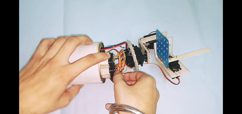

Step 2: Assembling
AssemblingAssemblingAssembling

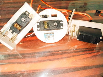

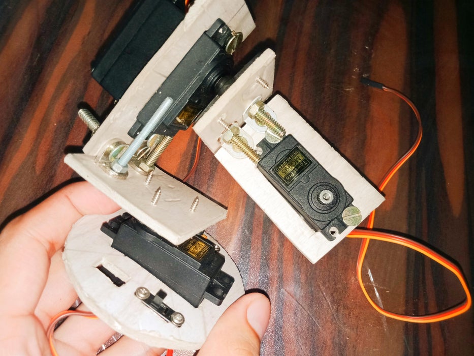

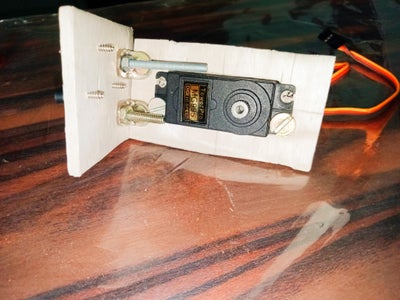

Foamcore, foam board, or paper-faced foam board is a lightweight and easily cut material used for mounting Servo motor and for making scale models.

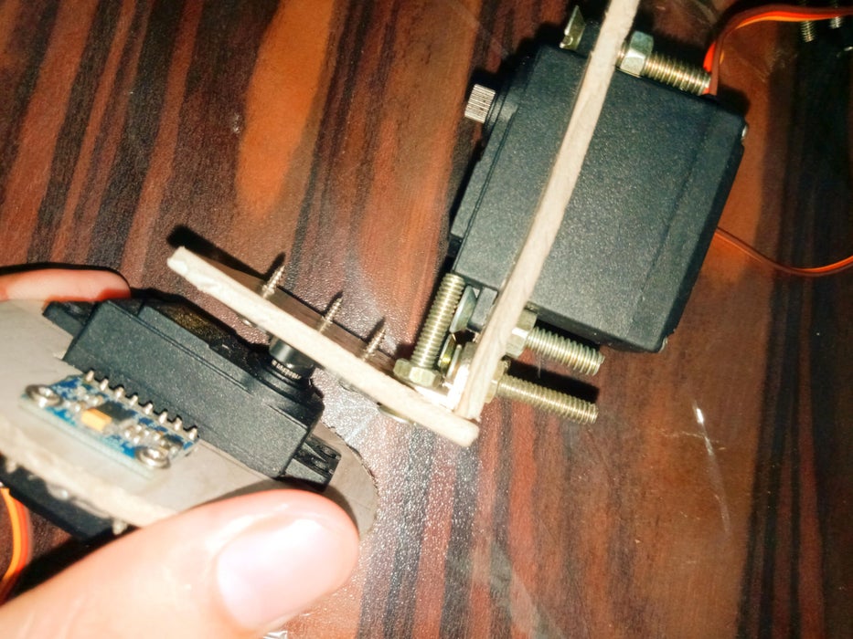

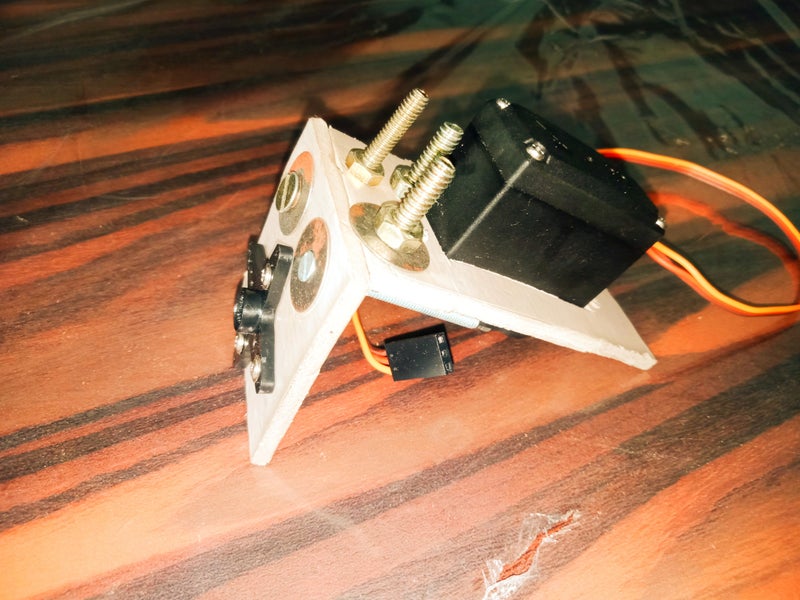

Firstly I made a DIY L-shape brackets to mount servo motor with the help of foam board.
Step 3:

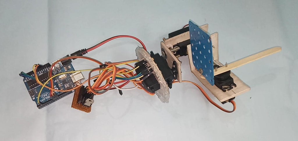

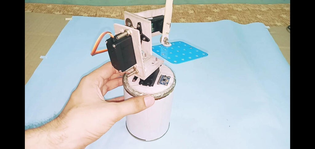

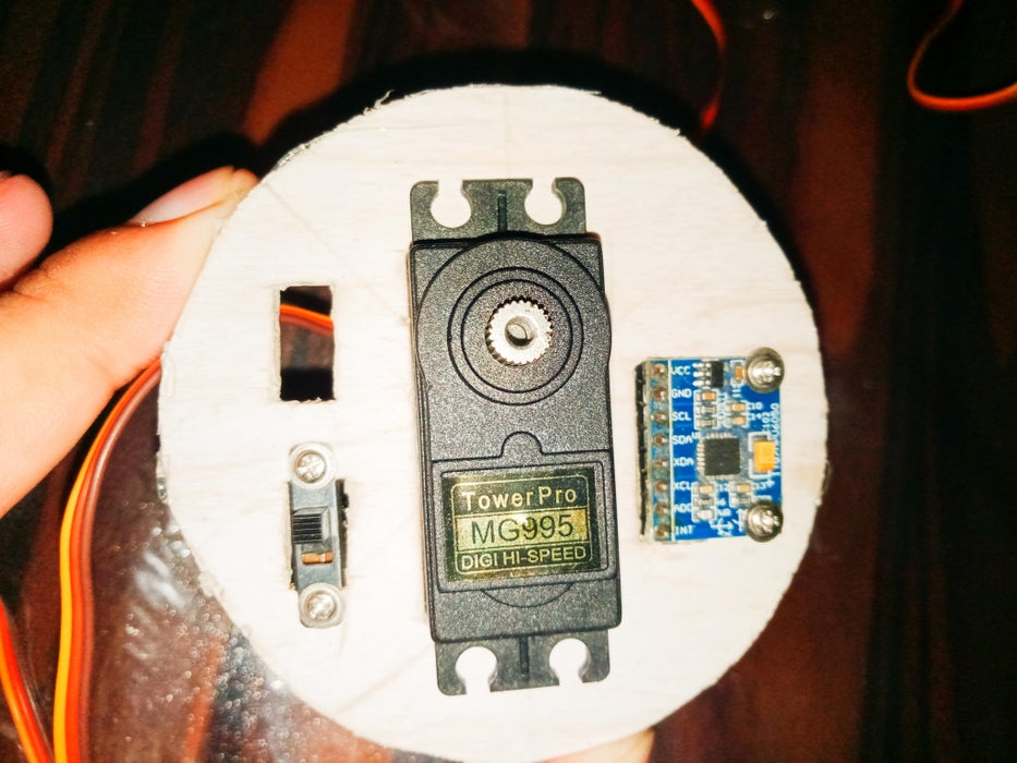

Assembling the gimbal was quite easy. I started with installing the Yaw servo,MPU 6050 sensor and ON-OFF switch. Using bolts and nuts I secured it to the base
Step 4: Next, Using the Same Method I Secured the Roll Servo. the Parts Are Specifically Designed to Easily Fit the MG995 Servos
Step 5: Next, Using the Same Method I Secured the Roll Servo. the Parts Are Specifically Designed to Easily Fit the MG995 Servos

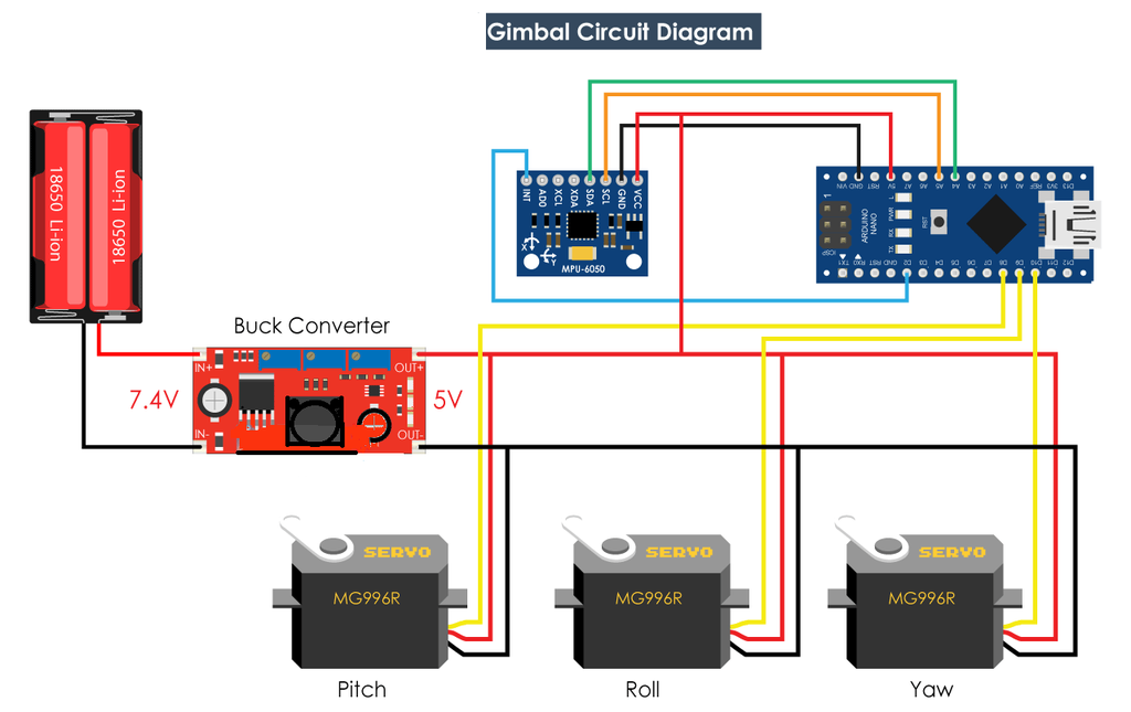

Step 6: Connections
Connections
In the circuit diagram you can use either buck converter or 7805 Voltage regulator IC to convert 8V to 5 V.The microcontroller which is given the circuit diagram is Arduino Nano you can also use Arduino Uno,Arduino Mega.
The SCL and SDA pins of MPU 6050 is connected to Arduino Analog pin A5 and A4.(SCL and SDA pin may vary so check out datasheet for SCl and SDA pins for other microcontroller)

Step 9: When All the Components Are Connected ,its Look Similar to This Picture
Step 10: Now Insert All Base Stuff Inside the Food Can
Step 11: When All the Wires and Components Are Placed Inside a Food Can Then Applied Glue Gun at the Base of Foam Board.
Step 12: Conclusion
Please note this far from good camera gimbal. The movements are not smooth because these servos are not meant for such a purpose. Real camera gimbals use a special type of BLDC motor for getting smooth movements. So, consider this project only for educational purpose.
