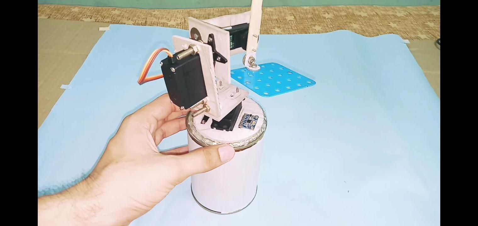

Hello Everyone,My name is Harji Nagi.I am currently a third year student studying electronics and communication engineering from Pranveer Singh Institute Of Technology,Kanpur(UP).I have a keen interest in robotics,arduino,Artificial Intelligence and Analog electronics.
The word “gimbal” is defined as a pivoted support that allows rotation of any object in a single axis. So a three-axis gimbal allows any object mounted on the gimbal to be independent of the movement of the one holding the gimbal. The gimbal dictates the movement of the object, not the one carrying it.
It consists of 3 MG995 servo motors for the 3-axis control, and a base on which the MPU6050 sensor, the Arduino and the battery will be placed.It’s used to keep the camera stabilized with no vibration. A 3-axis gimbal ensures that the motion of the camera is stabilized even if the one holding it is going up and down, left and right, front and back. This is what we refer to as yaw, pitch, and roll stabilization.

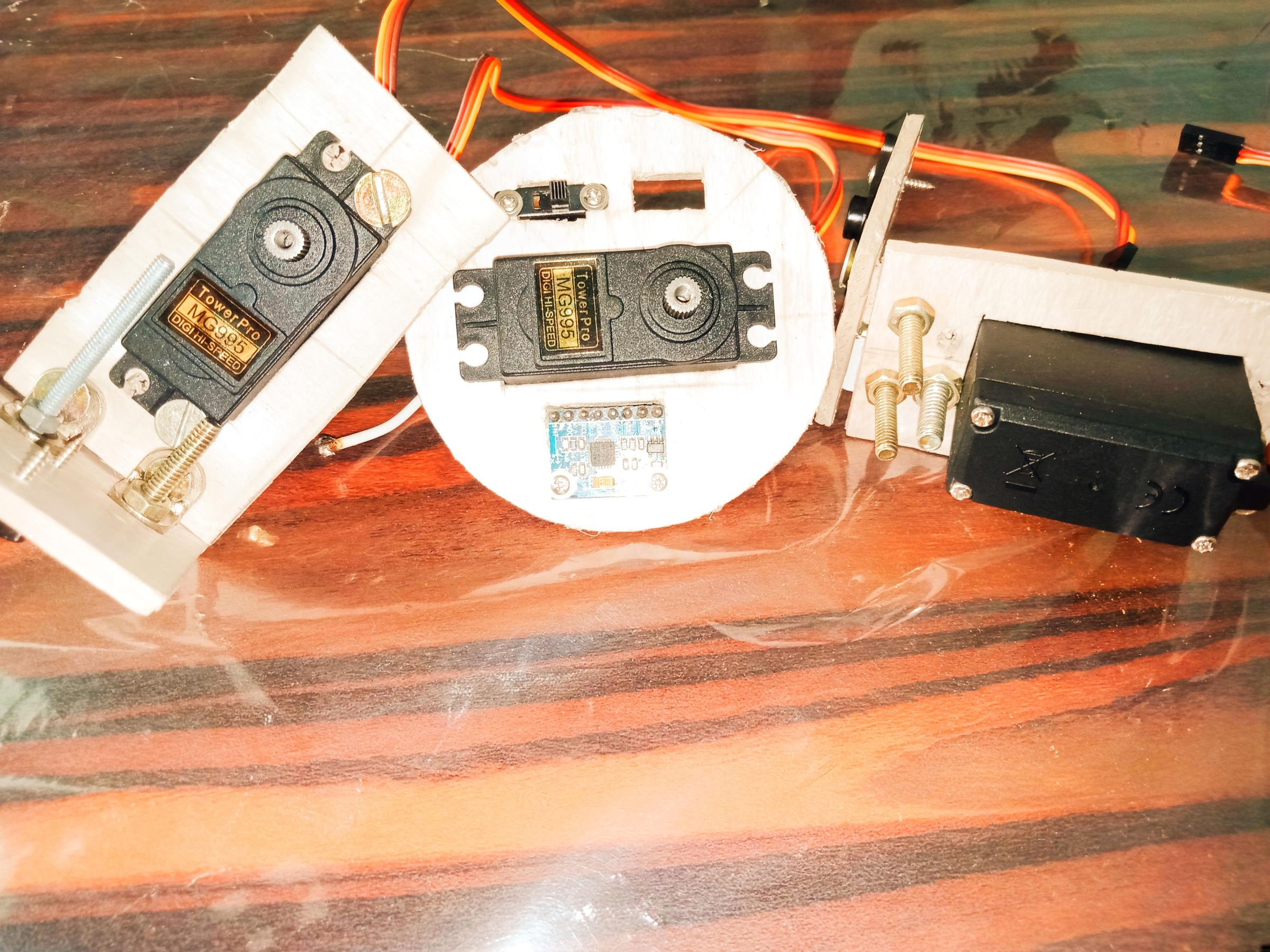

Step 2: Assembling
AssemblingAssemblingAssembling

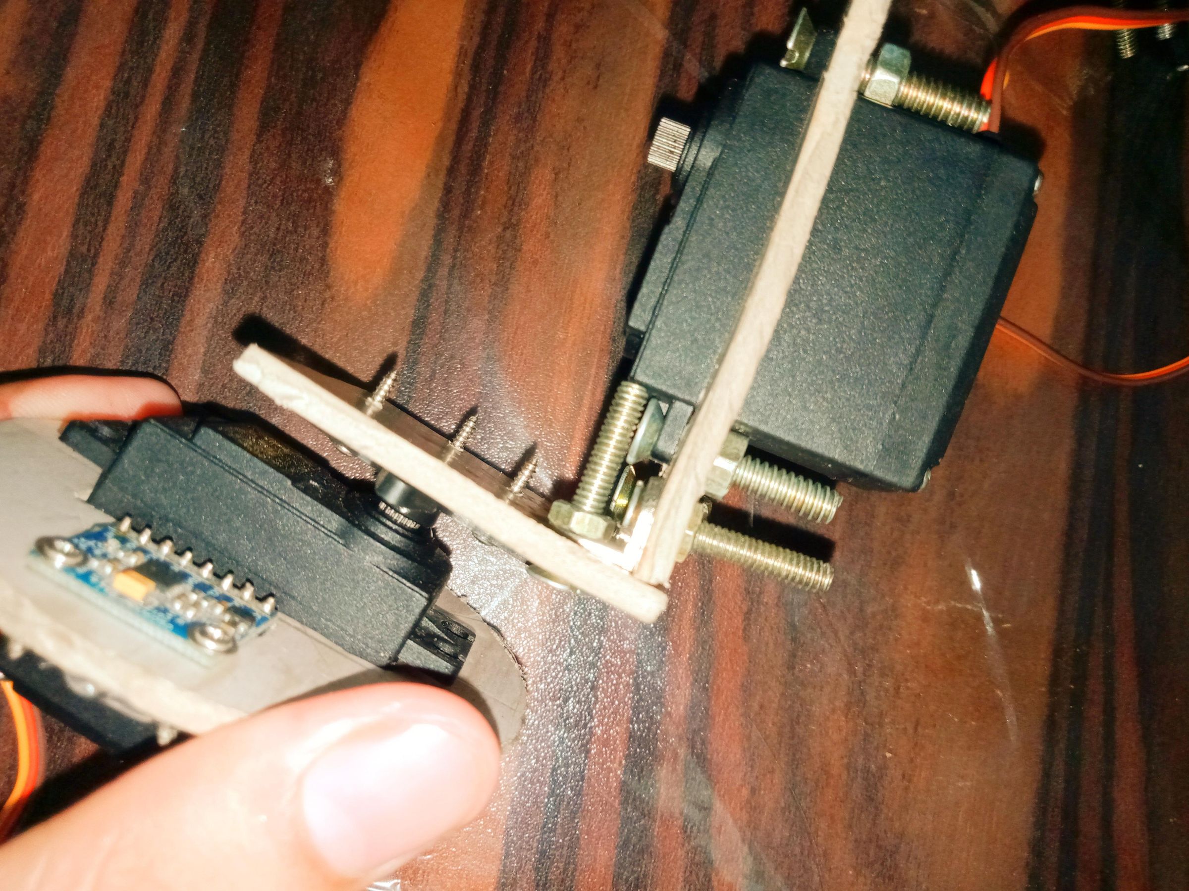

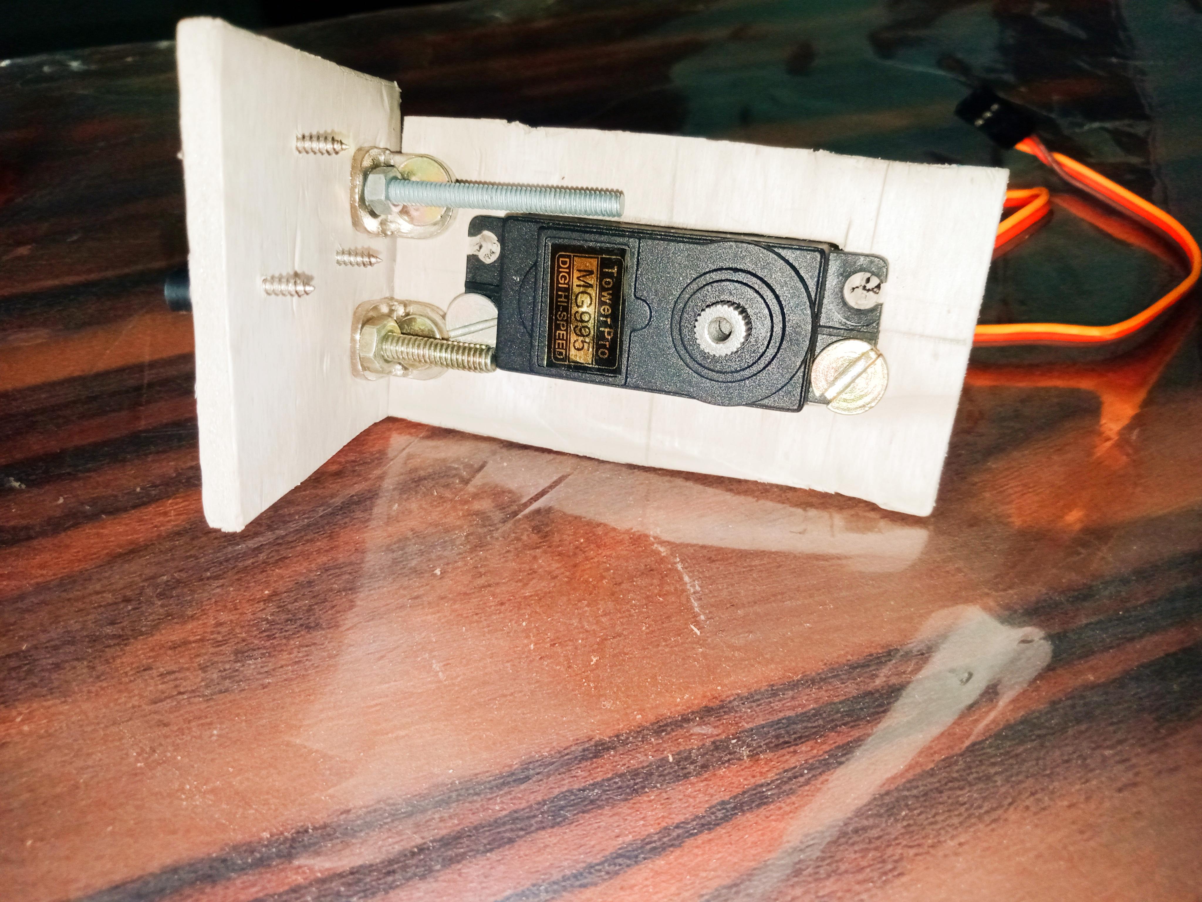

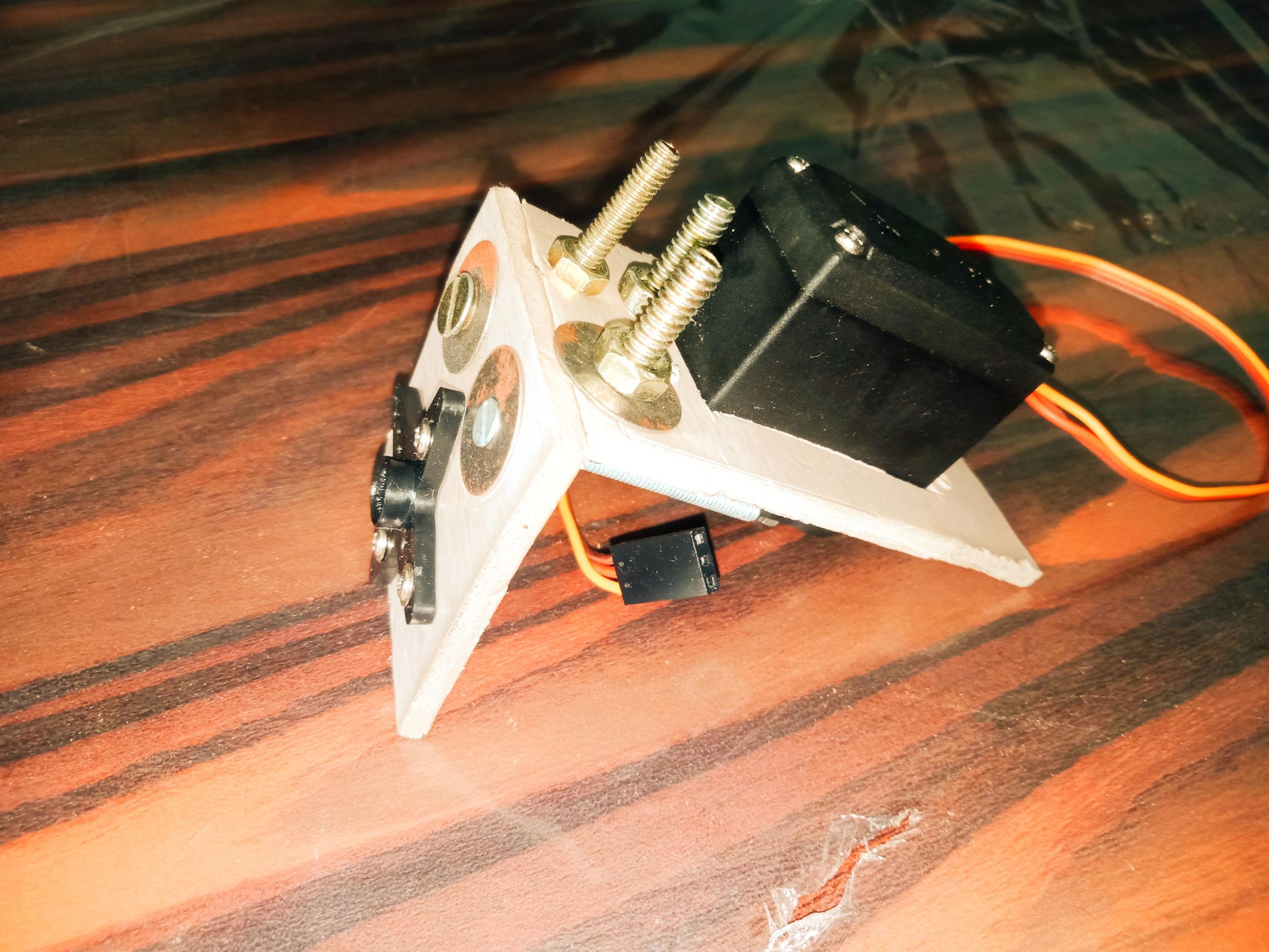

Foamcore, foam board, or paper-faced foam board is a lightweight and easily cut material used for mounting Servo motor and for making scale models.
Firstly I made a DIY L-shape brackets to mount servo motor with the help of foam board.

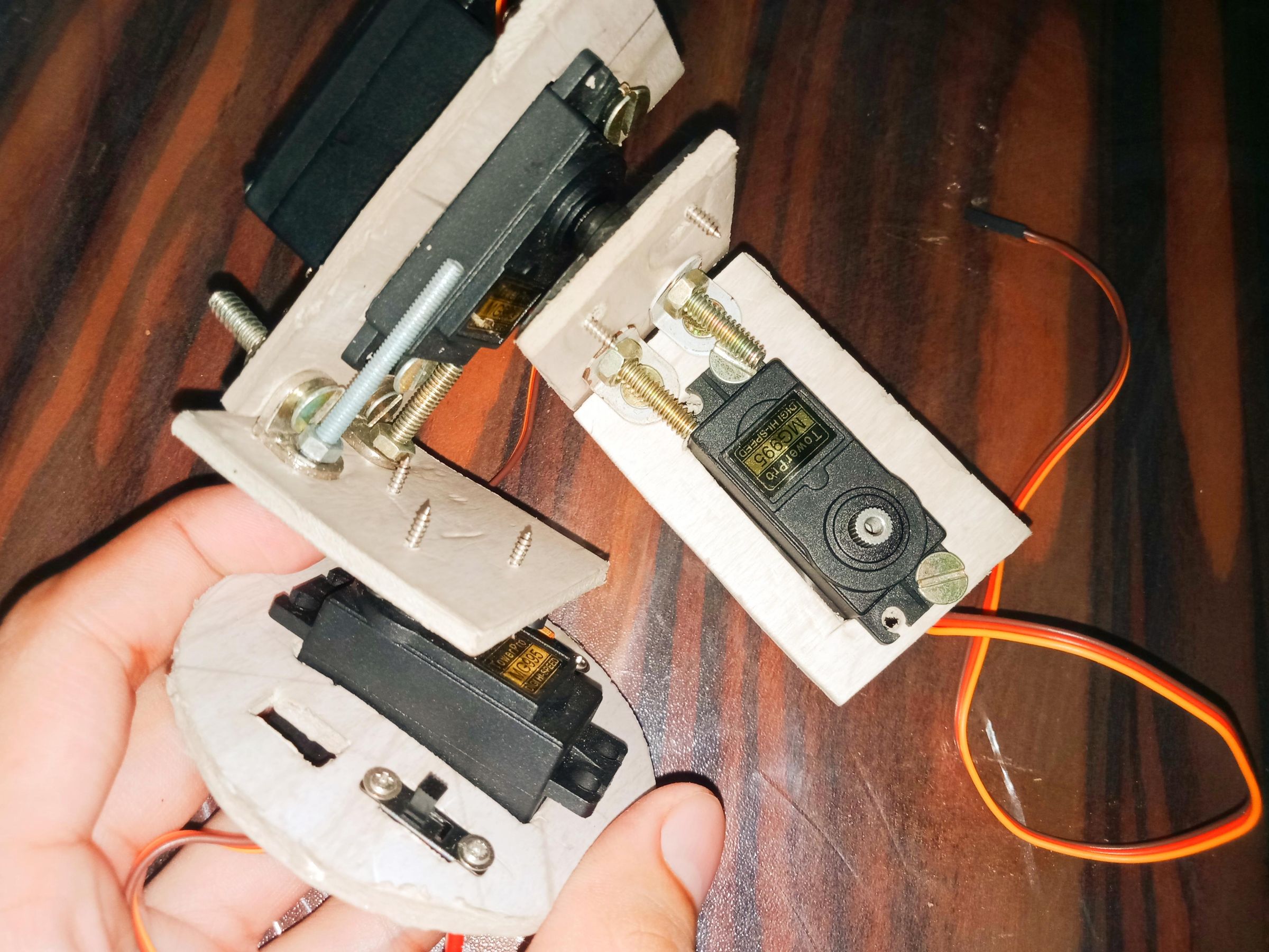

Step 3:
Assembling the gimbal was quite easy. I started with installing the Yaw servo,MPU 6050 sensor and ON-OFF switch. Using bolts and nuts I secured it to the base
Step 4: Next, Using the Same Method I Secured the Roll Servo. the Parts Are Specifically Designed to Easily Fit the MG995 Servos
Step 5: Next, Using the Same Method I Secured the Roll Servo. the Parts Are Specifically Designed to Easily Fit the MG995 Servos

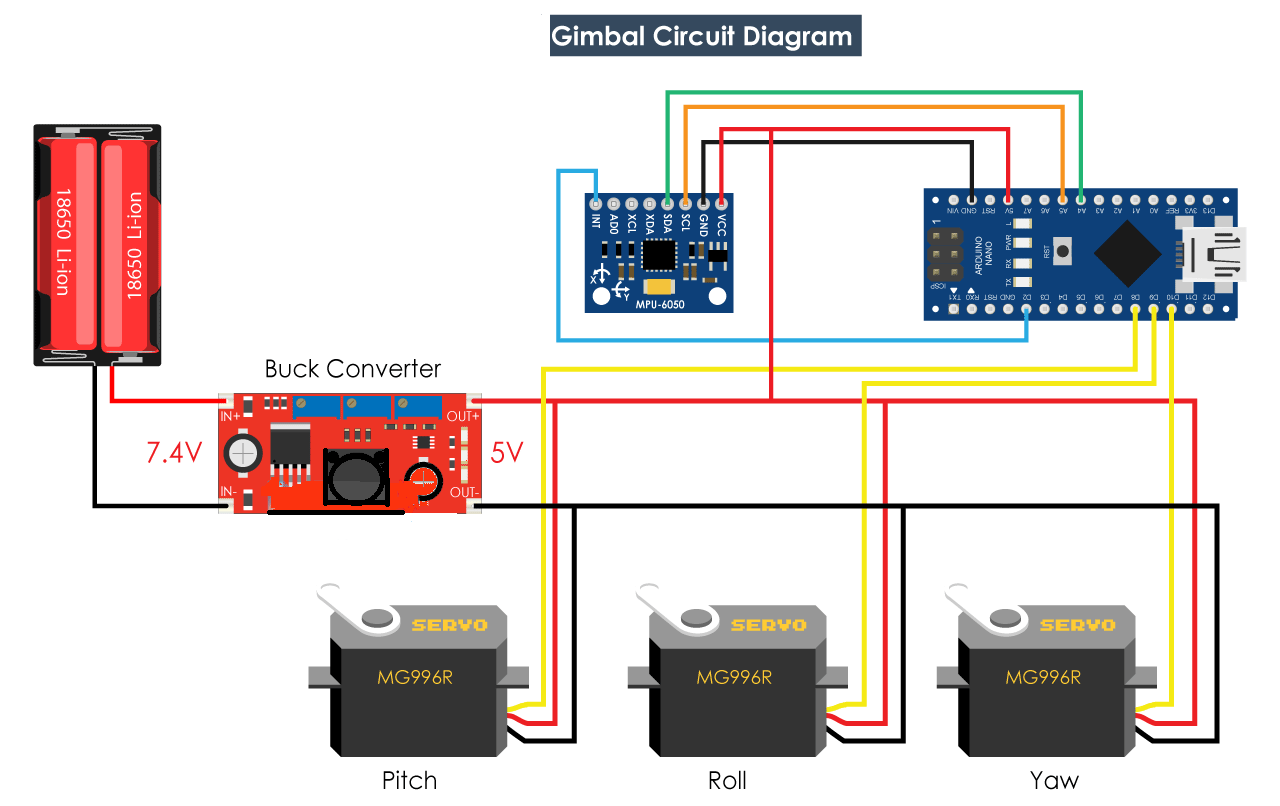

Step 6: Connections
Connections
In the circuit diagram you can use either buck converter or 7805 Voltage regulator IC to convert 8V to 5 V.The microcontroller which is given the circuit diagram is Arduino Nano you can also use Arduino Uno,Arduino Mega.
The SCL and SDA pins of MPU 6050 is connected to Arduino Analog pin A5 and A4.(SCL and SDA pin may vary so check out datasheet for SCl and SDA pins for other microcontroller)
Step 7: Connection With 7805 Voltage Regulator IC
This circuit diagram is for the connection of 7805 voltage regulator ic, connect the 8v battery at Vin and you will get an output voltage of 5v.

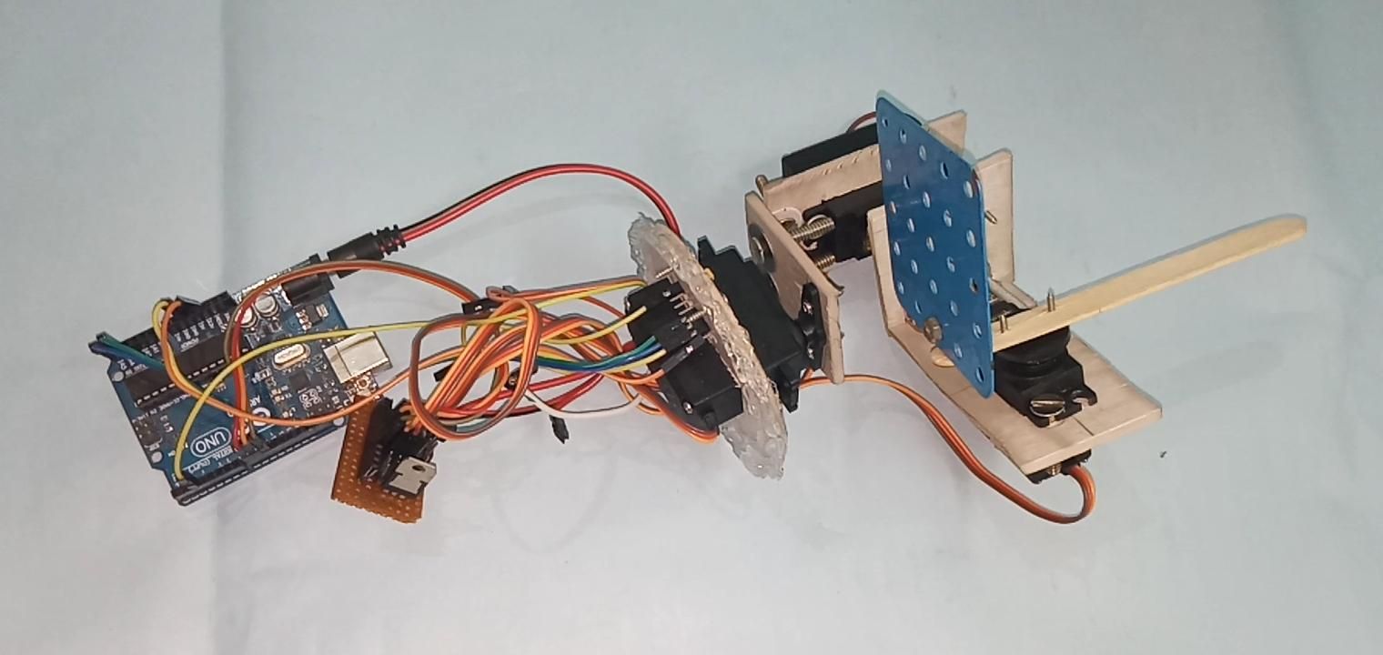

Step 9: When All the Components Are Connected ,its Look Similar to This Picture

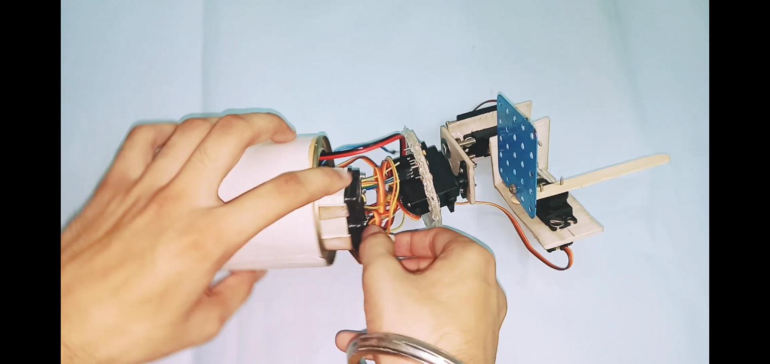

Step 10: Now Insert All Base Stuff Inside the Food Can
Step 11: When All the Wires and Components Are Placed Inside a Food Can Then Applied Glue Gun at the Base of Foam Board.

Please note this far from good camera gimbal. The movements are not smooth because these servos are not meant for such a purpose. Real camera gimbals use a special type of BLDC motor for getting smooth movements. So, consider this project only for educational purpose.
That would be all for this tutorial, I hope you enjoyed it and learned something new. Feel free to ask any question in the comments section below and don’t forget to check my collections of project
