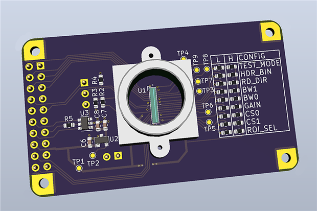

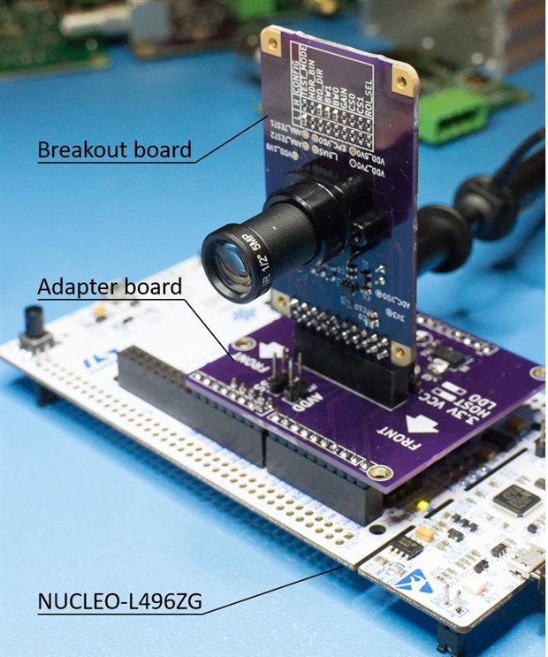

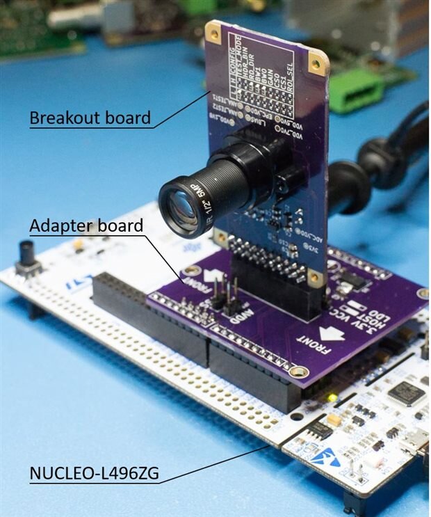

Camera Breakout Board
The KiCad project for the epc901 breakout board can be found here.

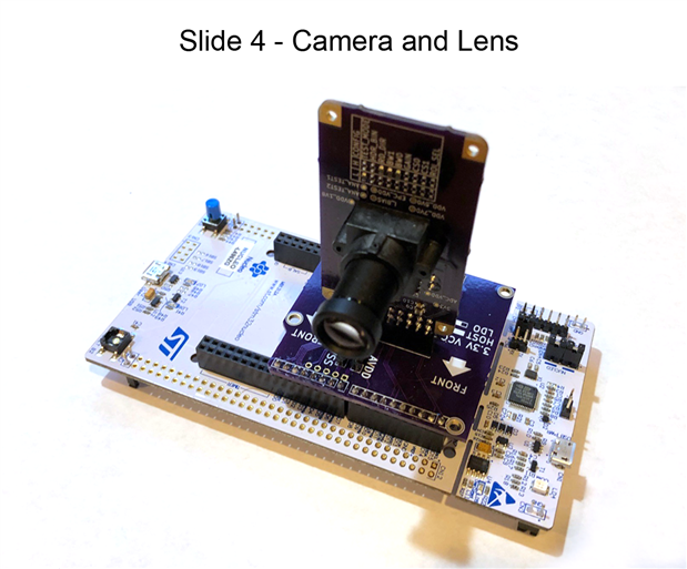

In addition to the image sensor and related passives, the breakout board also integrates an ADC.  The footprint and firmware are compatible with the Texas Instruments ADCS7476 and Analog Devices AD7476 which are 1 MSPS 12-bit ADCs with SPI-like interface.
Connection to the board is through a DIL 0.1 header.
The breakout board has space and mounting holes for a lens holder. The spacing between the mounting holes is 20mm. For full coverage, the lens should support 1/2.3" or larger sensors.
For our prototypes, we chose a M12 metal lens holder w/ 20mm hole spacing and a 25mm M12 lens for 1/2" sensors. In the US, a wide selection of lens holders and lenses can be found at M12 Lenses Inc.
Camera Adapter Board
The adapter board was designed in KiCad and the files can be found here.  It follows the Arduino Shield standard and could be mounted on any compatible microcontroller. The firmware was developed for the ST Microelectronics NUCLEO-L496ZGNUCLEO-L496ZG development board and would have to be adapted to other microcontrollers.

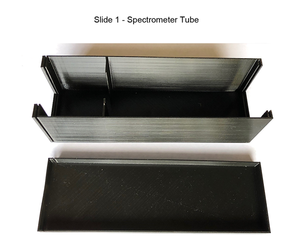

The prototype spectroscope has five major components: tube, diffraction grating, entrance slits, camera with lens, and base.
The spectrometer tube shown in Slide 1 has an internal baffle to block incoming light and slots on the ends to hold the diffraction grating and the sliding stainless steel plate with the optical slits.  We have experimented with length and the tube shown is well suited to observations in the visible spectrum. It is approximately 180 mm in length from the diffraction grating to the slits. A shorter tube allows a wider spectral field of view with the lens we are using.
The tubes were designed in Fusion 360 and printed on an Anycubic I3 Mega printer using black PLA filament.  The STL files are available here for those who would like to print their own.

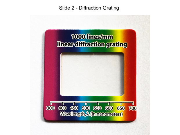

We used a 1000 lines/mm linear diffraction grating in a 35 mm photographic slide type mount which are widely available on Amazon, eBay, and from educational vendors. A package of ten can be bought for $10 USD.  Higher quality glass slides are also available.

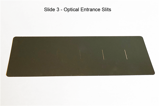

Our design for the optical slits as shown on Slide 3 was laser cut into a stainless steel slide by OSH Stencils, a US based company that fabricates stencils for applying solder to PCB boards. The slits are 0.5, 0.25, 0.1, 0.05, and 0.0254 millimeters in width.
The camera is shown above mounted on the breakout board which is then attached to the adapter board and the microcontroller.  As previously mentioned we are using 25mm M12 fens for 1/2" sensors that has worked well for capturing images in the visible and near visible spectrum.

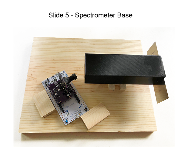

The wooden base in Slide 5 was constructed for easy camera alignment and to hold the components securely.  The camera and diffraction grating can be further shielded from extraneous light with cloth or paper during use.

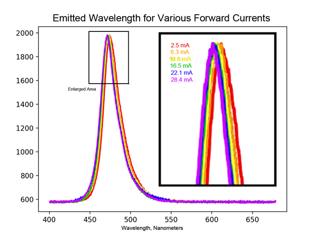

Usage: LED Wavelength with Varied Forward Voltage
This experiment illustrates how the wavelength of a blue LED varies with the forward current through the LED.  In a previous element14 Blog that used LEDs to estimate the value of Planck’s constant this behavior was identified as an issue but the apparatus to do an evaluation was not available.
Below we determine how a blue Lite-On LTL2V3TBS3KS behaves as the current is increased.  For this experiment we used a Tenma 72-2685Tenma 72-2685 bench power supply to supply a constant voltage, a Tenma 72-1020Tenma 72-1020 bench multimeter to measure current, and the epc901 spectroscope.
Before beginning the experiment the spectroscope is calibrated and the LED arranged so that it is axially aligned with the slit in the spectroscope.  As measurements are taken the exposure is adjusted for the peak brightness to land at approximately 2000 – this allows the resulting spectrograms to be aligned and compared easily.  We started the measurements at 2.6V which resulted in a forward current of 2.5 mA. The following procedure was then used:
  1. Save the spectrogram and record the forward voltage, forward current, and peak wavelength
  2. Adjust the forward voltage up by 50 mV
  3. Adjust the exposure to give 2000 counts
  4. Return to step 1 if the forward current is less than the LED max current (or the LED burns out)
The results are shown in the graph below.
The range shown in the graph is 2.5 mA (Vf = 2.6 V) to 28.4 mA (Vf = 3.1 V) at 100 mV intervals.  The peak wavelength shifted from 474 nm to 471 nm over this range, a 3 nm shift.  As a comparison, Maxim shows a 472 nm to 469.7 nm shift (2.3 nm) in the plot of an unspecified blue LED in their application note 3070.

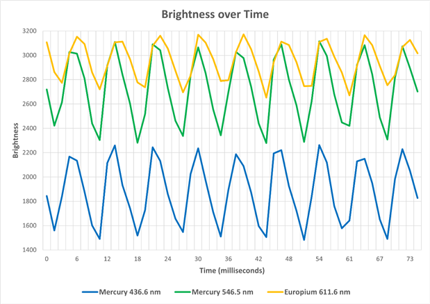

Usage: High Speed Analysis of a CFL Lamp
In this experiment the high-speed capabilities of the epc901 are demonstrated by examining the flicker and changing emissions from the phosphor of a compact fluorescent lamp (CFL). The experiment was inspired by a YouTube video from the commercial spectrometer manufacturer Ocean Insight.
A CFL works by driving an electric current through Argon with a small amount of Mercury inside the tube. The resultant ultraviolet light excites the coating on the tube (called phosphor) and emits visible light.  There are numerous variations in the CFLs manufactured over the years.  Some newer ones may have ballast refresh rates on the order of 10 kHz or greater and depending on the ballast the experiment described here would not work show the same effect with them.
Our lamp has a very discernible 120 Hz frequency as a result of the 60 Hz frequency of AC mains in the United States as shown in the short video below. This animation was created by capturing a burst of 100 images in 150 milliseconds, resulting in approximately 5.5 spectrograms per 120 Hz cycle.
Three of the stronger emission lines visible in the spectrogram of a CFL come from Mercury and Europium and that is what is examined in the plot below.

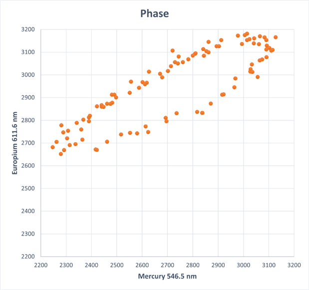

There is a delay in the emissions of Europium compared to the two emission lines from Mercury.  If the strength of the emissions as recorded by the camera for Europium 611.6 nm are plotted against that of Mercury 546.5 nm we see that the two are “out of phase” or stated differently the Europium lags behind Mercury:
We theorize that the phosphor continues to glow for some period after the peak Mercury ultraviolet emission drops and then lags behind as the Mercury emissions increases.

    Here you go: I used the trigger function of the firmware to record the spectrum of the CFL during turn on (cold lamp), while running (after warming up for a while), and during turn off. Below the plots…
    shabaz over 6 years ago in reply to astuder +5
    That's perfect, thanks! Just some initial playing with it.. can clearly see the 120 Hz output light ripple. I'm going to look for other ways to display it a bit better : )
    I had a bit more of a play with the data today, this was the normal 2D plot plus the waterfall: Then I tried looking at the log of the data, as a basic attempt to look closer in the noise. One interesting…

  • astuder
    astuder over 6 years ago in reply to shabaz
    Beautiful plots! Thanks for sharing the code. Looks a lot simpler than using Matplotlib. image
    I turned the lamp on with the switch on a cheap power strip, so there may be some switch bouncing. On the other hand, the deep dip seems to align with the subsequent 120 Hz cycles.
