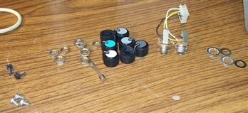

Step 1: Remove Mounting Knobs and Nuts
The first step is to remove the knobs and nuts mounting the controls to the front panel to the amplifier.
Remember to keep all the parts sorted so you can find them later.

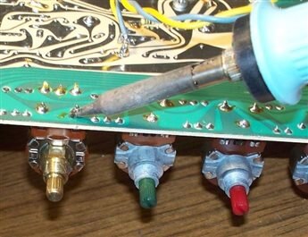

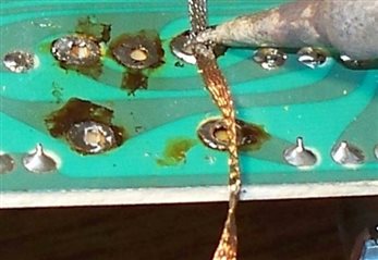

Step 2: Unsolder the Controls
After the circuit board is removed from the amplifier box, each control is removed and cleaned one part at a time.
Do not take them all off at the same time, because you may mix them up.
Step 3: Remove Old Solder
Remove old solder and inspect the pads for any burnt or broken traces.

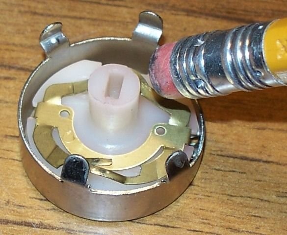

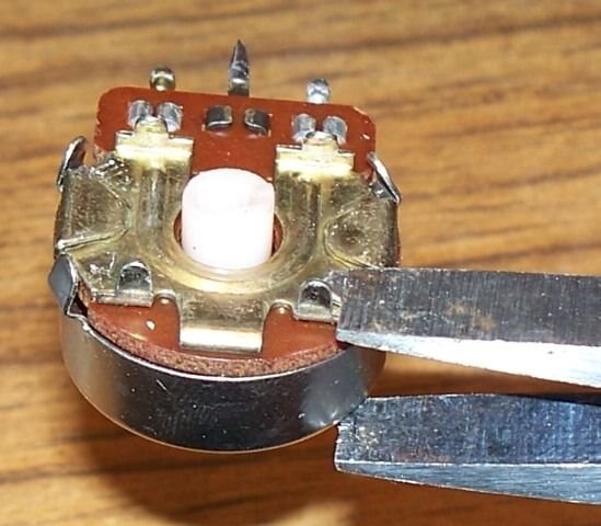

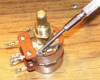

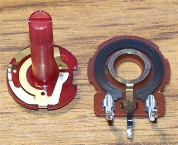

Step 4: Open the Control
Open the control (potentiometer or "pot") by lifting the mounting tabs slightly.
Remember that these tabs will not handle being bent more than a few times before they break off.
If a tab breaks off, you may be able to solder it back on later.

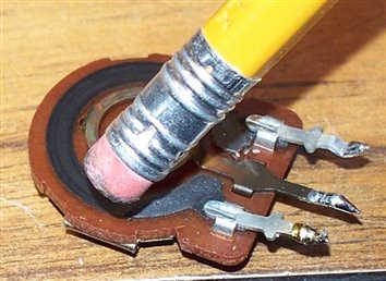

Step 5: Inspect Dirty Contacts
The control is made up of two main parts.  The contacts and the carbon resistor.
Each side must be cleaned without damaging them further.
If the carbon looks burnt or has broken areas, the entire control may need to be replaced.
If the contacts are worn too much or broken, the entire control may need to be replaced.
Step 6: Cleaning
Carefully, clean the contacts and carbon with a pencil eraser.
Do not push too hard, and clean the eraser on a piece of paper when it gets too dirty.
Do not use any cleaner or solvent except rubbing alcohol or cleaner designated for this type of control.
Make sure to blow off any eraser particles left on the control before assembling the part.

If you are cleaning a dual control, the method will be the same, however it will take twice as long,
and you must align both controls so they go back together correctly.

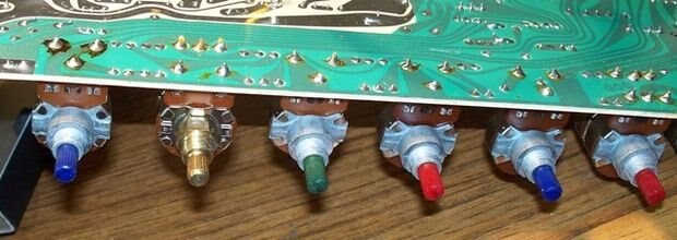

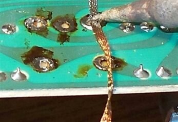

Step 9: Resolder and Continue Cleaning the Rest of the Controls
Use new solder to assemble the clean control back onto the PCB.
Clean the solder flux off with some rubbing alcohol or flux remover.
