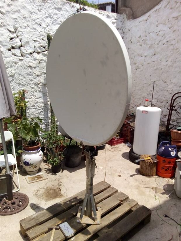

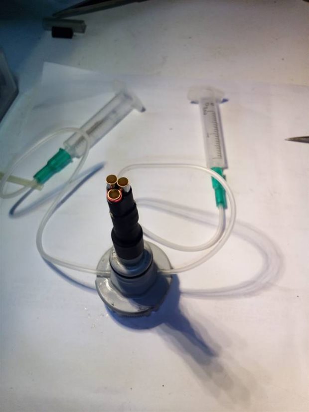

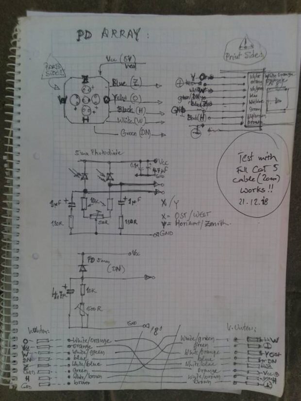

I  build up a Photo'diode / tansistor  Array - to get ' infos  about where  at the  sky is brightest  point ? - to track the sun.. yes.
so at fist again a schematic form that array  -  a note  from my  analoge notebook,  a photo from it :
as  we  can see  -  we have  4  PD,  and  a center one  - the  center is intended  to  just  measure  the amount of overall light_   to detect   the   night / day  difference -
  while the 2  pairs, crosswise  - for to detect  the  rotation of the sun -  from east to west over the  day  -  and  the elevation angle  from  morning - horizont  to   noon,  at zenith  and  back to  horizont,  at evening..
so them 2 pairs  deliver ots  analoge  signals  to the  arduino, which detcts the  amount of light  form each, calculate the / a difference  from a  pair ( rotation /  elevation) and gives the  diifference, and the direction  to fire the motors  - high difference  - motor(s)  fast, small difference, motor slow,  and - at no difference:  motor  stop - the mirror is alligned...
Ideas  and  Praxis :
first tests, connecting, test on stability  and sensivity: ( i experimented  quite  a while  to find out  the values  to the correct resistors  and  capacities' .. )
by  aproaching the light to one of the PD in the array - one  can see how the indicating LED  responds to it...
here, the idea  - to ' a  functioning PD Array. :
and the  final ' aperture:
now the PD's  are 'coated  with black heat'shrink tube  - to prevent light coming  from aside ... imageimage
And  the pcb, is  coated  with  a laquer  to prevent to 'enter atmospheric  influences to the board...
so it will be attached to the parabolic  dish:
an overview' :

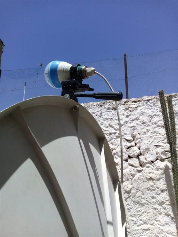

The 'camara' tilt and pan thing' - is is intended  to 'fine-adjust the 'mechanics  to the  electronics...
so, that the focus is  really  there , where the heat collecting element  is   mounted on !! image

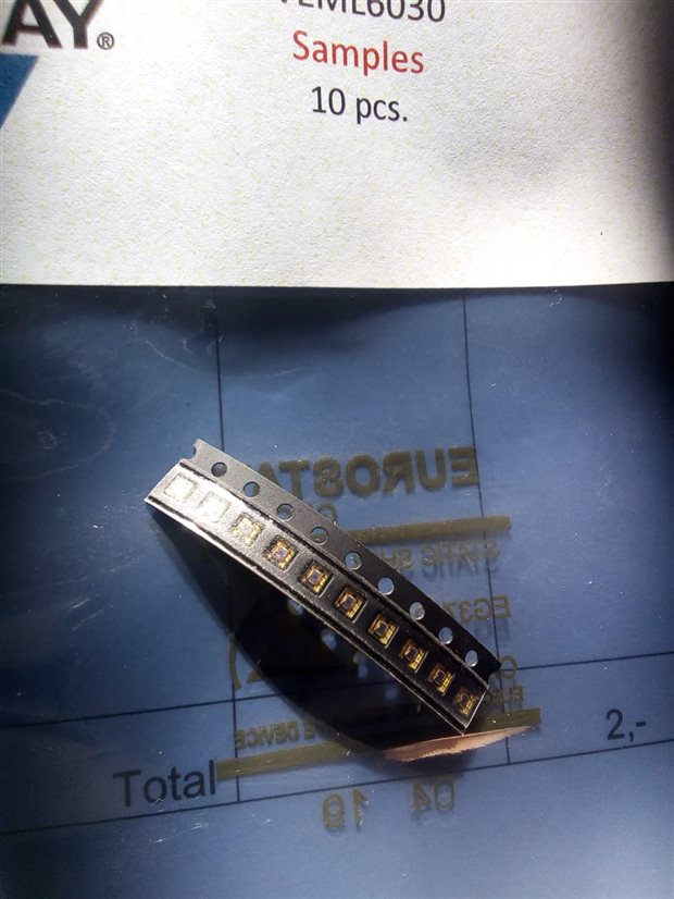

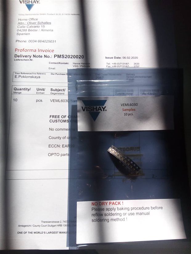

so back to the ' help from a  friend -
Vishay ( I am not  in any'ways ' connectet,  '$$' to them ' )  -
but I asked them what to do when some devices , have same  address, blah, blah,
  and long story  short _ they  sent me  - within  4  days  ( Germany/ Spain )
10 samples of their VEML 6030, for free.
but these  devices'  so to name', are as big as  2 by 2 milimeters ,
and  when one of them  will fall on the  floor  - it will be  for ever lost .
BUT - they  are  super precise, the datas  one  can read out,  will do  make  sense,  and  one' (Arduino  GiraSol Program') can 'work highly  accurate with it:
to detect:
Where is the sun ???
"... or use manual soldering method ...!"      ( aiiii )
2 by 2 millimeter, each...   mmm . 'image
think, it  will be a big challenge...

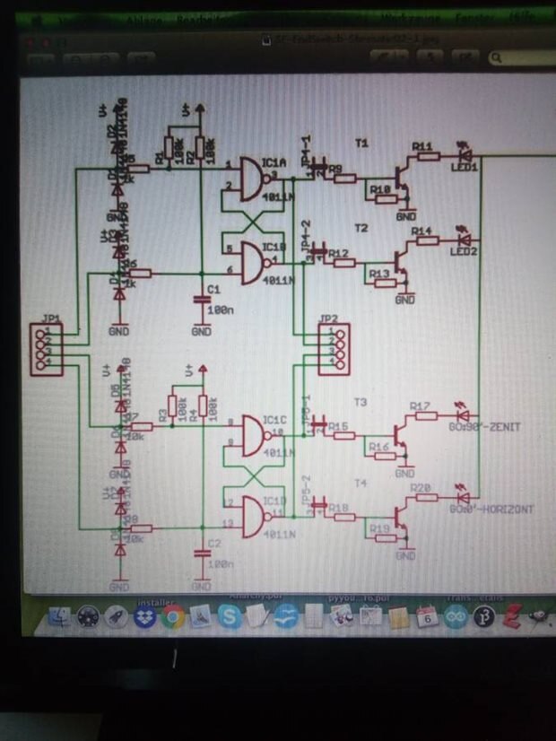

(optical) Switches, RS Flipflop, Arduino lead to a State-Machine...

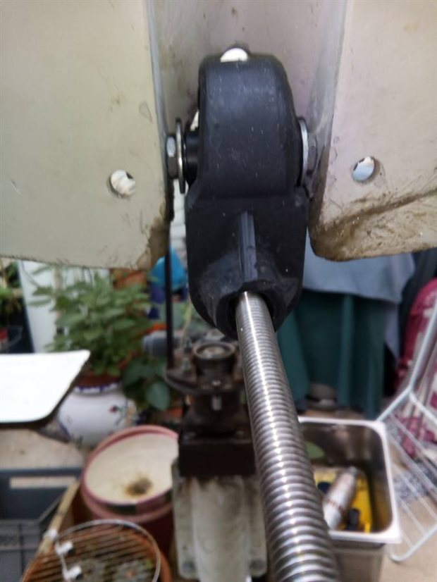

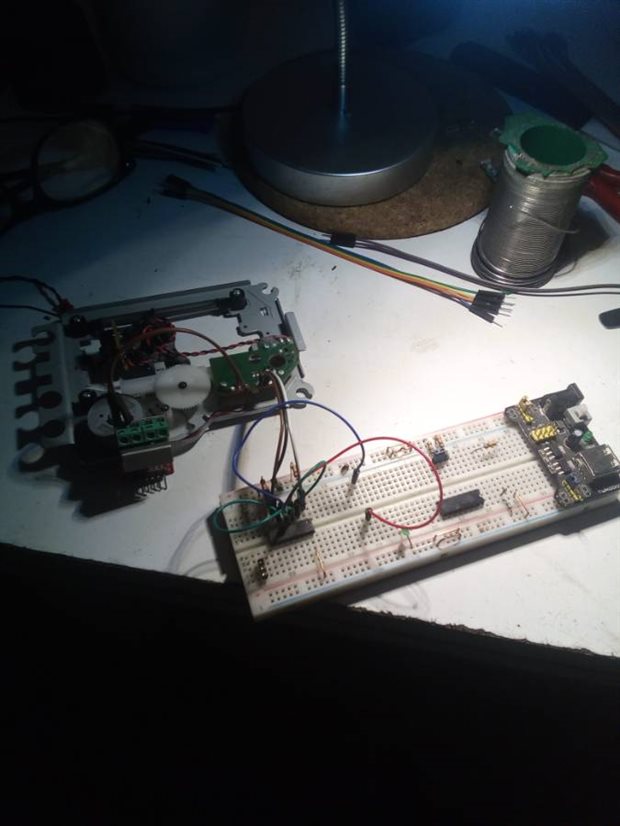

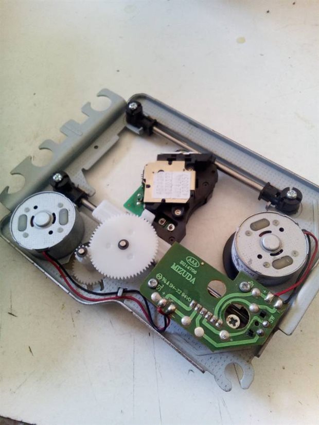

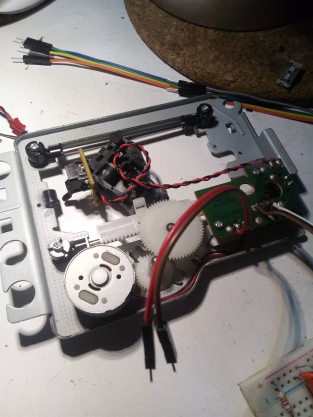

The  'State Machine'  - the model I made  from an  old  cd rom drive - and mounted on the carrier one of the switches - the other one  was already attached to the  frame at the other end'point... the  switches triggers the R or the S input of the  flipflop, so that the out of the FF either has  'high': going to 'west', or 'low': going east, depending on the  direction the  carrier  moves..
That model (to get the code for the Arduino, and to see if any obstacles may  occur', BEFORE I  would  let that Program  'sport'  the  real big motor for the  GiraSol... I attached the optical endswitchs to the GiraSol X axis 'recently ', so now, the 'need  for the model... made  some  videos from it :  but I want to start  with the  layout  from the RS FlipFlop,
(drawn in Eagle, exported the design via Lasertoner'transfer on a real, double sided' pcb, etched, drilled  and 'populized it) -  and - was already  build into the  GiraSol -Box, so I needed to simulate on  a breedboad - the FF, for that State Machine 'model...
The  Arduino detects the low/ high change on one digital input pin, and drives accordingly to it the 2 PMW out lines' - reversing the - one PWM, the other, to ground  - so the motor  spins with its PWM speed this way or the other (clockwise / anti'clockwise) ...
Directly  after power'up these  RS-FF's goes in a  un'definite state (due to components differencies -  small, but...)
So to prevent the toggel'ing to an indefinite  state - there is this build-in condensator (C1, 100nF) - it takes  a 'bit' longer to get completely charged, so that input  (at pin 6) is  a bit longer torn to ground' - long  enough,  to trigger the RS FF, to a definite  state ...
Here  two channels in the  design, exactly 1:1  - one  for the X axsis - rotation  and one  for the Y axsis - elevation..
(in the  final PCB I have 1K to all inputs, the pullup's are 100K,  and the IC is finally a '4093,  a quad CMOS S
chmidTrigger NAND..
I do really  like them cmos digital  ic's , for  you can run them, make them work  on  3  to 15 Vcc !)
and   - in the JP1  - 1 & 2 are the input pins  for the optical switch signals, and in JP2 you find the out's of the FF..
one of them 2 is  enough to detect  the direction: high or low - (  for the second is  just reversed to the first )
so  i decided to  define: logical '1', 5 volts  =  goWest; and logical '0', 0 Volts -  means  goEast...
the CD Rom drive..
the modified drive  - endswitch installed:
beedboard  FF, motor-driver, while attaching to the model' ..
here   you can see that  'model' running - in the background  the breedboard, on witch I built  the  RS FF (one  channel)
nice  to see the outs  from the FF indicated by the 2 LED's - which lits according to the direction the slider 'moves ...
the other switch is a bit hidden under the pcb, for it was  already  installed - I just  used it - as one endswitch..

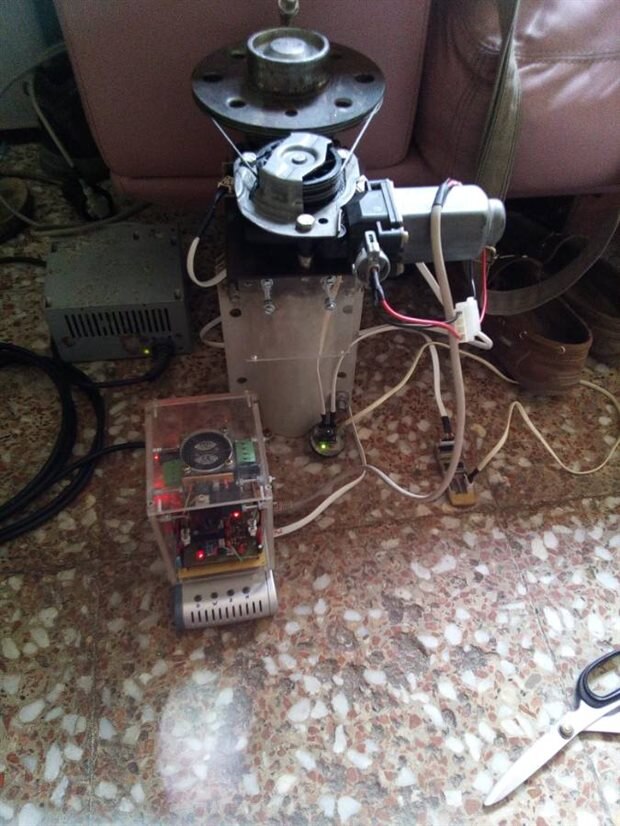

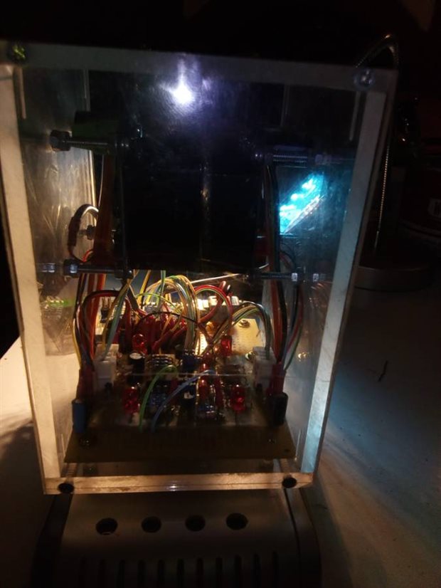

all wired, Arduino Nano Driven:
the  setup  with the  real machine'  via the GiraSol Box; motor drivers and optical endswitches..
no smoke ?  ..  no... image
the rotation axis and one optical switch...
That optical Switch in ' Action:
the State  Machine in full action. Program uploaded to Girasol Arduino Nano, executing..  image

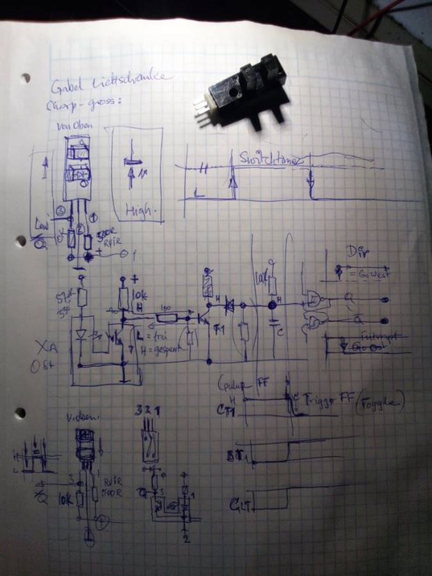

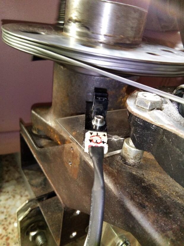

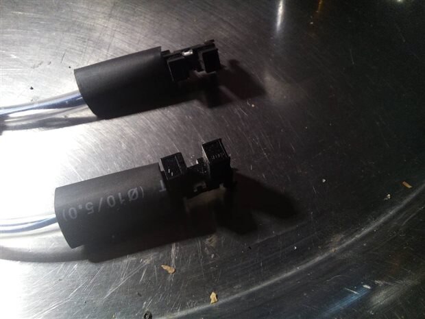

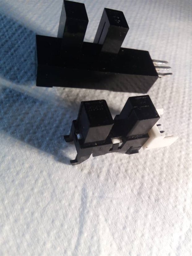

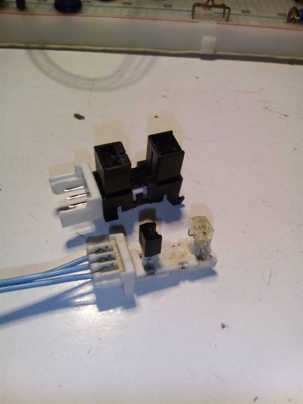

The  optical endswitches...
the  End-Switches…

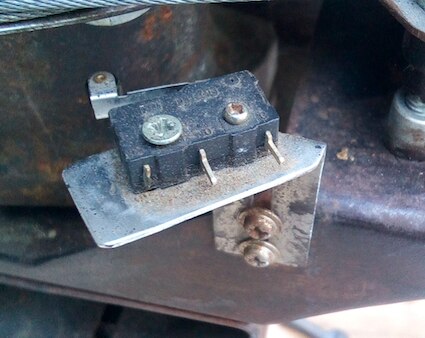

as recognized - the mechanical switches I  wanted to use and installed them already one year ago - they start to rust, to oxidize - so a more durable solution was in need.
I  googled around in my pile of electronically parts  and  found - some  pair of optical  devices:
an infrared diode mounted in opposite  to a  phototransistor - so the light beam opens the  collector-emitter path.. ( so  a ‚ positive logic‘ )

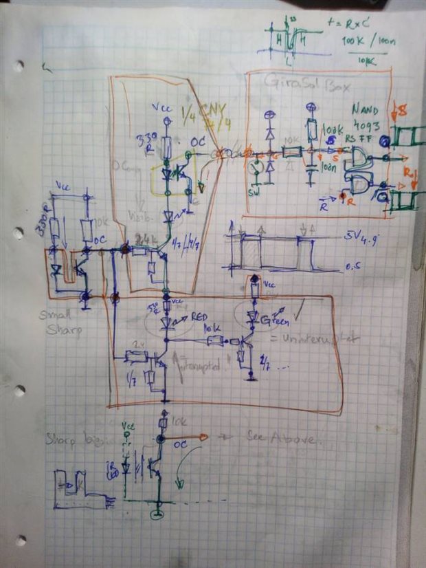

But, to toggle the electronic in the Girasol -Electronic Box  - it's expecting  a  signal that goes logic 'low', '0‘, so the signal had to be inverted…
The final 'switch' is to toggle the entrance (an RS Flipflop ) - the active path - an 'open-collector' draws the input to ground, to trigger ..
I need to build 2 pair optical end switches - one pair for the elevation axis, and one pair for the rotation’ ..
first schematic:
mimage
The detecting electronic works on breed board:

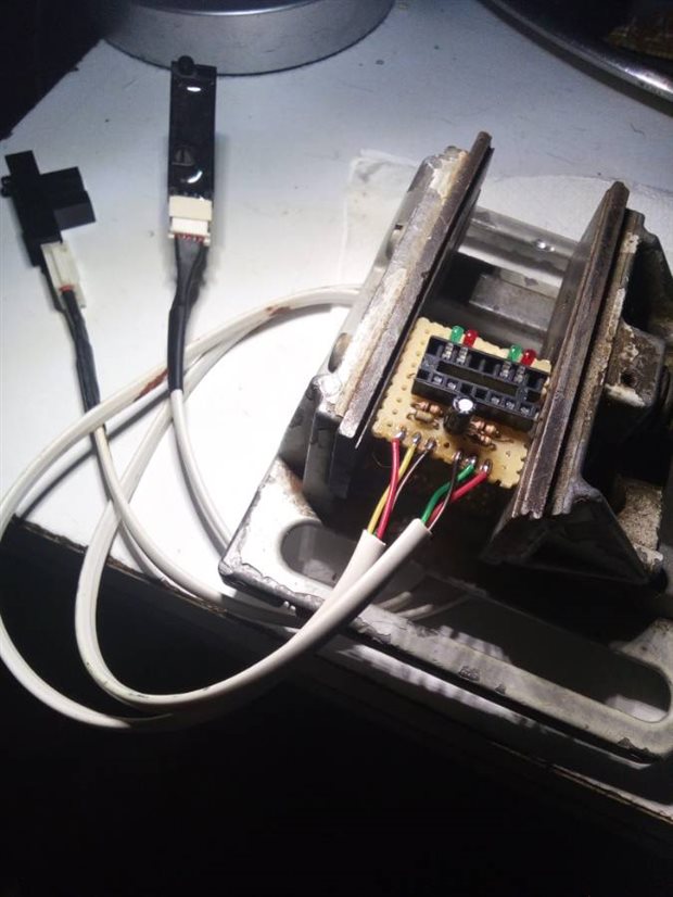

breadboard,  one pair:

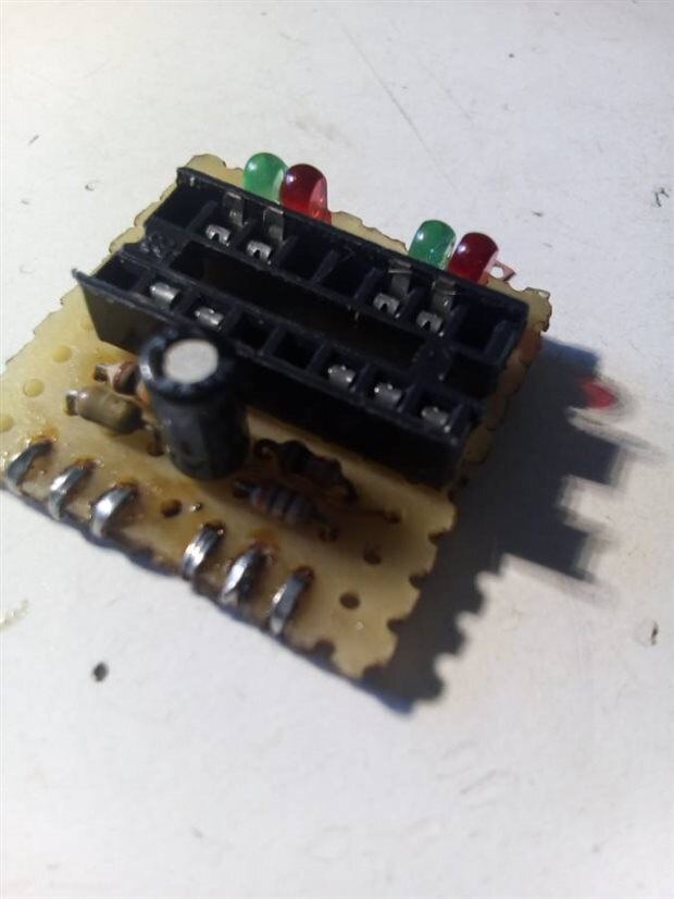

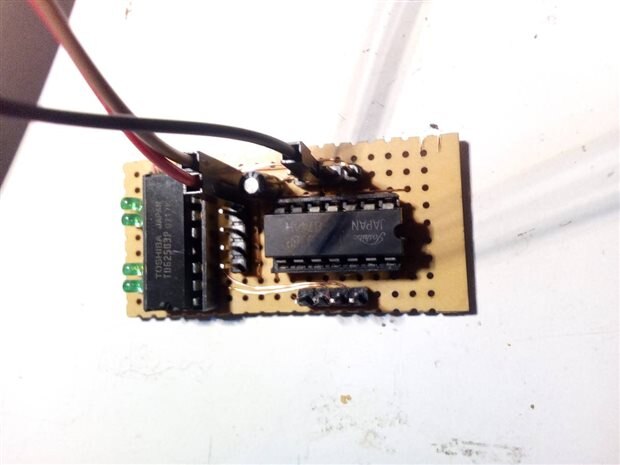

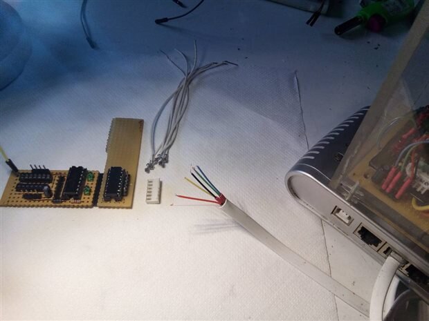

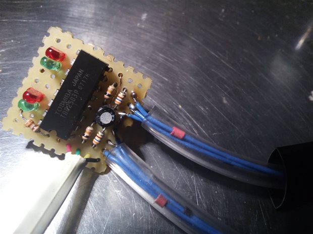

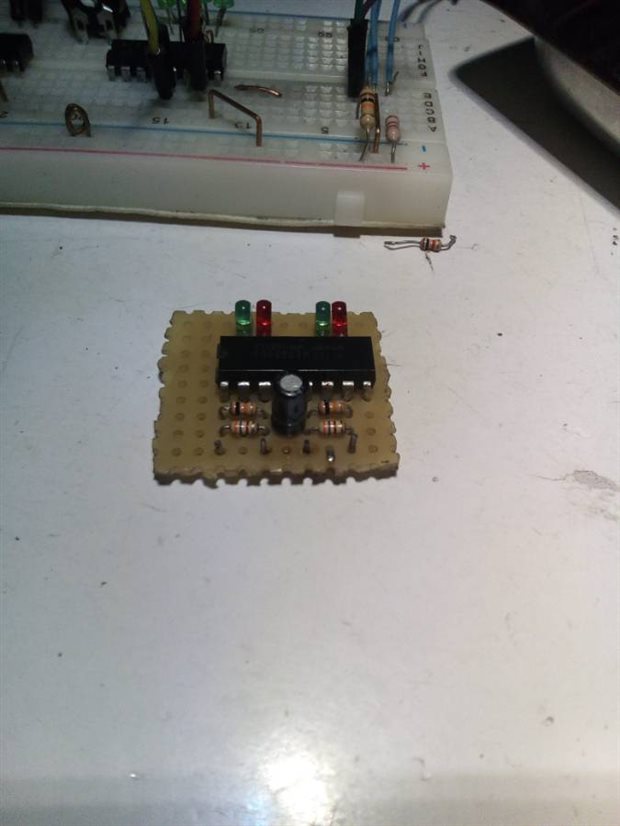

This little board is the soldered version of the breed board ...
I need 2 of them  - one for rotating east/west and the other for the elevation - horizon/zenith:
When running it shows the state of the optical switches
Green - no interrupt, Red - beam is blocked, (device is at end point..)

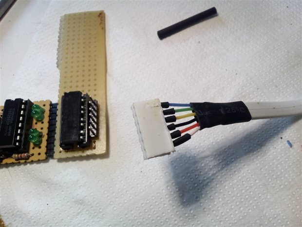

the  second device,but now with ic socket.
I removed  unnecessary pins and left over  the 'active pins in the socket' s

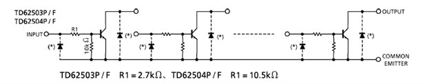

the TD62503 consists of 5 transistors - the base as open 'input, and an open collector 'output, basically -
and all emitters are connected internally to pin 8..
Only  4 of the transistors I used : the 4 inputs -  and 4 open collectors (200 mA each) - and the common emitter:
connected  to :
The yellow/green gives the signal; Red - positive for IR Led, black  - commune negative, ground...
So have  2 pairs of  detecting boards with the 4 sensors -the return points at east, west, horizon  & zenith
When the machine runs 'into'an (optical) switch at its  end'point, it has to stop and do reverse (by the GiraSol - Program ):
these are the detectors, to tell the program and 'it asks - is there, at that pin, connected to Arduino -  a high ( 5 volts,) or low' - logic, = 0 volts ??
The following electronic, directly after, is to store the way  (direction where to go )  - a toggle - RS FlipFlop tells', stores the state - if east  or west switch is ' triggered, it changes its output state:  on its tour to west = high', going to east = low'..
West tour ends' up  - at that detector when it runs into, 'triggers‘ the switch, and the prior high signal now goes low ... = now, go east,  - until you' hit the other end - the east switch..
The signal cooking, signal shaping' and toggling, does the hardware before the arduino..
The whole action is focused on - if one of them 4 reaches the switch, the toggle action is performed - the toggle line is connected to arduino, and the other toggle signal - as well to the Arduino. One of these signals ( high/ low) triggers the 'Service Interrupt Routine', ( at pin D2/3 )  witch calls a routine, wto look what state that toggle signal has:
all members in the program is now informed, that the 'goto-west' direction has changed - now it shall 'go east'.
for having 2 motores, all has to be double, so 2 interrupt pins, and 2 toggle signal pins..
So the need of 4 detectors…
so far,  theoretically …
Next day I found out, that the strange behaviour (sometimes a randomly’  triggering)  of one pair I recognized - at test phase with them big' ones, -
was due  a mistake I made:
I assumed that the devices were build up similar, consisting just one  IR LED and a Phototransistor - but after a check and download the data sheets -
I saw that the bigger ones were completely  ready image  - no need for a resistor for the IR LED:
just to  connect to  Vcc, Ground  -  and having than, the open collector to use ( iCE  @ 40 mA ) …. image
The 'small' one from sharp is the simple version, diode / photo transistor..
- the big one has it's electronic' already built-in:image
So I needed to skip, simply, just short out' the 350 ohm resistor, to sufficiently power up the device.
The resistor - limited the power, the device needed to run fully: so that strange behaviour is/was 'caused by not sufficient supply voltage..:

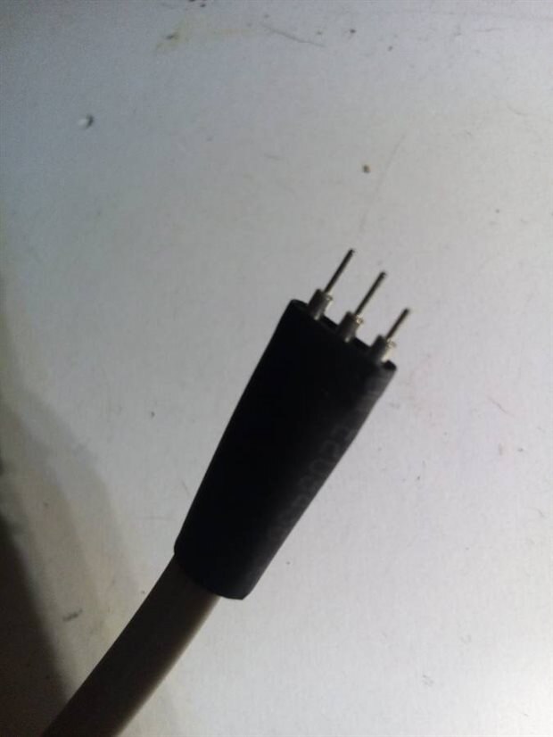

the cables  have  to be  well 'isolated -  not prior against electricity  - but against moisture..

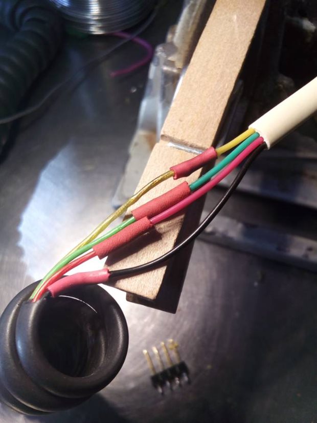

to identify: the + pole is the shorter one .. image
now, than: measuring cable' length, attached some jacks, designed the PCB where the two pairs of signals have to go in,
to be shaped and amplified, to go to the GiraSol-Box'
A spiralchord from an telephone gives free movement for the senselevation detectors, of course, they are moving with the mirror, so there the rotation'..
Now, the last 3 days  ‚in’ to build a lil board that does, in fact, trigger the switch inputs of the GiraSol-Box,
Had to open the box to see if my cable to them devices having the same color-lines connected throu'..
And that thing, the attempt’ was OK, but did not work to trigger:
So I've had to change the design, and found a even better solution :
now the final’ switch/trigger/contact to the  RS FlipFlop -  will be done with optocouplers ( its  IR Diode  in series  with the visible LED) The open collector,   draws the input 'low, perfect to trigger !!!
It does it’s  work,now,  yesterday evening until this  morning  -  reliable, all states  were fast and well recocnized and super stable':
Right, bottom, the cable jacked in'to the GiraSol.box...
the  6 wire cable  to the output pins have to have a socket’ to the cable to push-in to the jack of the  GiraSol Box…:
Red is Vcc ( +5V)
white is ground,
Black - west
Yellow - east
Green - horizont
Blue - zenith
(Lakota colours to the directions)
It works like a charm...
Set & reset,  by 2 devices, 4 sensors, - connected to the GiraSol.Box:
A one year task: now ready, done ..
These sensors I found in a big copy machine and  had them all in my ‚scrap box‘
2 months ago, the optocoupler I used  here (4 in one) came from Farnell, from the price I won on here, on Element14 !!  ( Huuuurraaaayyyy !!!!)
So all came together at the right time..
These optical switch devices - now - has to be mount to the real machine..

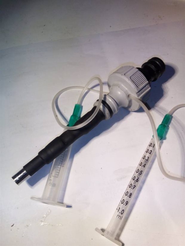

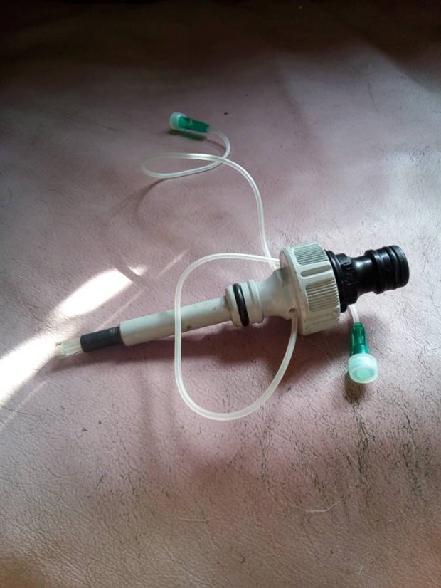

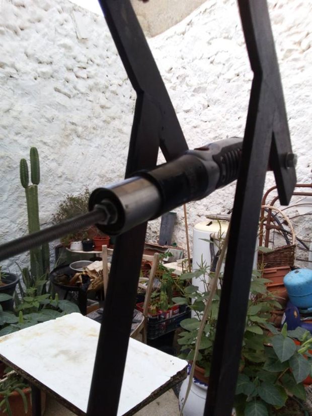

My neighbour Christobal lend me his air compressor - with a dust blower pistol, from which I unscrewed the tip -  and looked around in my boxes of material' and ended up with some  connectors and rings  - from the garden hose. The connector, to attach the end of the hose - fitted ' accidentally ' perfect in the pistol: I even could screw it on'- with a ´bit of force, so - it was perfectly tight.
now - I could use the pistol it to fit anything on it!  (a ' female' connector)
after that 'important step'  - I looked further on - the male connectors to it - found two -  which I could screw-on each other.
One of it I extended the outlet - with a PVC tubing,  some  8 centimetres - to have the outlet for the air.
My idea - then: letting end fine tubings at the outlet, so the air will take the liquid out and form the spray...

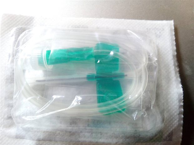

to add in 2  little tubings from a  venofix butterfly (the med-doctors use them to get a blood sample from off your vein') .
I just wanted to let them end, in the endpiece...

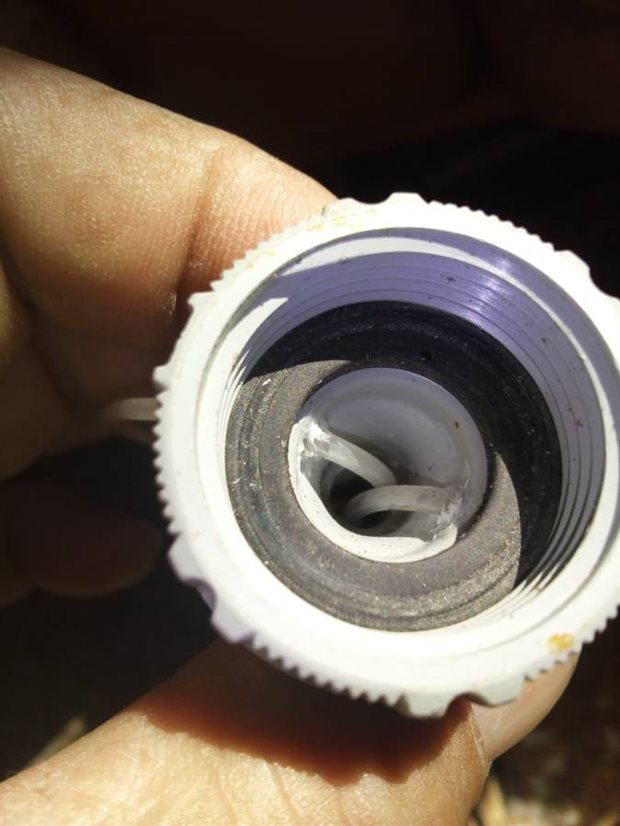

but how to get them in that housing?
I drilled  2 little holes on each side of the endpiece - oppositional' than I cut off the needles and pushed the little tubings into the housing - one left, one to the 'right -
and long enough to end up in the nozzel. A drop' of CA glue, tightend the drillings... :
the end-piece:  all parts in place:
But, that 'construct' worked - for just around 5 minutes:
The air stream forced the ends of the fine tubings to vibrate -  and so the ends destroyed themselves by hitting to each other ...
MMMMM... image

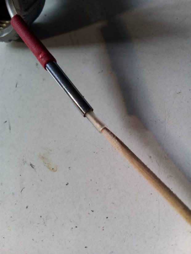

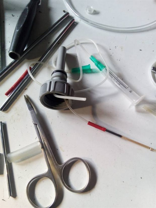

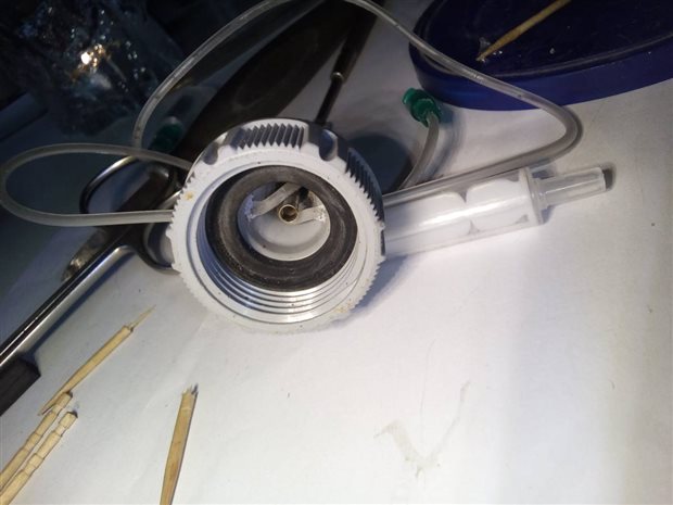

The need to reconstruct  the entire 'end-tip':

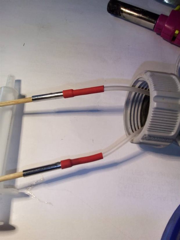

A concrete airflow, a housing for the end of the fine tubings. Form metal. Glued, fixed together - like a pack of three.. :

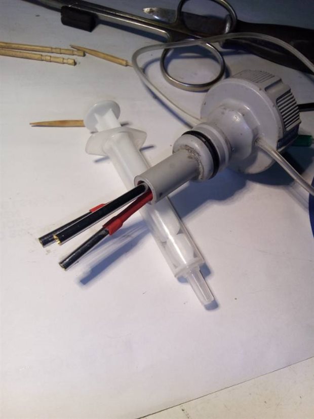

wow - and again,  hovering the house, was looking in all boxes, cartons. And I found' a radio antenna. The last end part was fine,  but was it thin enough to fit?
tube,  red shrinktube, metal tube,  the end of the flexible, a toothpic in the lumen' :
Cutting, measuring, recutting, until all the 3 ends were in place - the tubing outlets for the liqids and the air tube. Before glueing the fine flexible tubes, the ends - into the fine metallic tubes, I pushed in the ends, in the lumen a tip of a waxed toothpick - to prevent that any glue would clog up the fine outlet.
airtubing and the 2 liquid dispenser tubings - that tiplet - to get in place:
here in the housing, starts the airtube:
After the ends were fine and cured I added the longer air tube - fixed altogether by shrinktube, some epoxy to the triplet and all at, in' the end of the PVC nozzle...
shrink tube forms the triplet :
a bigger shrink tube all around, to tighten all up and to stabilize. - the shorter tip is  the air nozzle (red) :
all in place, ready to connect:
That construct works like a charm. It draws about 1 ml every second to nebulize...  image

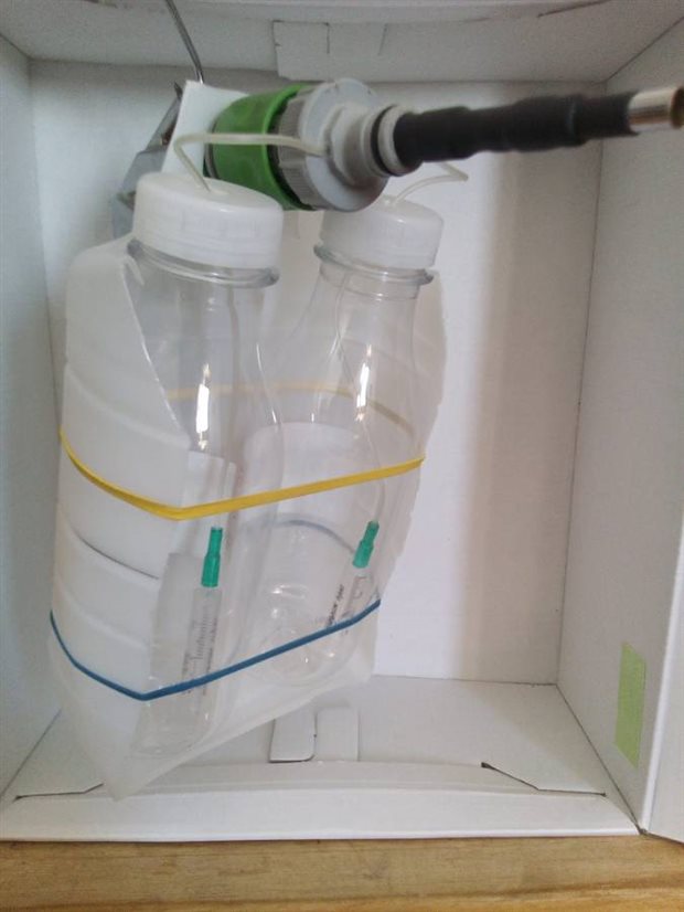

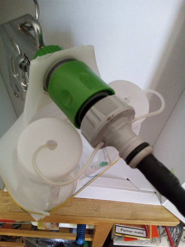

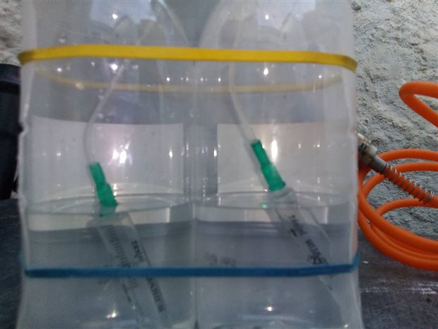

Now,  how to attach the little tubings to the liquid bottles, and a holder for the bottles -  to that pistol ?
browsing the house, an empty 5-litre demin water canister would do it ':
cutting away the half of it from top to down, cutting away the unused parts -

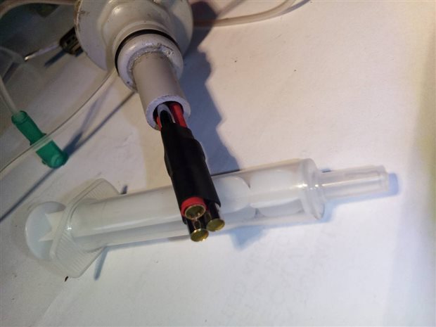

at top of that construct a big hole to fit on to that pistol, to the garden hose connector... :
into the open syringes I can add some filter material, and they guarantee that the tubings will be well 'supplied, always submerged in the liquid..
the bottleholder, 2 x 0.5 liters:
the center drilled caps with the superflexible liquid-tubings:
after all testing all has to be cleaned, all, the working marks...  yes... image

the history  about  to choose  the dish, and  - how to 'mirrorize', making  it 'highly' reflective:
All them 'parabols' I had im my hands were coated, of course - the one I used here, shown in the video, has a core from aluminium with is massive 'coated'  glass fibres X epoxy (structures on the backside)  and a  fine layer of it on the front..
I wet-sanded the front, with 150, 300, 500, 800, 1000  up to 1.500 - the parabol' was  laid up ward, and I filled the parabolic gap with water and some drops  of a  dishwasher, detergent'
My grinding tool was a 30 cm round tap from a small rubbish bin...and I just followed softly (!!) the form, curve -  not to change the geometry...

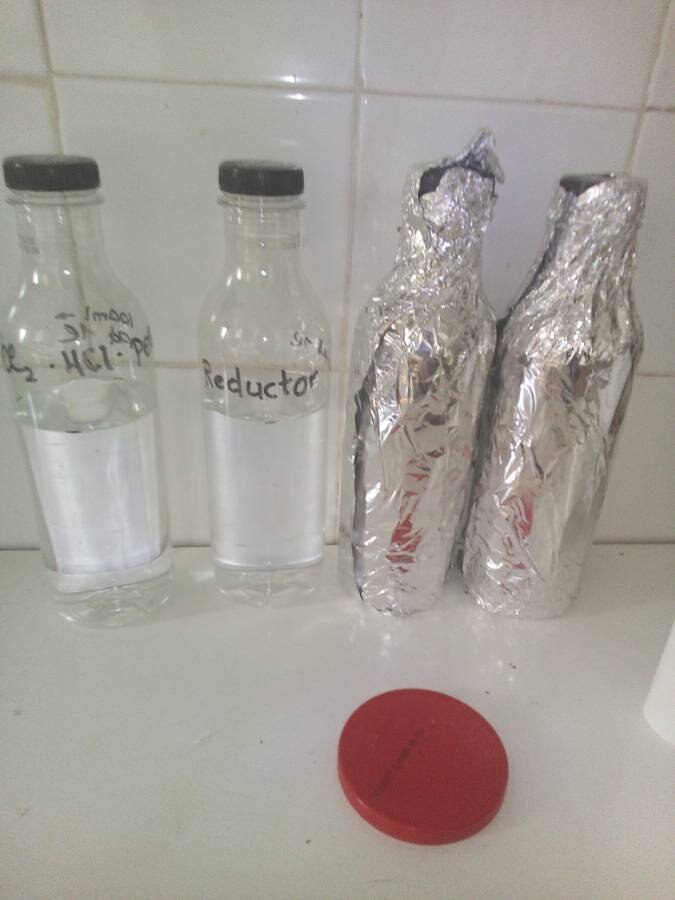

Activator, reductor  & silver in solution (light sensitive ! -  so I wrapped the bottles in alufoil...)

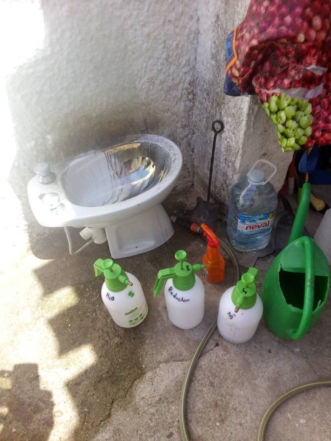

the  3  pumpspraybottles -  at the  location of the  test  - outside in the patio:

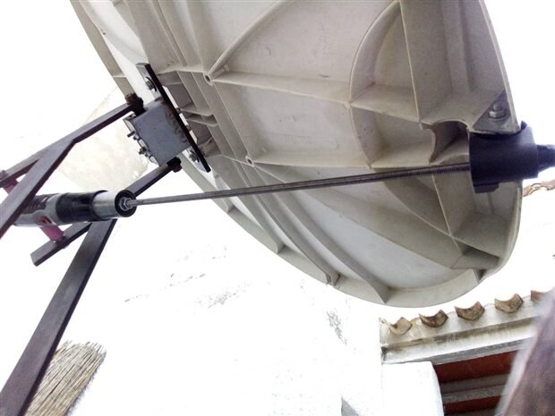

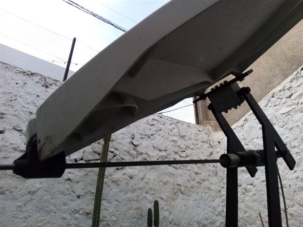

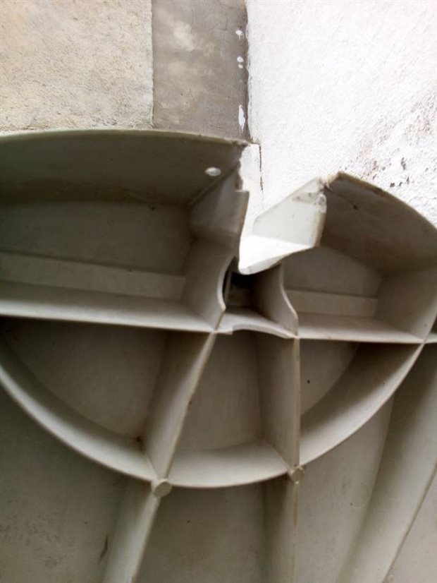

the 'new construction to the elevation axis -
the force  was so strong
that  the old rod nut  was
pushed out of its harness...
wow.  - I was looking for a new possibility to order the entries -  found until now ' nothing -  so I will append the material I do have.

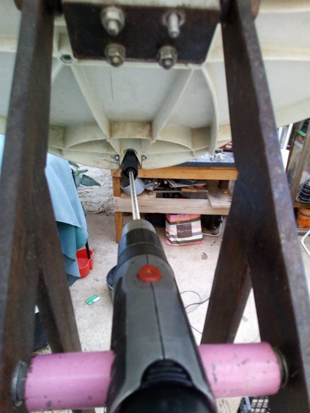

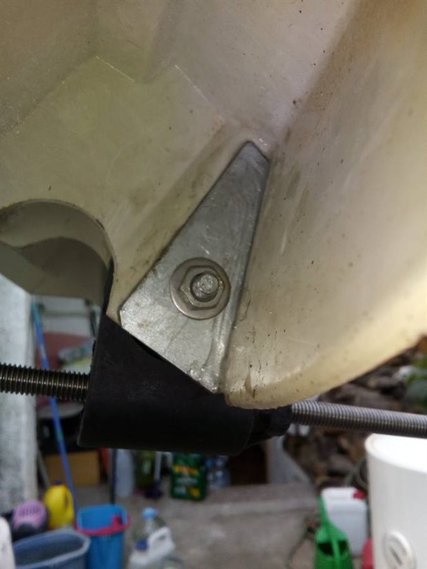

Today  I  completely  was  able  to renew the elevation 'system:

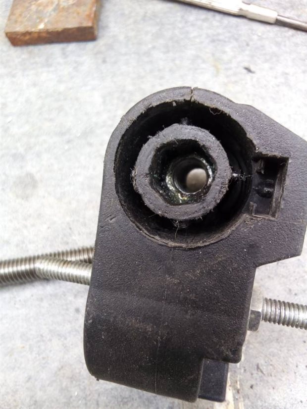

the motor, the connection from the motor housing, case to the bear 'ring'housing was wobbling, so I used just a piece
of a wider metallic tube and resined (epoxy) the gap in between the housing of the motor and the bear'ring housing... perfect tight and rigid, now. ( some days ago ) ..
The rod nut, in its housing ' rod-nut-holder' -
a long 'nut, hexagonal, glued in - as well with epoxy. To make it  'fit in - I widened the existing channel, and
dremel'ed in, the hex profile,  so
the  long nut finally fitted in..
As  well some  days  ago
and  the
todays

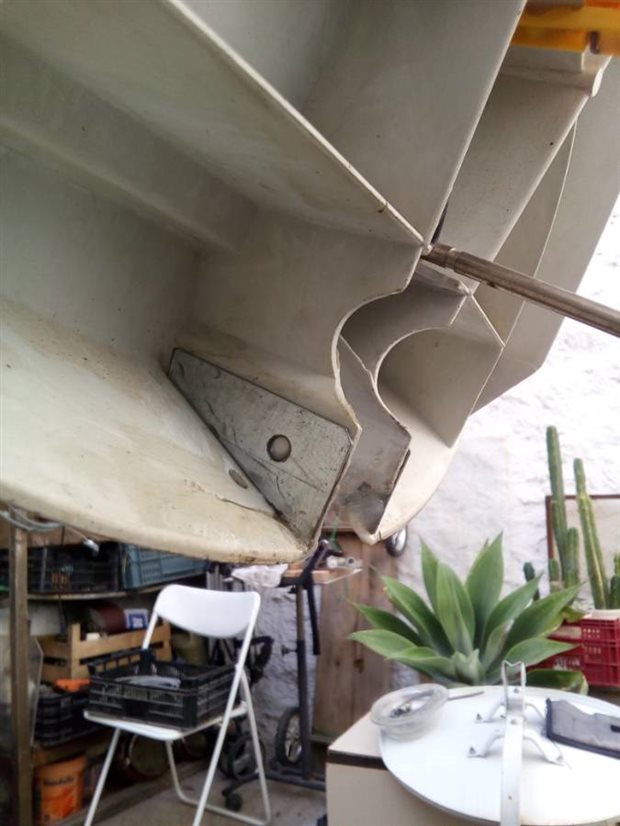

' work: the strengthening to the  sides, which carry, will hold the rod nut'-holder...  (the  nearly  triangular pieces of metal, with the
bore hole
for the  axis) - glued to the
innerside
of the down-under-part of that parabol.. :
Here to see the motor, the rod and the housing of the hex-long-screw-nut', and the triangular strengtheners':
the hex-nut, glued in the holder (epoxy)
the triangular strengthener'
does all fit to each other?
close'up of the hex-housing'
aside: the nut's, M6, Inox

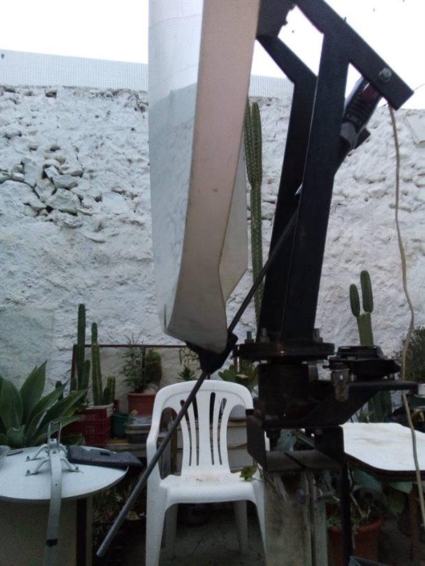

the motor,  the black tube to the  housing,  and the silvery tube-housing of the  bear'ring:
a  shot from below, upwards: motor, rod, hex'housing, attached  to the bottom of the paraboldish;
      above the motor: the elevation axis..
.. about 55 degrees

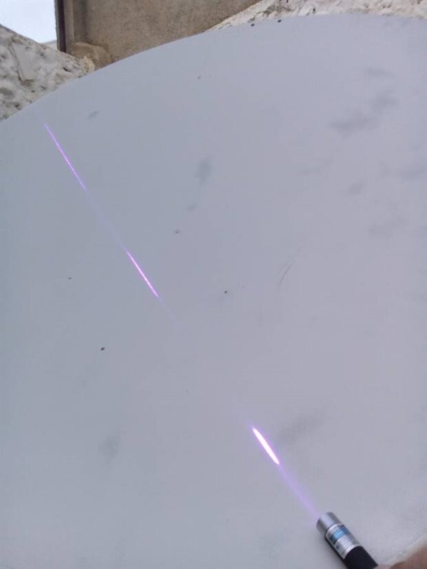

last year, what's  today's  left over - from the polishing  action ( without the  reflective  silver layer  !)
the laser beam reflects at first spot, to the second, to get reflected to the third. :
(5mW 405nm):

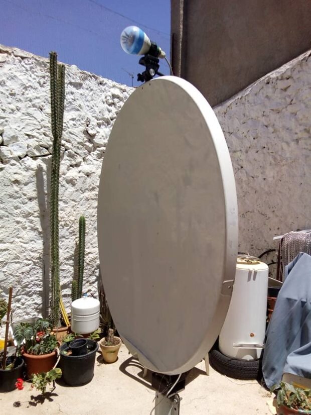

horizont' position - at  evenings and in the mornings.. (we  will see  image )
the  coloum cacteea in background are  Trichocerus - terchekki, -peruvianus & -panachoi.. image

the  sunfollwer electronics, Program to calculate  is  made  for an Arduino Nano, it has  8  analogue 'In'put pins :
5  for them photodiodes, 3  for the temperature from the boiler
2  big motor driver ic's IBT ( h.bridges  for DC' motor's ), to drive by  PWM the rotation motor ( east-west )  and the  elevation motor ( zenith-horizont )
the  sensors are made of 2 pairs of photodiodes, and a centre PD, all in all, 5.
4 End-switches, to detect the max'mechanical limits  - after 2 Schmit-Trigger RS FlipFlop - polled' to  2 interrupt pins..  ( on D2, D3 @ Nano )
The  thermor  has got its own ArduinoUno -
for the 3  NTC - and the mechanical overtemperature switch
the temperature - coming from the  Parabolic  Dish, to load the thermor,
the  water'temperature  'absolute, in the thermor, and -
the temperature at the out'let  - back to the focus,  to get reheated there again...
OpAmp followers  and  one comparator, to detect overtemperature,
a 0.9' Oled Display to show the current temperatures -
a pushbutton to show up the data on b.press..

first  steps - 2  photodiodes, arduino nano, the  sketch - listed  below -
the motor  driver, the dc windowlever motor, connected to the rotation axis:
(a rear-axis  from a opel astra, without all them mounted  stuff on it.. ) :
Overview:  in front the  Parabol, in the back, the thermor in which the energy will be stored in'..image
a test to  pan, tilt the  system, to see how it responds to different voltages:
dc motors do reverse the direction of rotation when we do reverse the connections of the dc voltage.
the speed is pretty  high  with  current, steady 12 V DC - but in work modus',  the  speed is  really, really slow - realized via the  PWM... '
PWM: tiny spikes of  12  volts -> very slow motion;  5 ... 10%
longer, wider  spikes: half impulse <>  half delay' - forces to spin faster: 50 %
and real big ones,  long impulses witch nearly flowing to each other:  the motor spins really fast ...  90%:
These impulse and pause times were repeated in nearly 1:1.000, 1:500 seconds interval.. (Arduino et al. ) depends on which pin is  assigned.
the  GiraSol-box - the  Arduino Nano as the core - and two  mighty dc motordriver for the  asxis's:
