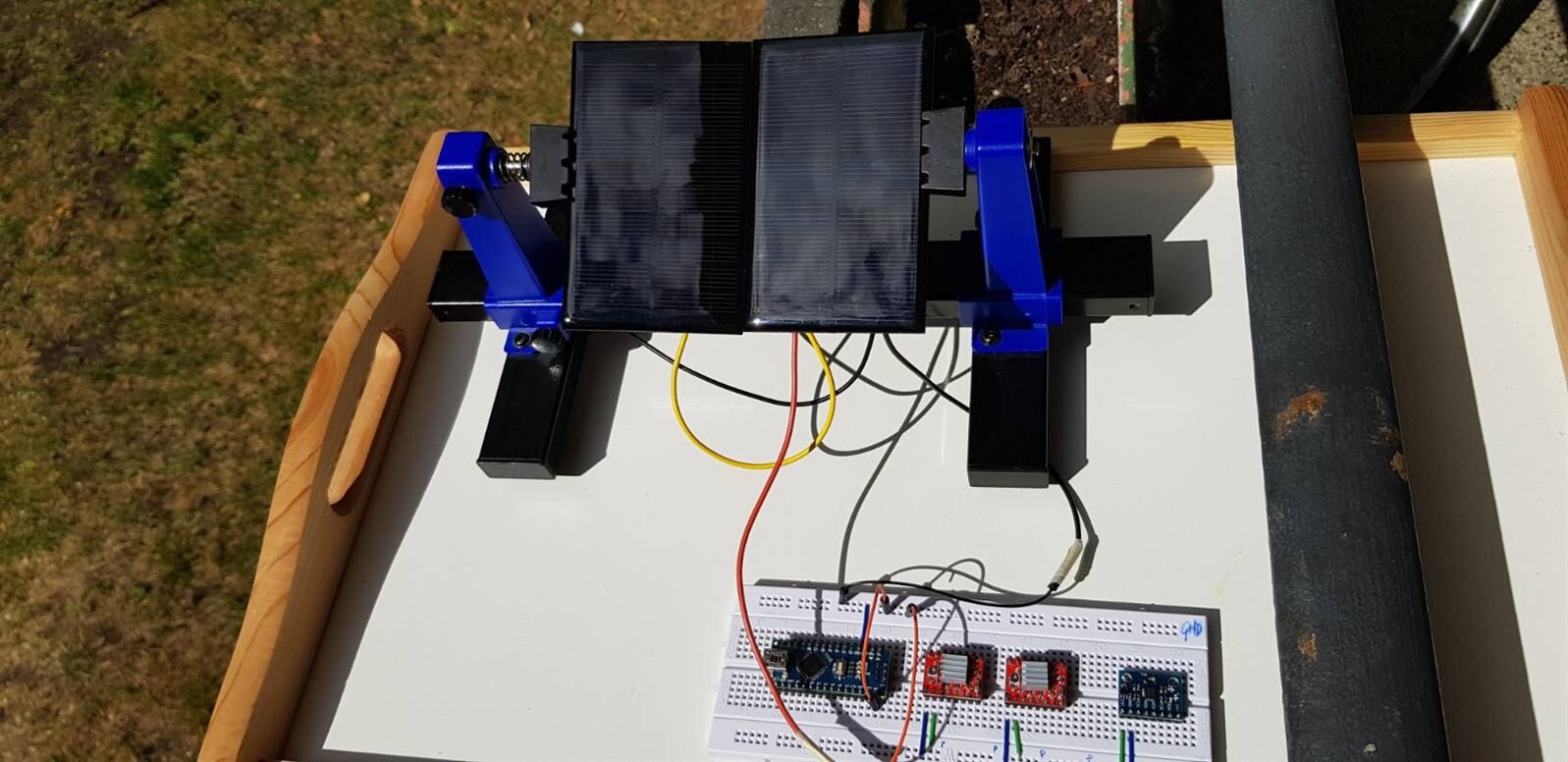

This week was not blessed with much sun in North Germany. I focused on testing different sensors and motor drivers with Arduino Nano board.
  • Testing Solar Panels powering Arduino Nano

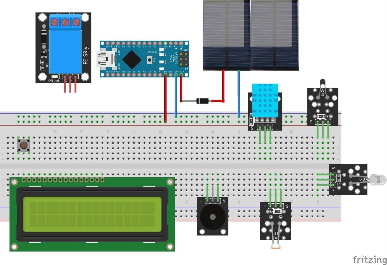

  • The Sensors Test Setup Plan

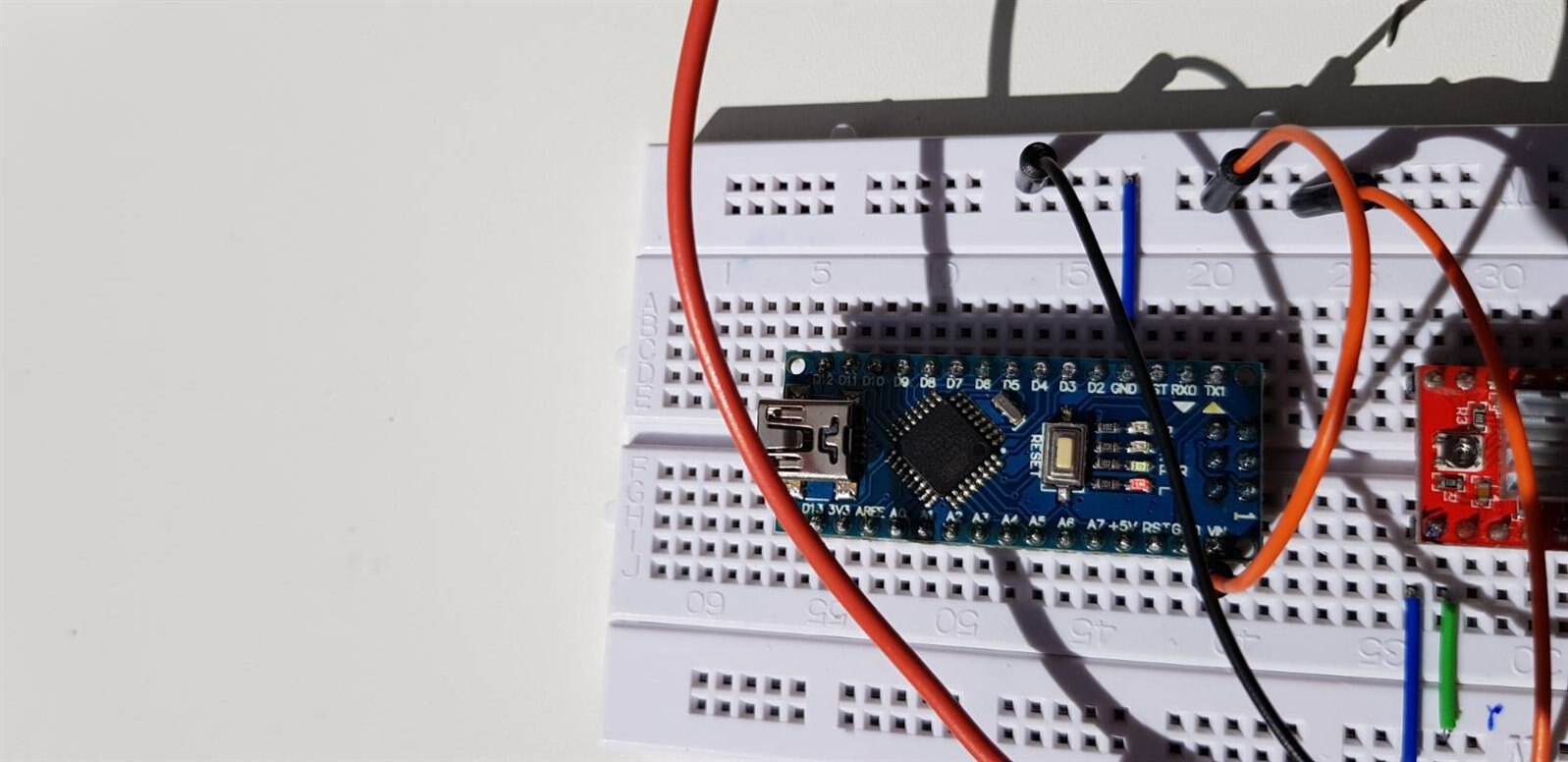

Powering up the Nano with Solar panels
imageNote: Next time must add some diodes for security to keep the controller safe.

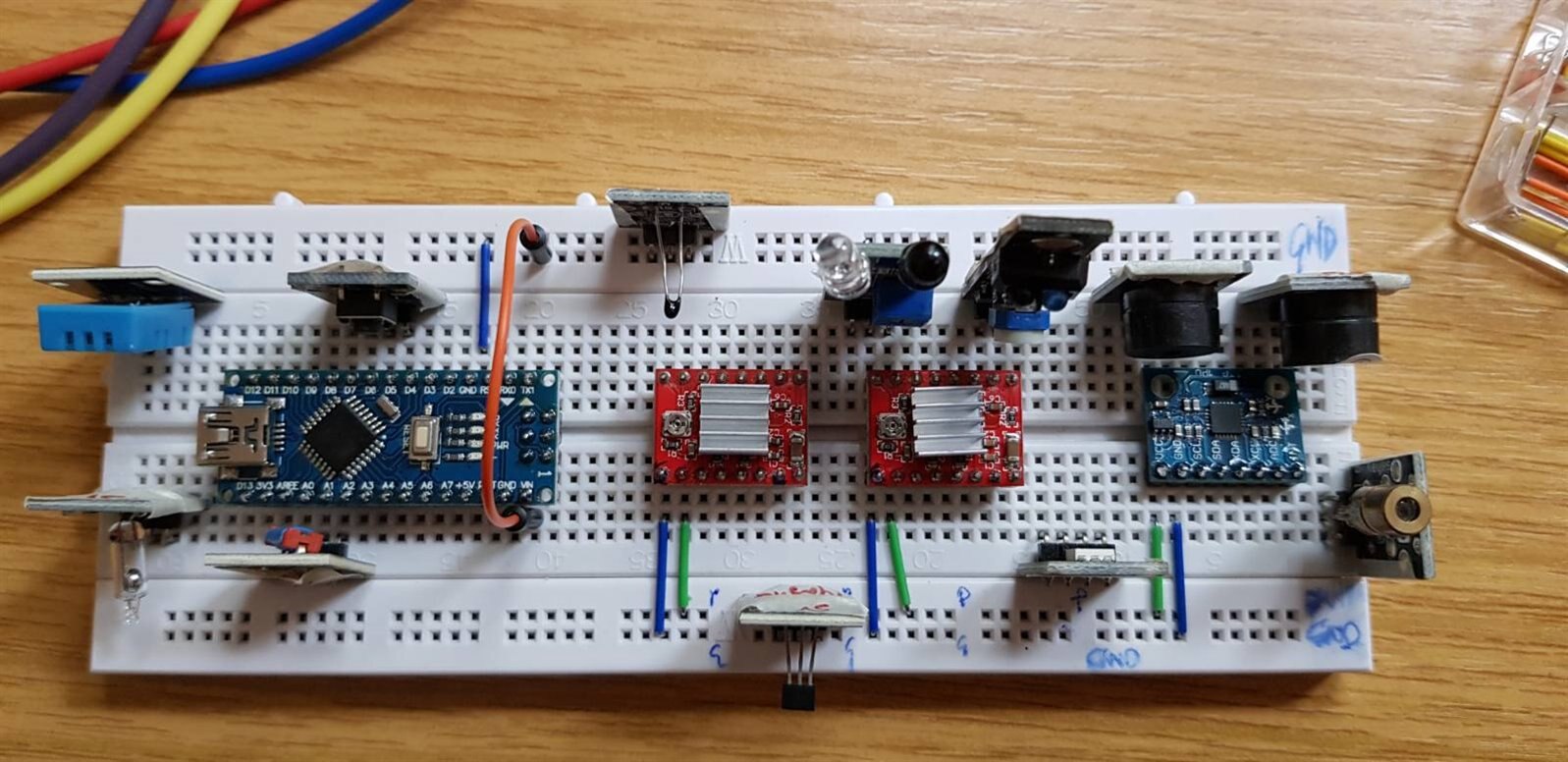

The test plan
Testing the Sensors

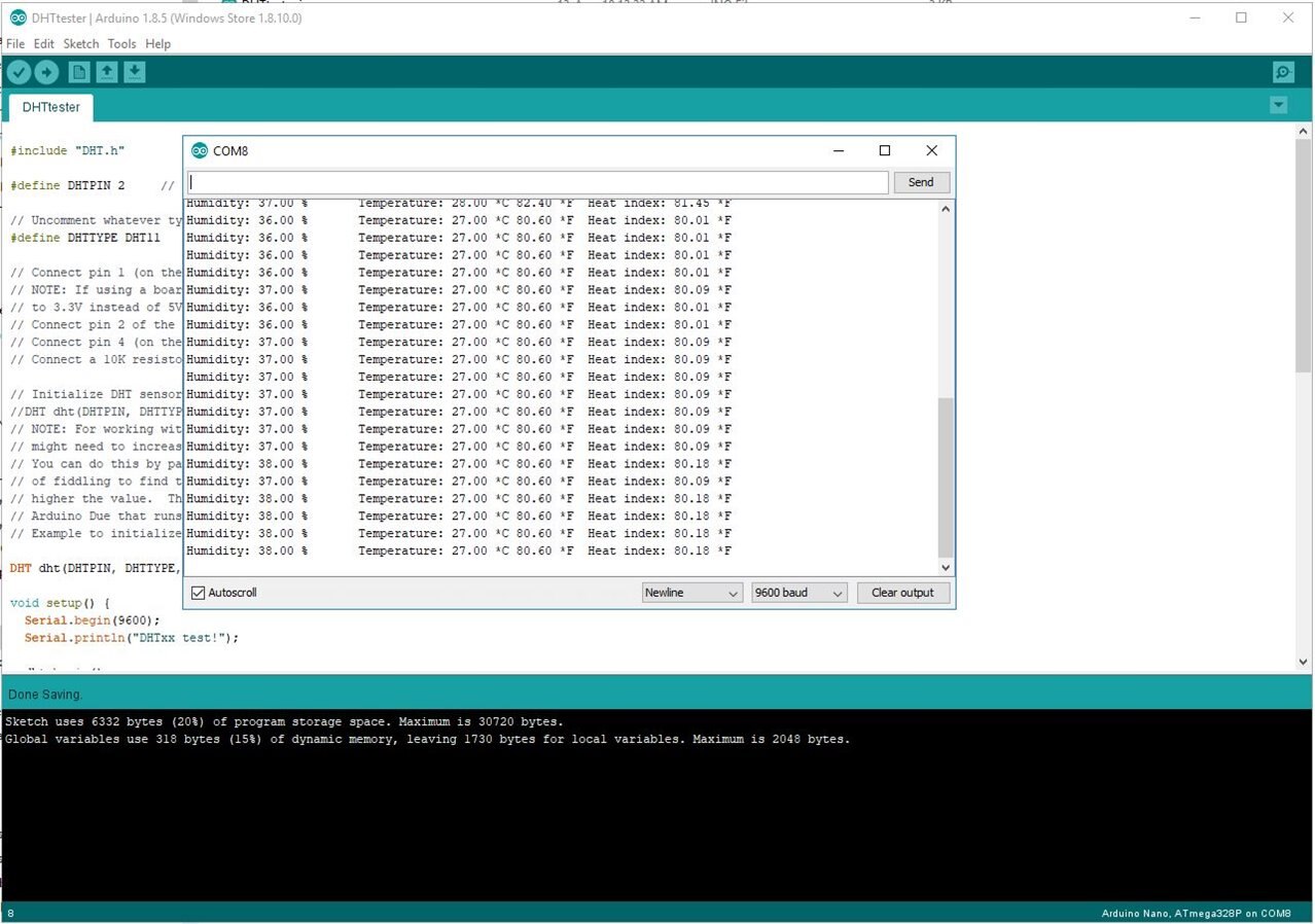

DHT 11 Sensor with Arduino

    genebren over 8 years ago +3
    Nice update on your solar powered project entry. Care should be taken to insure that over light loads that the solar panel output voltage remains in safe region. This can be achieved in similar manner…
    jw0752 over 8 years ago +2
    Hi Sneha, I am assuming that you are using the bread board for display of the components for this presentation as many of your placements are meaningless electronically. John

  • snidhi
    snidhi over 8 years ago
    Thank you guys for the insights...... Too late though.. image
    *** got burnt and fried like chicken image
    Nice update on your solar powered project entry.  Care should be taken to insure that over light loads that the solar panel output voltage remains in safe region.  This can be achieved in similar manner as fmilburn  did on his Solar Bubble Blaster project, or through the use of a switchable load (like a resistor or LED) which can keep the open circuit voltage in a reasonable range.
    Good luck on your continued progress on your project (and on getting some sunlight for testing your robot).
    Hi Sneha,
  • snidhi
    snidhi over 8 years ago in reply to 14rhb
    yea thats for sure. And also many of them image
