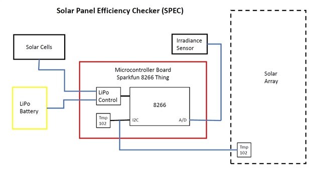

The initial Block Diagram for the SPEC:

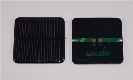

1) Solar cells - AOSHIKE Monocrystalline Silicon Solar Cells in Epoxy Package
    2V @ 160mA
    50mm x 50mm x 2mm
   These are compact, inexpensive cells which are reasonably robust mechanically.
   Use cells for both power and irradiance sensor.

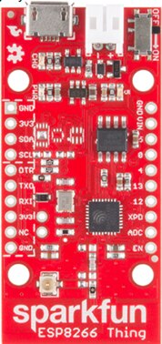

2) Microcontroller Board - Sparkfun ESP8266 Thing
    80mm x 30mm x 5mm
   Features:
     ESP8266 microcontroller
     A/D Converter
     I2C Interface
     LiPo Battery charger
     802.11n Wifi

The solar cells are rated at 2V @ 160mA, but I do not have a detailed spec sheet.  I'm assuming that this is under standard test conditions.  I plan to use 3 cells in series to provide 6V @ 160mA.  I'll use a series diode to drop the voltage closer to 5V for the input to the Thing board.  I'll need to do some characterization to ensure that I won't exceed the 6V maximum of the board input.  I plan to use a 1000 or 1200mAh battery to provide power when there is no sunlight, so I think I'll be okay except for possibly a string of days with poor total irradiance (winter months).  Again, I'll need to do some characterization.  I can add another string of cells in parallel at the expense of a larger housing.
I'll need to have power management incorporated in the program (control the frequency and duration of WiFi activity, standby when there is no irradiance).  I don't think I'll need the deep sleep mode but that could be an option at night.
Irradiance sensor:
Since I don't have a detailed spec for the solar cell, I'll need to generate the I-V curves.  I'll determine the MPP voltage and current under standard test conditions (STC - 1000W/meter^2 and 25C) and use that to select the load resistor for the solar cell.  I'll need to scale the load resistor voltage as the A/D input range is only 0-1V.   The A/D reading will provide the voltage and current (voltage/load resistance) that are needed for the irradiance computation.
I plan to use a Daystar Irradiance meter as a reference check.

    Very interesting update to your solar powered devices project. You mention MPP (maximum power point), but I don't think that you can get the 'thing' board to control the charge rate for your battery. On…

    Very interesting update to your solar powered devices project.  You mention MPP (maximum power point), but I don't think that you can get the 'thing' board to control the charge rate for your battery.  On periods of partial sunlight, the charger will load your solar panel down to the point were the voltage drops below the charging threshold and no charge will occur.  The trick with simple Li-ion charger chips (like the MCP73831) is that you have to be able to control the charge rate to match the solar panel's available energy (MPP).  There are a couple of ways to do this.  One is to use a programmable resistor (or digital potentiometer) in place of the fixed (2K) resistor (increasing resistance as the solar panel's voltage drops).  It is also possible (and a bit trickier) to create a closed loop system to trim the charge setting, inject current into the 'PROG' proportionally to the voltage on the solar panel (as the voltage drops, inject current to effectively lower the charge rate), to decrease the charge charge so the solar panel's voltage increases (to stay about the charge threshold voltage).

    Jan Cumps over 8 years ago in reply to DAB
    DAB  wrote:
    I am curious, why did you not just use the solar cell as your indicator for sunlight?
    This may be possible. But the solar cells are high power. The signals they give would have to be transformed into something that's appropriate for a micro controller.  And the high power in the solar circuit would have to be isolated.
    A separate cell that doesn't have a connection with the power side may be cheaper and easier to keep safe?
