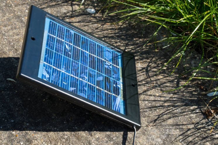

I wanted to have a general purpose outdoor solar charger that could be used for (say) powering outdoor speakers, or for evening lighting. I wanted something that could easily charge some tens of Watt-hours energy capacity batteries, so that there is lots of power available, but small enough that it doesn’t need a massive panel.
I have several compact solar panels and a few rechargeable batteries to test with for now, but I hope to find slightly larger panels and batteries too.

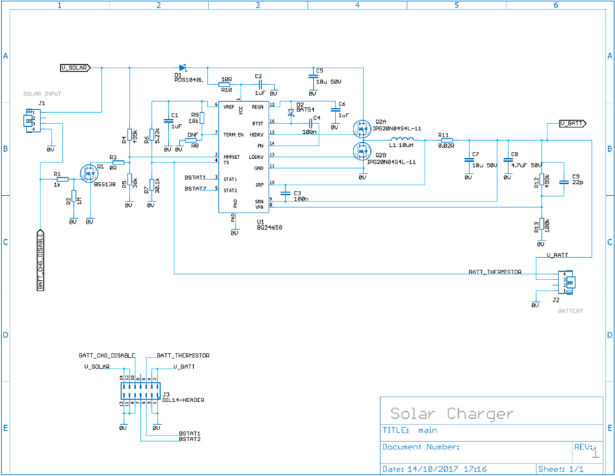

The perfect IC for this seemed to be the BQ24650BQ24650. It can accept a reasonably wide power range for small panels (5V to 28V) and can handle different battery types and different numbers of cells.
Schematic
The circuit is fairly straightforward; it is based on the datasheet, with some external control to be able to switch it on/off using an optional microcontroller. The two main connectors J1 and J2 are used for the solar panel input and the battery to be charged. There is a third connector which carries the same connections plus a few more that are useful for connecting up a microcontroller or LEDs for status information.

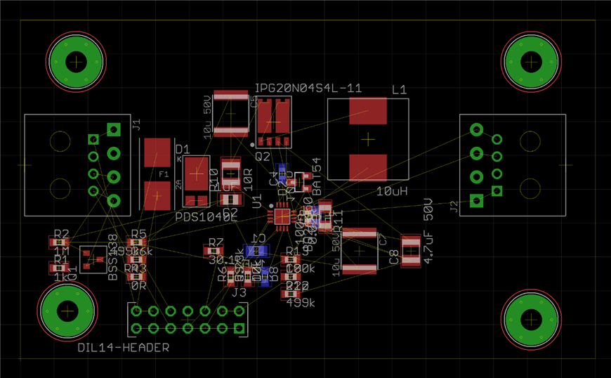

PCB Layout
The CAD layout here shows the current state of the board; it still needs to be routed! It will be fairly compact, around 100x50mm.

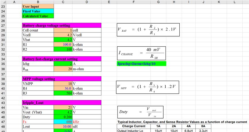

Circuit Calculations
In order to determine precise component values, there is an excellent BQ24650 spreadsheet. I used it to experiment with what values will be required. These will be selected once a battery is chosen. Initially I may use a couple of D sized NiMH batteries, to build an outdoor lamp or speaker : )

    I wasn't planning on purchasing any solar panels either to be honest - instead I purchased individual cells, they are quite cheap, less than $2 each even in small quantities.
    They are not environmentally protected however. It was just going to be an experimental project, i.e. it could be an interesting approach to have only partial environmental protection, and replace cells if/when they died or cracked. Also I'd rather just experiment with cells and learn a bit more about the technology for now, see how long the cells can last, and if the output is worth it.

    Unfortunately I've had this project on a lower priority recently : ( but I should hurry up, because summer is approaching and it would be good to test it. I've made some slight changes to the schematic in response to the comments above by Ka (the screenshot below shows the modified portions of the original schematic - a few resistors were added), and I have started laying out the PCB. I still need to do some work on it : ( but hopefully can have it laid out in the next month or so.
