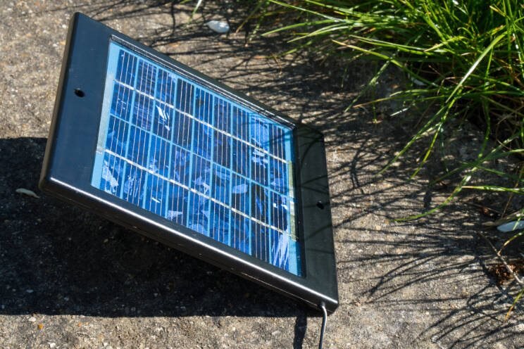

I wanted to have a general purpose outdoor solar charger that could be used for (say) powering outdoor speakers, or for evening lighting. I wanted something that could easily charge some tens of Watt-hours energy capacity batteries, so that there is lots of power available, but small enough that it doesn’t need a massive panel.
I have several compact solar panels and a few rechargeable batteries to test with for now, but I hope to find slightly larger panels and batteries too.

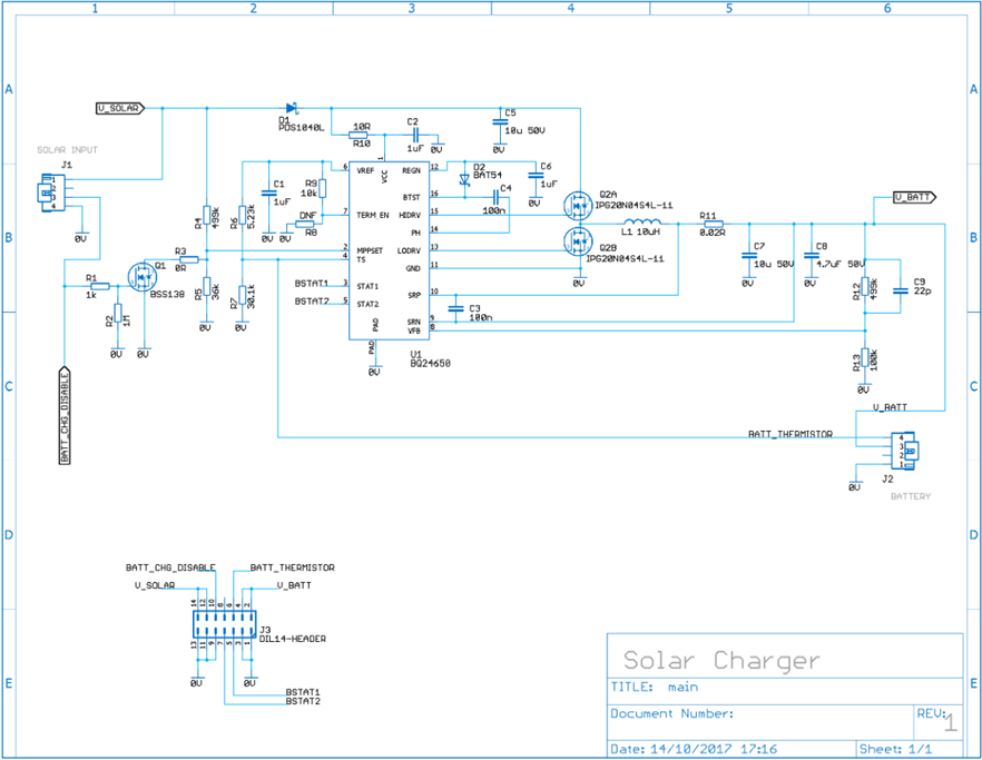

Schematic
The circuit is fairly straightforward; it is based on the datasheet, with some external control to be able to switch it on/off using an optional microcontroller. The two main connectors J1 and J2 are used for the solar panel input and the battery to be charged. There is a third connector which carries the same connections plus a few more that are useful for connecting up a microcontroller or LEDs for status information.

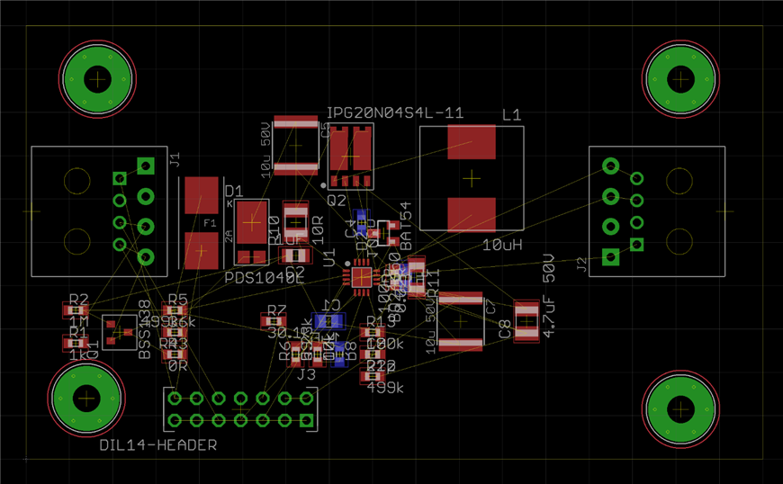

PCB Layout
The CAD layout here shows the current state of the board; it still needs to be routed! It will be fairly compact, around 100x50mm.

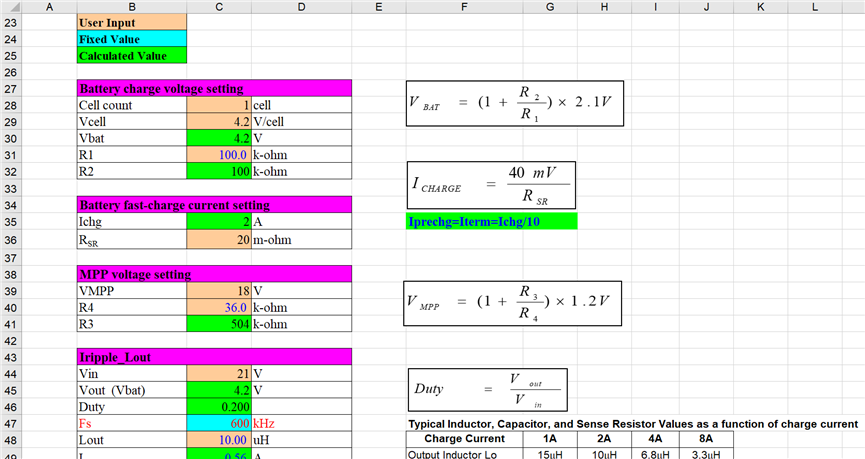

Circuit Calculations
In order to determine precise component values, there is an excellent BQ24650 spreadsheet. I used it to experiment with what values will be required. These will be selected once a battery is chosen. Initially I may use a couple of D sized NiMH batteries, to build an outdoor lamp or speaker : )
