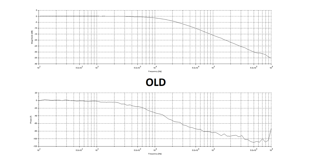

The quest to achieve frequency response measurements in my home lab began around one and half years ago, with this Rohm buck converter roadtest. After that, I made a followup trying to measure the loop response on that specific board but I got mixed results. With passive circuits (RC filters) it worked decently but it was kind of useless for measuring anything more complex.
Then, as usual, life went on and many other things happened. I changed jobs, bought an apartment and moved in with my lovely girlfriend. All of this was great but finding the time to work on hobby projects became a luxury so I had to put this goal on hold. However, that time has come again! The timing of this spring clean competition is perfect for giving me the push I need to finish this long-overdue project!
How I left things up
Last time I left this project only partially functional, but I had a great conversation with michaelkellett on how to improve my setup: moving the post processing to the pc, by acquiring many more periods and using dft to extract amplitude and phase information. This is exactly what I'm going to do now.

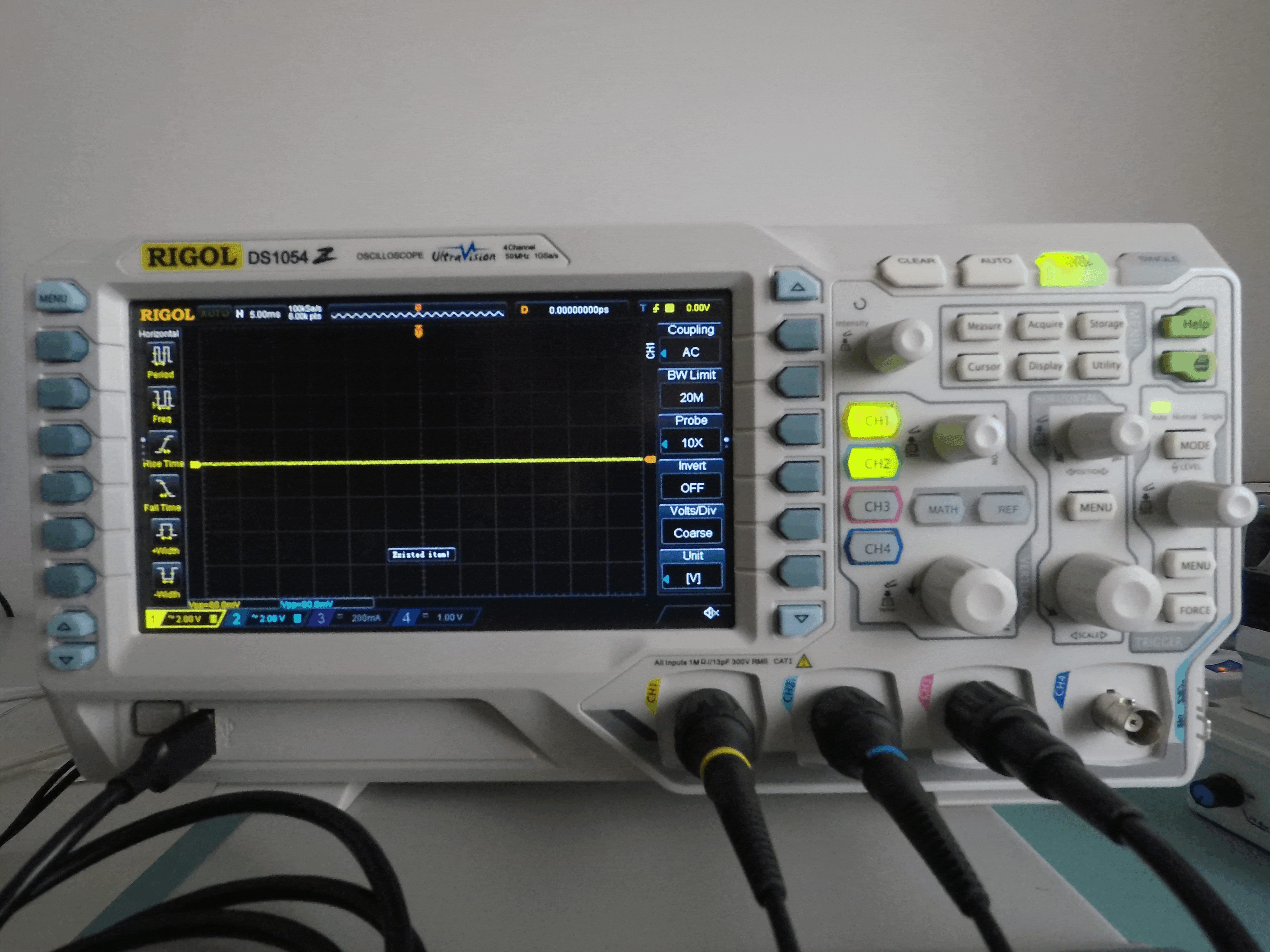

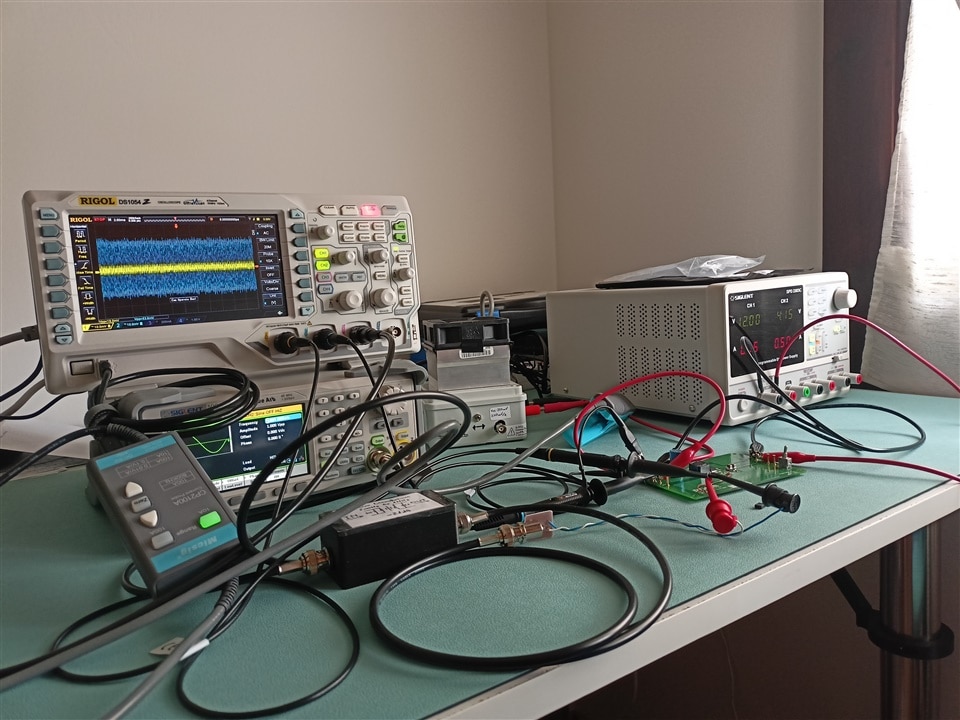

The measurement setup
The measurement setup remained unchanged from the previous attempt, and consists of a signal generator to stimulate the DUT, an isolation transformer, the scope to acquire input and out waveforms and a PC to coordinate the instruments and to elaborate the data.
This is the same setup, just with augmented reality Slight smile

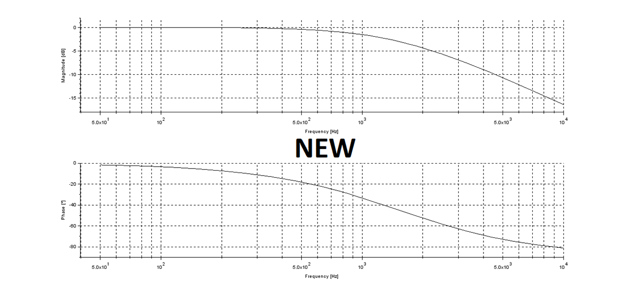

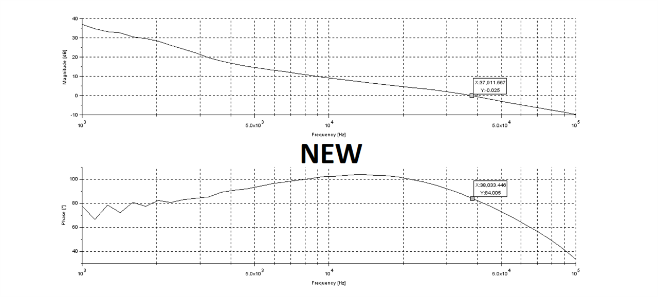

This is the main point of the project. I started with the old script and evolved it, fixing along the way some minor bugs I left last time to keep things more interesting Slight smile. The following flow chart illustrates what I have in mind.

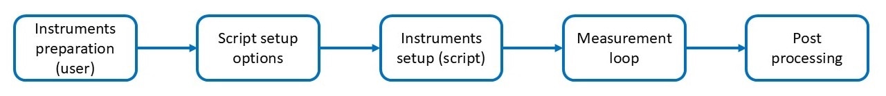

To avoid navigating through a km long script to modify a couple parameters, I decided to leave most of the instruments setup on the instruments themself, relying on the script only for essential parameters (such as number of points per acquisition or signal amplitude). Once manual preparation is complete, the script can be launched and it will control the signal generator and the scope, adapting horizontal and vertical scale as required.
I decided to avoid real time graph plotting and opted for a simpler post processing once all the data has been gathered.
It's far from perfect, but after a few iterations I managed to produce something that works reasonably well (more on that later).

Comparison: old vs new approach
Overall, I'm pleased with the outcome. It's easier to explain the improvement obtained with a couple of images.
Comparison measuring a RC filter
Comparison measuring loop stability of a buck converter
As it stands, this setup allows to get a complete acquisition with 40 points (two decades, 20 points per decade) in just under six minutes. It's not fast, but it's fast enough for all of my purposes.
imageAccelerated view during a sweep

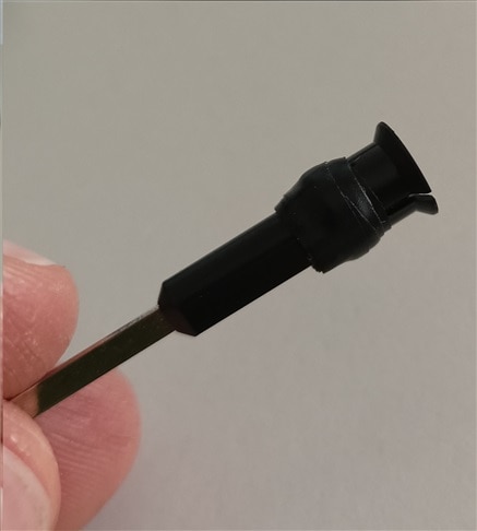

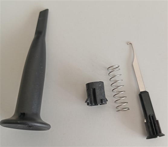

The project within the project: fixing scope probes
During the script development, I spent quite a bit of time searching for the cause of inconsistent results and lack of repeatability. After some time, unable to find the corporate inside my code, I decided to check my scope probes, finding a surprisingly inconsinstent contact resistance when set to 1x (but it was also visible in 10x). The correct resistance for my probes (tip to BNC) is around 200Ω, but it was jumping around up to hundreds of kΩ at times.
Luckily, the probe tip/cable are intact and the problem was found in the hook tip, which was making bad contact with the rest of the probe. A cleanup with some contact cleaner somewhat improved the situation, but the final solution was mechanical: dismantling the hook tip and adding some insulation tape around the contact point to improve its stability.
Probe tip dismantled and the "repair"
It's kind of funny I was able to bring to conclusion with success this project thanks to a small piece of tape Slight smile. And thanks to the  e14 community that pushed me to start on again on this topic with this great challenge!
