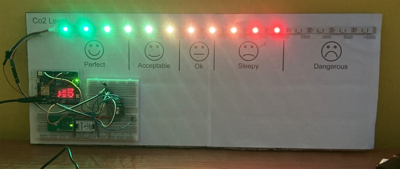

This project contains smart panel which shows CO2 level and can be used for example, to indicate when to open window.
See it in the action
After powerup, it took about minute to make measurement which is limitation of sensor, then it shows status on bar as well as textual details on matrix display. it also sends data to Arduino Cloud for making easy historical and remote visualizations.

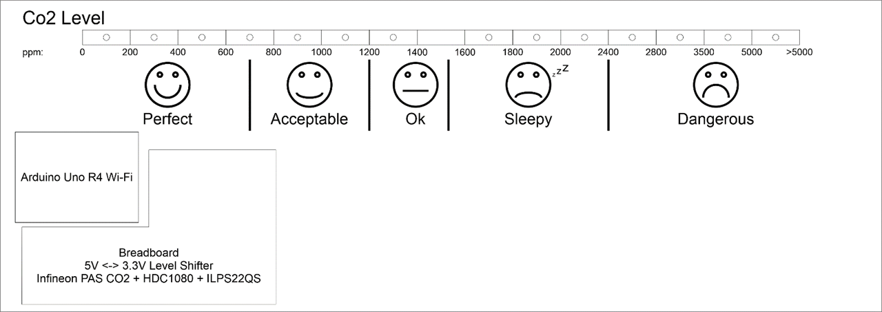

Mechanical build
For making it more interesting I took cardboard from some electronics components, printed two A4 sized pages with panel labels and glued all parts onto panel. The panel drawing is available in English and Czech (my native language) translations and at the end of article it is also downloadable in Corel Draw format in case you want to modify it.
EN: https://misaz.cz/Public/files/e14-co2/layout_en.pdf
CZ: https://misaz.cz/Public/files/e14-co2/layout_cz.pdf
Panel content template

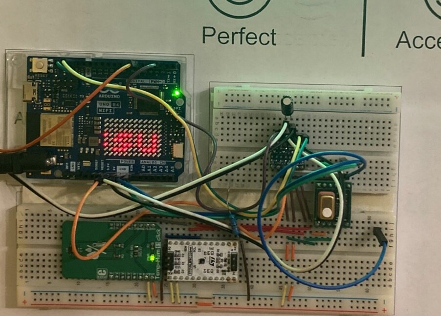

Printed layout is glued to cardboard. Breadboards and Arduino are attached by double sided sticky tape:
Electronics to panel mounting

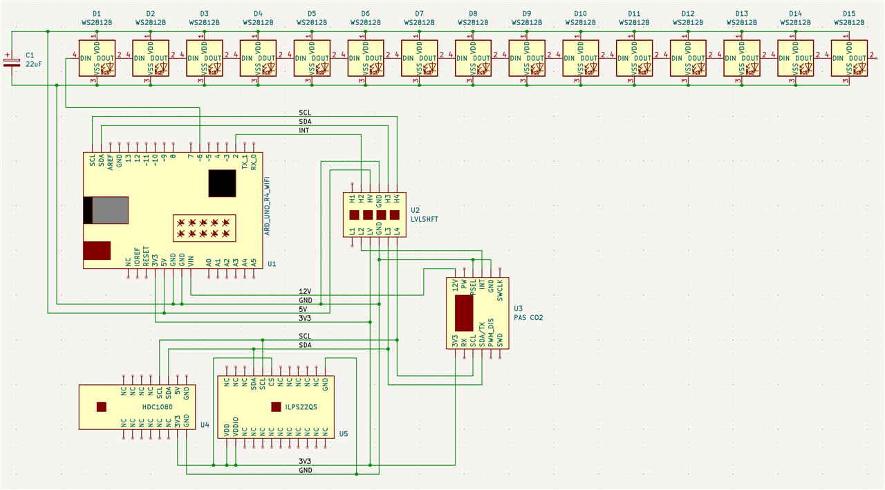

Electronics
As mentioned at beginning, I mostly use it for evaluation Infineon PAS CO2 sensor. Except this sensor there is Arduino Uno R4 Wi-Fi for controlling whole thing, WS2812B RGB Led Strip, ILPS22QS pressure sensor because CO2 sensor needs it for compensation, and finally HDC1080 temperature sensor because pressure sensor needs it for compensation :D . Finally, there is level shifter because sensors are 3.3V while Arduino is 5V and there is 12V supply which is required by PAS CO2 sensor. Arduino actually must be powered from it. USB power is not enough (CO2 sensor will miss 12V voltage if Arduino is powered only from USB).
Hardware is conceptually connected as follows:
block diagram
In reality it looks like:
And if you want to make it yourself, here is full schematics (you can download it in PDF at the end of this article):
Firmware
Since I used Arduino, I reused ecosystem a lot. I used available libraries, except for pressure sensor which is used for compensations. There is no library available, so I write my own simple driver, see init_pressure and measure_pressure functions, in sketch. For other sensors (including main CO2 sensor), I used existing libraries: XENSIV PAS CO2, Adafruit HDC1000 Library, FastLED, ArduinoGraphics, ArduinoIoTCloud.
Since Arduino ecosystem is quite great, firmware itself is pretty simple despite it combines many parts (4 sensors, cloud connectivity, matrix display, led strip). It is about 430 lines long.
The most lines of code come from error handling. Firmware is failure resilient and can recover from any sensor failure.
Feel free to download it at the end of the article, and modify it for your needs. For example, you can modify it to use different pressure/temperature/humidity sensor for compensation pretty easily by replacing content of relevant functions.

Results
I used it long term, sensor is really nice. Response is quite direct. In tests, over time CO2 concentration grown slowly and after opening window, sensor detected drop immediately in first consecutive measurement cycle (which happens once per 30 sec).
I picked levels from some health safety website. They differ slightly, so I pick some reasonable levels based on various guidance. However, even in "sleepy" range I mostly did not notice it and actually start noticing some sleepiness at the end of the range, nearly around level which health website considered "dangerous". So, I think it is bit shifted, but likely every human can feel it differently. Definitely open window and breathe fresh air sometimes
Showcase of indication of bad air quality
I run it in night as well. However, I disconnected LED bar for night runs :) In night I obviously did not follow it much, but at morning I had history of data available in Arduino Cloud dashboard.
